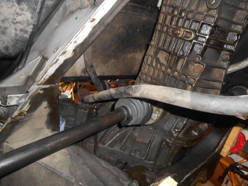

Postby Domi » Sat Jan 16, 2016 7:30 pm

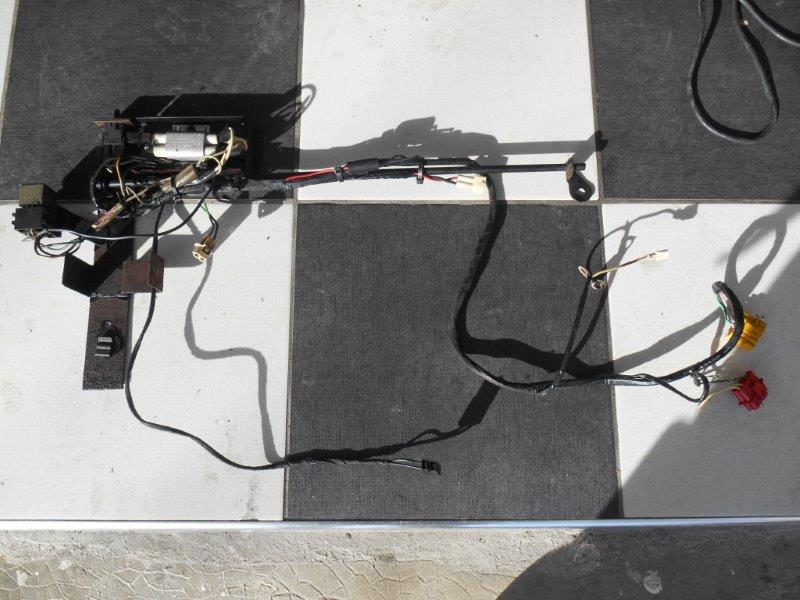

I forgot this part last time
This one need to be restored

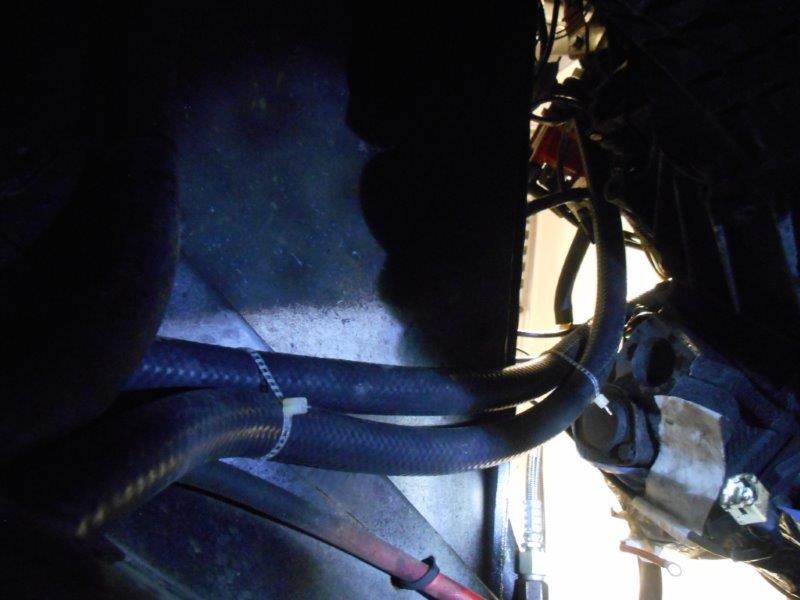

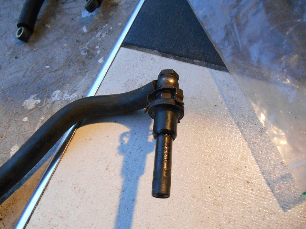

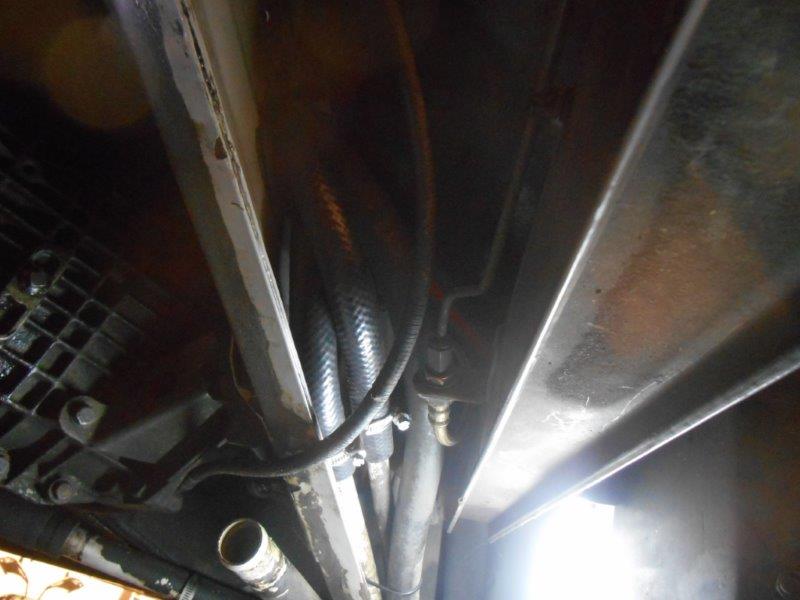

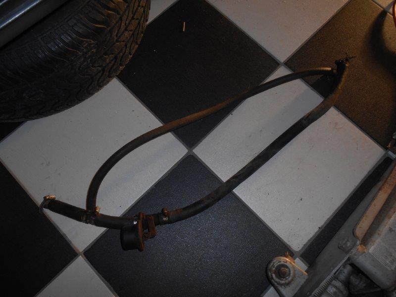

I have removed the pipes from the hot water valve and back water pump. Not a lot of room to remove them
Success, hot water valve removed but I can’t do the new because some clamps are missing in the kit

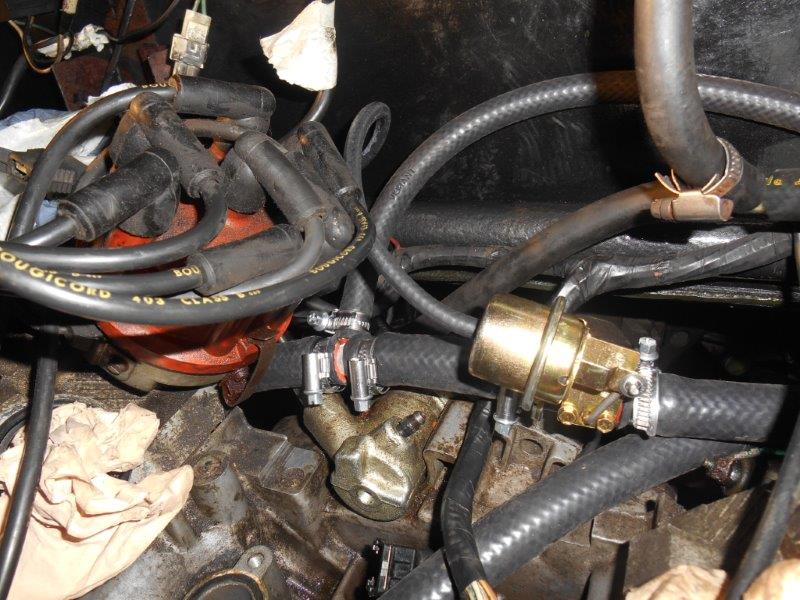

New pipes looks nice

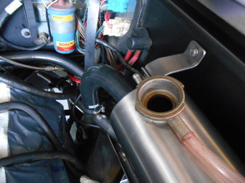

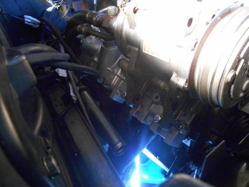

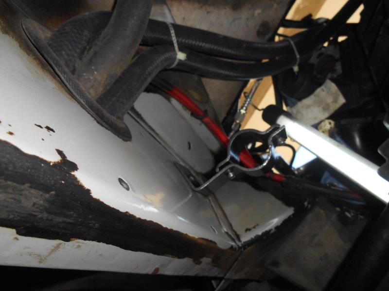

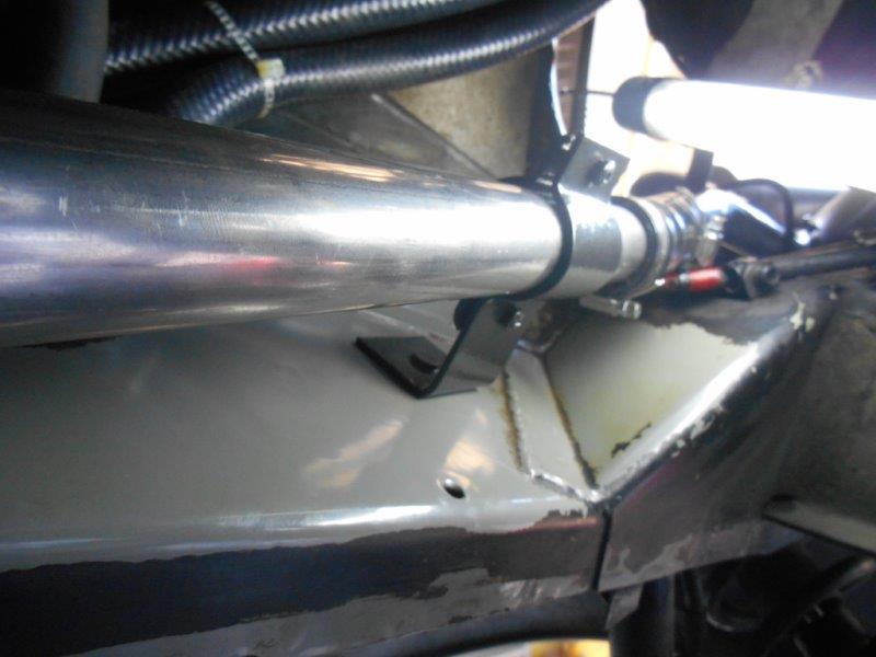

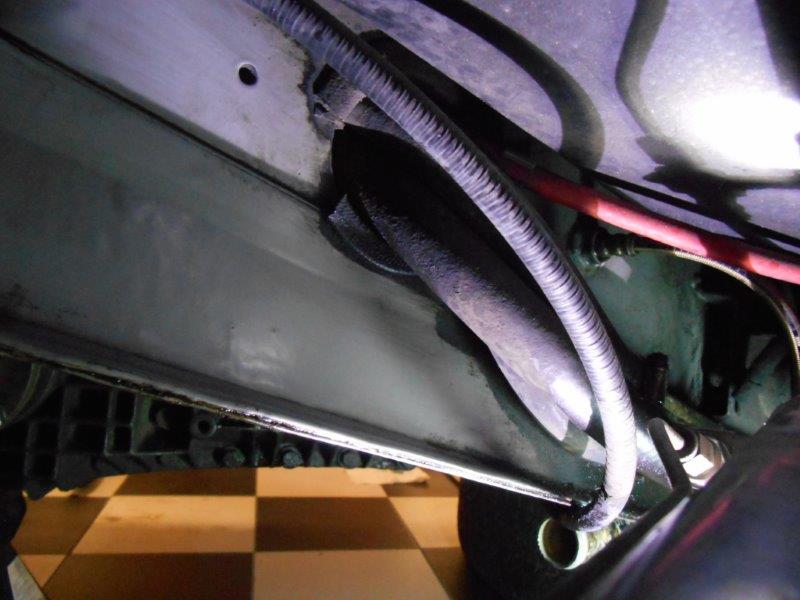

Postby Domi » Sat Jan 23, 2016 7:29 pm

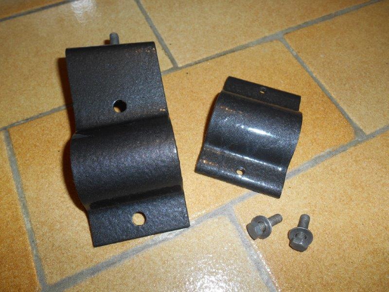

The bracket has been painted

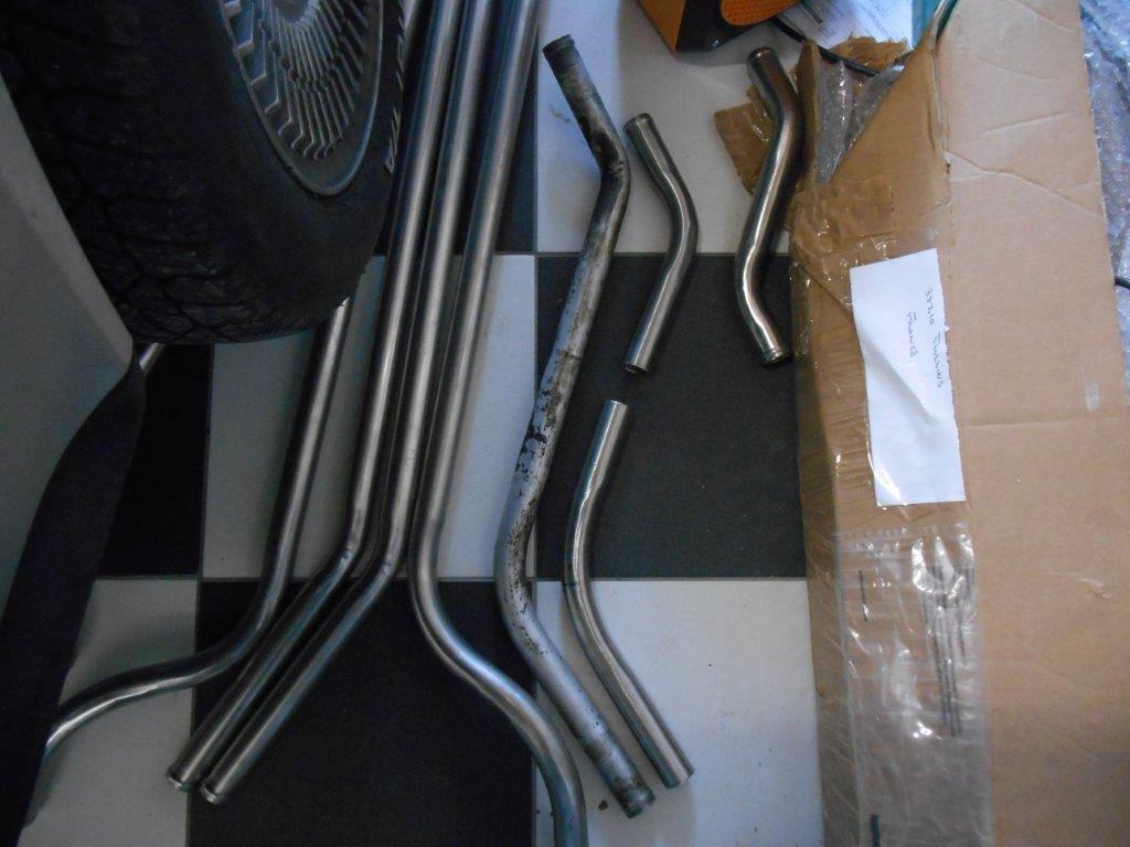

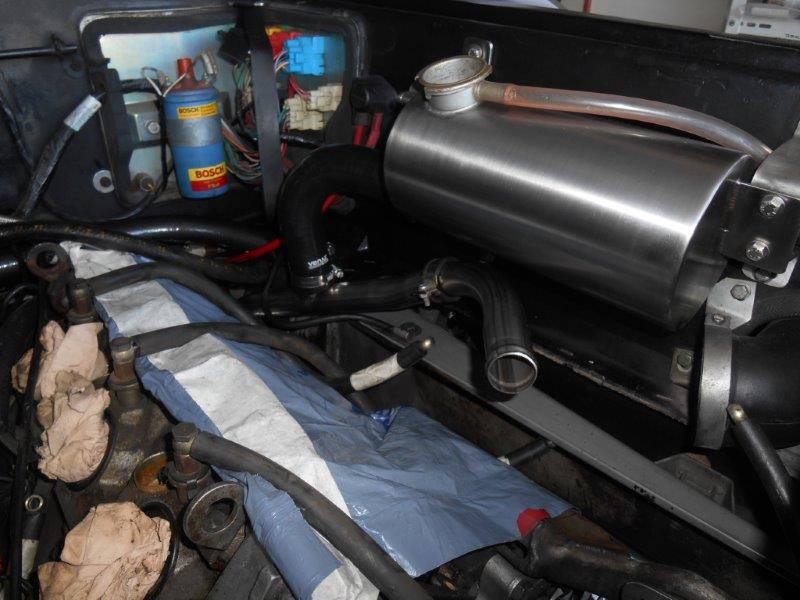

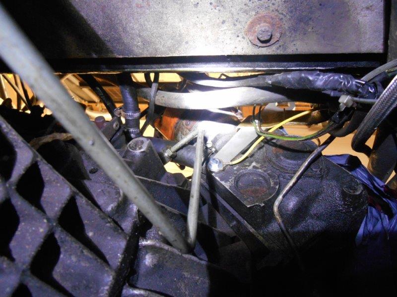

On the frame with the stainless pipes

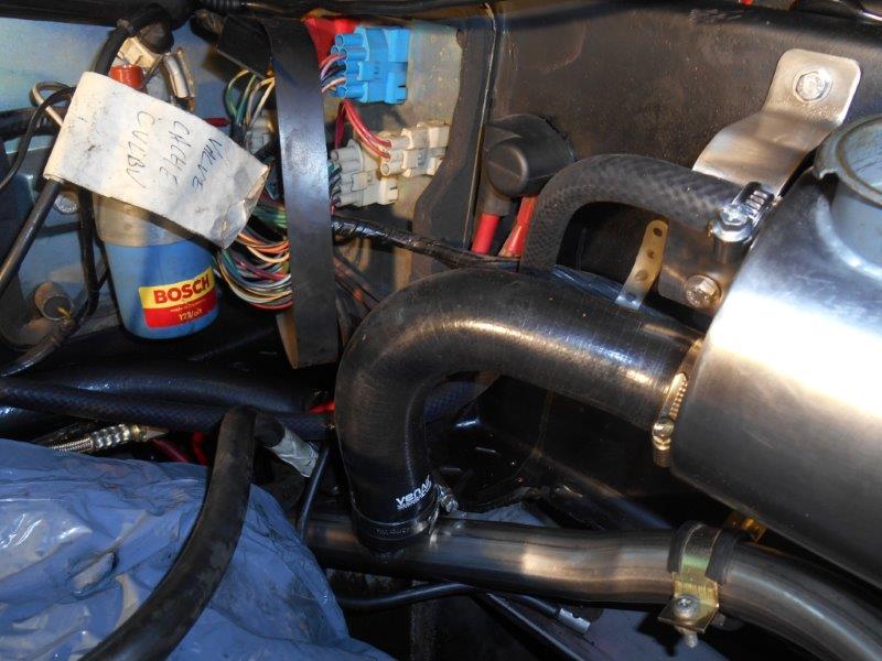

Coolant pipes, I had to cut the length of one of them because it was a little bit too long

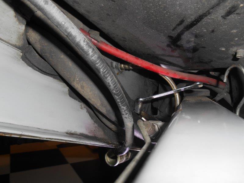

Removing the clutch pipe

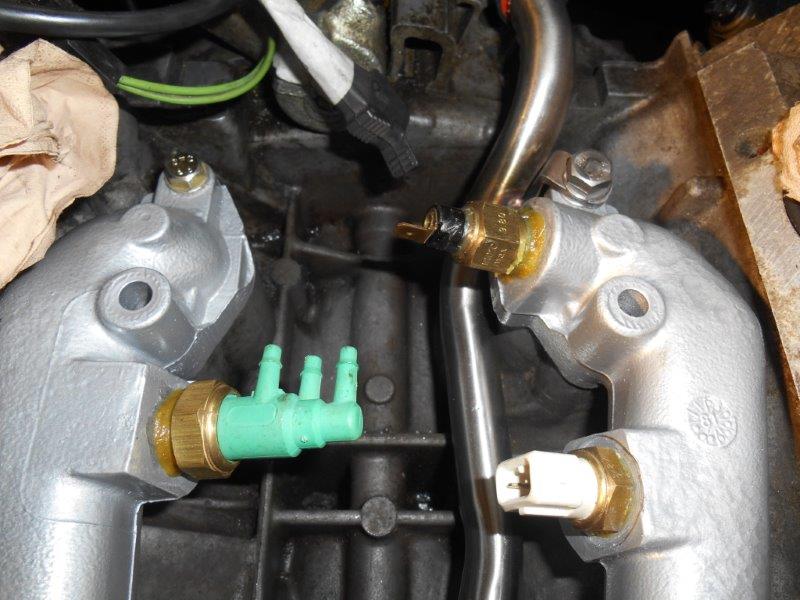

New sensor
New screws

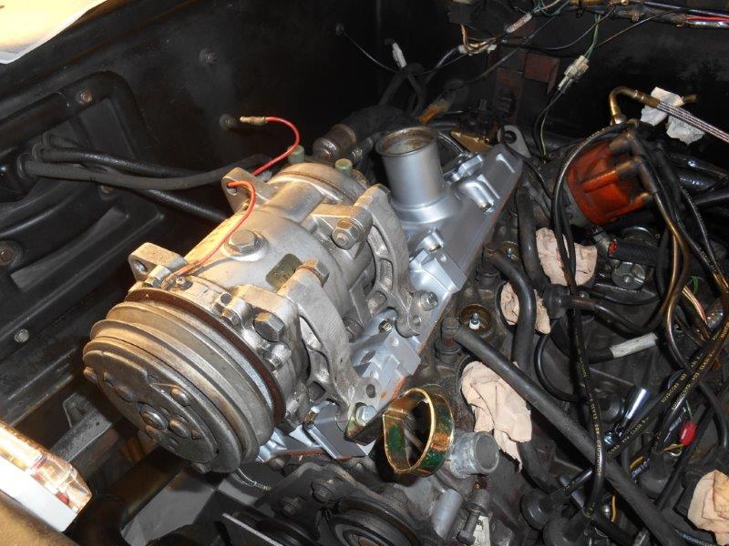

Valve covers are back in place with the AC

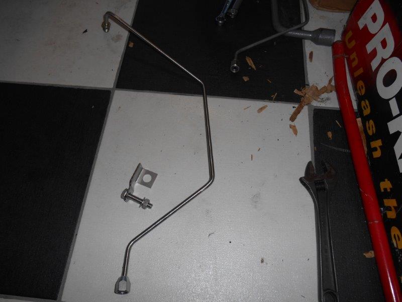

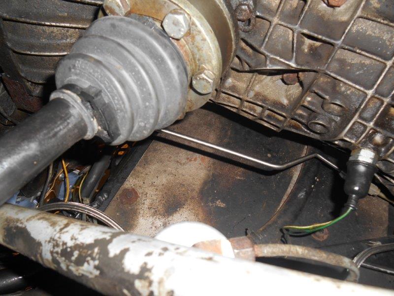

New stainless pipe with its bracket

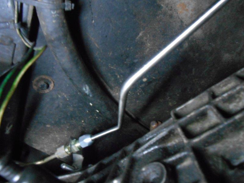

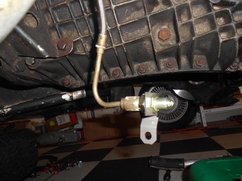

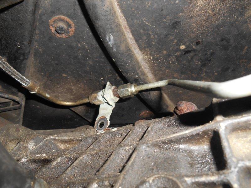

Postby Domi » Sun Jan 31, 2016 6:39 pm

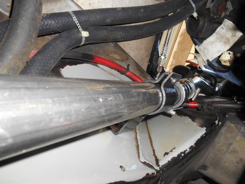

Stainless Clutch and bracket
Hot water valve with its new pipes
Posts: 1004

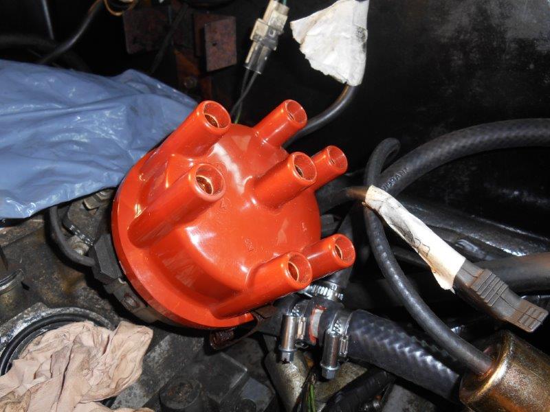

Postby Domi » Fri Feb 05, 2016 11:02 pm

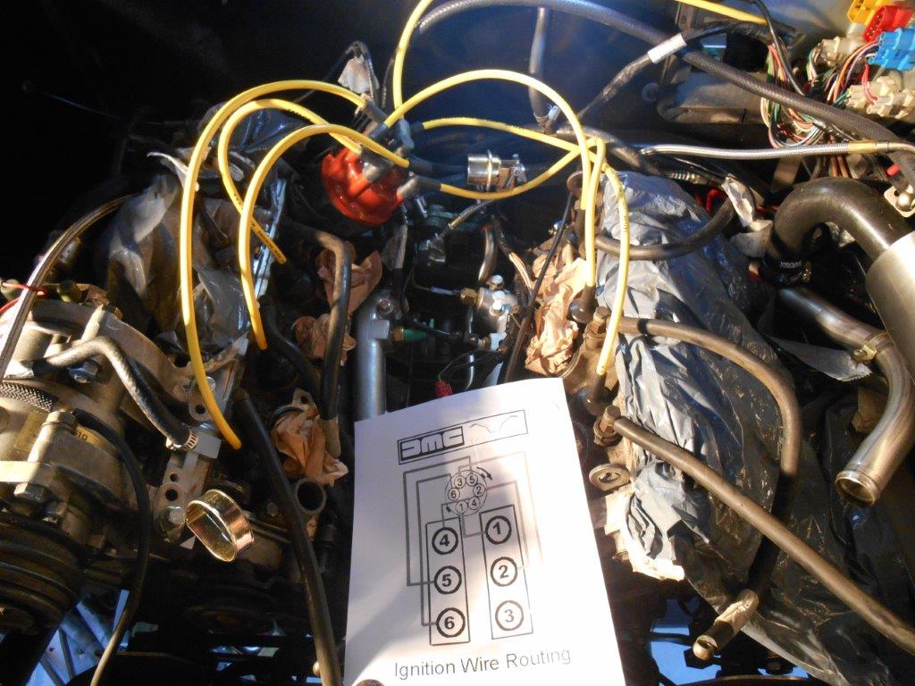

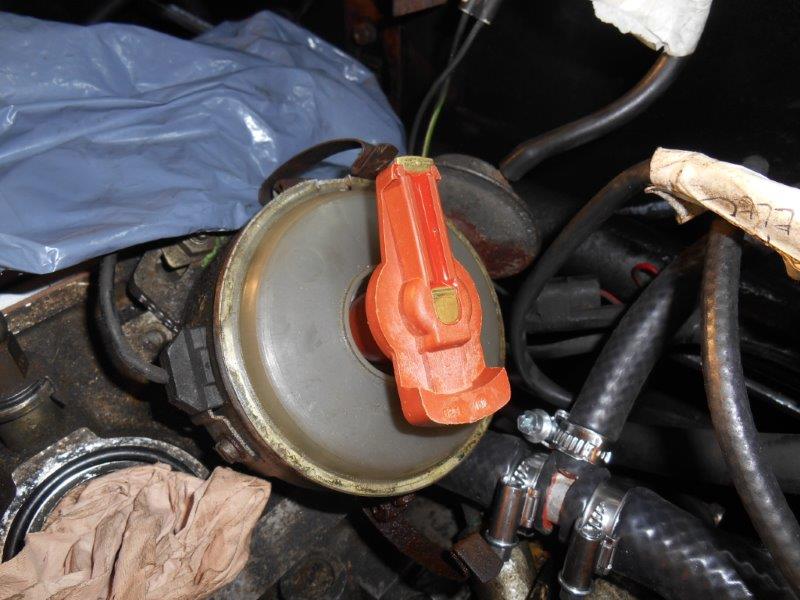

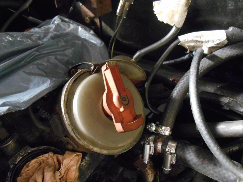

New rotor and cap

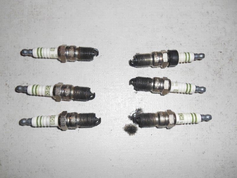

Old sparks

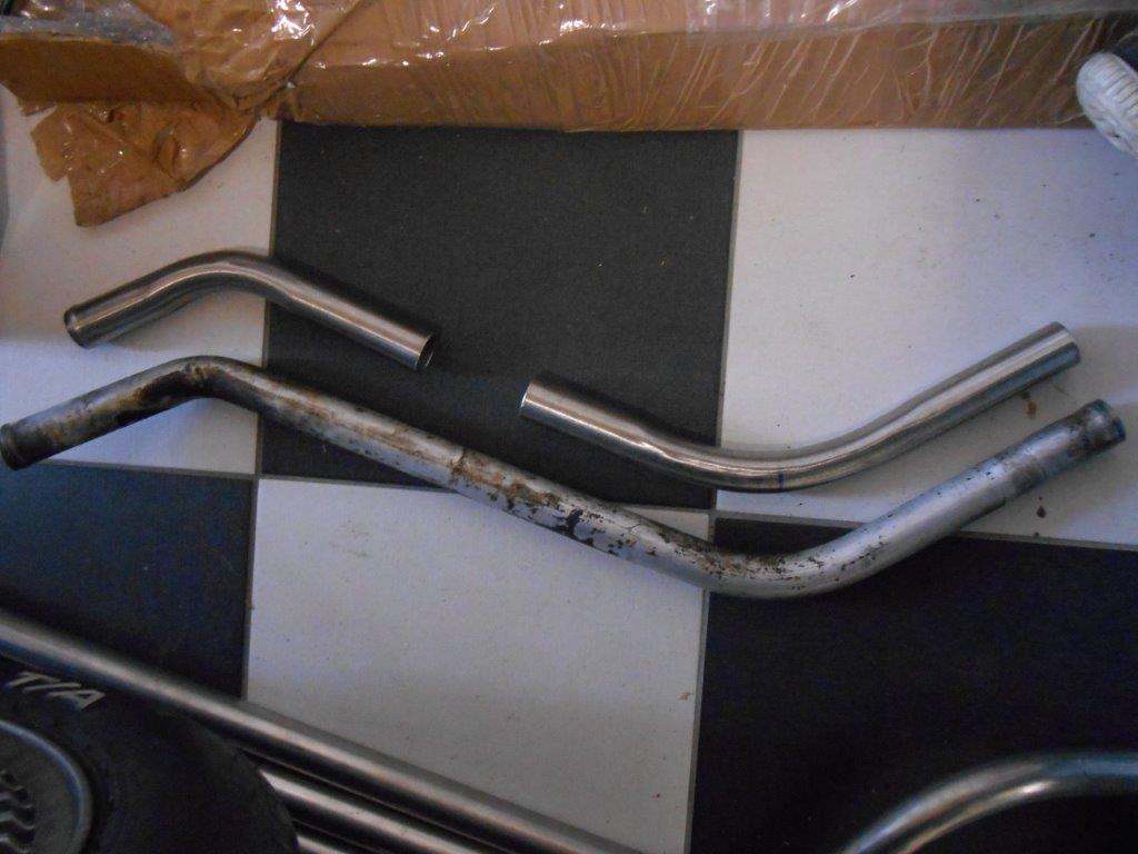

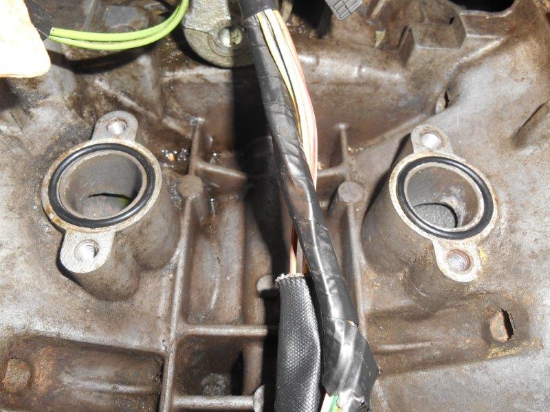

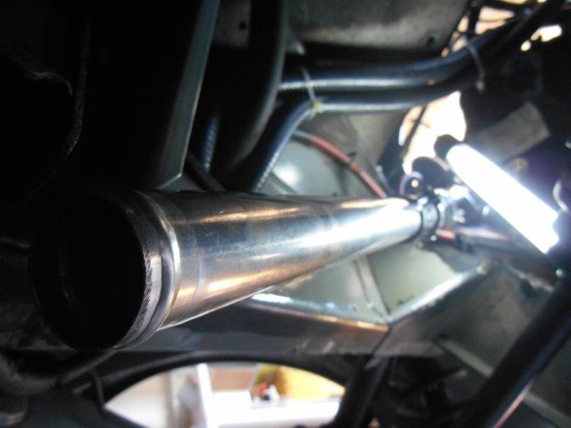

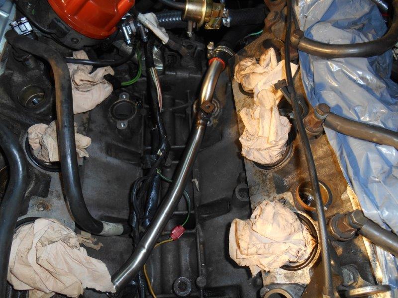

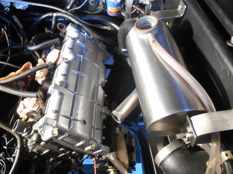

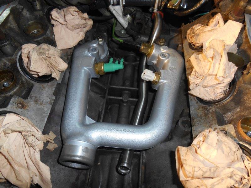

New stainless water pipe
New seals

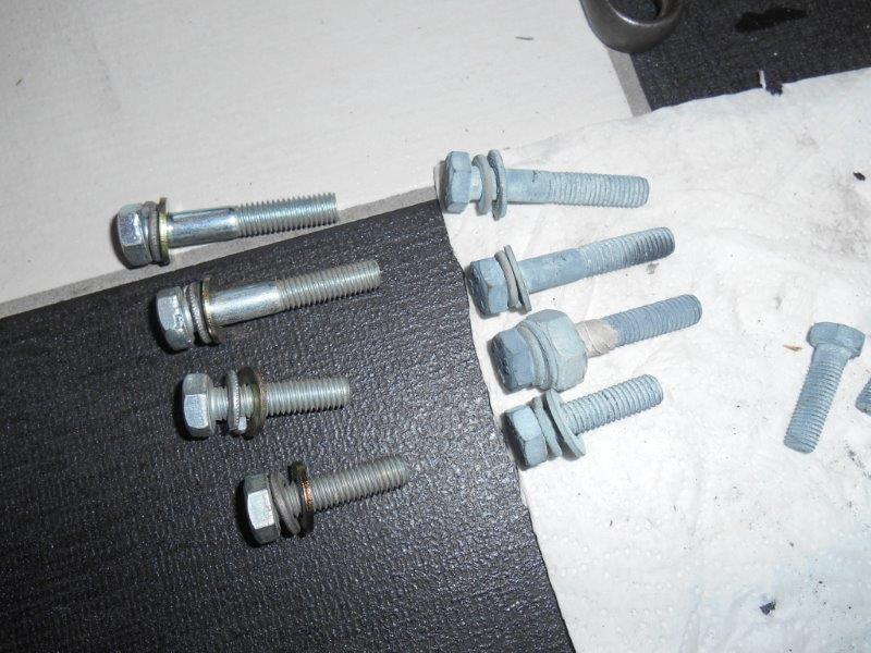

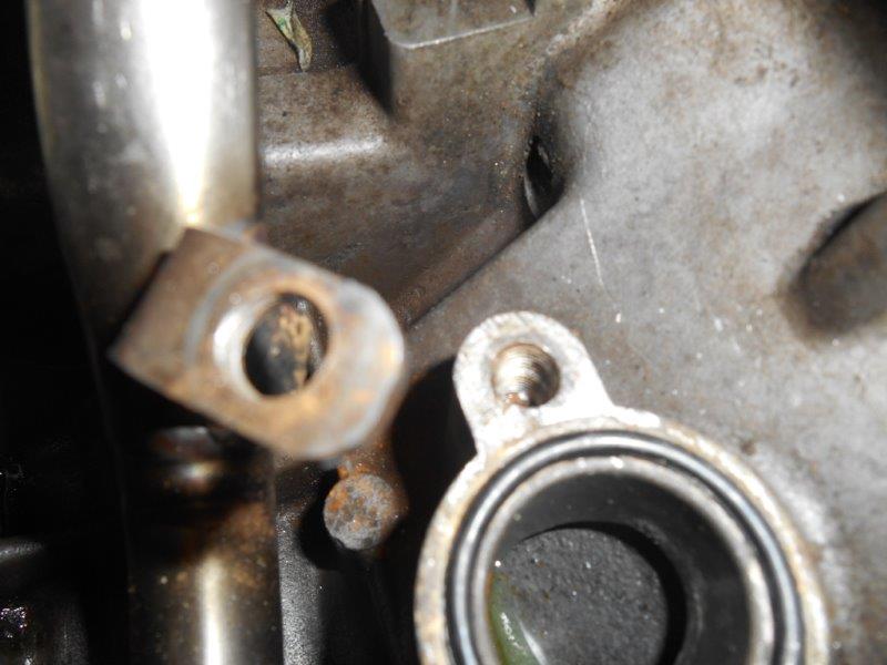

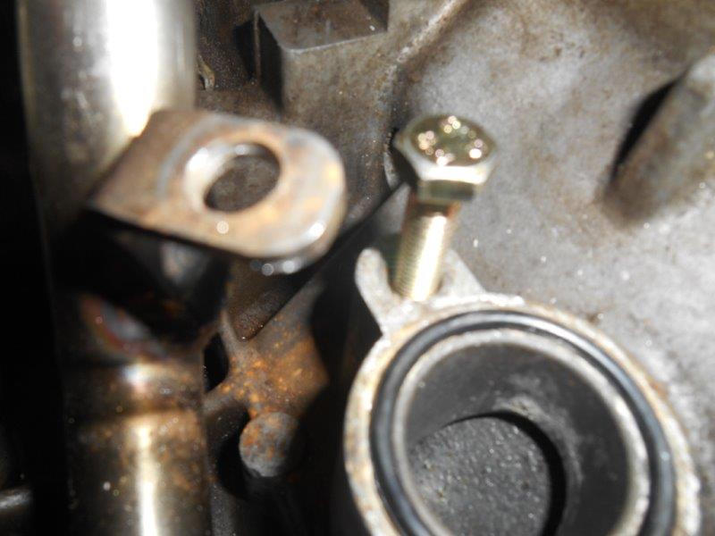

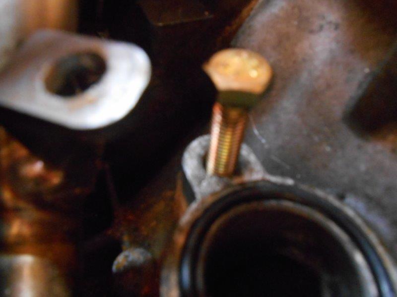

This parts doesn’t look good because the hole wasn’t correct for the screw, so I had to replace it with a bigger one
I have to find the two other screws somewhere

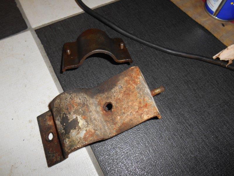

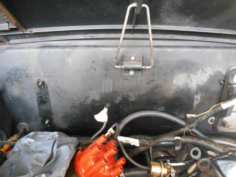

Postby Domi » Sat Feb 06, 2016 9:29 pm

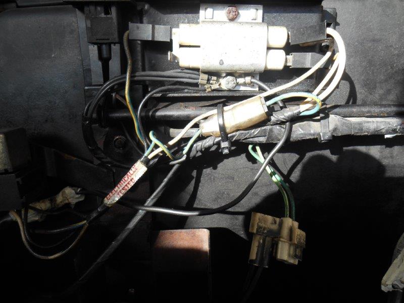

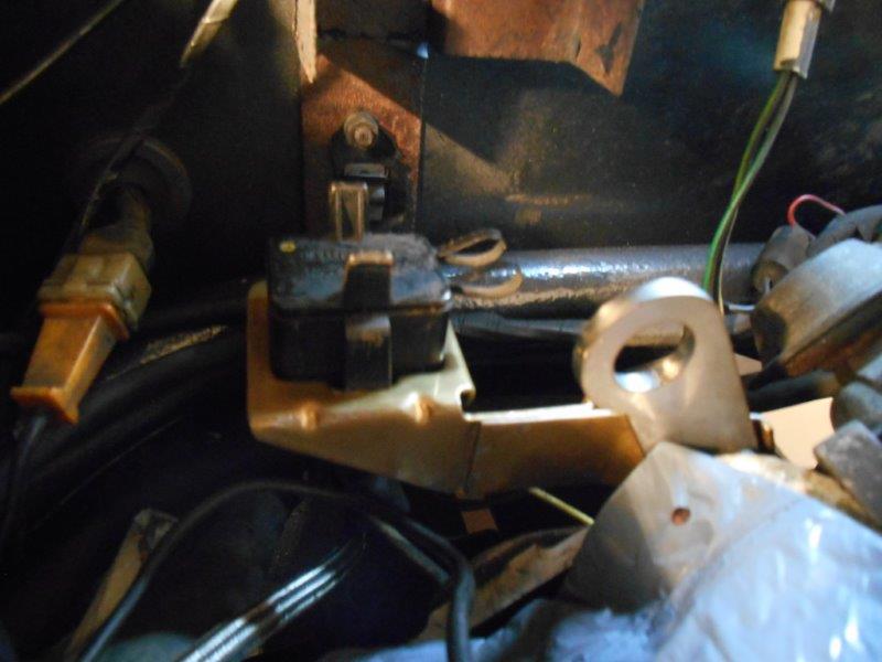

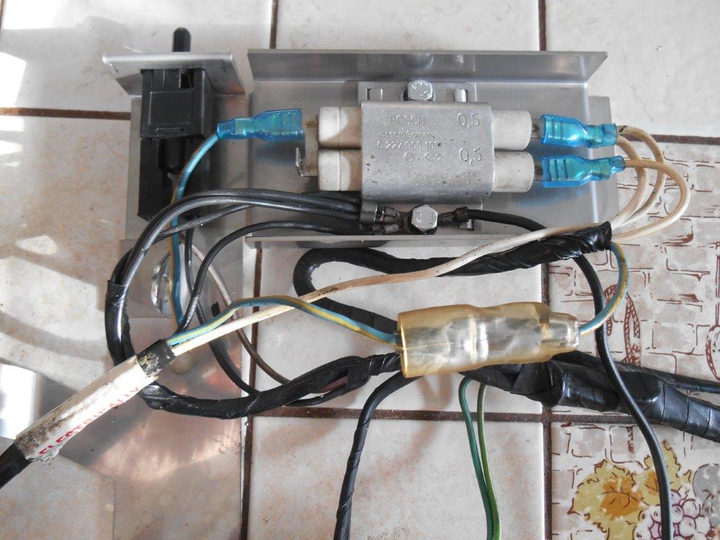

The bracket of the resistor is very rusted, so I need to remove it to change it

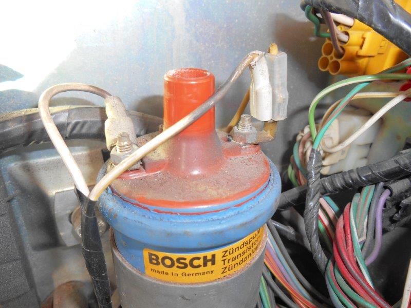

Does everyone remove the capacitor on the coil?

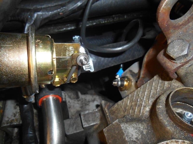

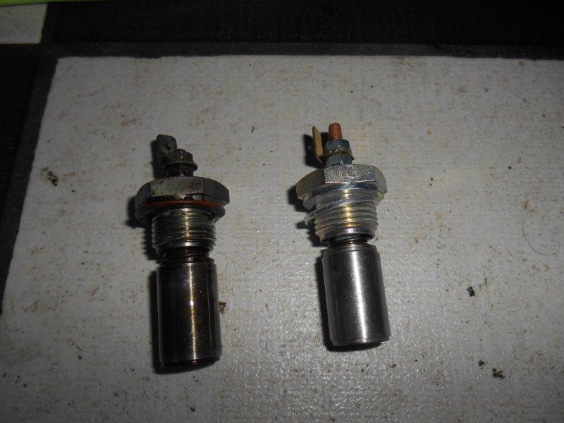

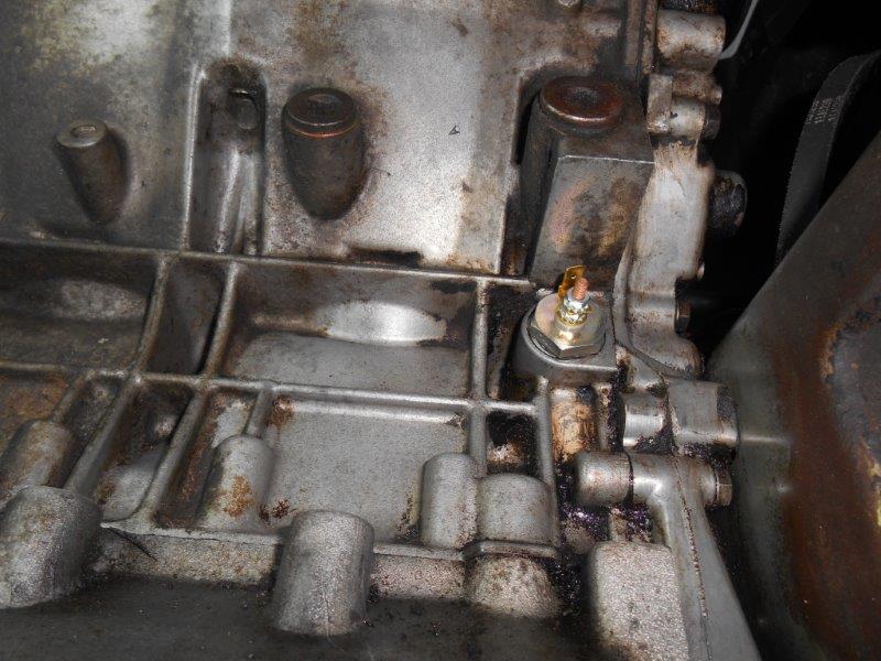

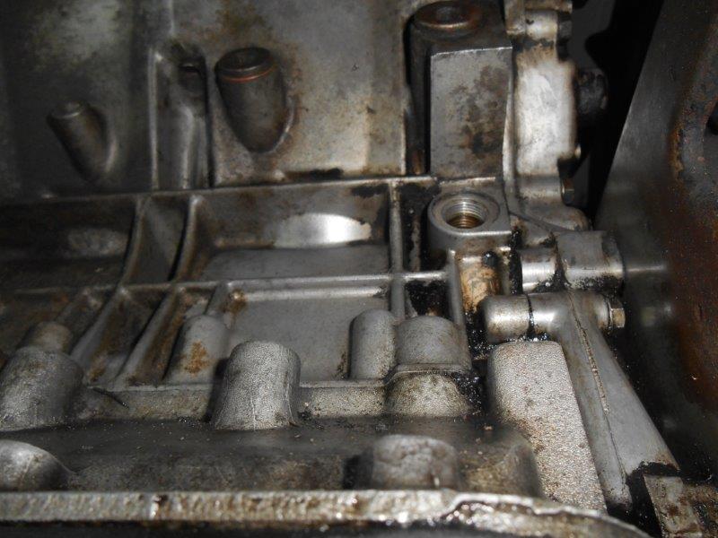

New sensor on the engine block

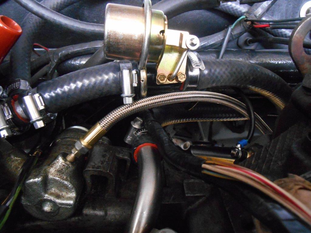

Postby Domi » Sat Feb 13, 2016 9:18 pm

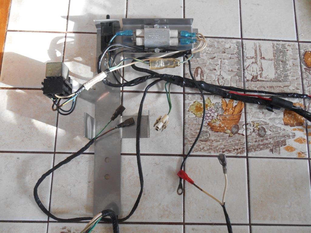

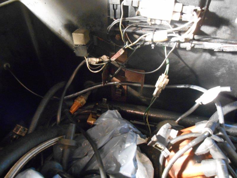

New connectors
Clutch Bleeder

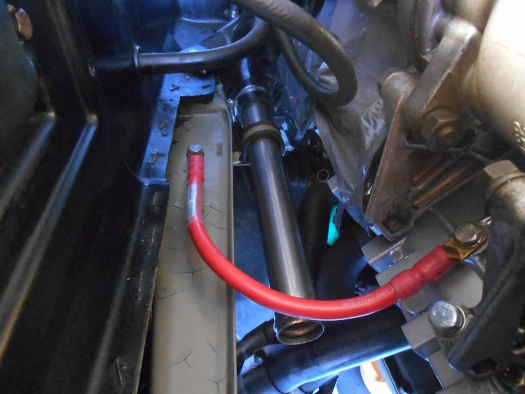

Looks like I have a problem with my stainless pipes water kit
New grounds wire
New spark plug wire
