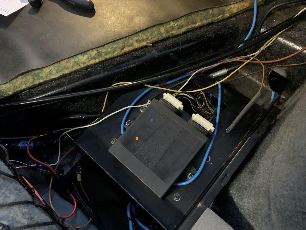

Postby Domi » Sat Mar 07, 2020 5:33 pm

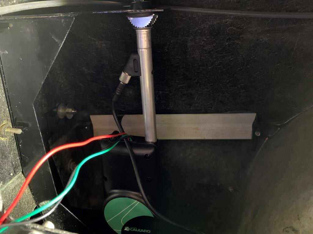

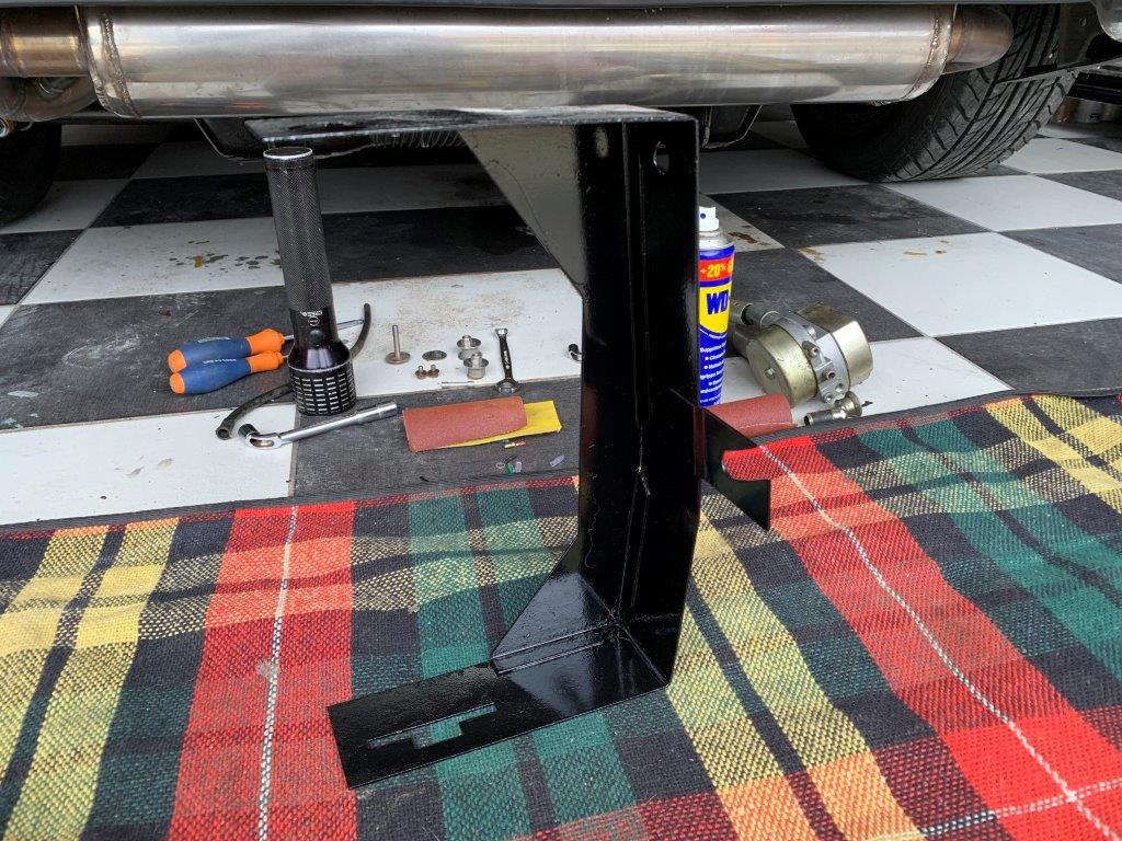

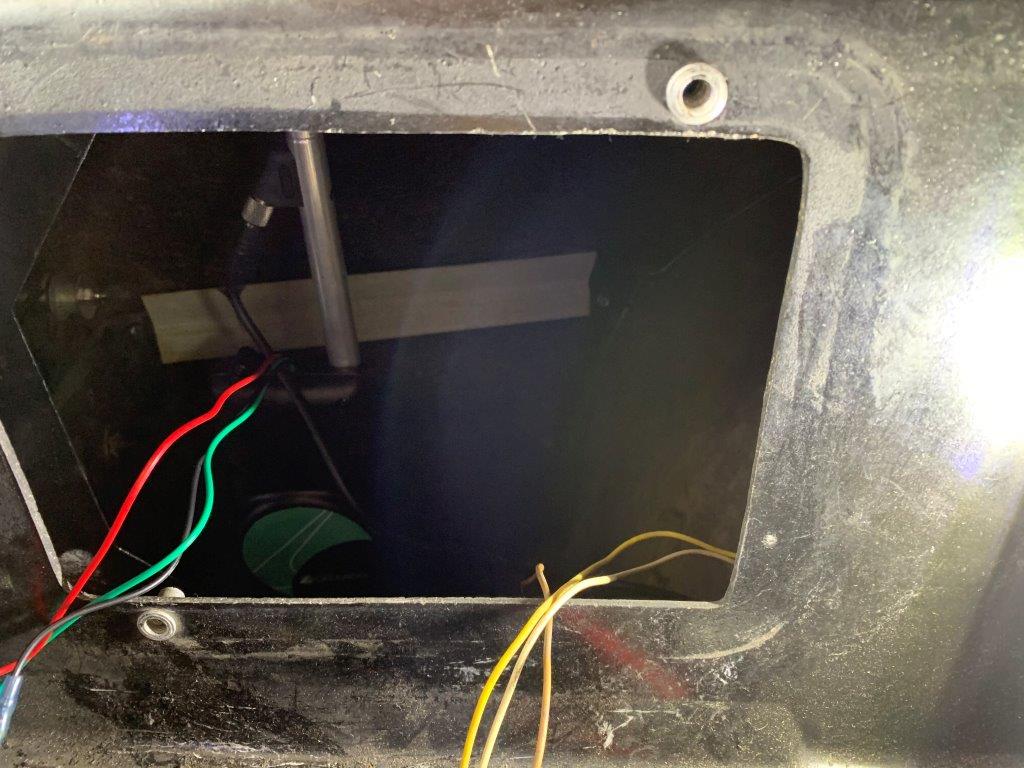

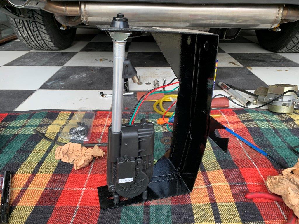

Installation of the antenna, it was necessary to modify the bottom of the support because the fixing and evacuation holes are not aligned.
Otherwise, for the moment impossible to make it work ...

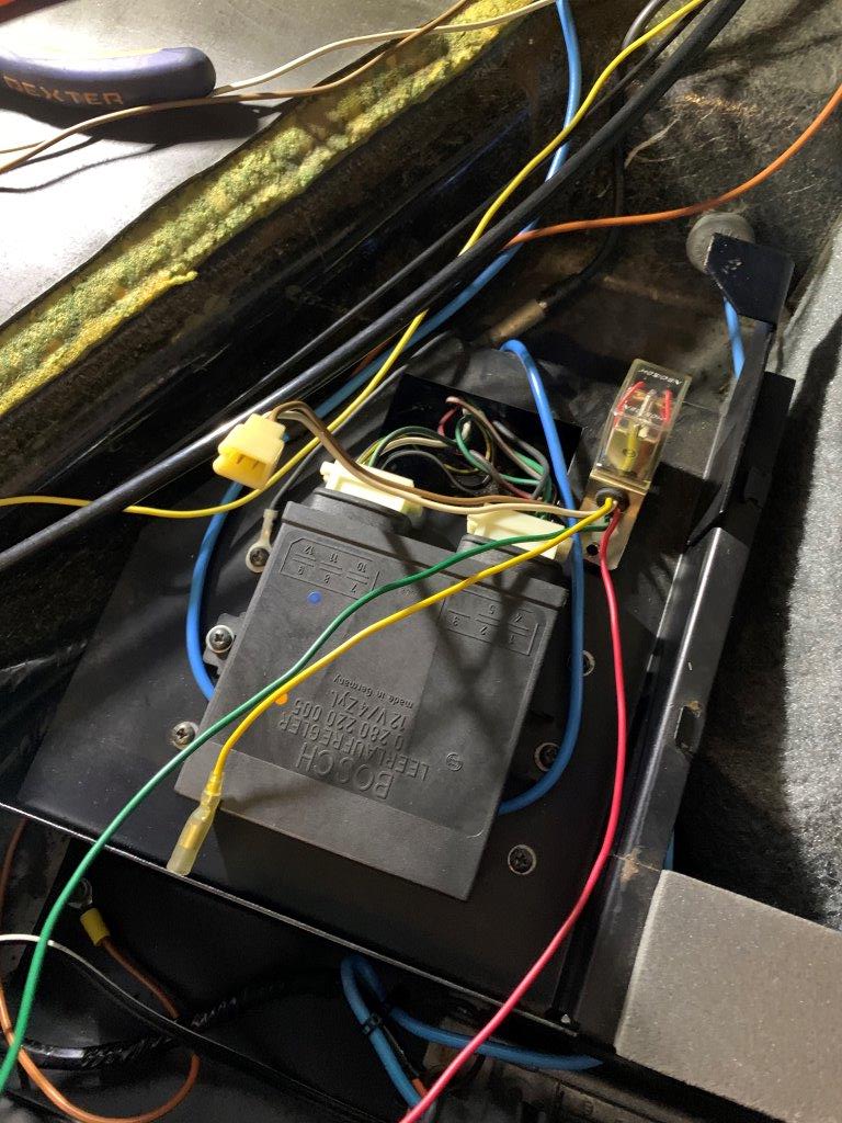

The polarities are reversed when the ignition is on, and when the station is on.
For example /
White: Once negative once a positive
Yellow: Once positive once a negative
Brown: positive after contact
In short, it is to go crazy...
Postby arranj » Sat Mar 07, 2020 6:14 pm
Have you bypassed the old relay....?
The new antenna has the relay built in, so the old one is redundant.
You only need two of the three cables running back into the car, the trigger wire and the positive feed. You pick up power for the antenna from the central locking circuit breaker. Earth is connected to the earth point on the rear wing.
http://deloreanblog.blogspot.com/2012/0 ... ement.html
Postby Domi » Sat Mar 07, 2020 6:36 pm
No I did not.
I thought it could work even if I kept the old one, I guess not.
Thank you for the link, I will do the modification tomorrow, and it should work.
Postby Domi » Sun Mar 08, 2020 6:29 pm
Power antenna is now working properly

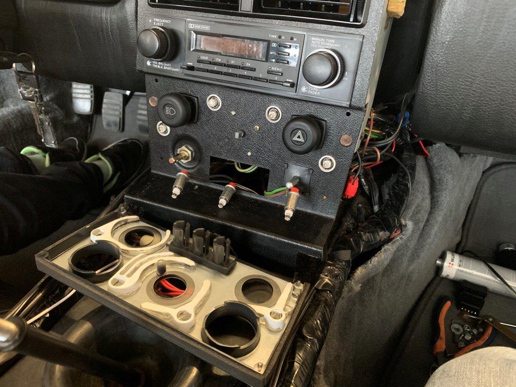

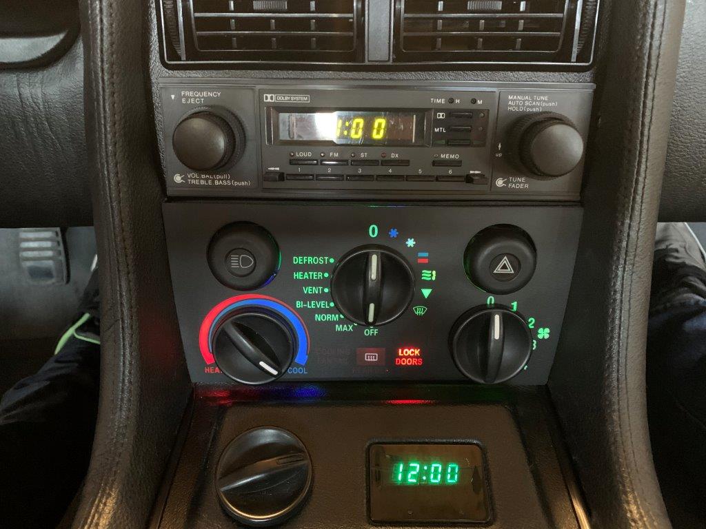

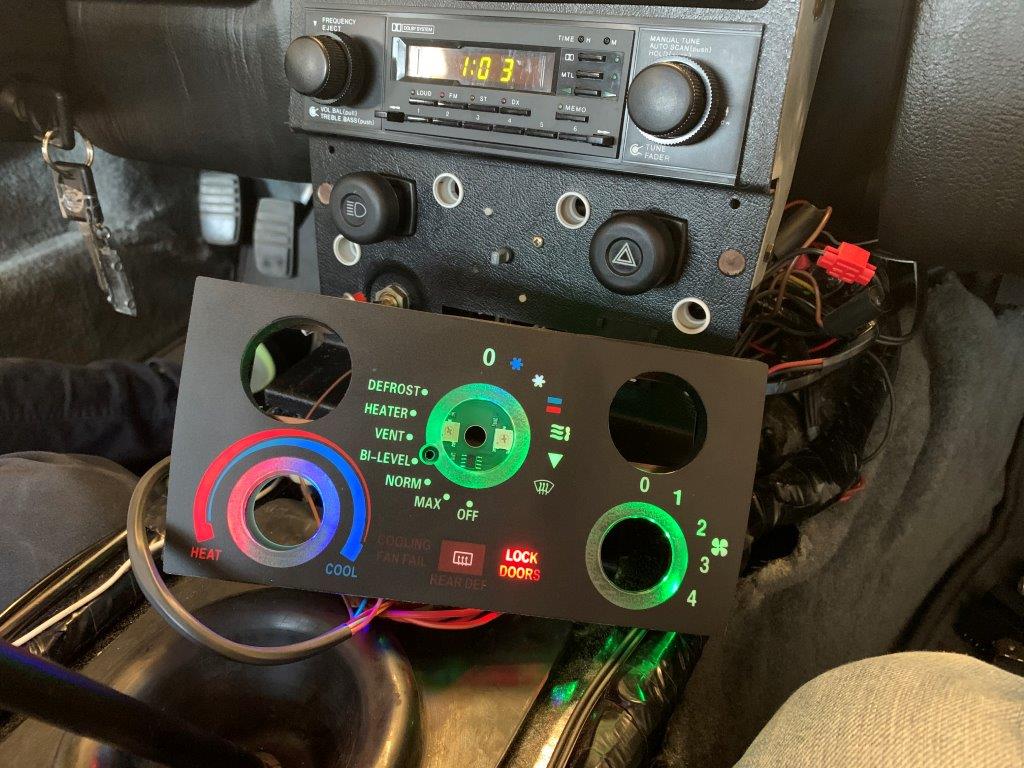

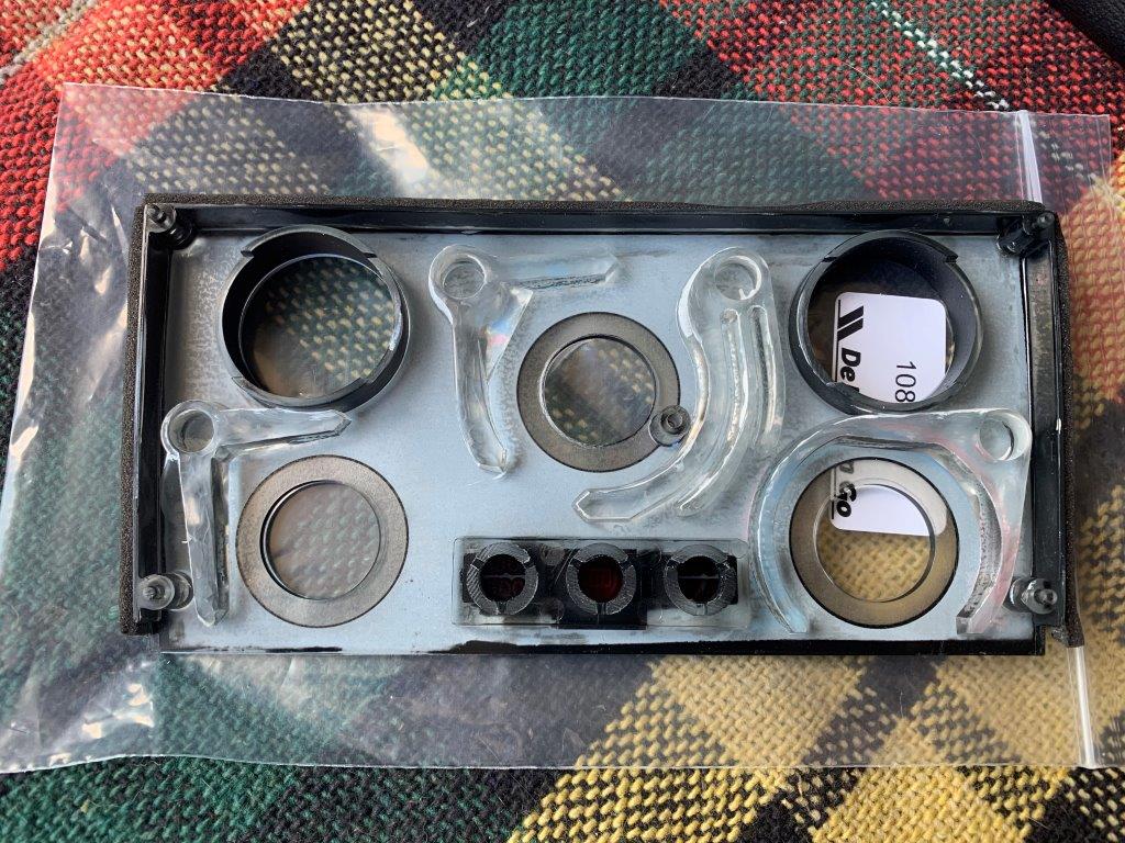

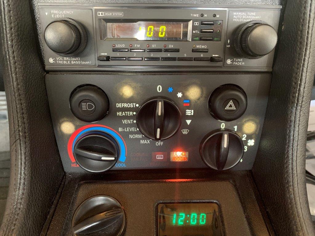

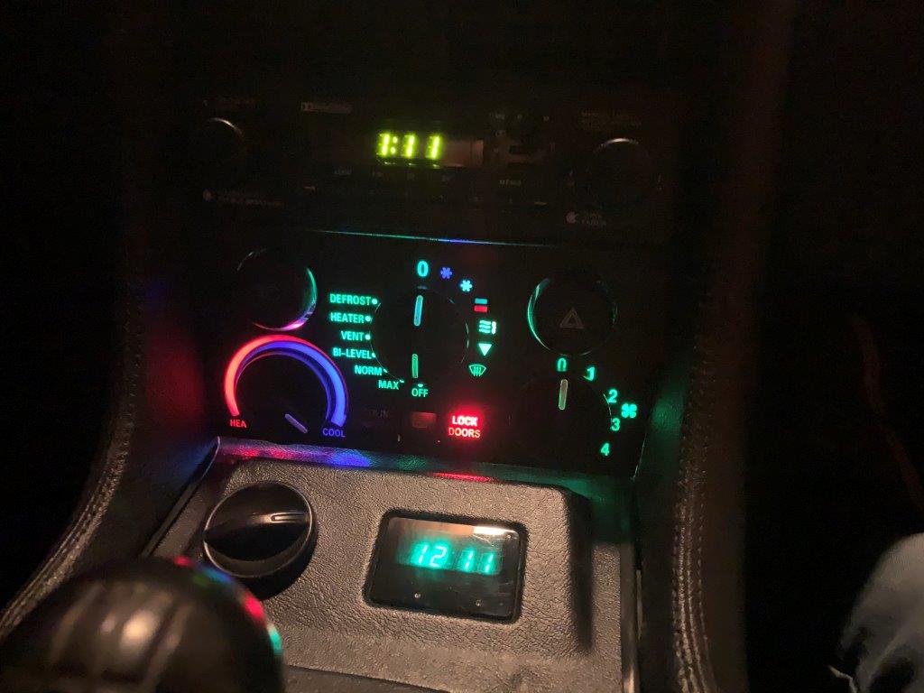

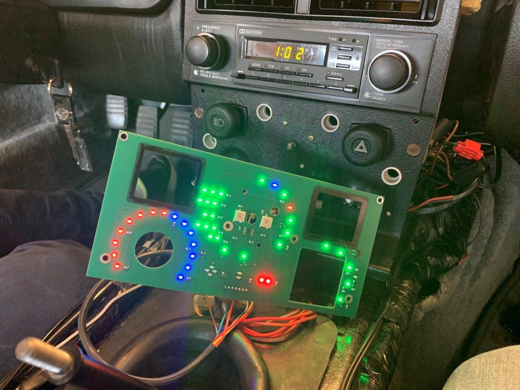

Postby Domi » Wed Apr 22, 2020 8:31 pm

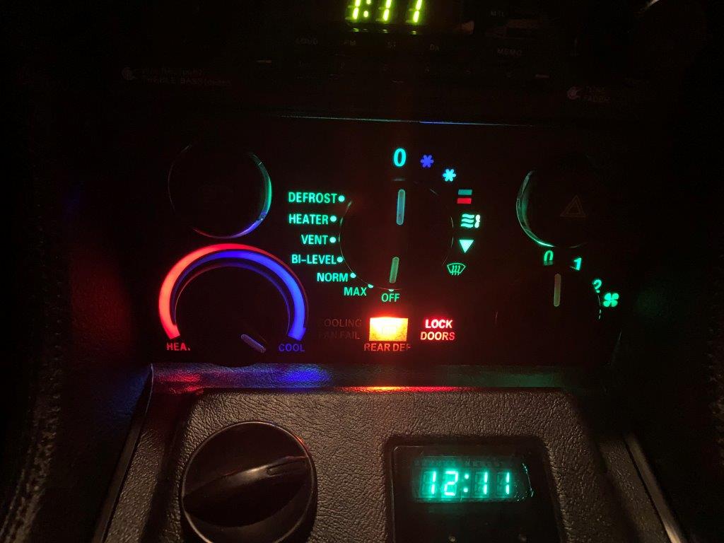

This afternoon I installed Dave Mc Keen’s Led board, and what can I say, it's simply amazing.
The result is absolutely beautiful. Before this, I, had white Leds behind the panel and the illumination wasn't nice enough.
Now, a few pictures to see it:
