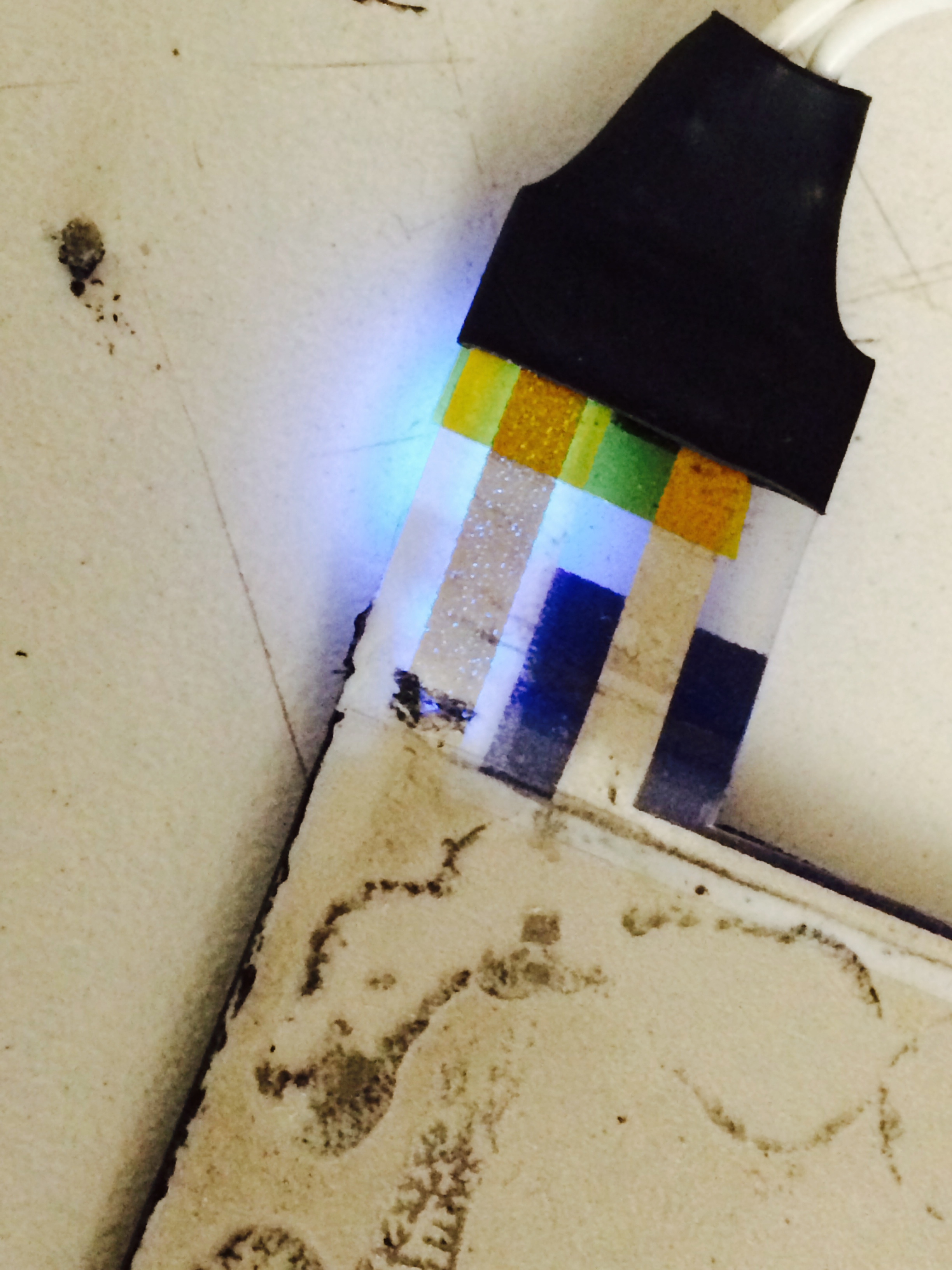

I have this custom gauge lighting, called ElGlo or Indiglo or whatever from SpeetHut. EL sheet is a plastic sheet that lights up if you put 12V AC on it. It does not get warm and takes very little Amps. And it looks cool.
Today I broke the panel connector. It is fucked. The panel is internally damaged and doesn't work any more. EL sheet is non-reparable. Even worse is that the glue underneath basically wrecked up the original instruments. And of course, SpeedHut stopped making these for the DeLorean about 2 years ago. So I have 4 options:
- repair the gauge fronts. Close to impossible for me.
- repair the EL sheet, needs investigating.
- replace the gauge with new originals. $$$$$$$ = no.
- let it be.
Clearly option 2 is the way to go. I decided to buy new panels from EBay. I can separate the SpeedHut silkscreen pretty easily from the EL panel and cut the new ones to size. For $20 I have order on A5 sheet of blue EL that is more than sufficient for my broken panel. This leaves me some stuff for experimenting or other fuck-up's.

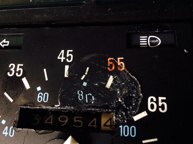

Postby RobvdVeer » Sun Jun 15, 2014 10:27 pm
This is what a bit of glue did to my gauges. Not for the fainthearted!

RobvdVeer wrote:This is what a bit of glue did to my gauges. Not for the fainthearted!
Oh crap!! :doh:
What was the glue doing in there????
What's your plan?
Postby RobvdVeer » Mon Jun 16, 2014 4:46 pm
The EL sheet didn't stick with the 2-sided tape. So I used some non-corrosive child-safe edible gluten-free non-toxic ph-neutral adhesive to stick it down. Stupid mistake I made 8 years ago.
Postby ALEXAKOS » Mon Jun 16, 2014 7:14 pm
RobvdVeer wrote: So I used some non-corrosive child-safe edible gluten-free non-toxic ph-neutral adhesive
Well it didn't say gauge safe did it? :doh:
Postby RobvdVeer » Mon Jun 16, 2014 7:23 pm
I can't help that the car is made of sugar. It wasn't stated in the manual.
