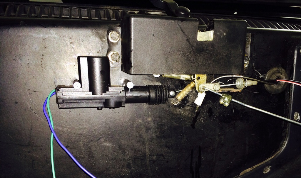

Postby RobvdVeer » Sun Jun 29, 2014 4:33 pm
time for a picture. Here's the actuator installed for the trunk release. Wiring needs to be cleaned up, and i need to trim off the actuator rod. The lock had two springs installed but i noticed that was a bit too much for the actuator, so i took one off. now it works brilliantly.
Postby andyd » Sun Jun 29, 2014 9:25 pm
Nice touch rob,
Are you also rigging up an emergency cable for the moment when the gods snigger at us, and your cable snaps and the battery's flat? :dmcdoors: :doh:
A
Postby RobvdVeer » Sun Jun 29, 2014 10:03 pm
you see the backup cable in the pic, that'll go when it's all finished. no need for two backups. The 2nd spring has to go as well. For the wires i'll use proper crimp and connectors (it is twisted and taped right now) so it'll be pretty later on.
Postby ALEXAKOS » Mon Jun 30, 2014 4:59 pm
exactly my intention as well. Have got a spare actuator and was thinking of that. How did you mount the actuator on the fiberglass? What did you use to keep the screws tight?
Postby RobvdVeer » Mon Jun 30, 2014 5:03 pm
i drilled a hole and put a parker in. pretty obvious.
