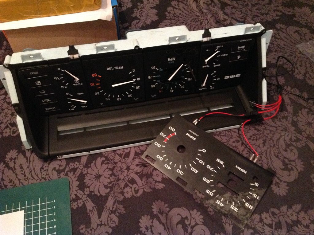

Yes! My EL-sheets have arrived. This means I can repair the damages to my ElGlo gauges overlay and finish up the binnacle. Last week I already received the LED's from SuperBrightLeds.com.
And all will be good.
Postby RobvdVeer » Thu Jul 03, 2014 7:28 pm
Exchanged the dashboard bulbs with leds from superbright. wow what a difference.

Postby RobvdVeer » Thu Jul 03, 2014 8:34 pm
this is the best i can do right now.

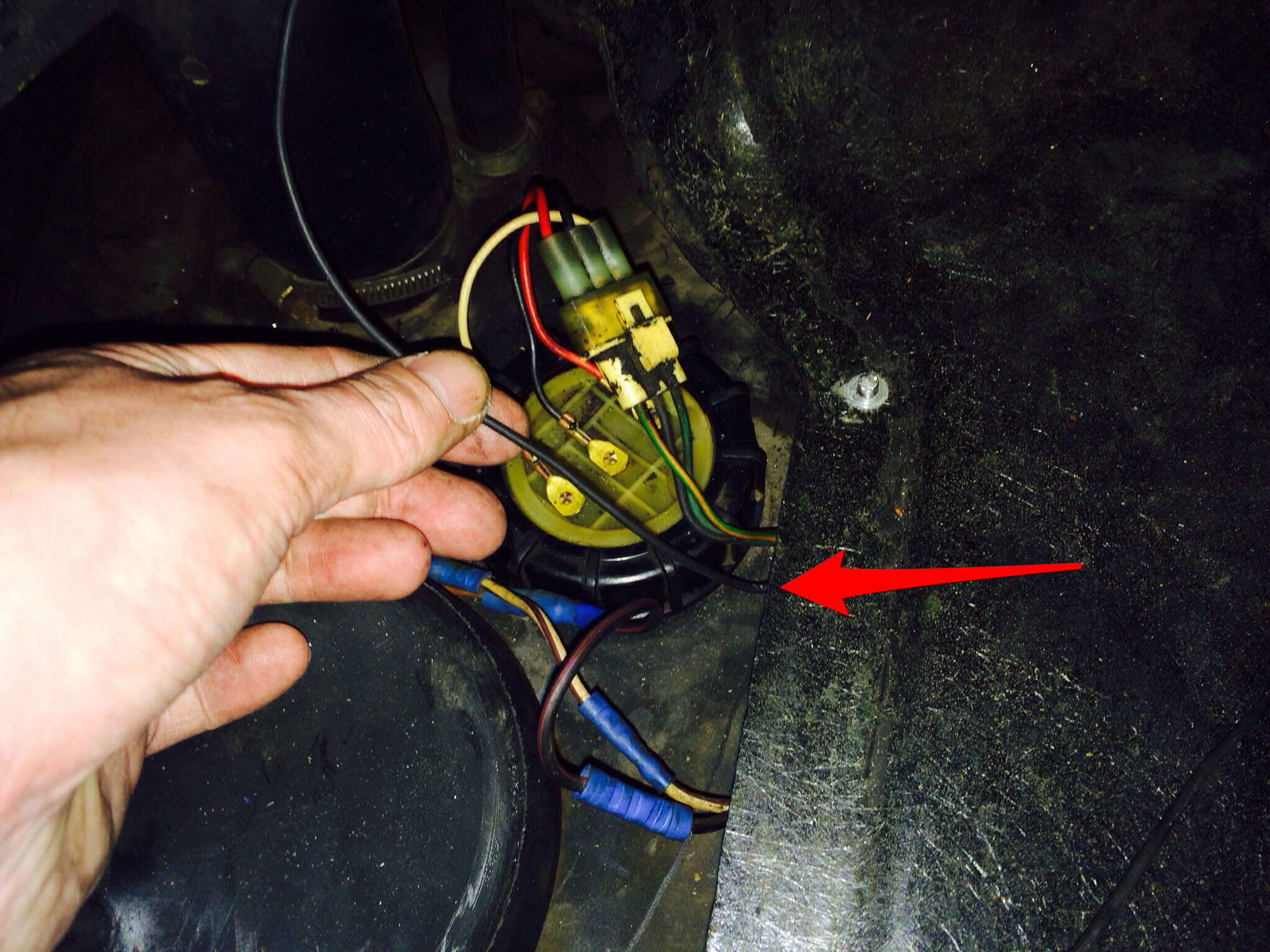

what does this wire do? it's a surplus black wire with a ring terminal (supposed to be screwed somewhere) about 70cm starting from the loom near the fuel pump. it's not on the wiring diagram.
Postby Admin-bloke » Sun Jul 06, 2014 6:09 pm
Have you tried doing a continuity test with a multimeter to the battery negative terminal to see if it's an additional earth wire?
Postby RobvdVeer » Sun Jul 06, 2014 6:13 pm
yes, it is an earth wire, but what is it doing there? from the looks of it (and the feels) it is part of the original loom (unless PO rewrapped it, which is unlikely seeing the fuckups of other mods).
Postby Dan 6511 » Sun Jul 06, 2014 10:26 pm
I think it should be connected to the fuel filler neck to ground it.

Postby RobvdVeer » Sun Jul 06, 2014 10:29 pm
Ah, that sounds plausible
