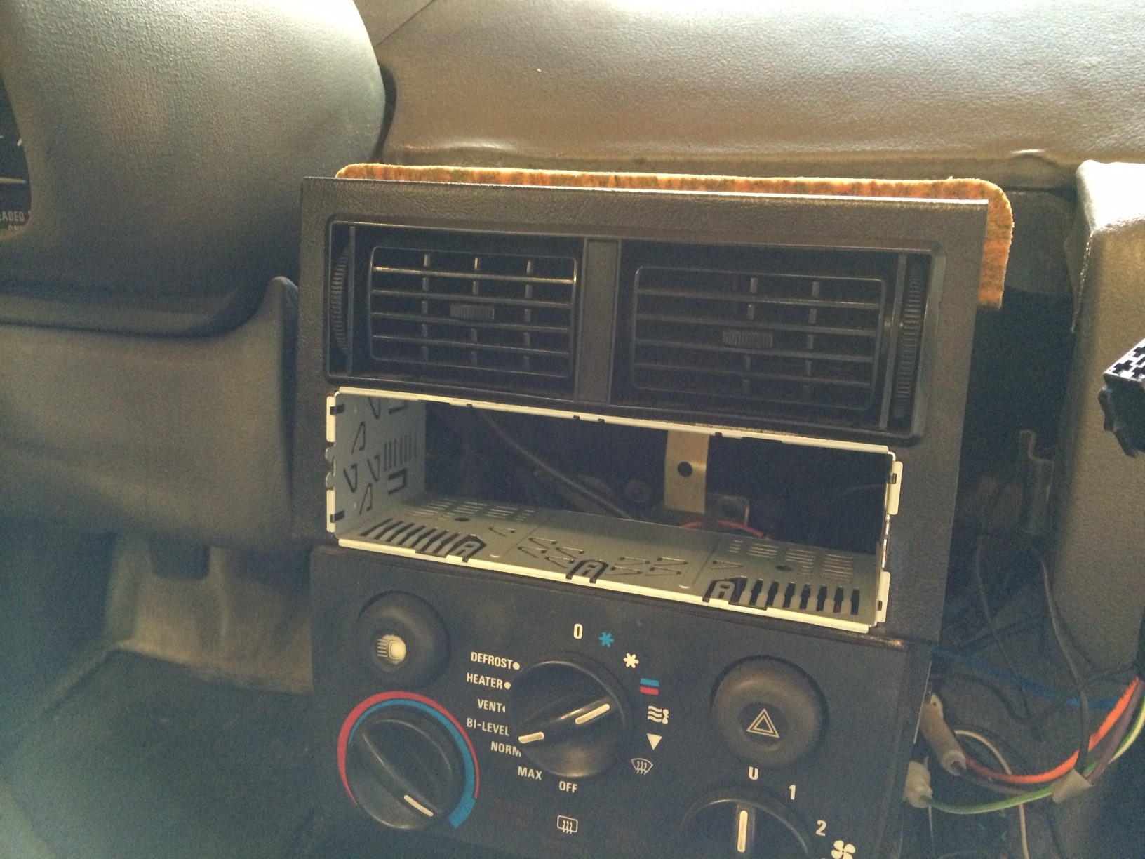

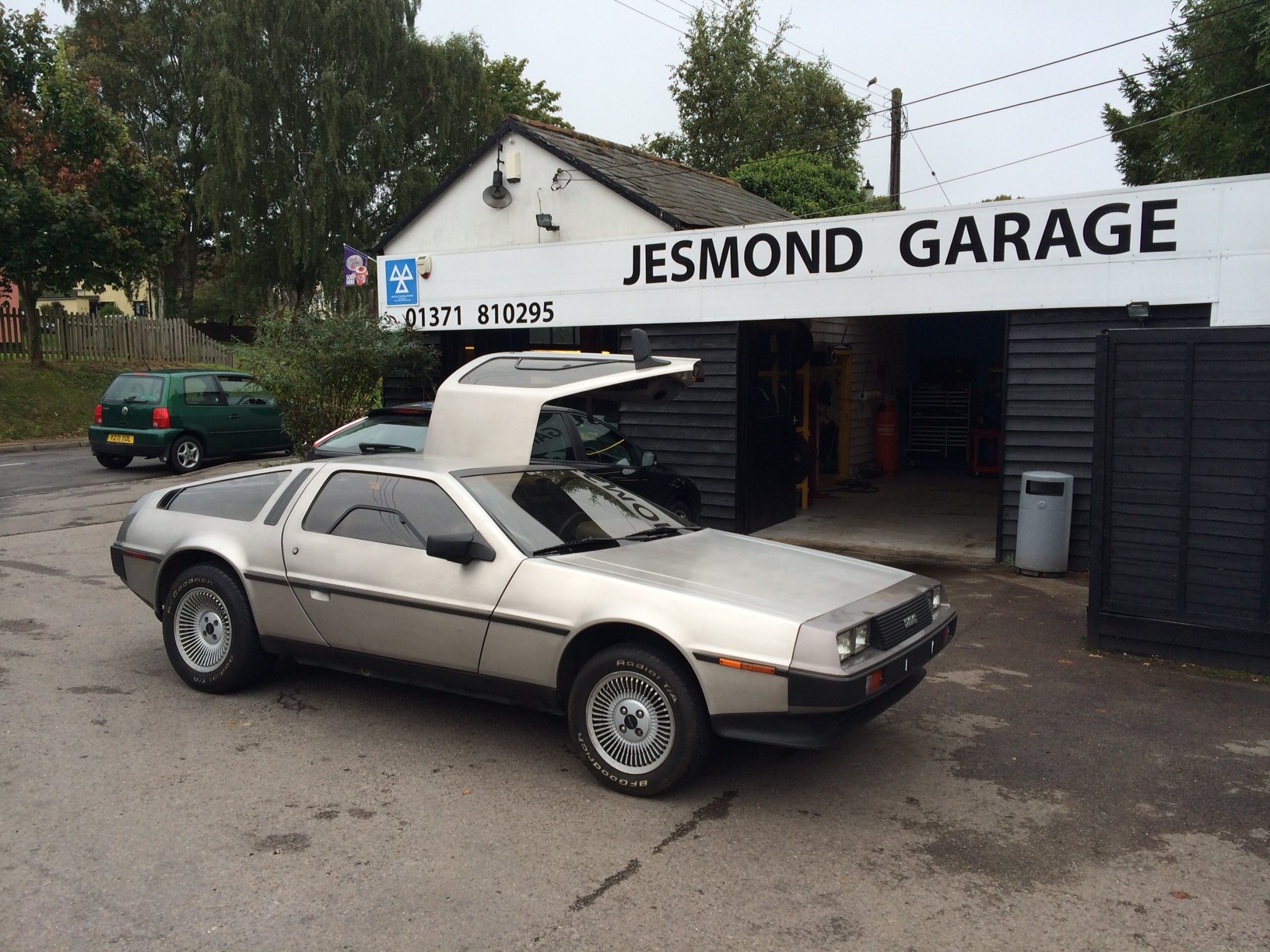

Since my last post I have rebuild all 4 brake calipers with new pistons and seals. Replaced all the flexi brake pipes with Julian's set. Re-fitted the calipers with all new pads. I finally got round to getting it MOT'd at the weekend, and now it can be registered at last. The plan is to register from the 1st Oct so it should be coming along to the Norfolk meet :D It still needs an accumulator as its a right bastard to start at the moment, both hot and cold which is odd though...
I also cut out the center console to fit a standard radio instead of the old spindle mount type.
