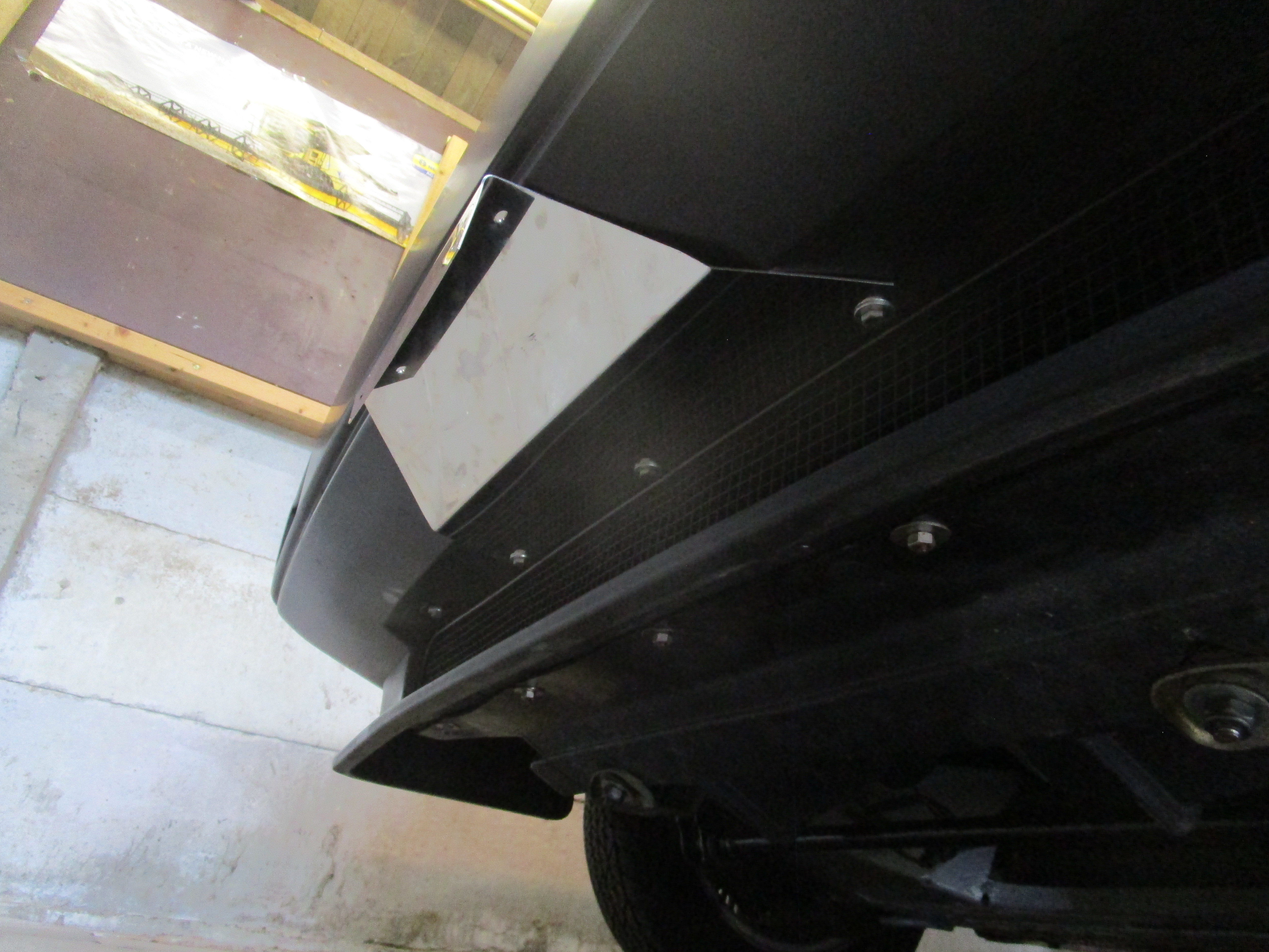

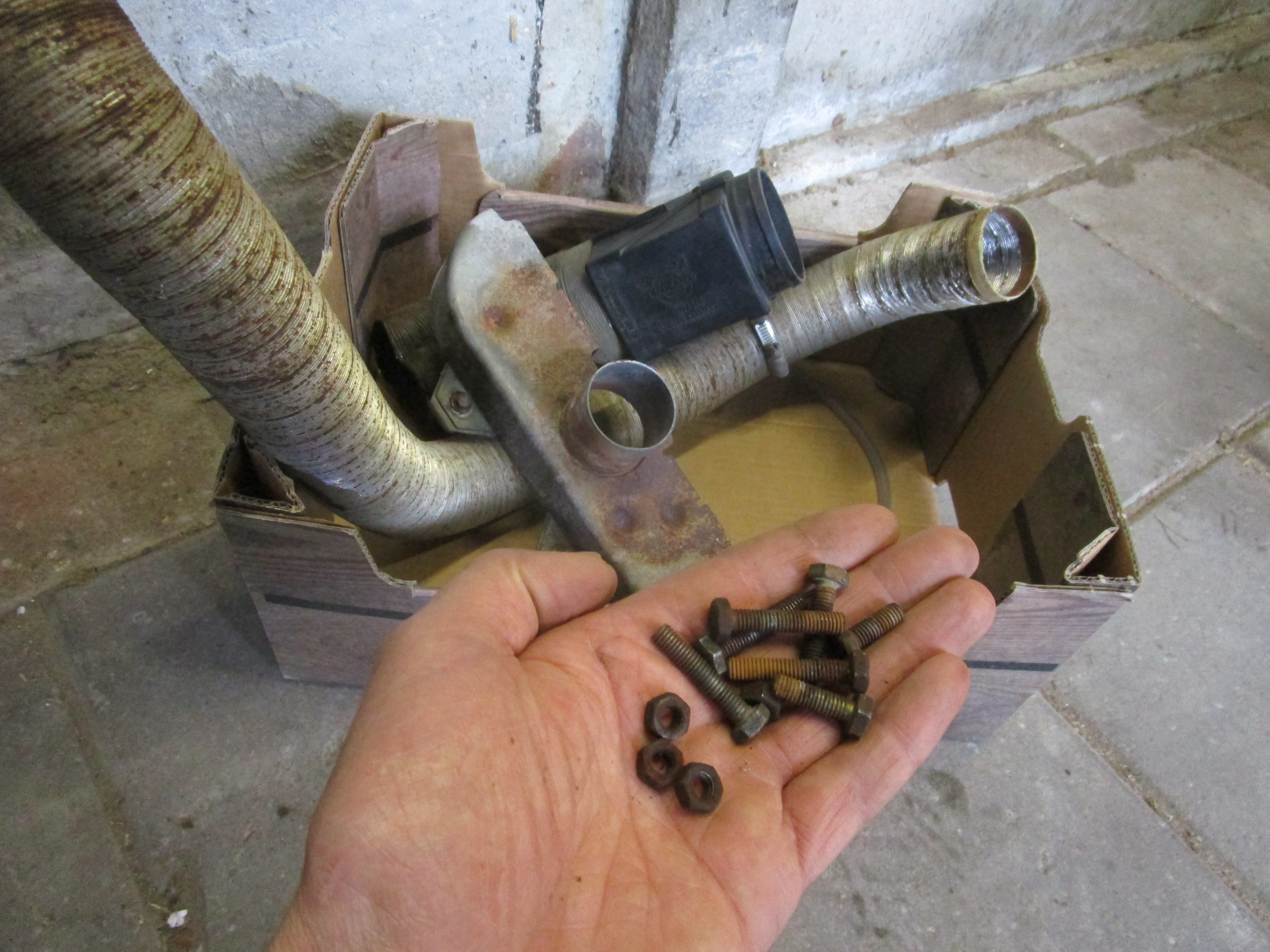

Got the stainless bracket from the club and it is on the car now. The old bolts from the rock screen where rusted, to long and hard to get out. The nuts where very rusted but nothing broke and i was able to clean the threads on the rock screen bolts. Painted the rock screen and put everything back together with copper paste and stainless bolts and nuts.
Cleaned the engine bay and removed the stove from the manifold and installed a cold air intake.

Stove and old rockscreen bolts
New bracket

Postby Domi » Thu Jul 28, 2016 2:00 pm
Polished stainless bracket, looks awesome :thumbsup:
Re: Vin 5823 arrived in The Netherlands today.
Postby Delta Delorean » Sat Jul 30, 2016 11:58 am
Yes Domi, to bad you have to lay down on the ground to appreciate it!

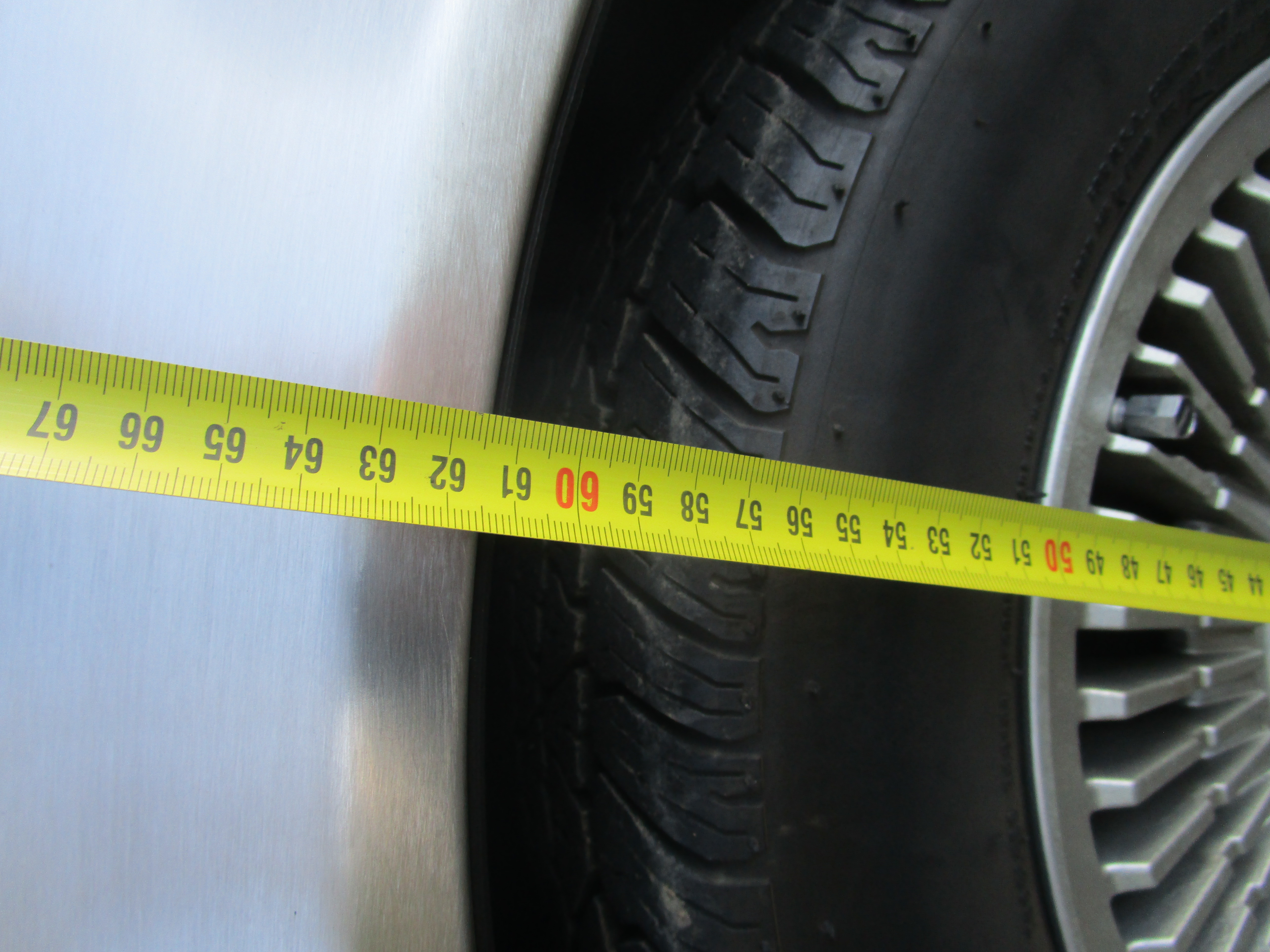

Front: 61 1/2 cm to top of wheel arch

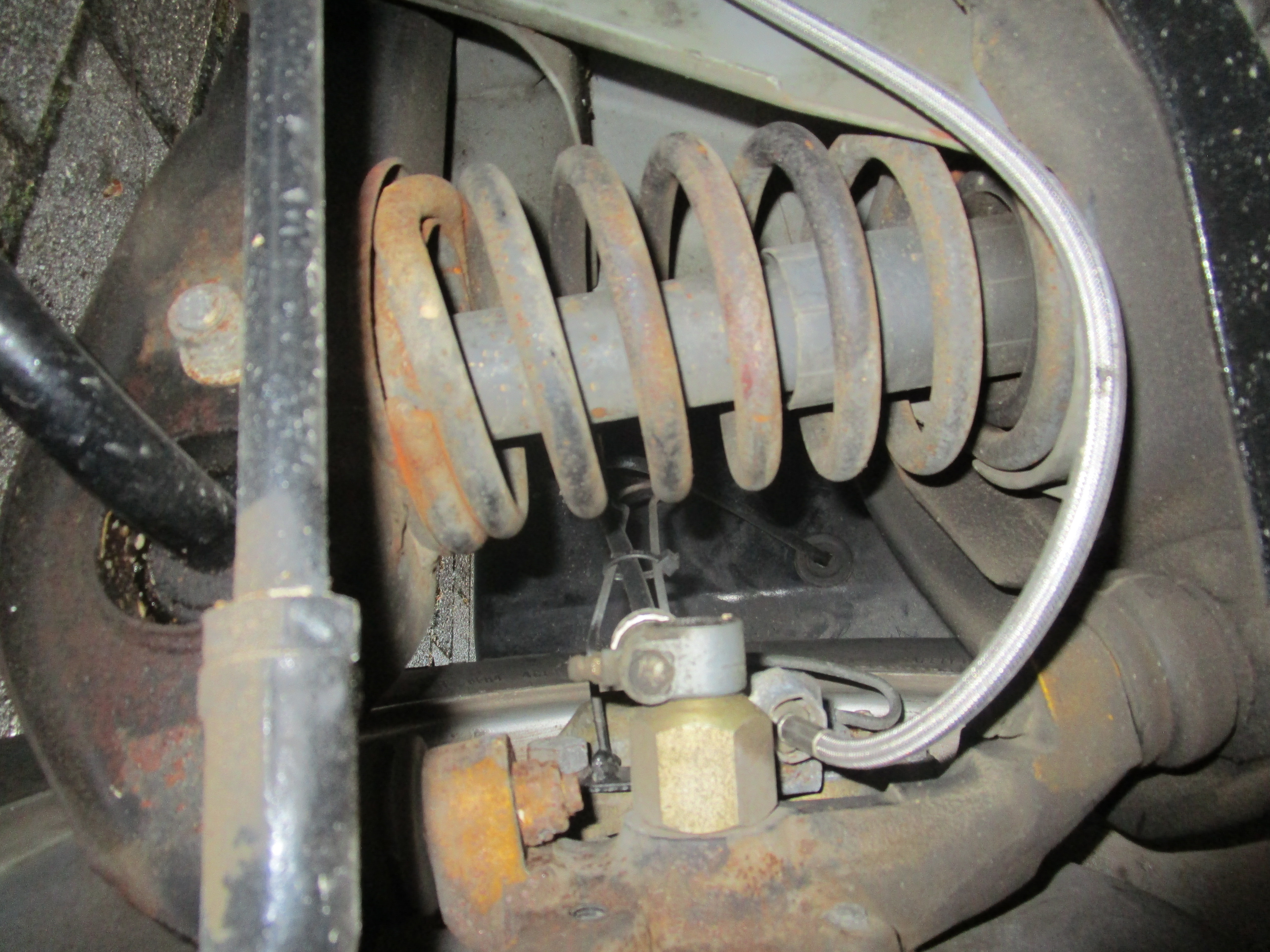

Took the D for a 100 mile trip yesterday. Runs good. I do keep adding things to the list that I want to take care of this winter. I did a lot of reading on the forum today but I can not find what the distance to the top of the wheel arch would be if you have the front springs from Ed. My car it is 61 1/2 cm. Who has Ed springs and what is the distance? Don't want to buy them and then find out they are also around 61 cm.
Who can indentify my front springs? I have no idea what brand they are and the po also did not know.
Maybe something from PJ Grady, the car has spend a lot of time in that area .

Please indentify front spring

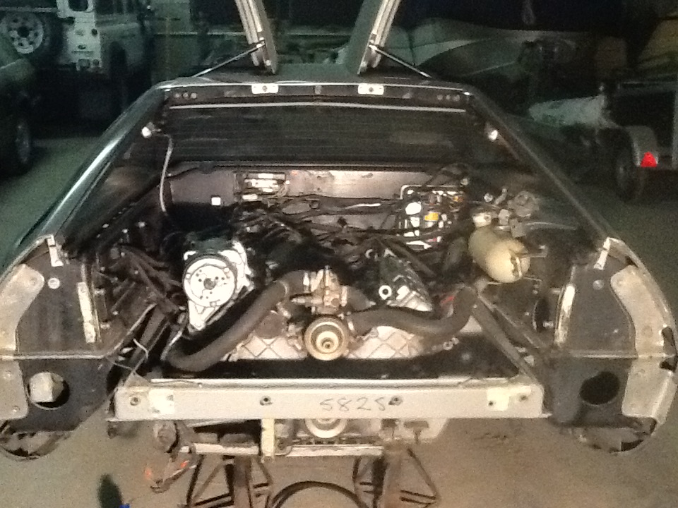

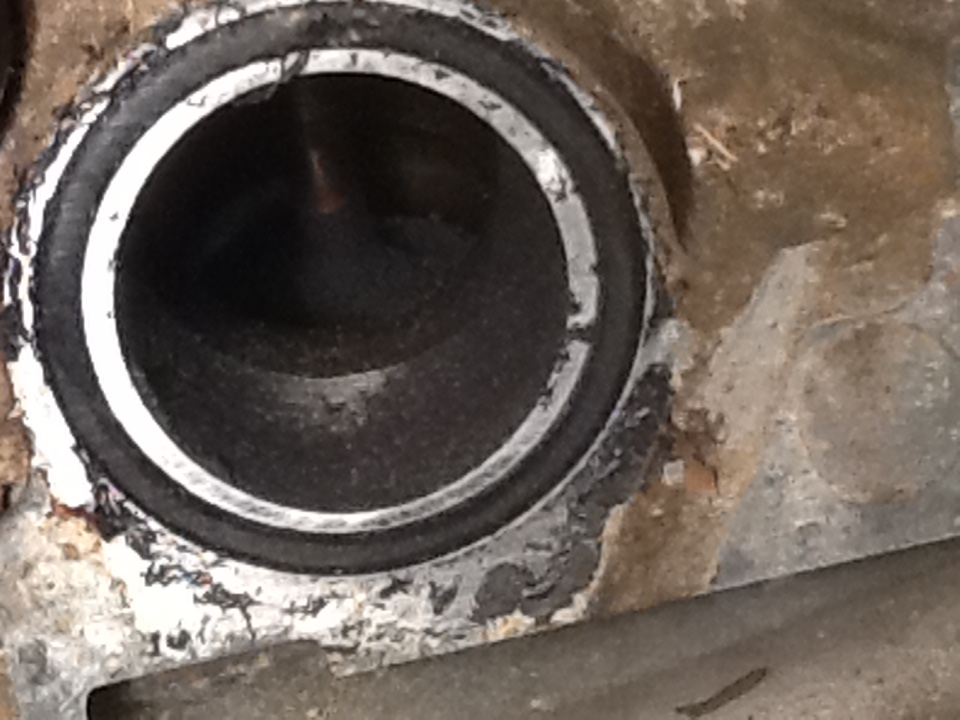

Got to see the frame number today. Only 2 numbers different then the VIN!

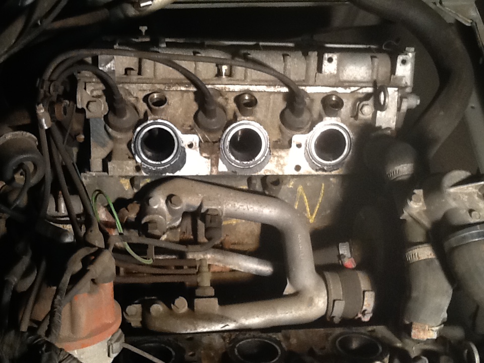

Had a look in the valley. Looking for sorce of high idle when warm problem. Can not find anything wrong. All vacuum hoses are hooked up correct. The springs in the butterfly valves also look in exelent condition. I will replace all vacuum hoses and the o rings and gaskets. Going to put in a new clutch slave, water hoses, water tank, otterstat, spark plugs, rotor and distributeur.
Noticed a lot of black dirt (carbon?) bildup on the intake valves. How is that possible on the intake valve?
I also will check and adjust the valves and replace the cover gaskets.
Any tips would be welcome , maybe i am overlooking something?
Some dirt bildup on intake valves

Frame number 5825
