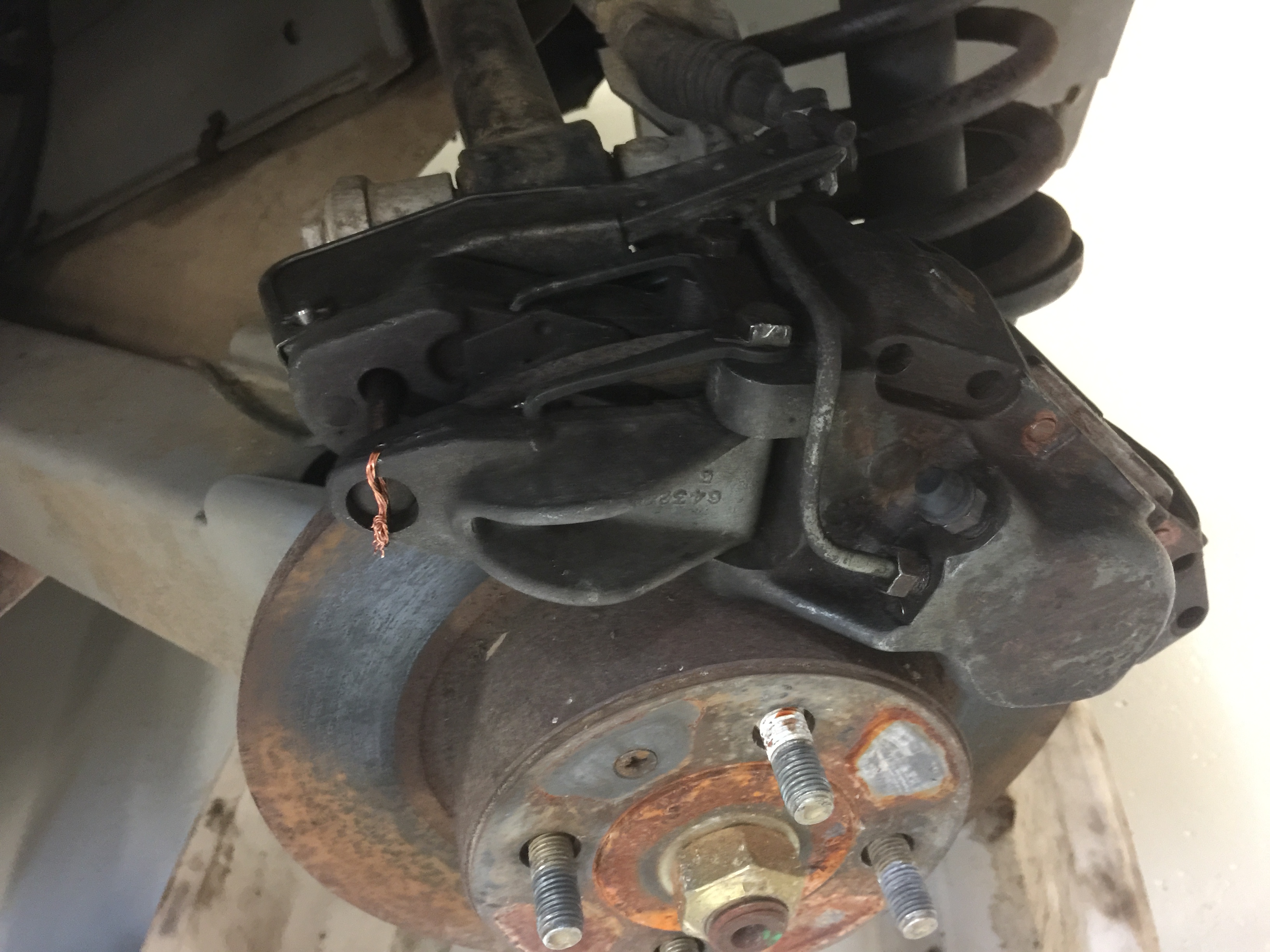

I finally got the correct tool to refresh the threads on the left rear caliper. So got that assembled and installed on the car. I also figured out how the parking brake adjustment works, and took the opportunity to adjust both sides.

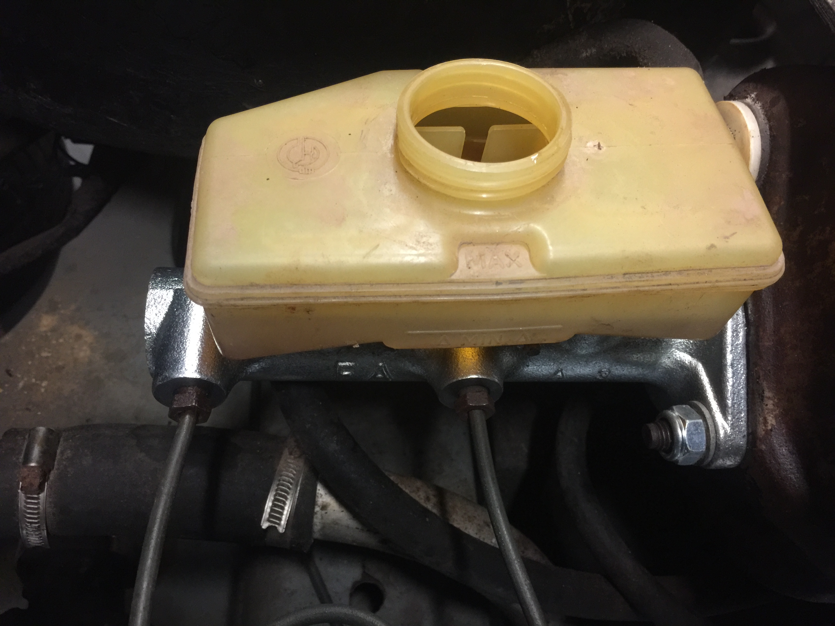

The brake fluid reservoir also got installed tonight and filled with fluid.
All it takes now is bleeding. I'm gonna need help with that.

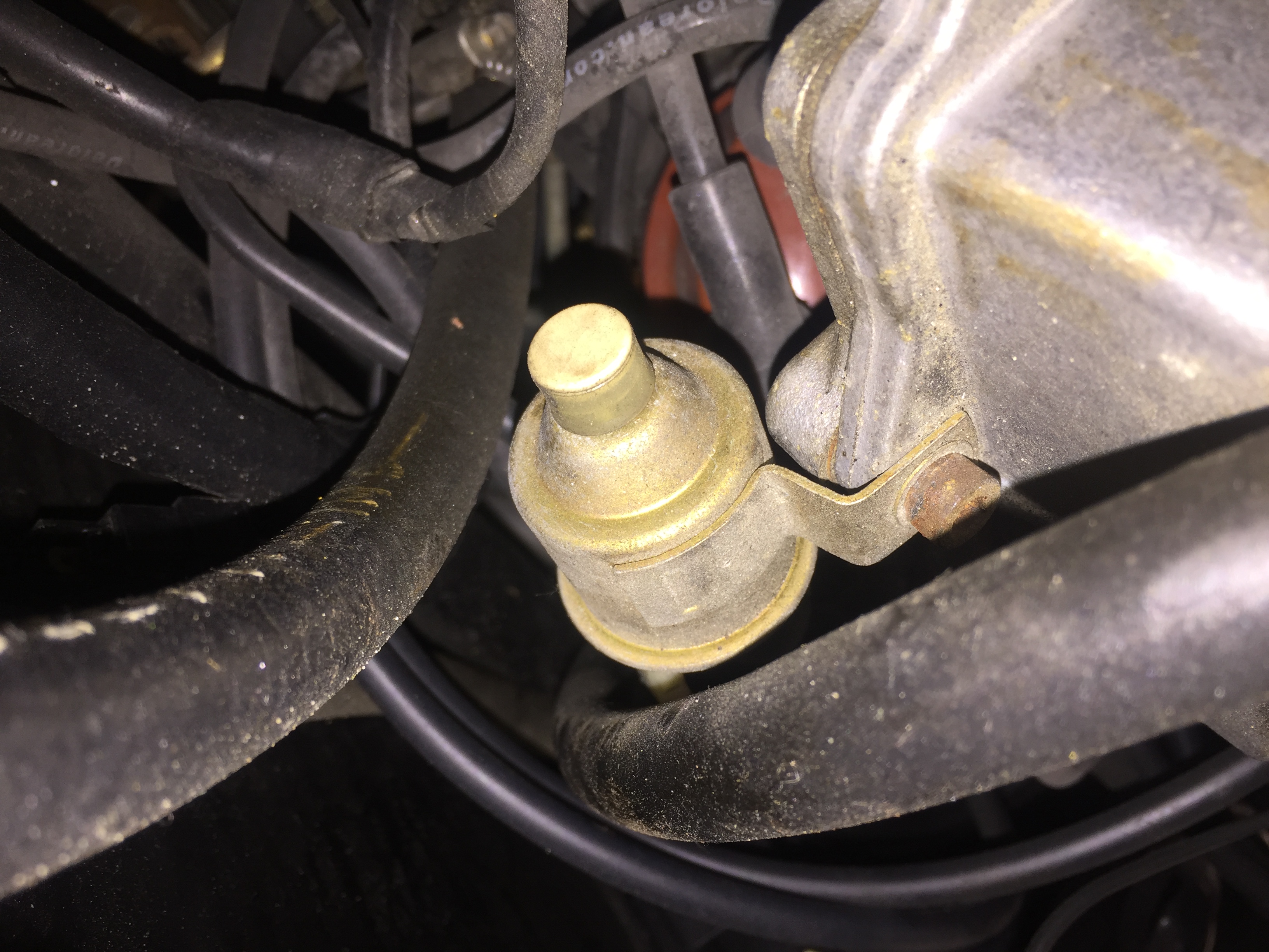

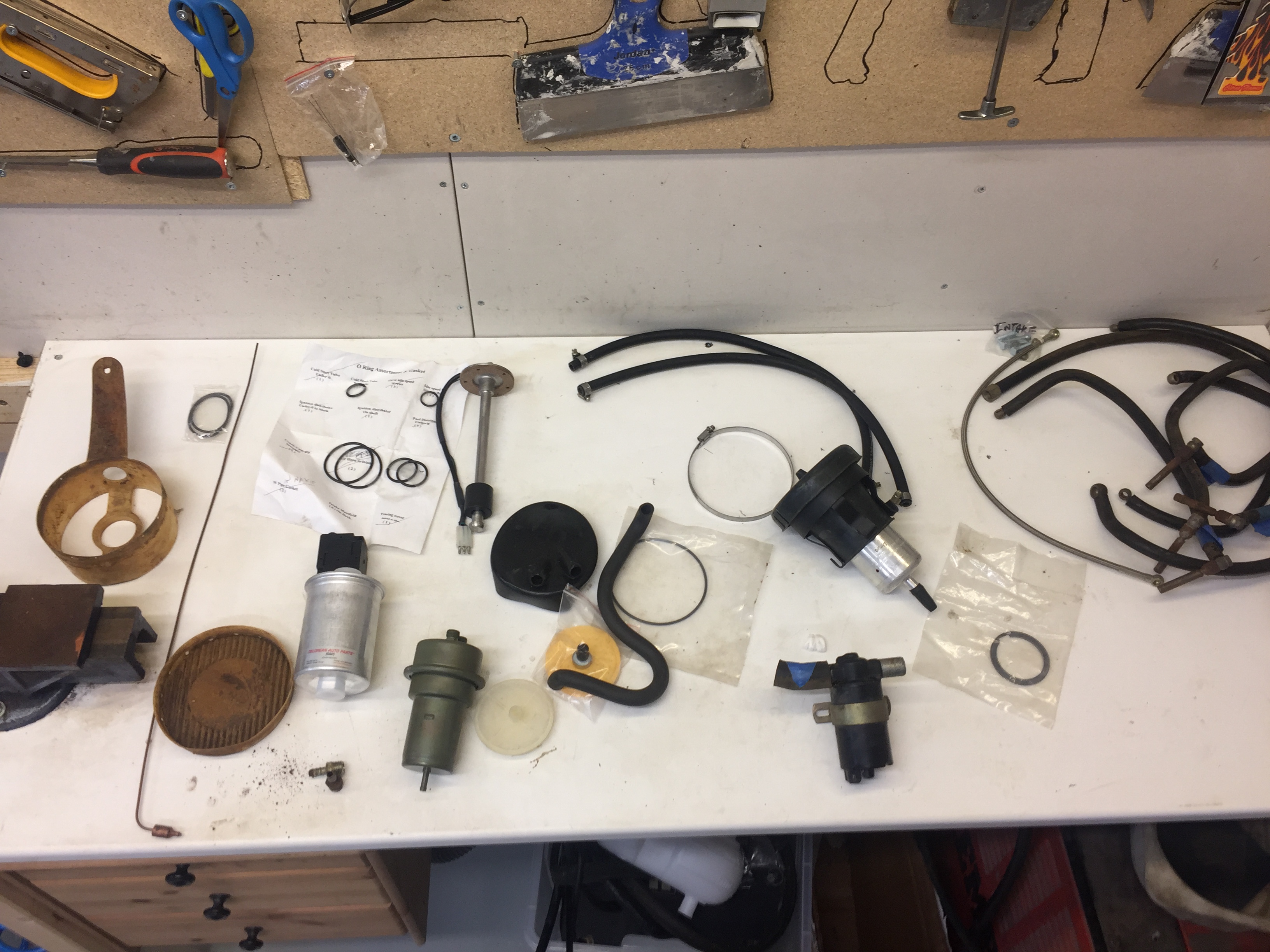

Fuel system next, here's an overview of what I've got
What's this?
Parts inventory

Postby Spudmurphy » Thu Oct 12, 2017 11:37 am
Nice! - I REALLY enjoyed putting the strainner and clips in last weekend - now I know what a vet feels like operating up a cows bum!
oh, and don't do what I did - put a small LED lamp inside the tank .... and left it in there doh!!!
Martin Gutowski's video on you tube was a great eye opener for me ... I notice that the editing left out the times the nut slipped off, clips were not "clipping" - it seemed seamless. Heck, now I've done it "I'm an expert!"
Now all I got to find are the wires going to the pump! - Hey, would you take a picture when you do yours so I can check the orientation of the wires on the fuel pump please? :-)
