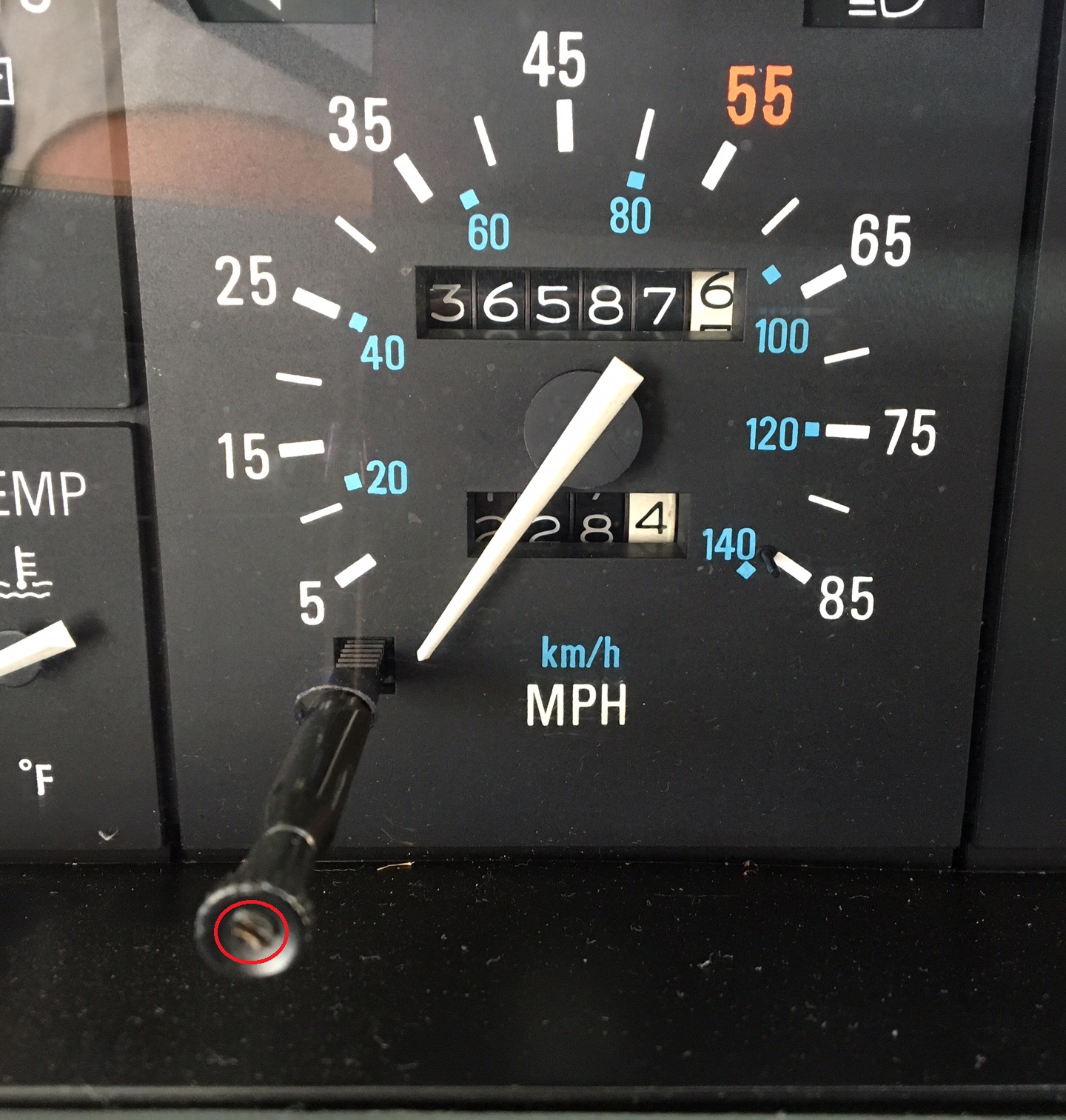

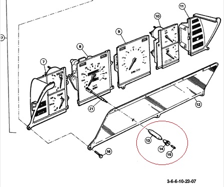

You would need to use a small jewellers screwdriver to remove the screw holding the trip reset knob in place (circled in the picture below).
With the screw removed you can then remove the knob from the trip reset shaft, and then remove the outer sleeve (referred to as a spacer in the parts manual) which covers the trip reset shaft. All three parts are shown in the parts diagram pictured below. (Don't be tempted to try and remove the trip reset shaft itself or you will end up damaging/breaking it)
With those out of the way you can then attempt to get a paperclip and/or length of wire bent to shape in through the hole to try and flick the needle up, some contortion maybe required.

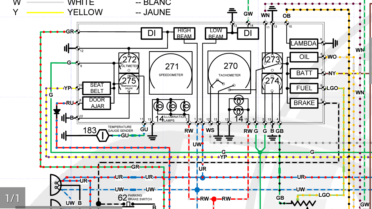

Now - I’ve looked at the wiring diagram and see the door ajar and seatbelt lights take power and ground on the same cables as the temp gauge.(green and black) and neither of them work .........
Perhaps it’s power and/or ground at fault.....

TristanC wrote:Now - I’ve looked at the wiring diagram and see the door ajar and seatbelt lights take power and ground on the same cables as the temp gauge.(green and black) and neither of them work .........
Earth is a possibility in some way, but those particular warning lights are controlled by the little door switches, and the connections there are frequently knocked off.

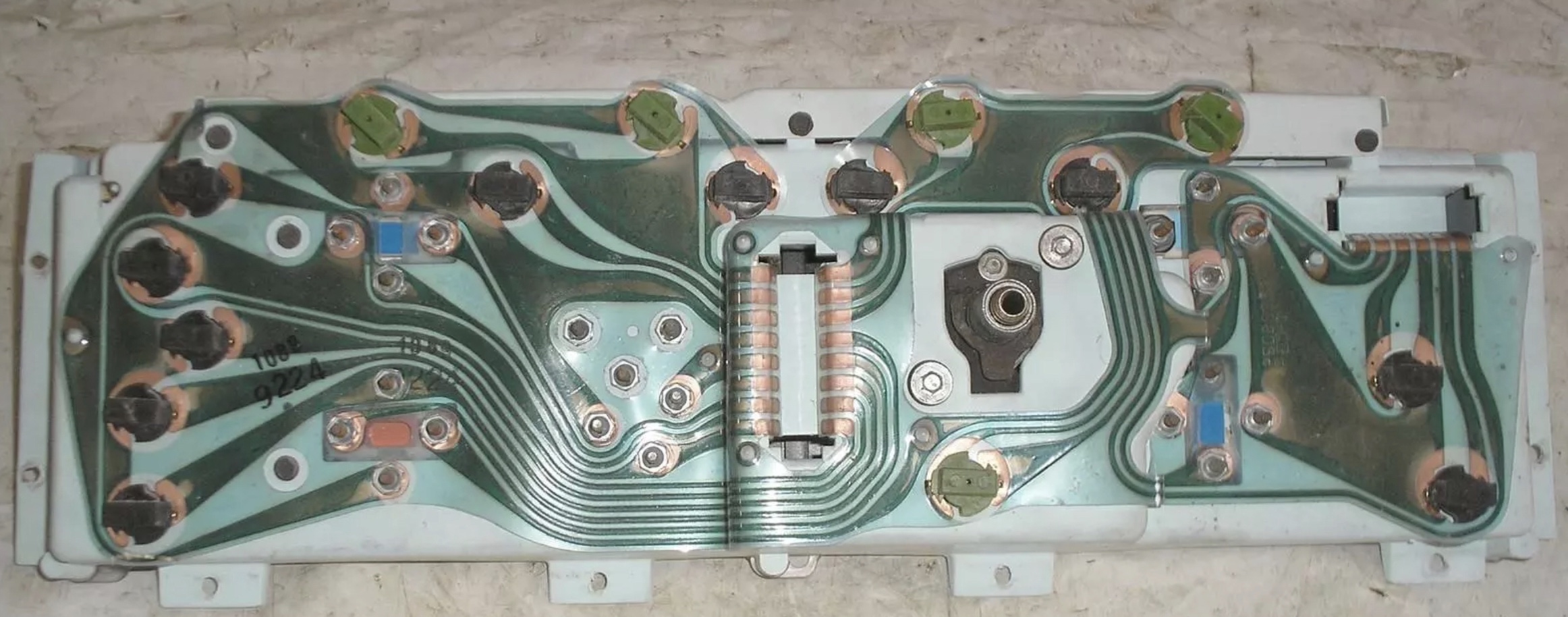

Ok so looking at the back of the binnacle for the temp gauge (picture is one I nicked off eBay)
Of the 4 studs around the temp gauge, which 3 are the power, ground and temp signal?
The top one looks to be missing a nut (same as mine when I look up from the footwell)
If the wiring diagram is to be taken literally, the stop stud is the signal?
