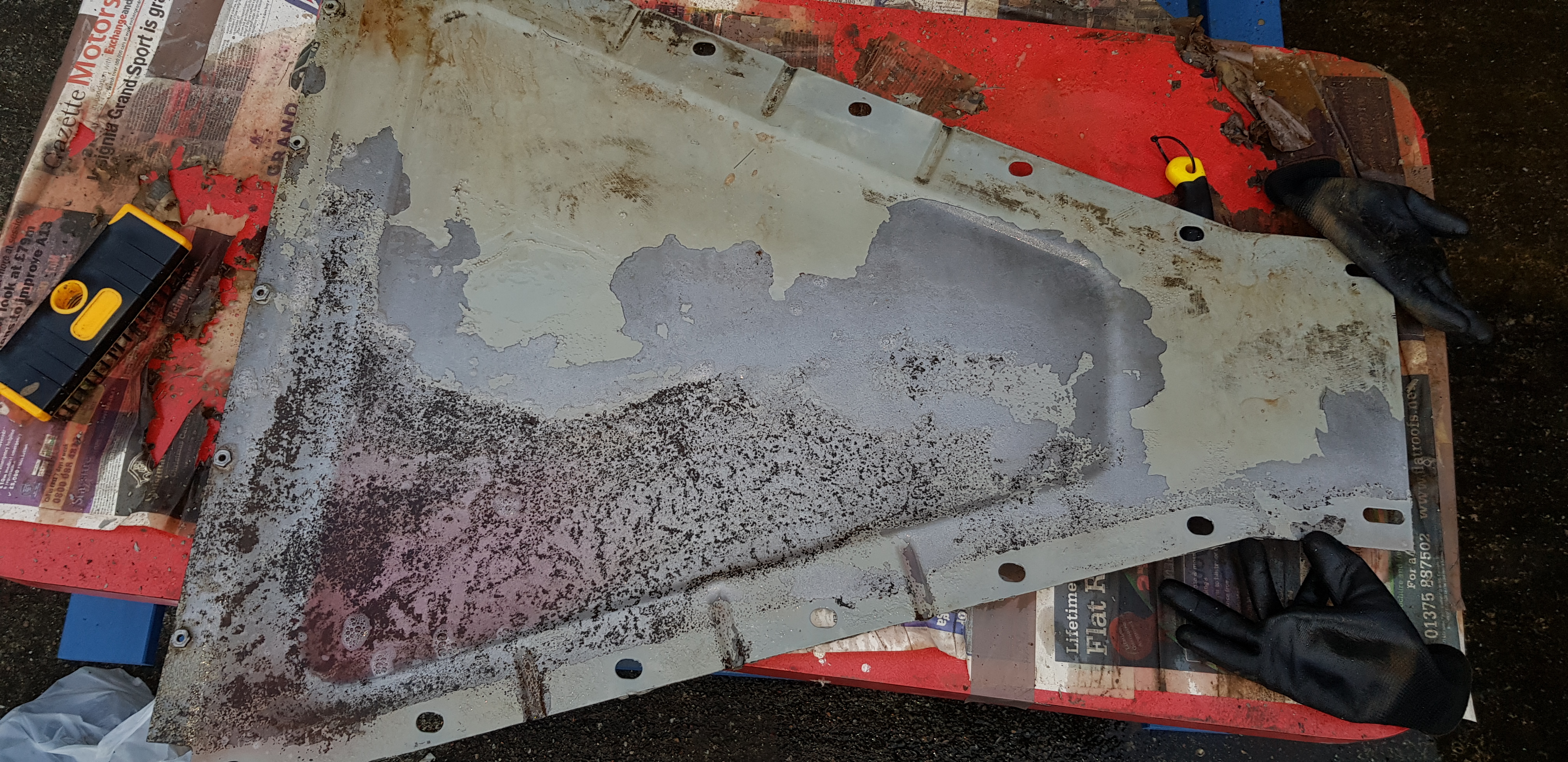

POR-15 is good stuff. I used it with marine clean, hot water, and prep n ready as per instructions. Other coating systems are available! (Which are admittedly cheaper)
A
Re: VIN 5219
Postby InoX » Sat Apr 13, 2019 11:42 am
Hello.
I'd second that. Although it is time consuming stripping back the epoxy to where you're back to solid material. Prep's always the key.

Postby DMC1983 » Sat Apr 13, 2019 8:56 pm
Well im getting there. Its looking a lot better but still some way to go yet.

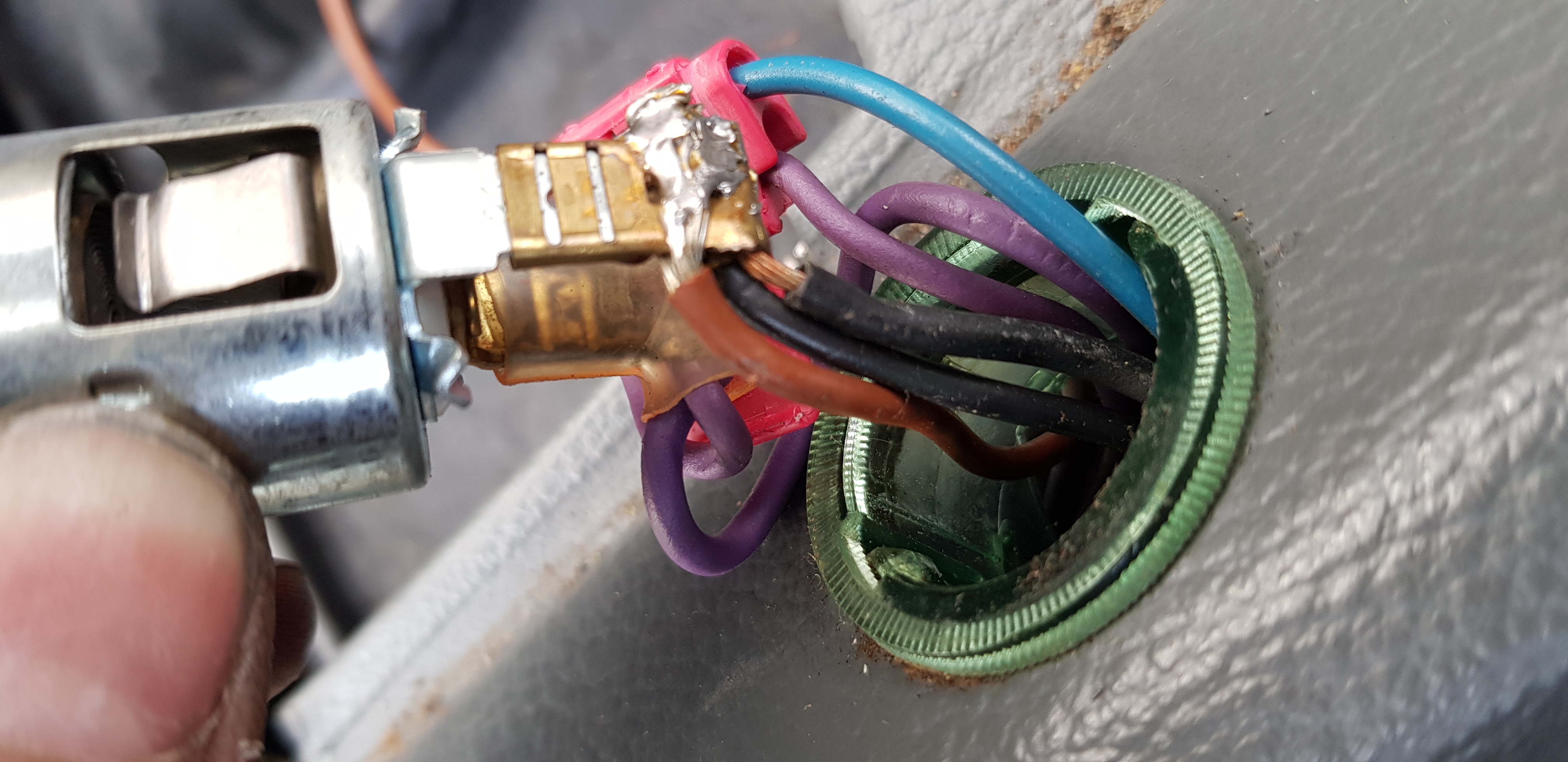

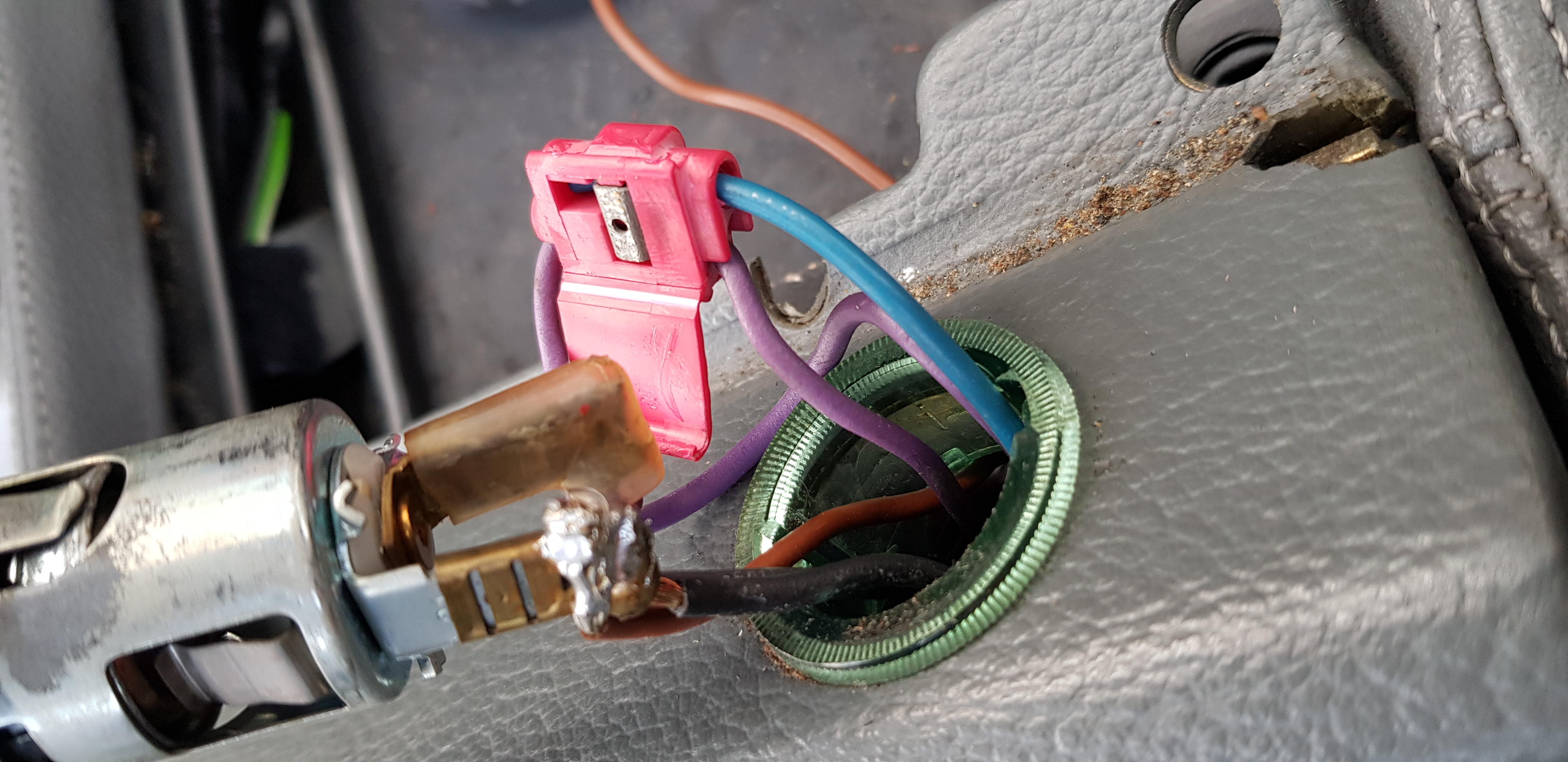

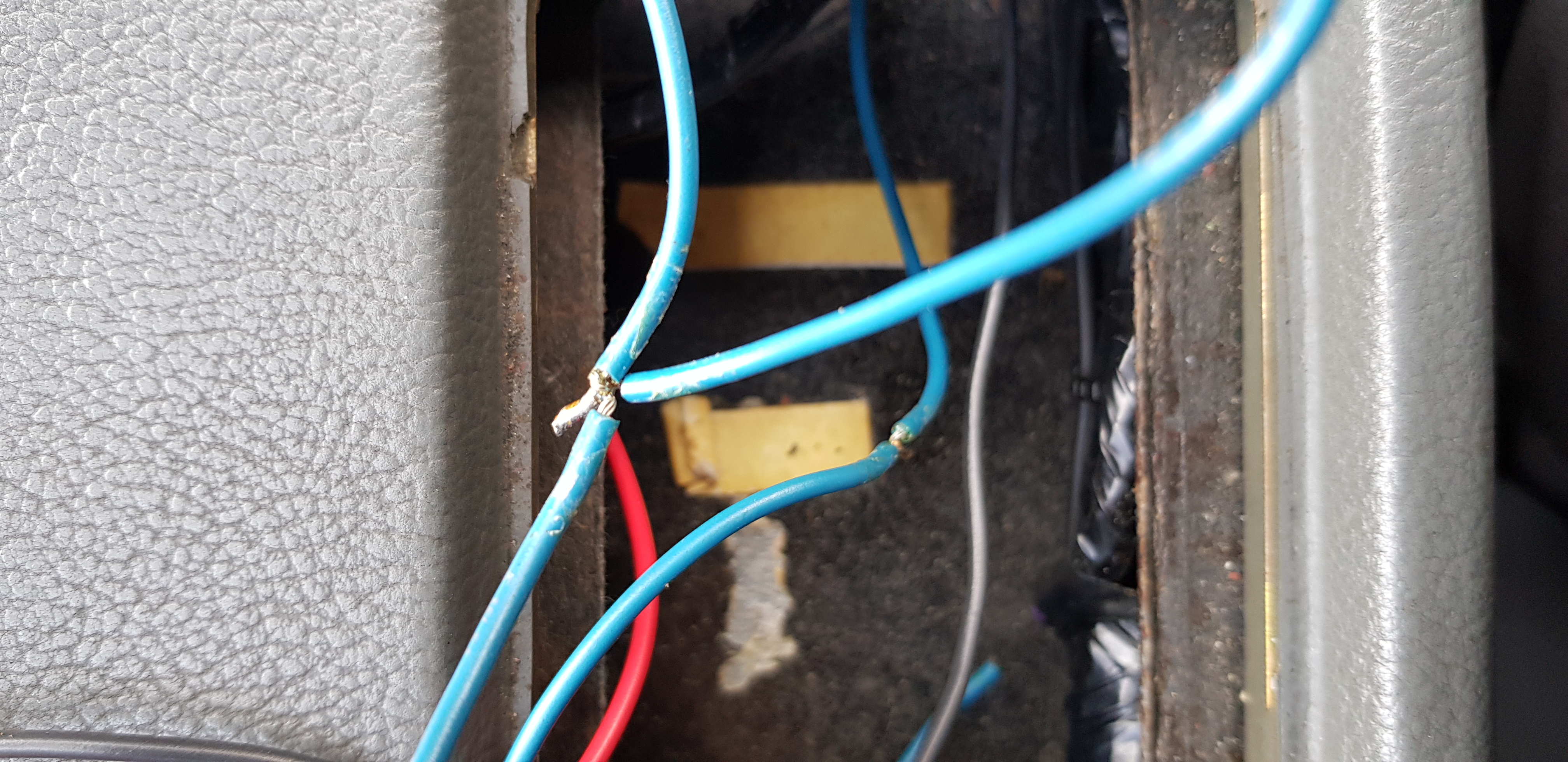

Postby DMC1983 » Fri May 10, 2019 6:27 pm
Seriously, WTF was the previous owner on? Theyve soldered (rather poorly) wires into anywhere. Theyve also put different coloured wires together. So a green wire just turns into a grey wire for no reason. I literally have to follow the entire length of the wire. The pictures show where some of the crappy alarm wires are wired to.

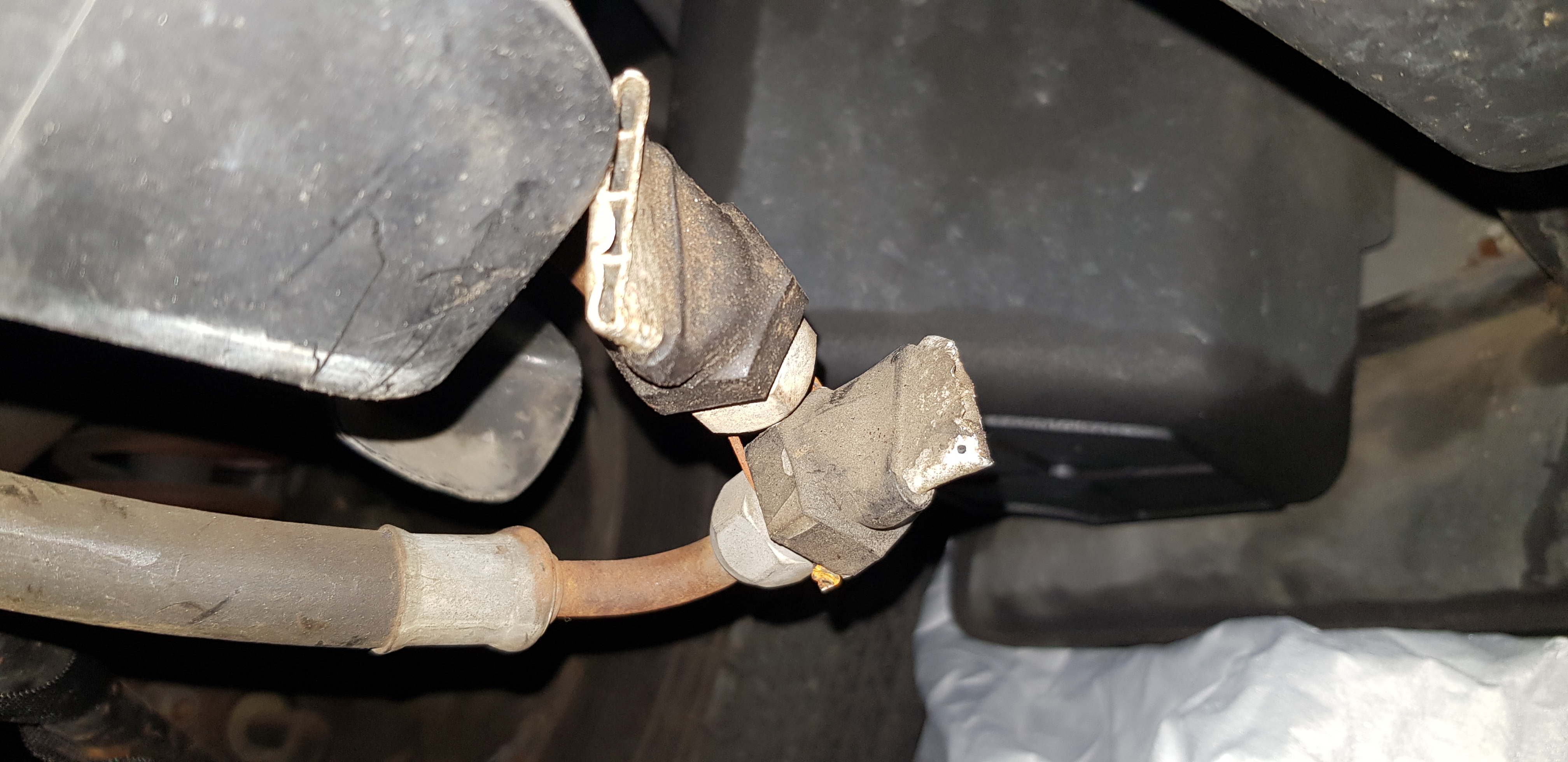

Postby DMC1983 » Sat May 25, 2019 7:58 pm
Gotta find out why the car is overheating. Temp goes up to 250+ and the fans dont kick in. Fans do work when bypassed but not when connected to the otterstat

Postby mec » Sat May 25, 2019 8:04 pm
More than likely a new one is required, id reccoment the new screw in version which comes with its own new section of pipe available from arran at delorean go
