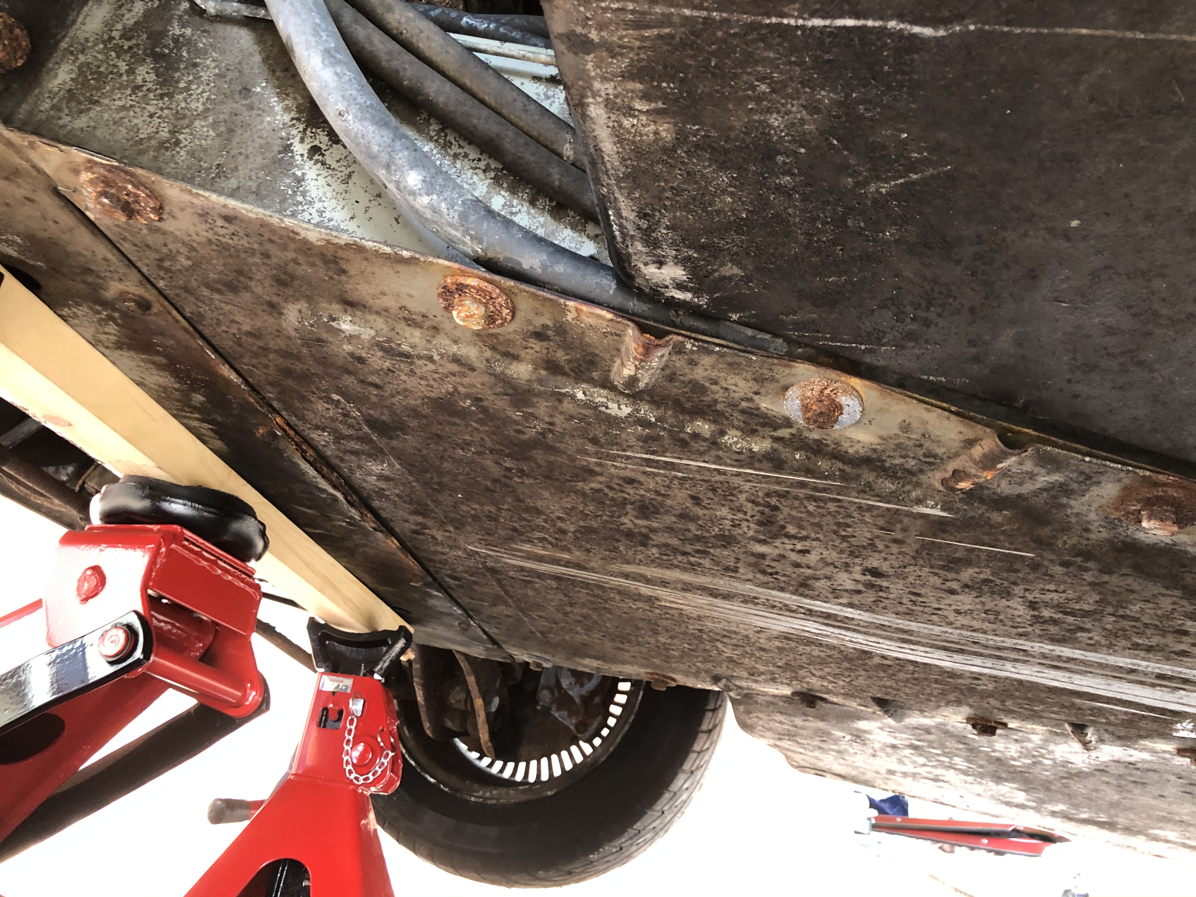

How is the Chassis looking ?

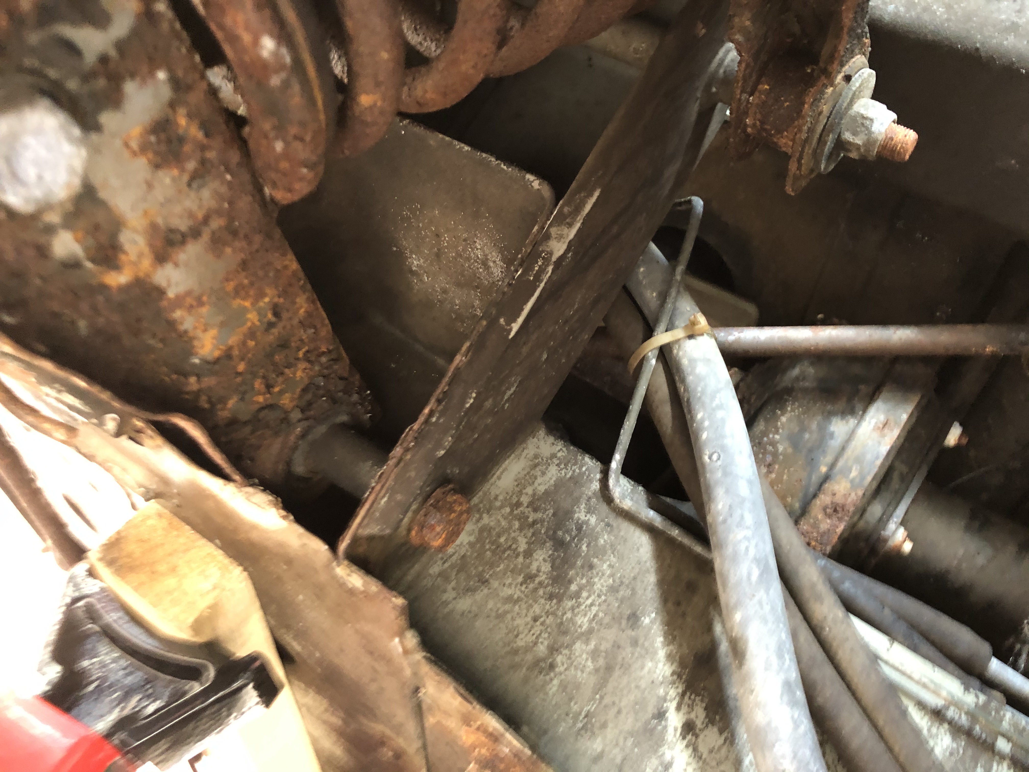

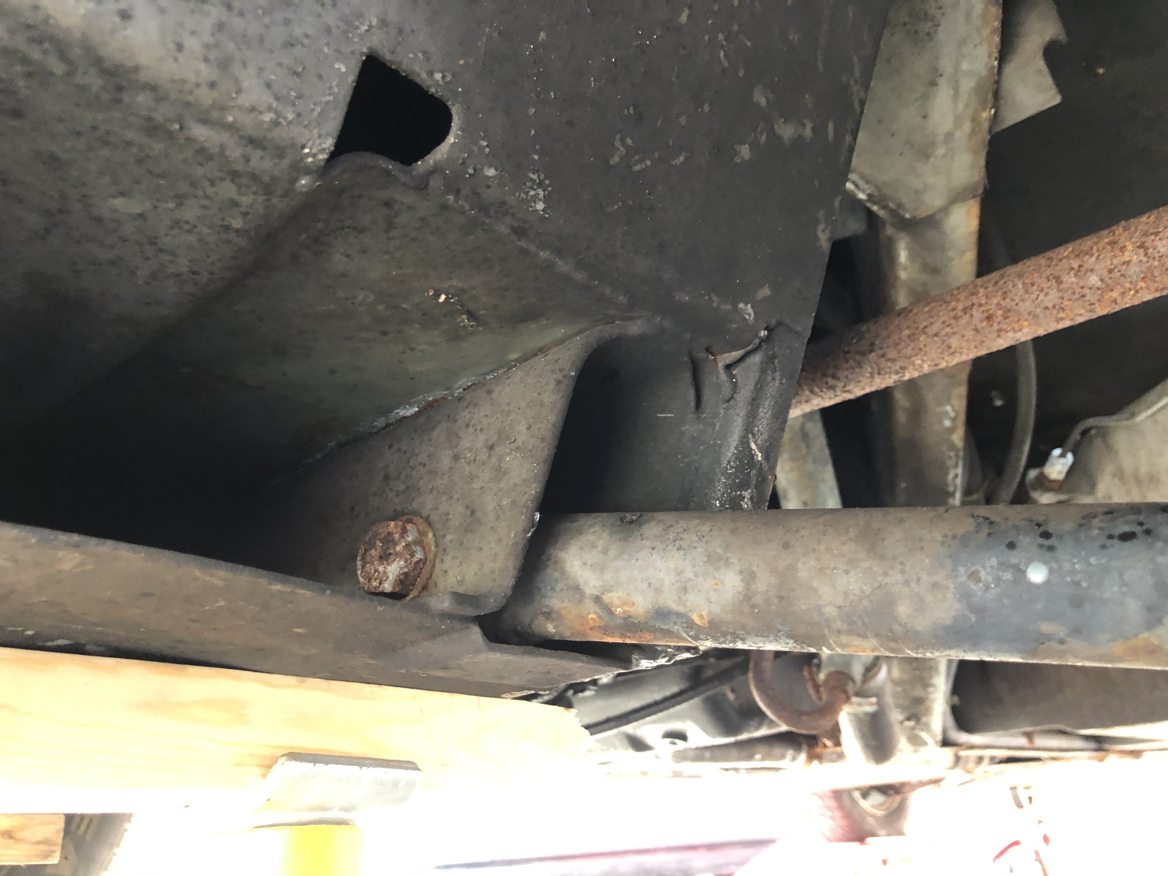

Now this is where I need some input. I am planning to lift the car tomorrow for a little look see. Where should I look first Second last etc.
ERIC

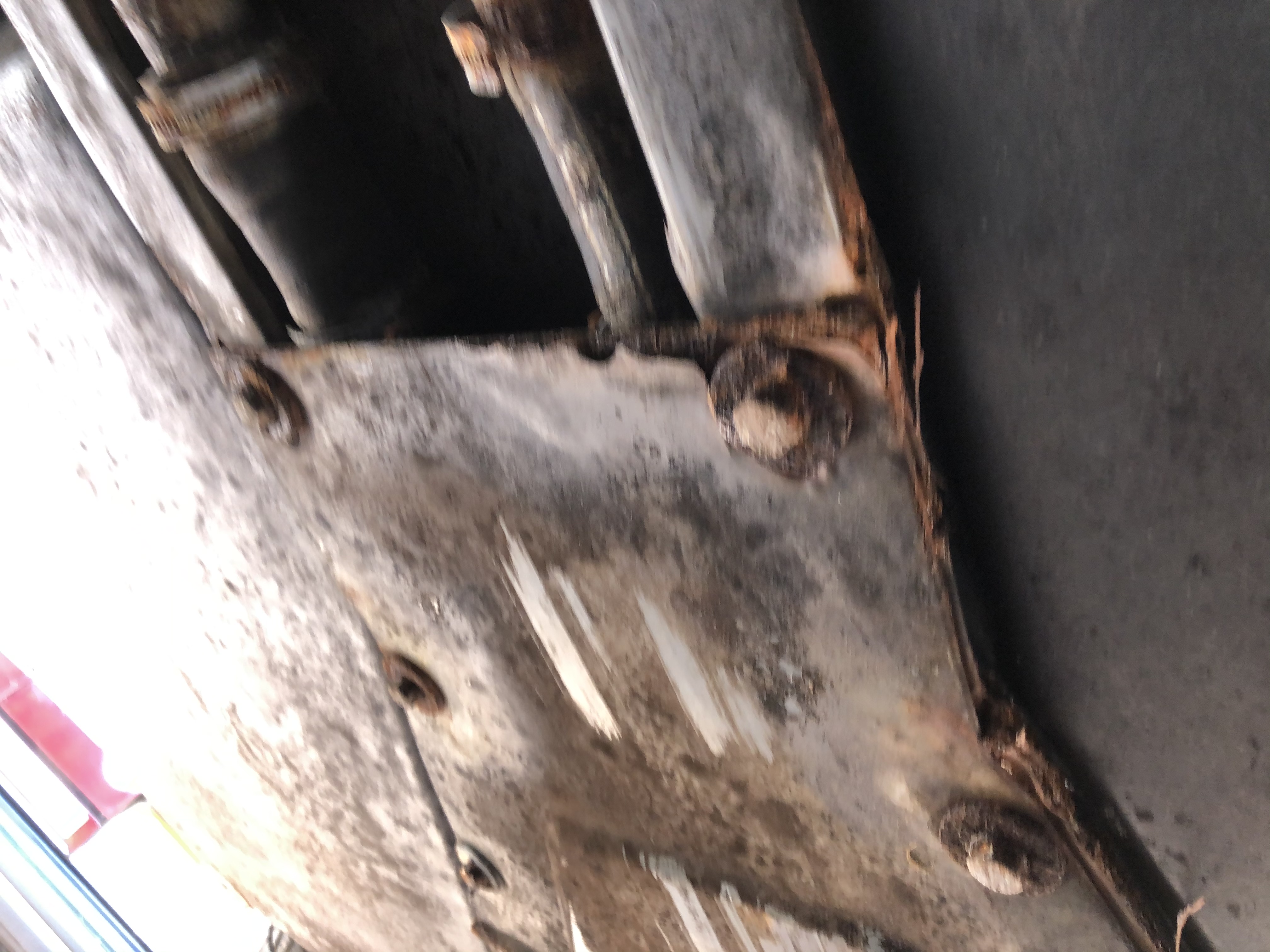

Postby eric » Mon Aug 31, 2020 7:14 pm
I am by no means the expert but if you look under the LCA's and inside there and inside the box section at the back it will tell you a lot. If they have issues you know where you are. The front Extensions are usually a prone spot.
I know there are spots near the fuel tank etc which you don't tend to see until you remove it. I have my ramps available if you want to do a full lift and get under it you are welcome to borrow them.
What you need to establish is, is the epoxy coating broken down and it has water under it and is effectively eating itself inside out or is it just a few rust areas.
I suspect the epoxy has cracked as per my pics but I may be wrong..

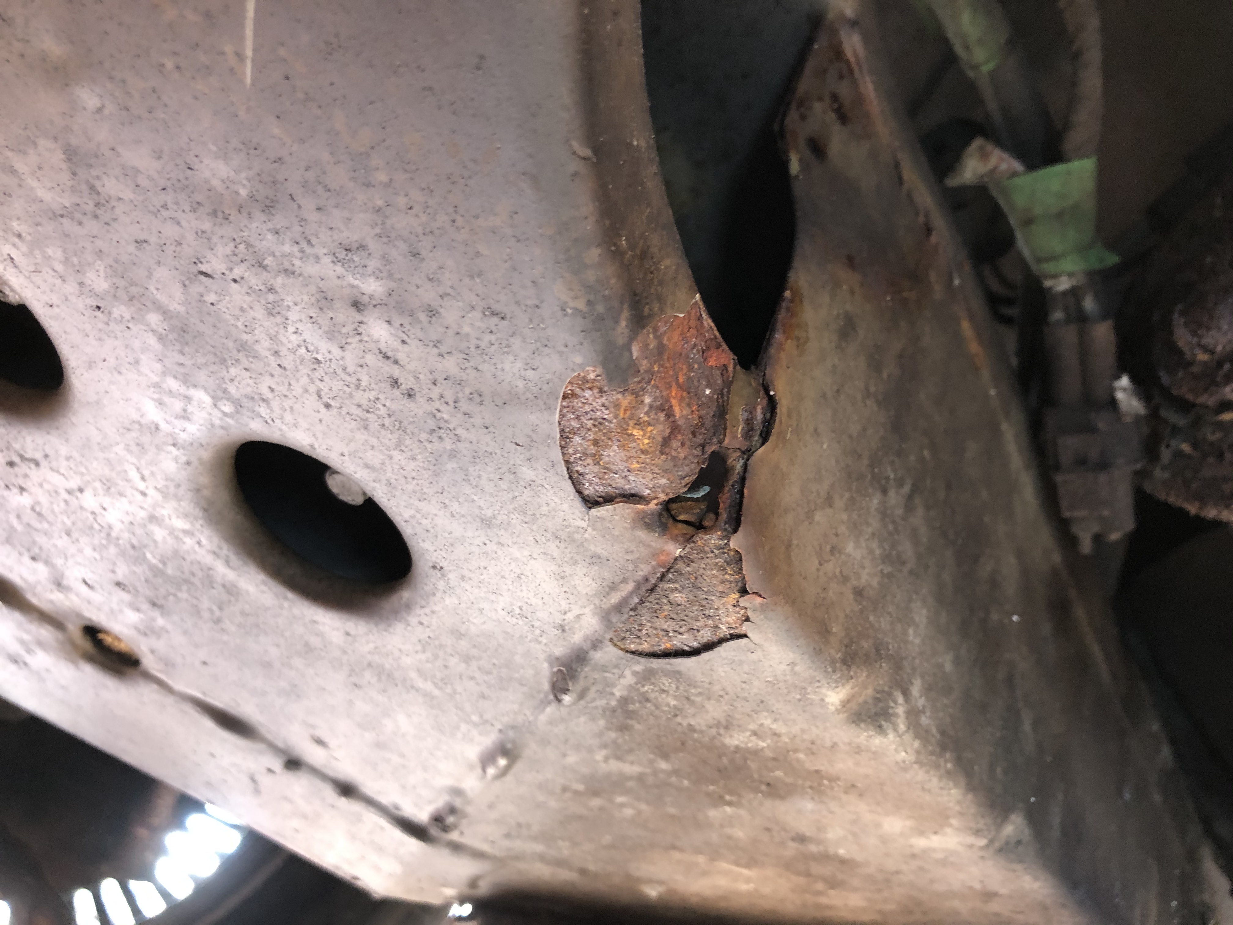

Postby DMC1983 » Mon Aug 31, 2020 8:20 pm

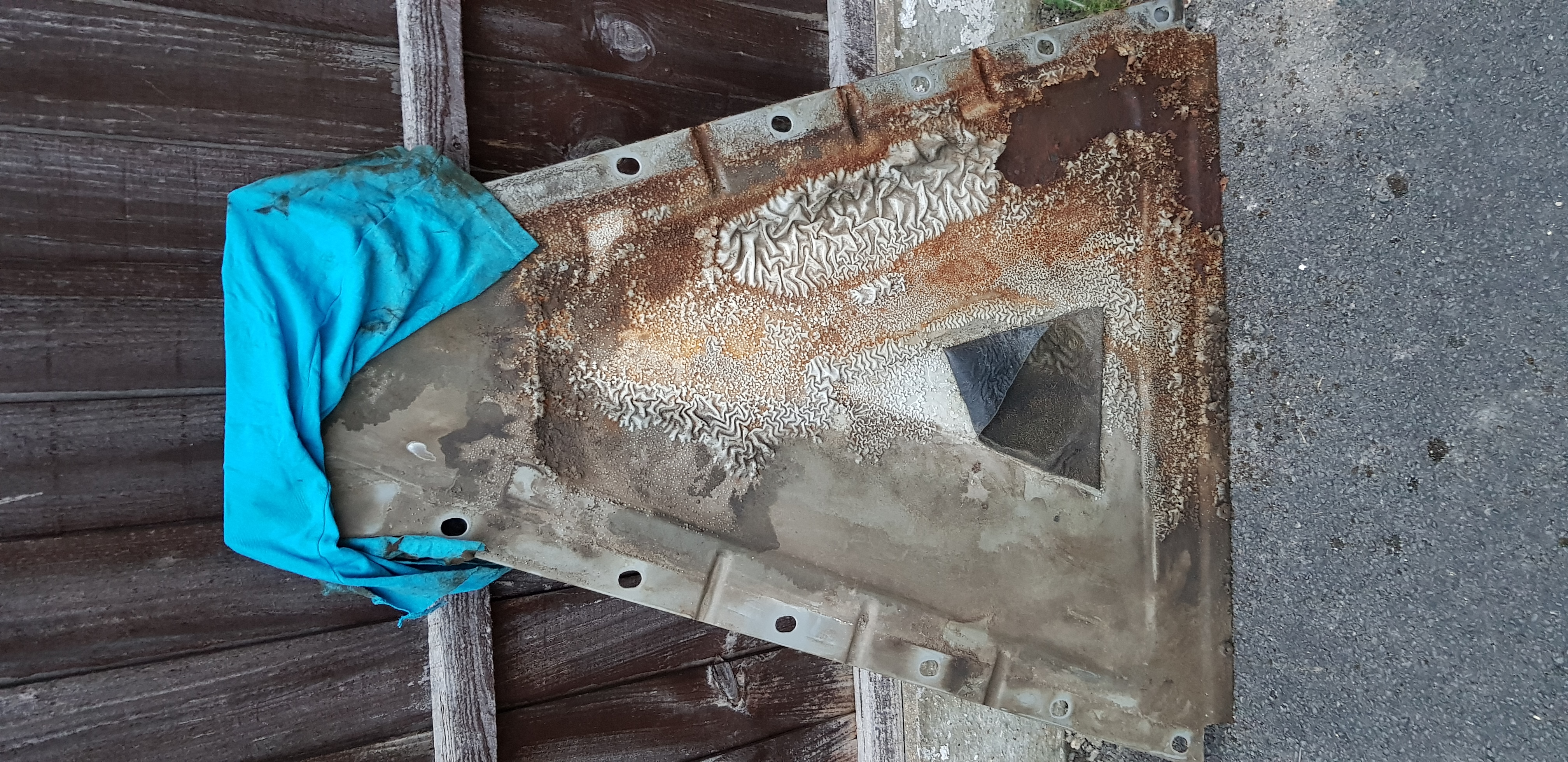

I would say drop the fuel tank. Im glad i dropped mine as i found this little spot. Its a common spot
And the inside on the cover plate...

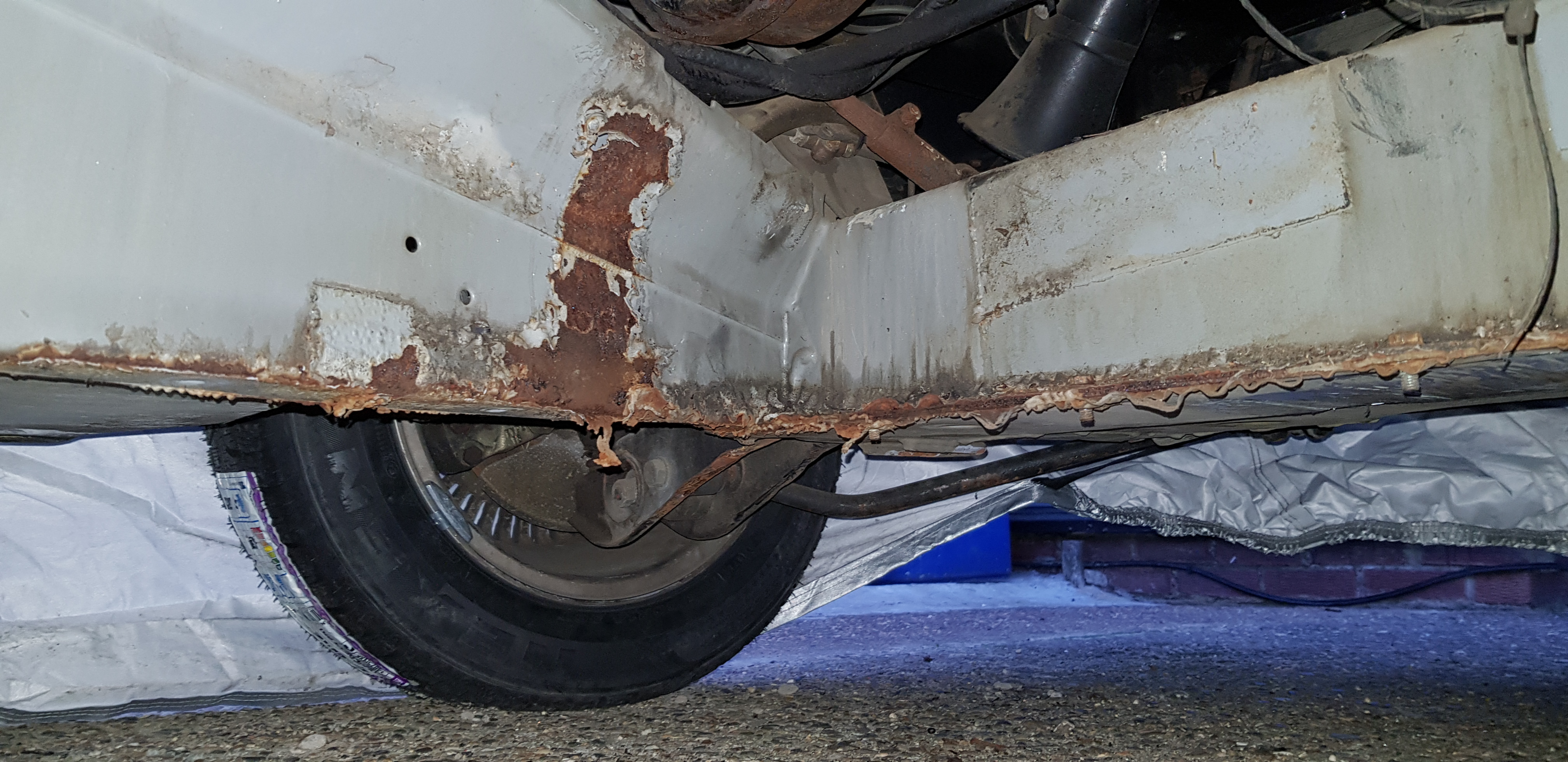

Postby eric » Tue Sep 01, 2020 8:57 am
Whilst it needs doing I would be less worried about the above pics compared to how some of my initial pics looked which definitely show a more terminal problem.
What causes the fuel tank one, I think its usually from the Brake/Clutch leaks, whereas the above is just from general water ingress.

From the pictures I saw it looked like the chassis was covered in some sort of dirt/mould?
You can see a couple of scrapes on the fuel tank plate where it has come off and it looked ok

Postby DMC1983 » Tue Sep 01, 2020 4:47 pm
eric wrote:What causes the fuel tank one, I think its usually from the Brake/Clutch leaks, whereas the above is just from general water ingress.
Yes thats exactly it. The brake reservoir was empty when i got my car.
A Van wrote:From the pictures I saw it looked like the chassis was covered in some sort of dirt/mould?
With a bit of luck, that dirt and grime has protected the frame. Fingers crossed

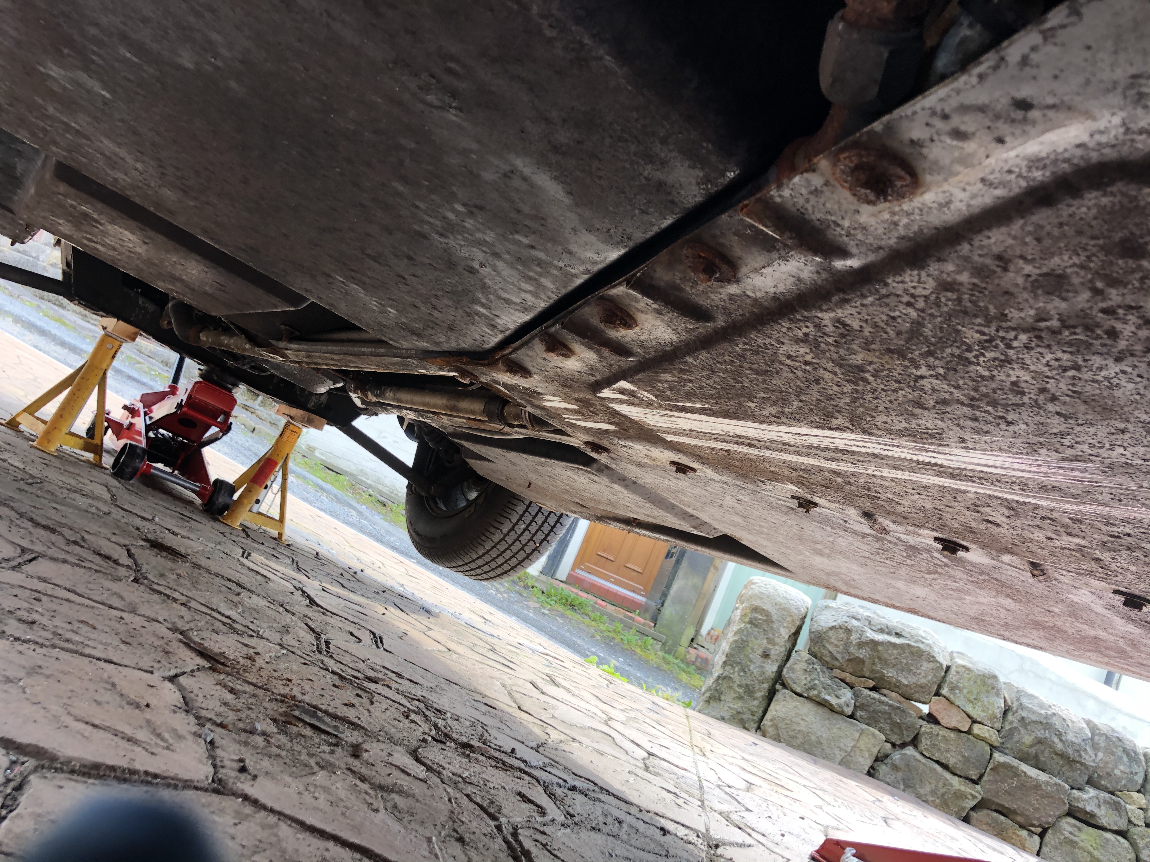

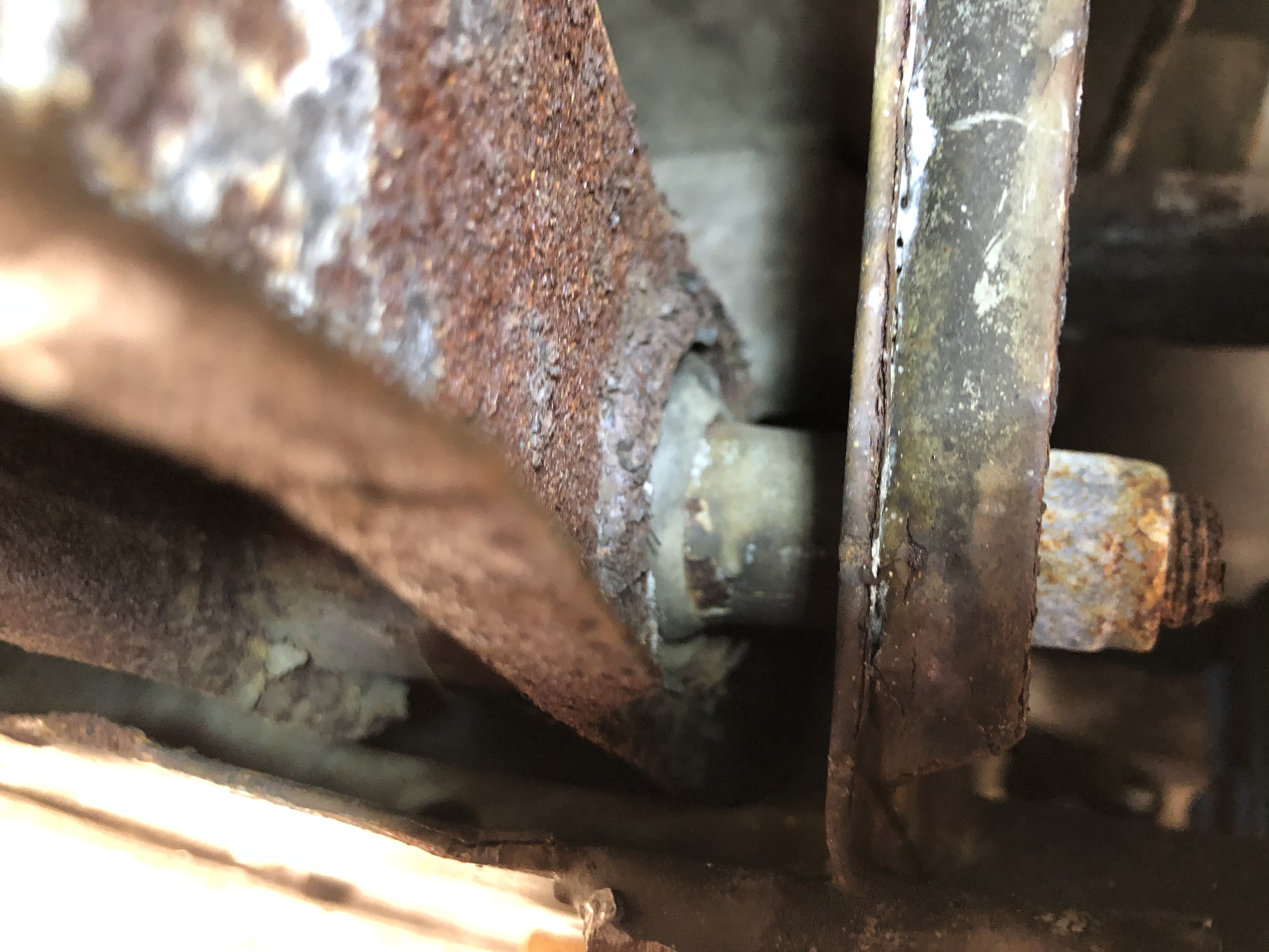

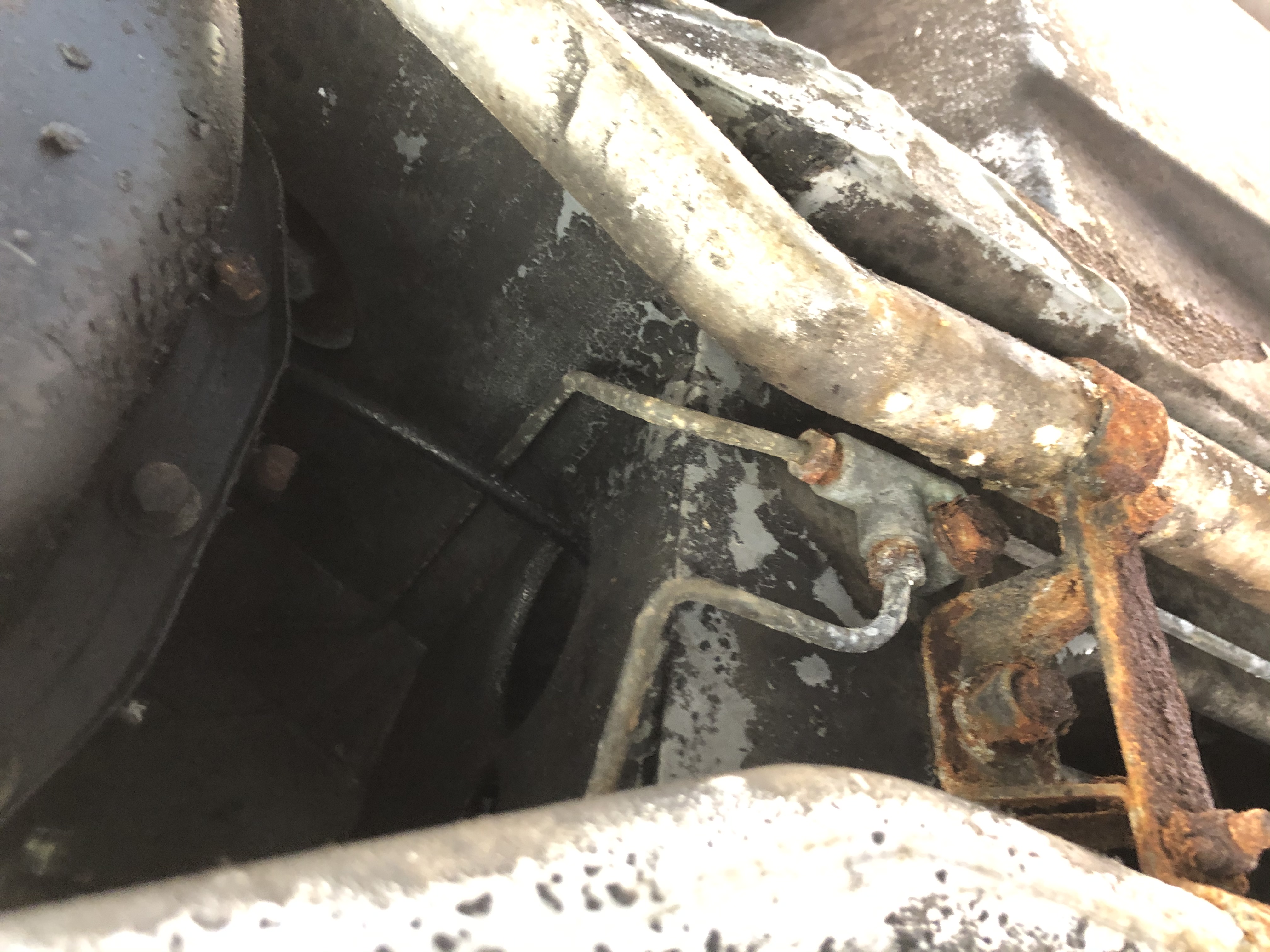

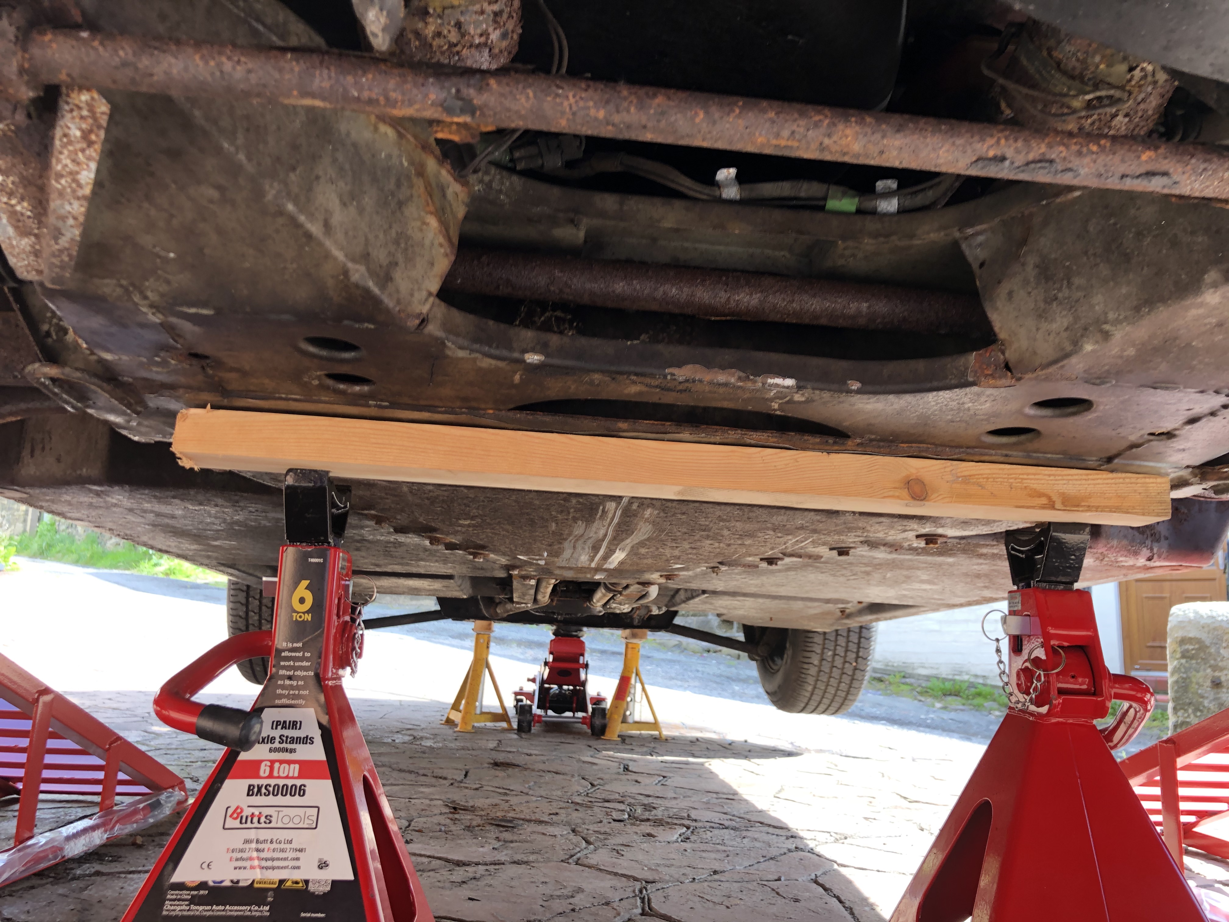

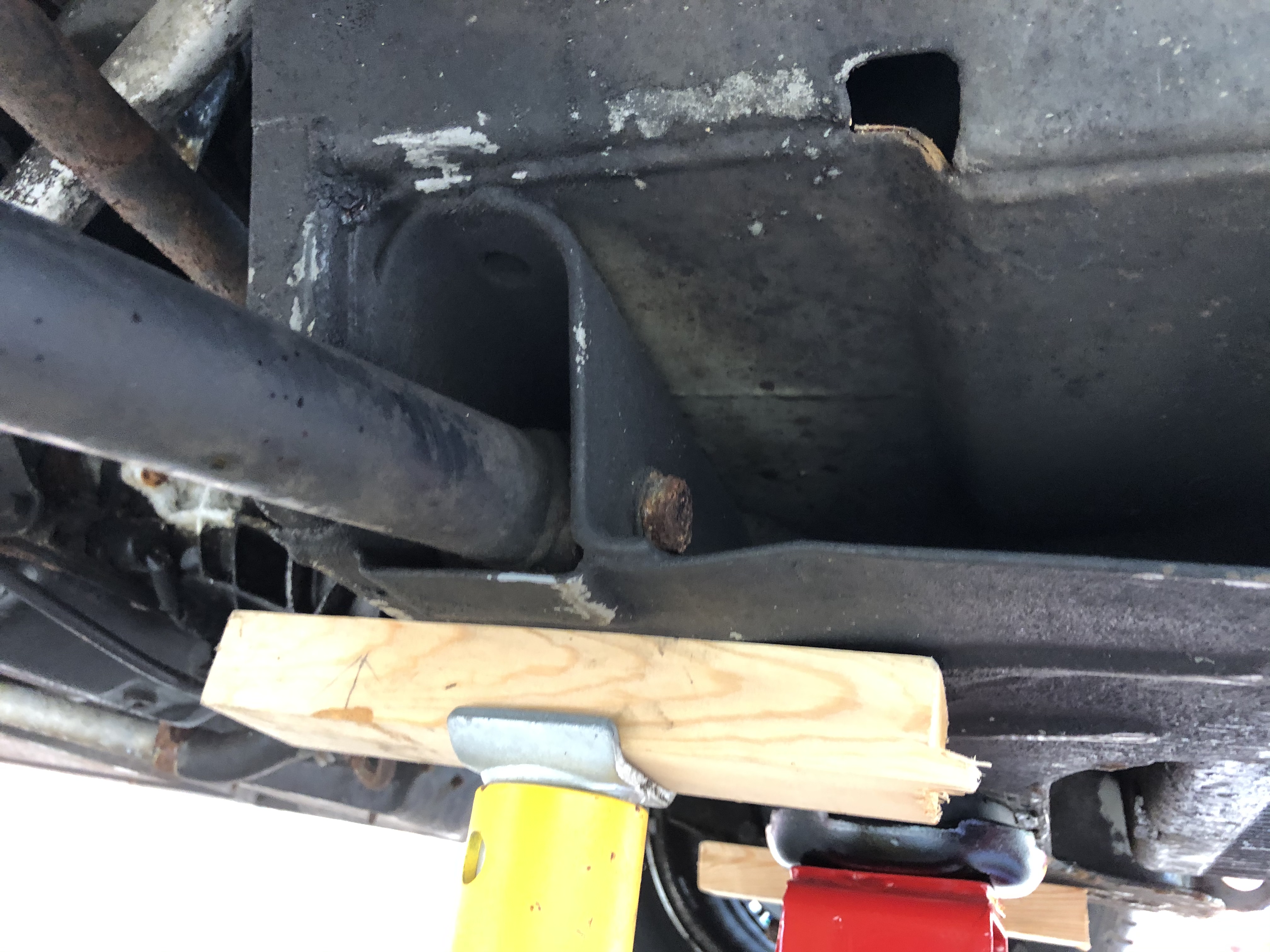

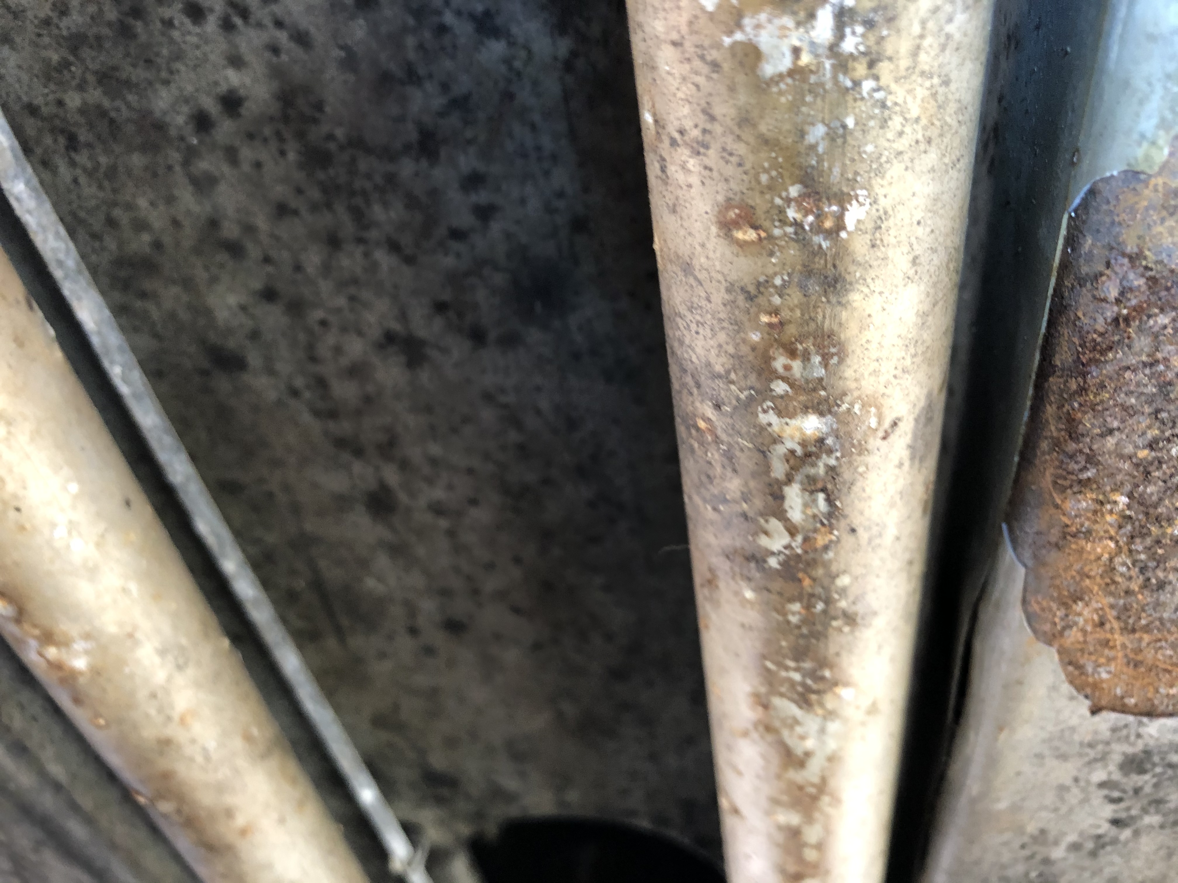

Postby Darrenre » Tue Sep 01, 2020 7:02 pm

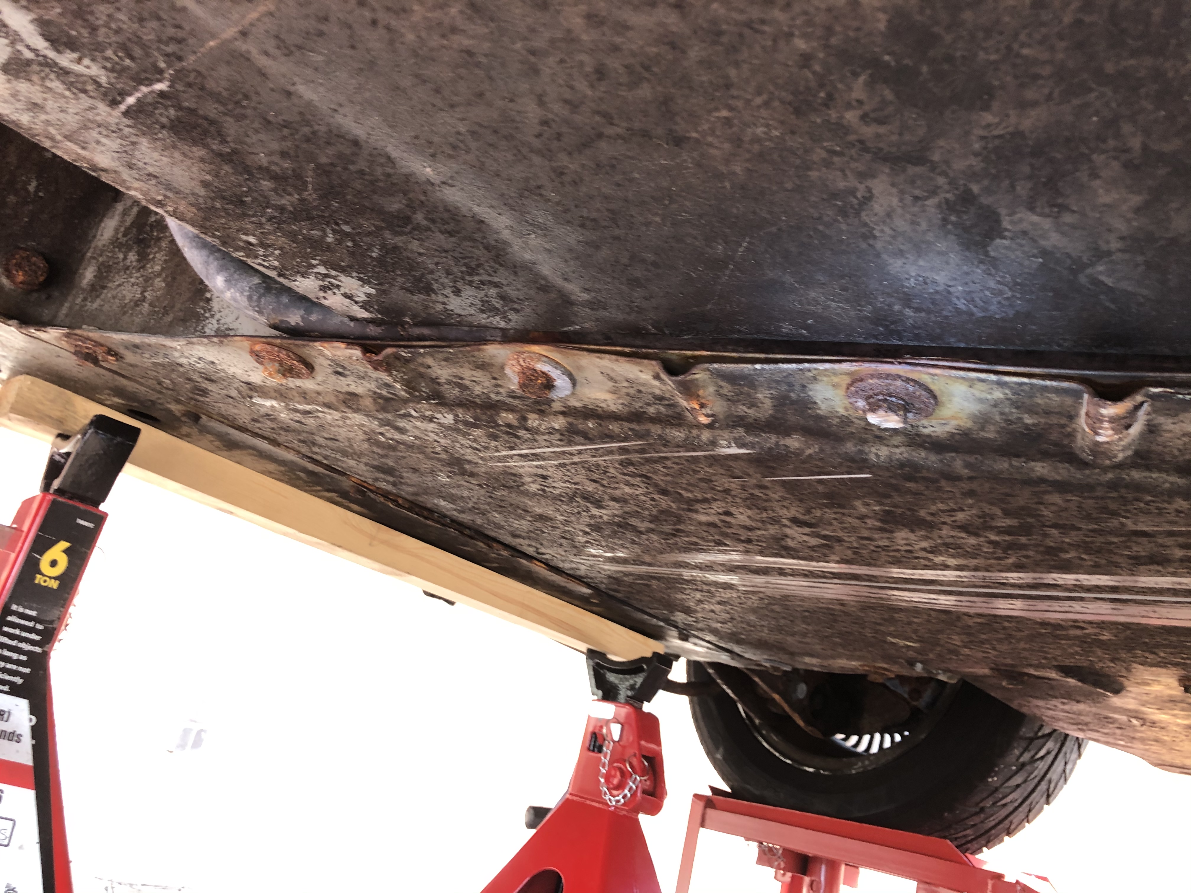

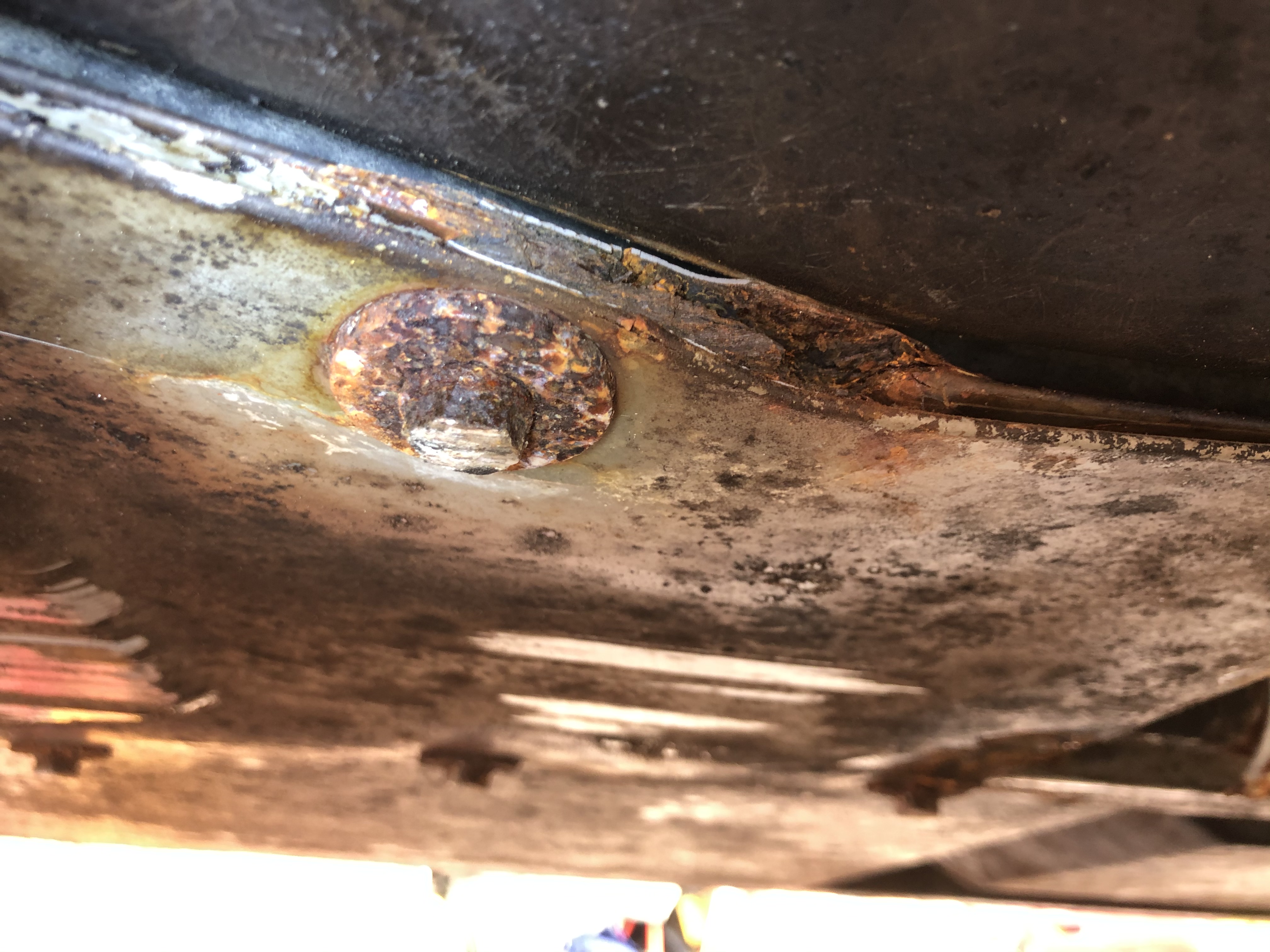

Dirt and grime appear to have helped, brake reservoir still full also. Will pull the fuel plate soon to see the couple of ares that have some flaking. Mirror so far.

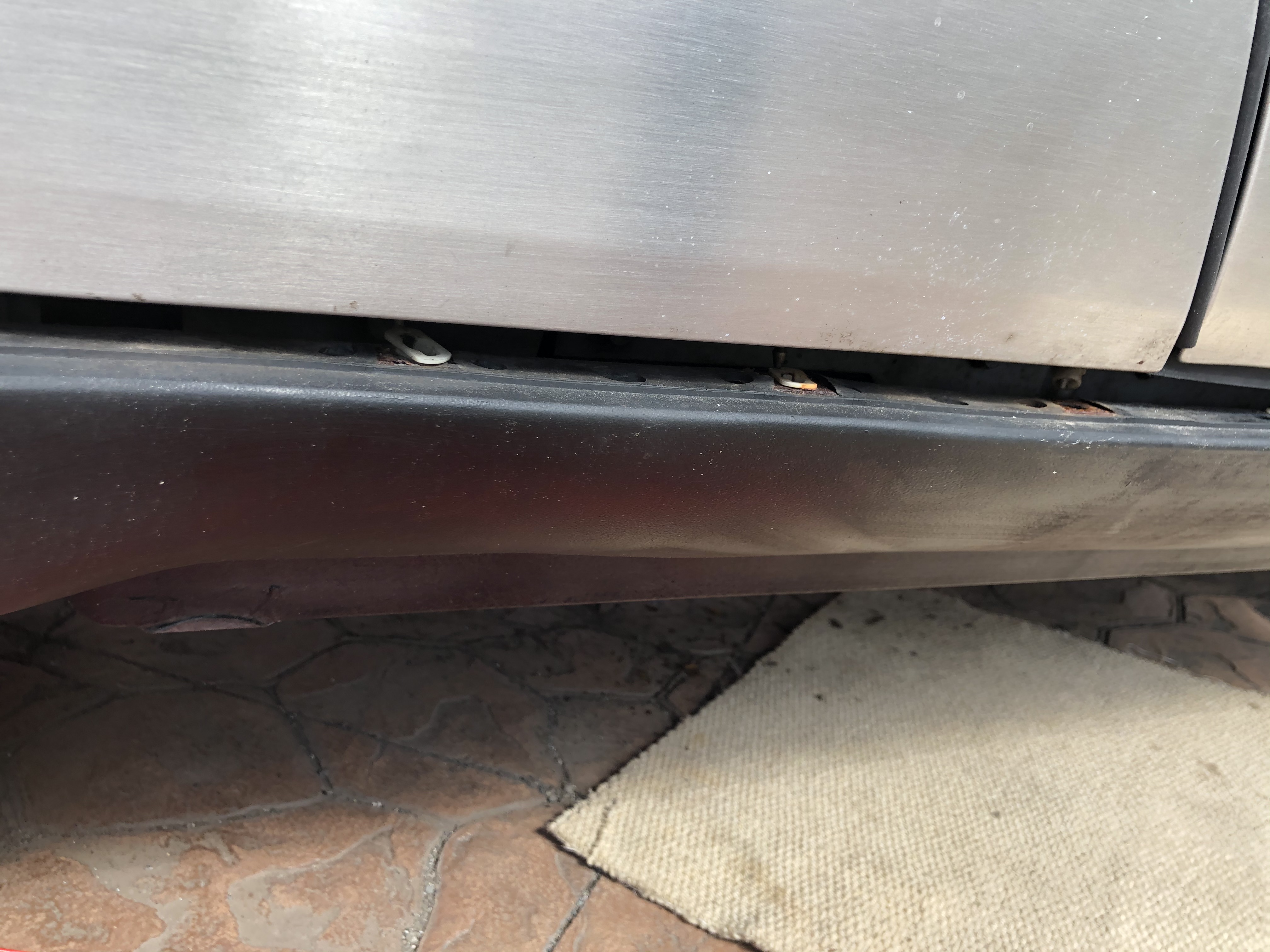

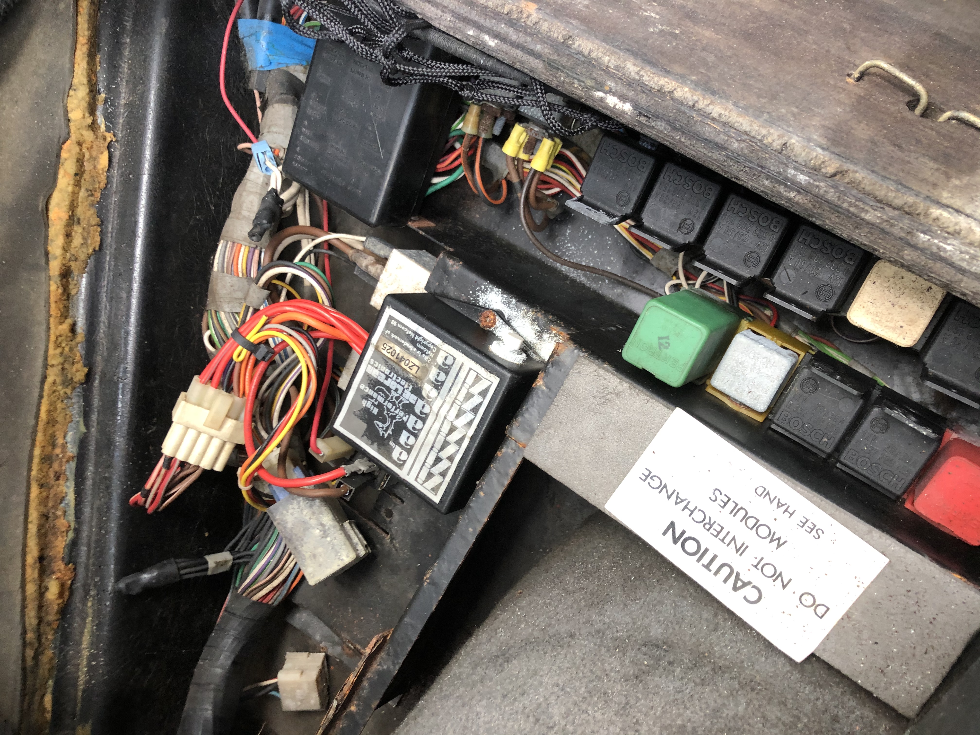

Postby Darrenre » Tue Sep 01, 2020 9:27 pm

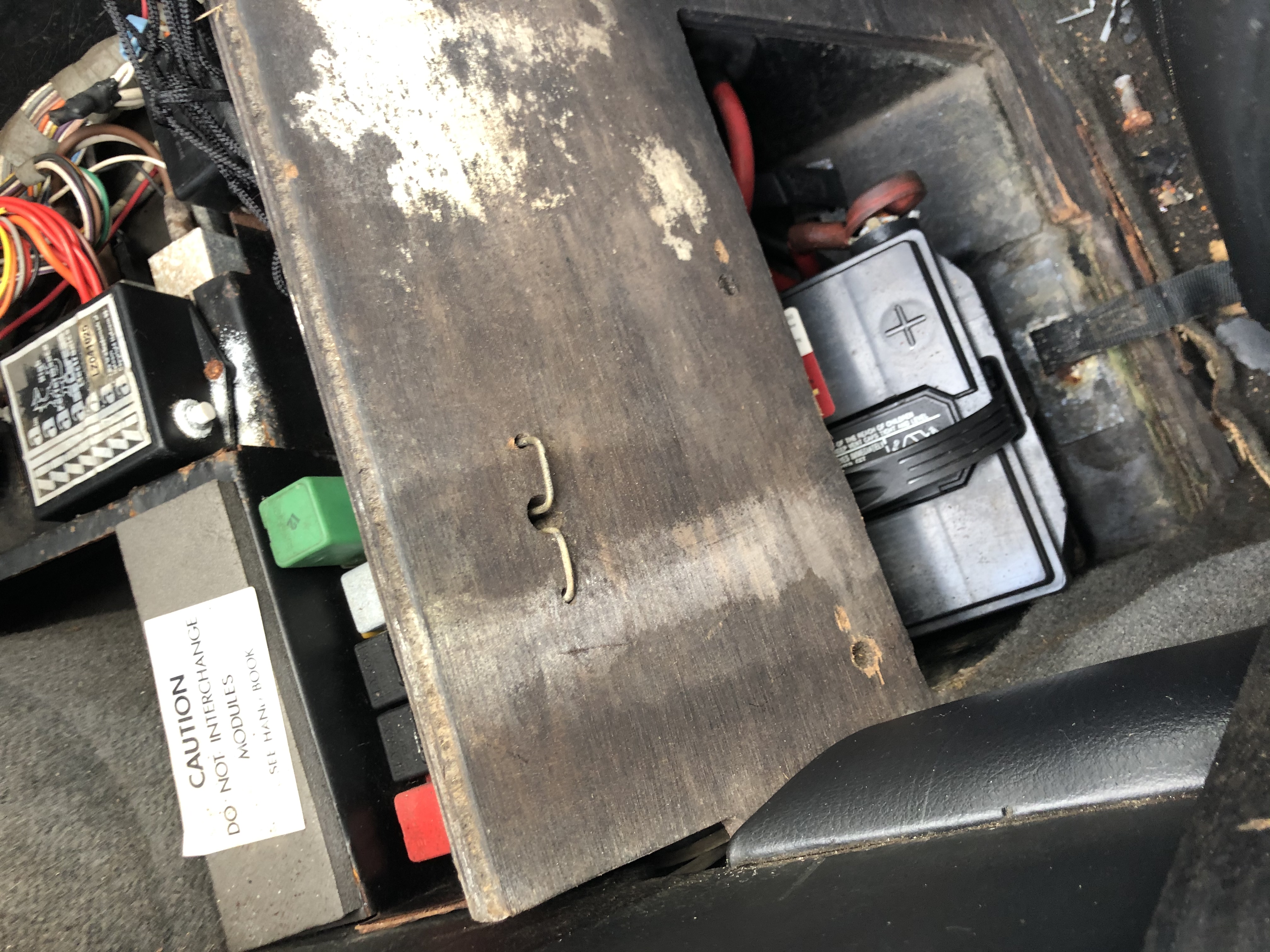

Found the car still has its battery which was still connected and very very flat! Also found an upgrade box fitted too? Loose sill needs sorting too.
Ecu
Battery

Postby andyd » Tue Sep 01, 2020 10:16 pm

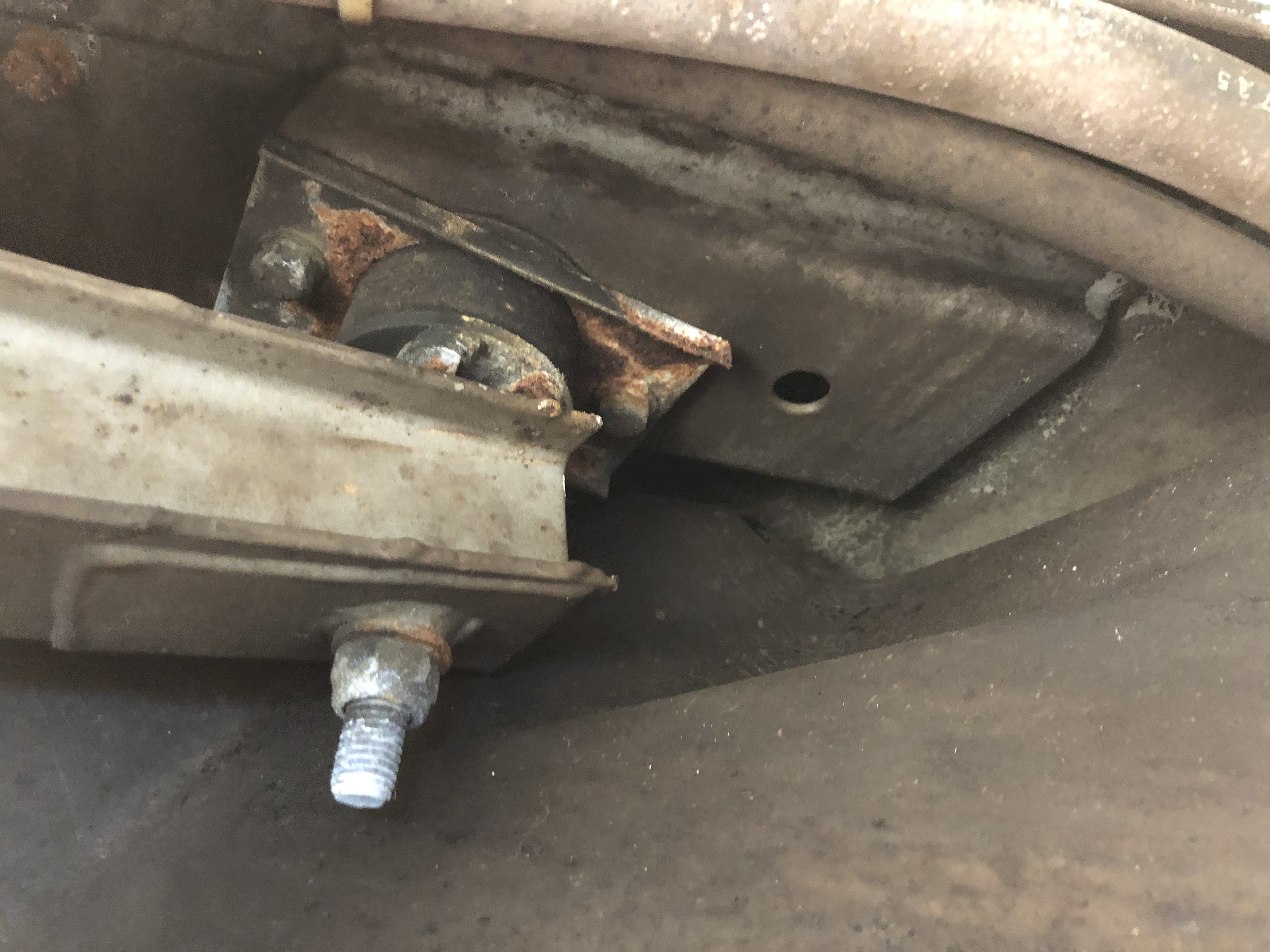

LCA's and mild steel brackets don't look pretty, but overall may not be terrible from those pics?
