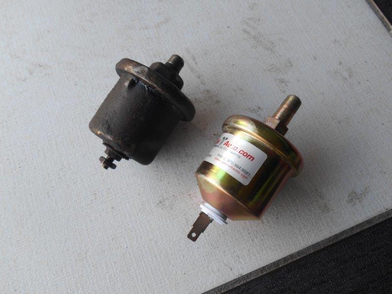

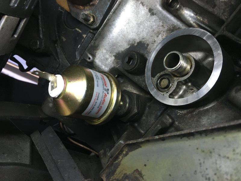

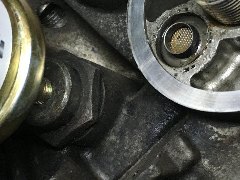

New oil pressure sensor
Nevertheless, it does not screw everything, please see picture below. Does this happen to anyone else? (I hope it won’t leak oil)

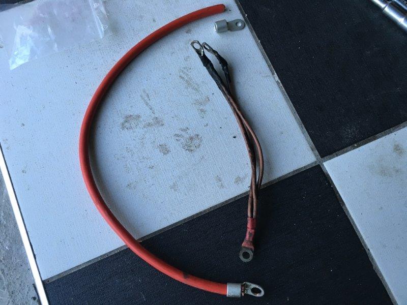

New wire from the starter to the alternator bigger and longer to avoid heat from the exhaust pipe

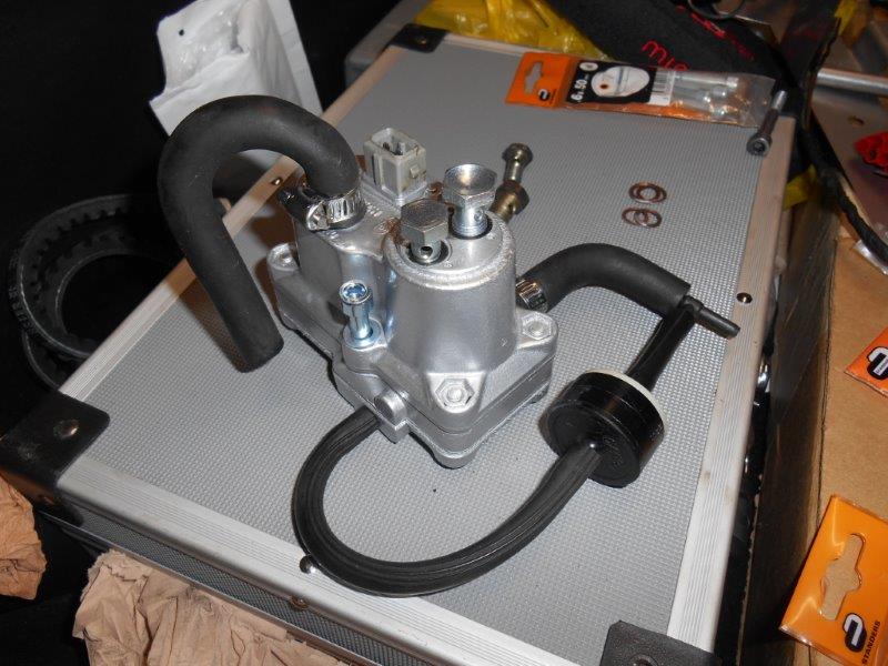

Postby Domi » Tue Feb 16, 2016 9:32 pm

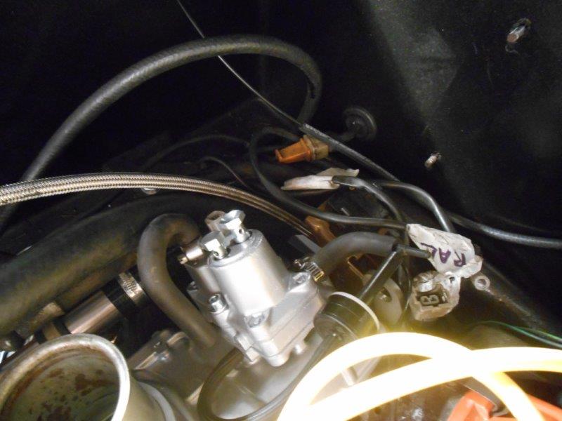

WUR cleaned

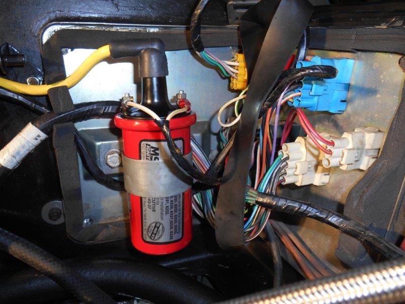

Postby Domi » Thu Feb 18, 2016 7:53 pm

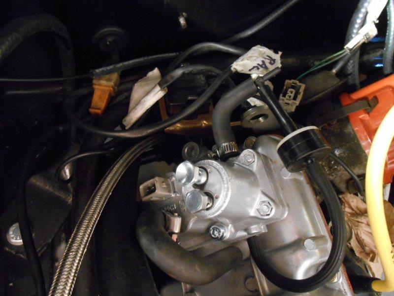

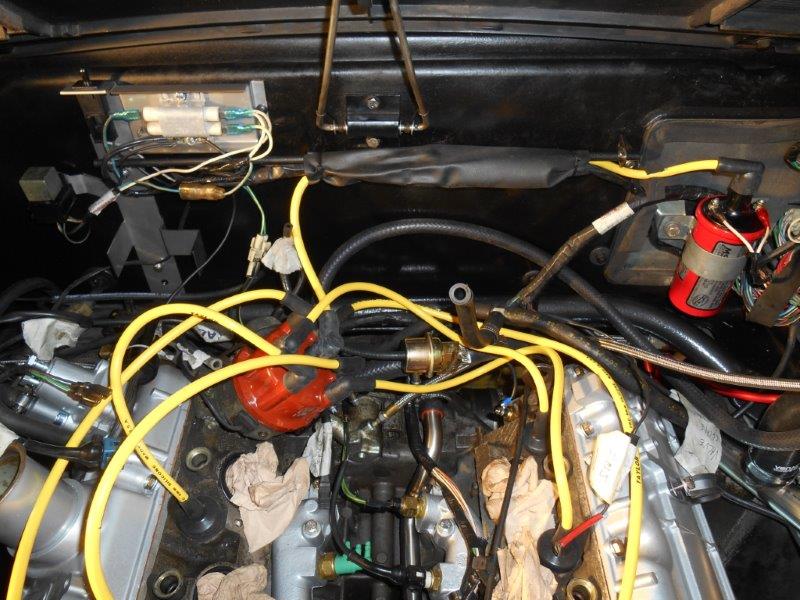

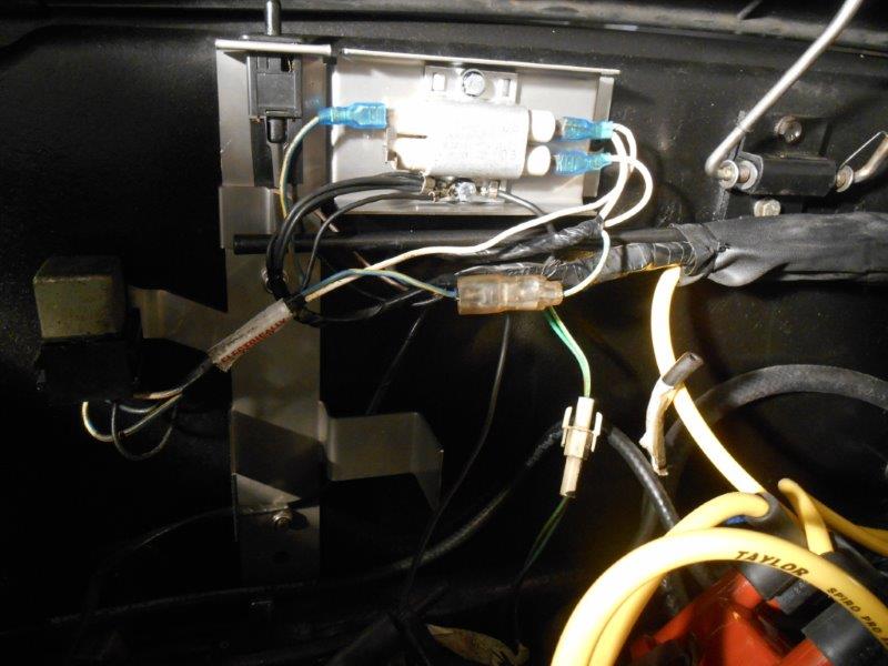

The stainless bracket is back in the engine compartment, and a new coil
Posts: 1004

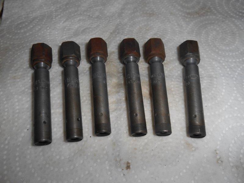

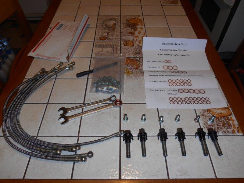

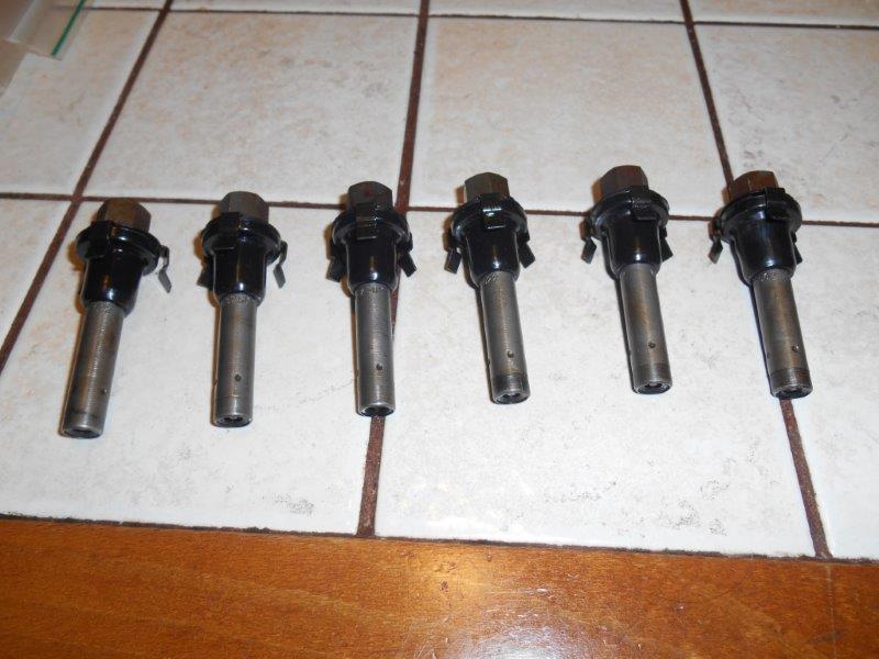

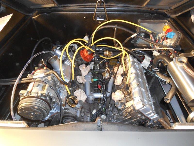

Postby Domi » Mon Feb 22, 2016 9:32 pm
Injectors are ready for a new seal and a new hook

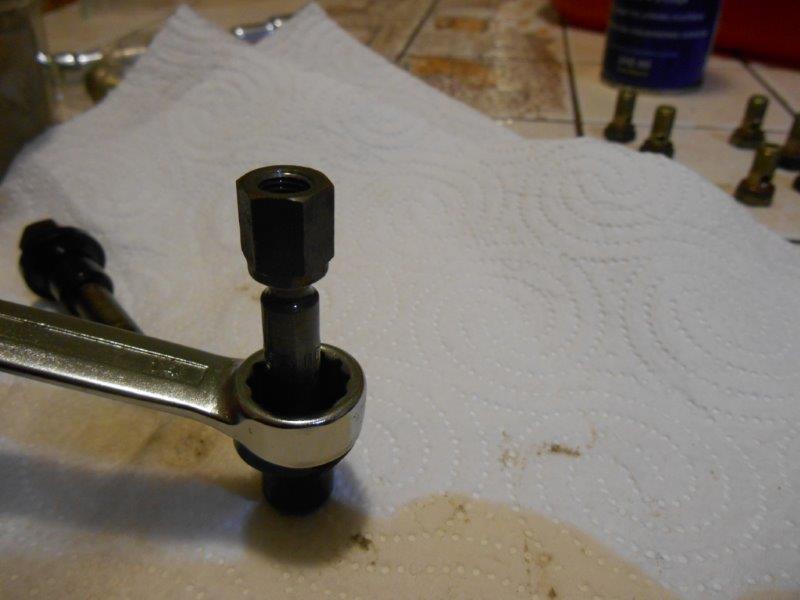

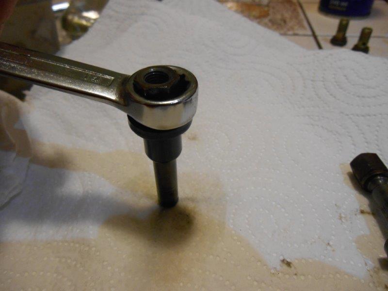

Not so easy to remove and to put on the new one
Soak in WD40 and with the help of a 14 wrench push to remove the seal

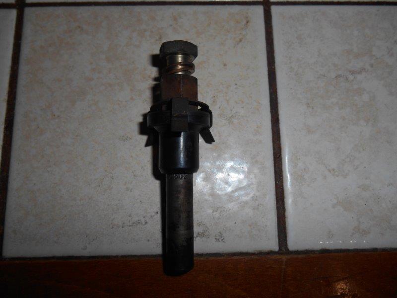

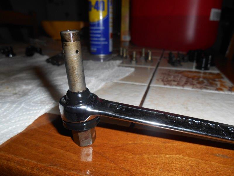

Same thing in reverse to put the new seal

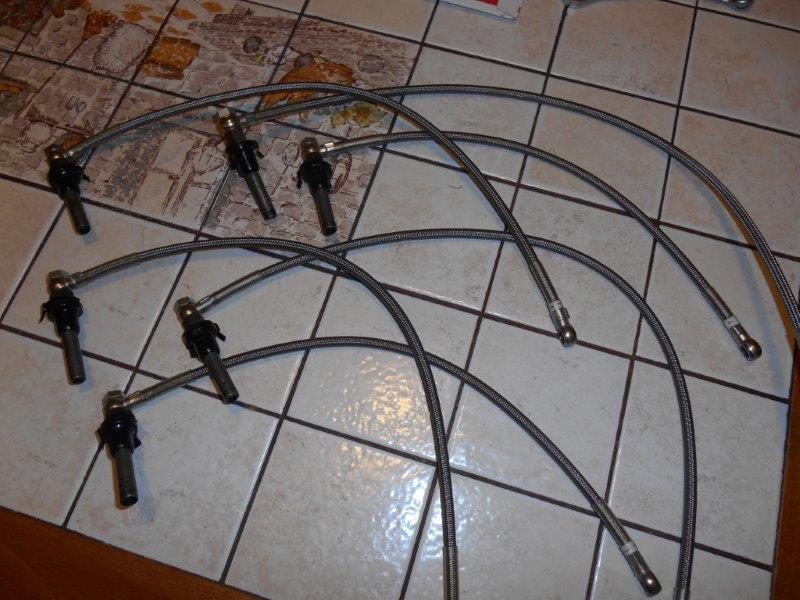

Injectors are finally ready

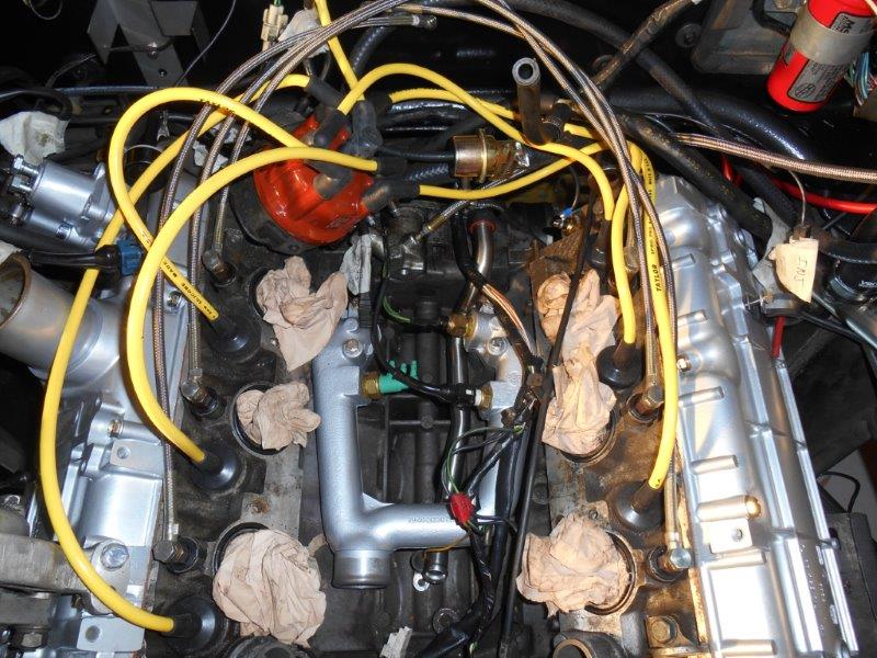

With the new stainless steel fuel lines
In the engine compartment
Posts: 1004
Postby Admin-bloke » Mon Feb 22, 2016 9:46 pm
Looking great there.
For replacing injector seals, I use a deep socket and a rubber headed hammer to drift them off.
viewtopic.php?f=17&t=119&start=20
It looks like you're almost there
