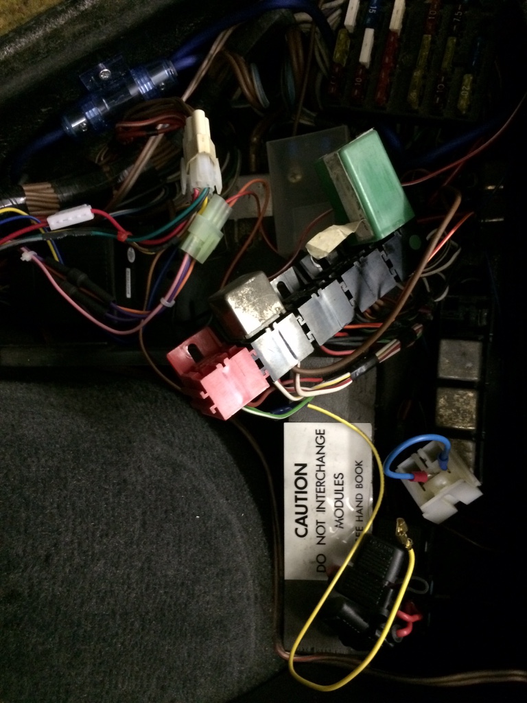

Postby RobvdVeer » Wed Oct 08, 2014 4:12 pm
Current state of my relay bay. I had to lift all of them to find out what's happening.
The front interior light was incorrectly wired. This caused a bad connection on the entire lighting segment at a certain setting. But i only found out after tracing the wiring. PO has made some, errm 'improvements' to the relay wiring causing my delay module to backfire, slowly draining the battery instead of saving it. There are all sort of surplus wires coming and going from the delay module to the A/C panel resistor (???).
Tomorrow i'm going to restore it all back to factory. At least i've found the cause!
Postby ALEXAKOS » Wed Oct 08, 2014 4:55 pm
You're da man Rob! But are you sure the factory setting is the best way out? Why would the PO bypass it that way? Maybe as soon as you go factory, you encounter other faults the PO was trying to save.
Postby RobvdVeer » Wed Oct 08, 2014 5:30 pm
At least the documentation will match the car then.
Postby RobvdVeer » Wed Oct 08, 2014 5:35 pm
And further more. All previous mods made by the PO have not proven to be a positive change.
