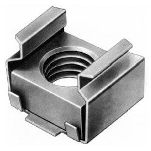

I've used cage nuts to replace some rivnuts with good success, drill out the duff riv-nut, file the hole square and insert the cage nut from behind the panel.
This can only be done where you have access to the rear of the panel for example the rear fascia and the cover panels under the bonnet.
They are available in stainless, just search online, no special tools required just a pair of decent pliers to squeeze them into the square hole.
Because they are stainless (or even mild steel) they are not so prone to the corrosion and seizing which effects riv-nuts, and because they are square they are much less likely spin if they do become a little stuck.
For those not familiar with cage nuts here's a picture...
J

I have some, as I used them during a bike project previously. Handy things, I agree. They will also grip a non-round slightly knackered hole, which could work here...
