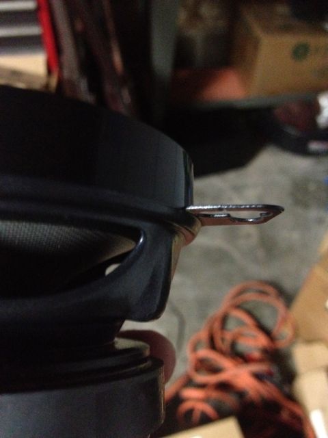

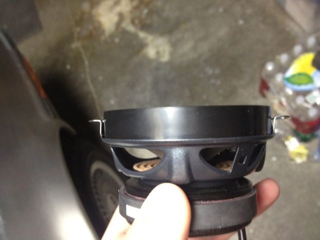

InoX wrote:Fitted 5.25" speakers in the back - not exactly drop in replacements. Had to cut back the carpet and foam to get to the fibreglass then had to shim the magnet on the bottom to get the things to fit.
Made the mistake of getting front speakers with protruding tweeters which mean't I had to space them away from the dash. Hours spent trying to guide the screws and washers up vertically whilst on my back at the same time trying to prevent the fasteners from being pinched by the magnets :x
What speakers did you go with for the rear? (I used Infinity Kappa 52.9i on my car, and they clamped in without the need for any fettling).
For the fronts, did you bend the mounting tabs up and out as per the below pics, that should help a little with the protruding tweeter.

Bent the tabs slightly placed a half nut 1/4 way down the stud to space the speaker. Then bent the tabs up a bit.
