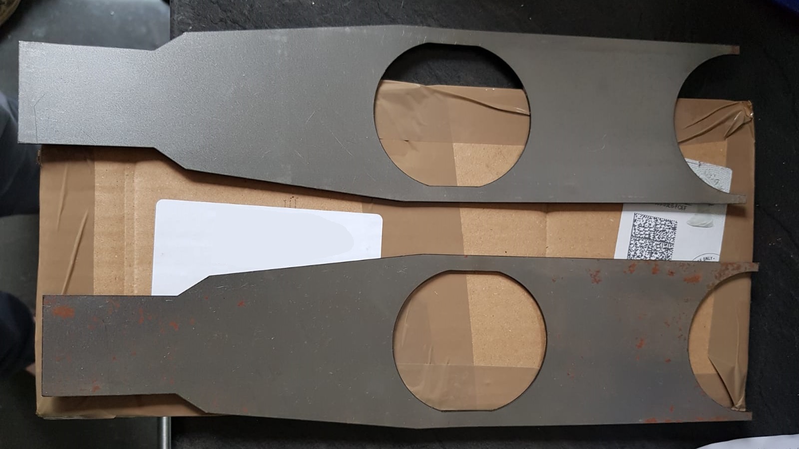

Delta Delorean wrote:I don't see any reinforcing plates for the LCAs for sale one the website. Does Arran sell them " under the table" ? If they are for sale there is no point making them myself
Yes ;) - https://www.deloreango.com/nl/lower-con ... plate.html
I haven't taken a photo of them yet, but it's a laser cut steel plate - you would need 2.
Re: MEC'S EPIC RESTORATION
Postby Dan 6511 » Mon Oct 29, 2018 2:25 pm
These are the plates from the club shop:

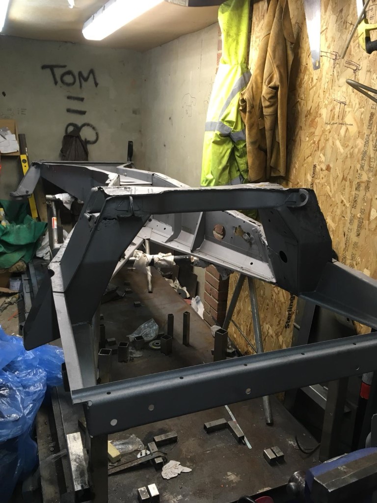

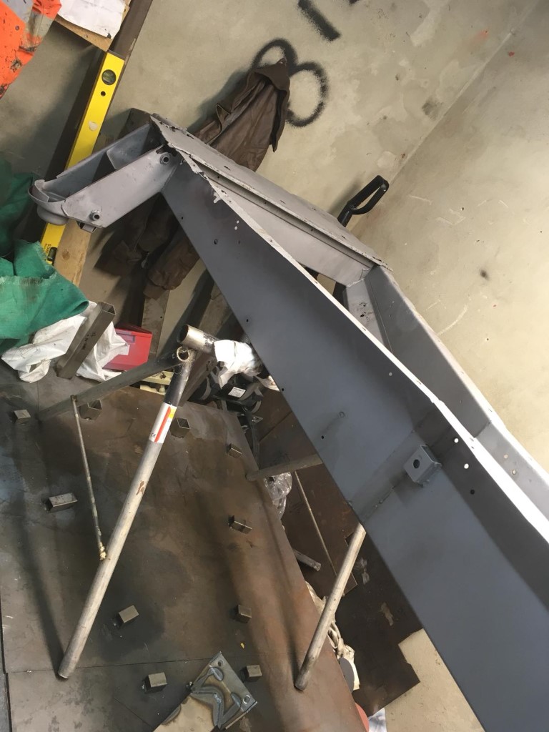

Hi all
A small update for you, the chassis as you know is now at Alex's, he has it all set up and has started work ...
IMG-20181028-WA0012 (Medium).jpg (175.7 KiB) Viewed 3551 times
IMG-20181028-WA0013 (Medium).jpg (171.21 KiB) Viewed 3551 times
IMG-20181028-WA0014 (Medium).jpg (140.14 KiB) Viewed 3551 times

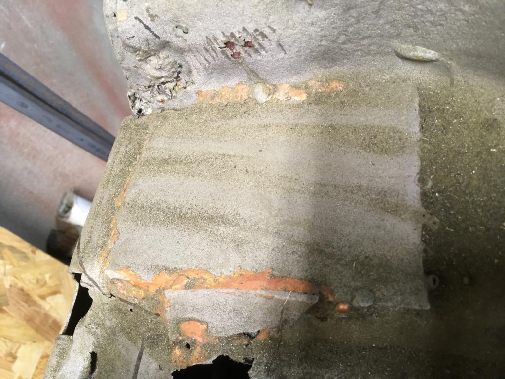

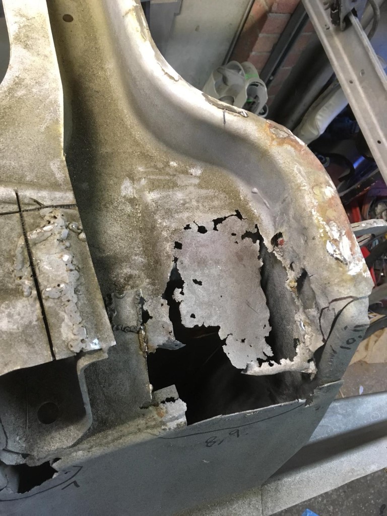

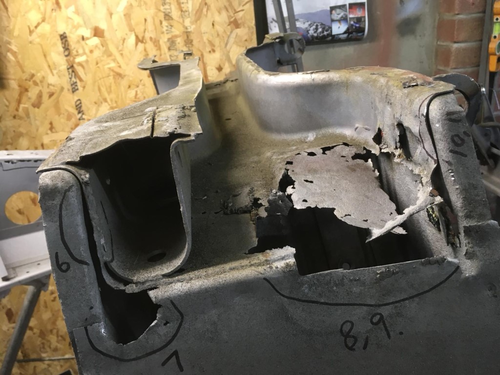

As you can see all of the repair areas have been marked up no matter how big or small, the total is around 70 repairs !

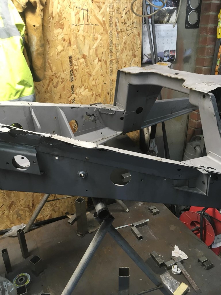

the following pics are the 1st area that has been started, this is under the rear dog bone section (now removed), poor previous repairs have caused a lot of the problems on my chassis, so these are all being removed and done properly.
IMG-20181028-WA0006 (Medium).jpg (209.43 KiB) Viewed 3551 times
IMG-20181028-WA0005 (Medium).jpg (172.43 KiB) Viewed 3551 times
IMG-20181028-WA0004 (Medium).jpg (205.36 KiB) Viewed 3551 times

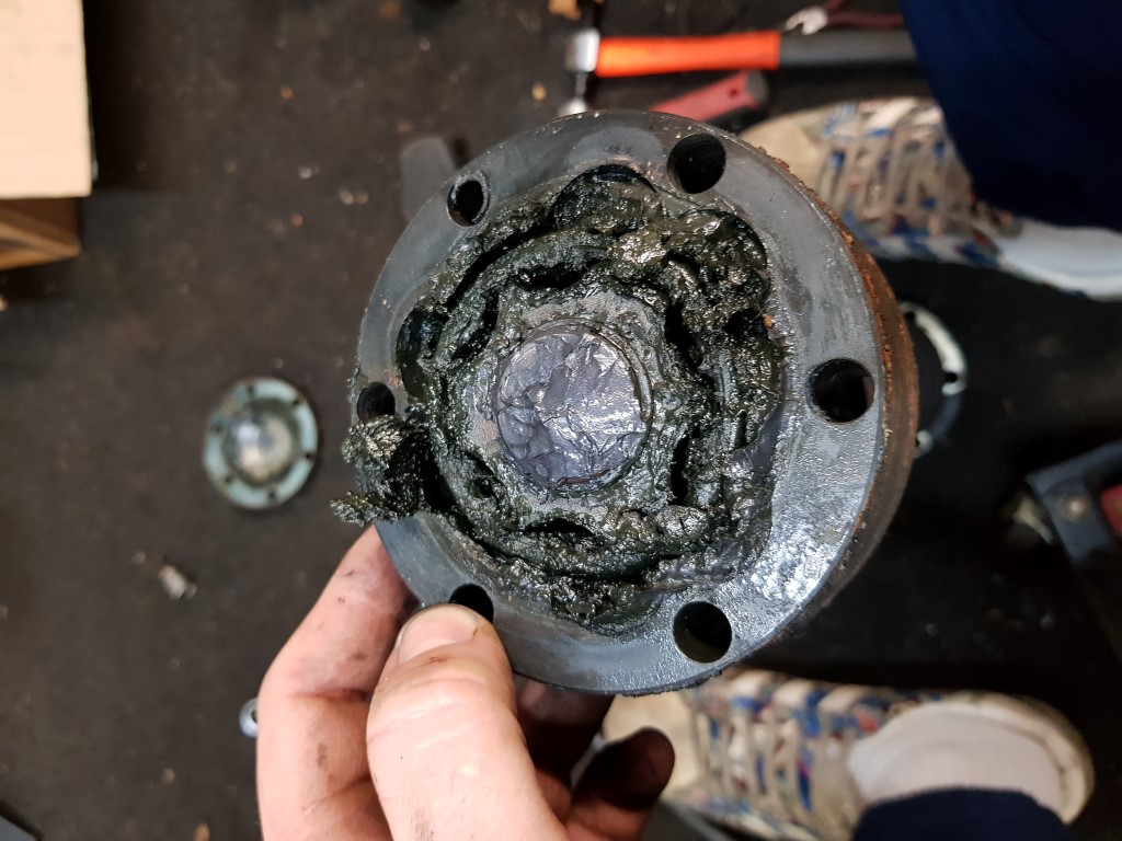

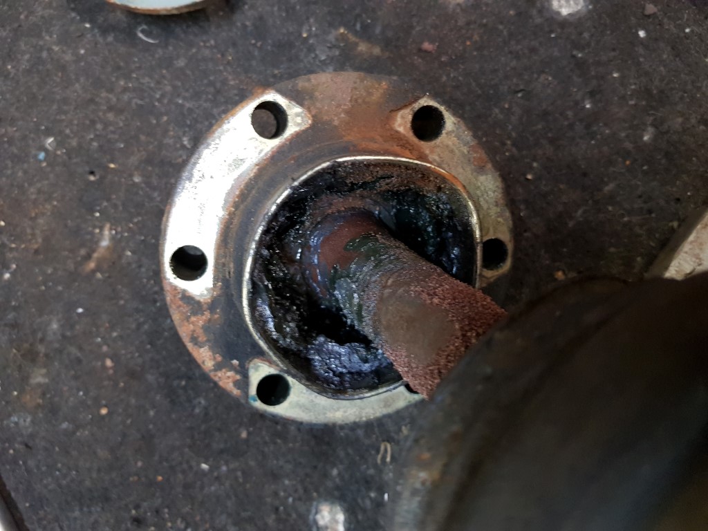

I have also been doing a bit of work in the garage, i now have the front wheel bearings removed from the front hubs and also driveshafts disassembled, these are a bit worse for ware, with not a lot of grease in them..
20181101_122457 (Medium).jpg (212.35 KiB) Viewed 3551 times
20181101_122505 (Medium).jpg (190.35 KiB) Viewed 3551 times

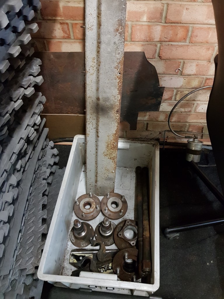

So now i have another batch of stuff to go to the blasters/coaters..
20181102_124021 (Medium).jpg (276.08 KiB) Viewed 3551 times

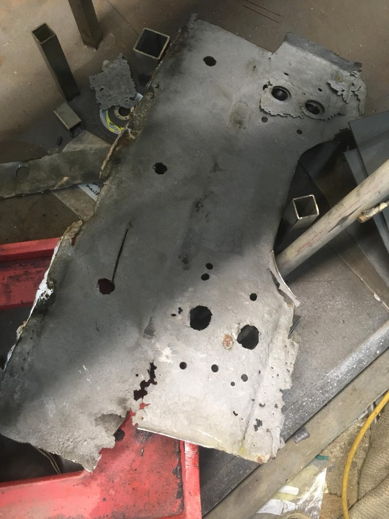

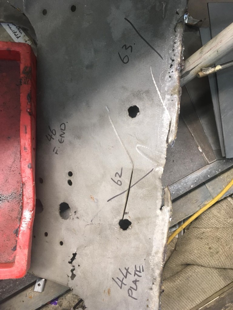

this is the big plate that was "welded" on the front underside ..

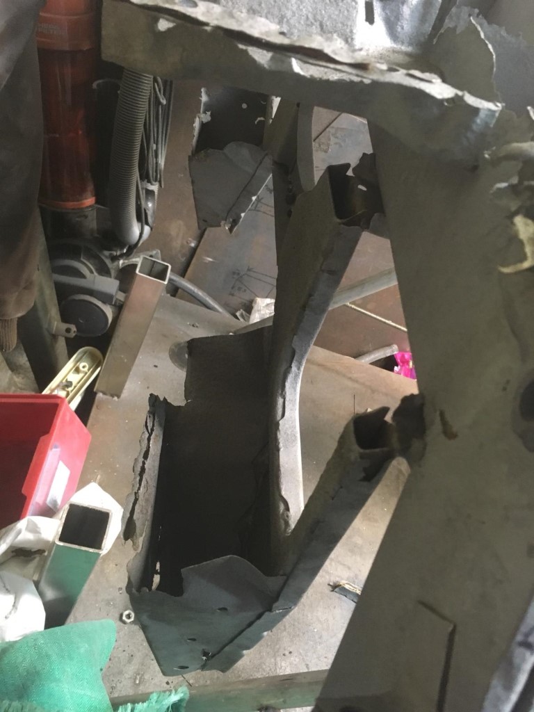

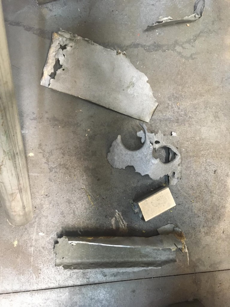

Then the following is what lay beneath or rather what didn't lay beneath...
IMG-20181106-WA0005 (Medium).jpg (180.91 KiB) Viewed 3507 times
IMG-20181106-WA0004 (Medium).jpg (196.15 KiB) Viewed 3507 times

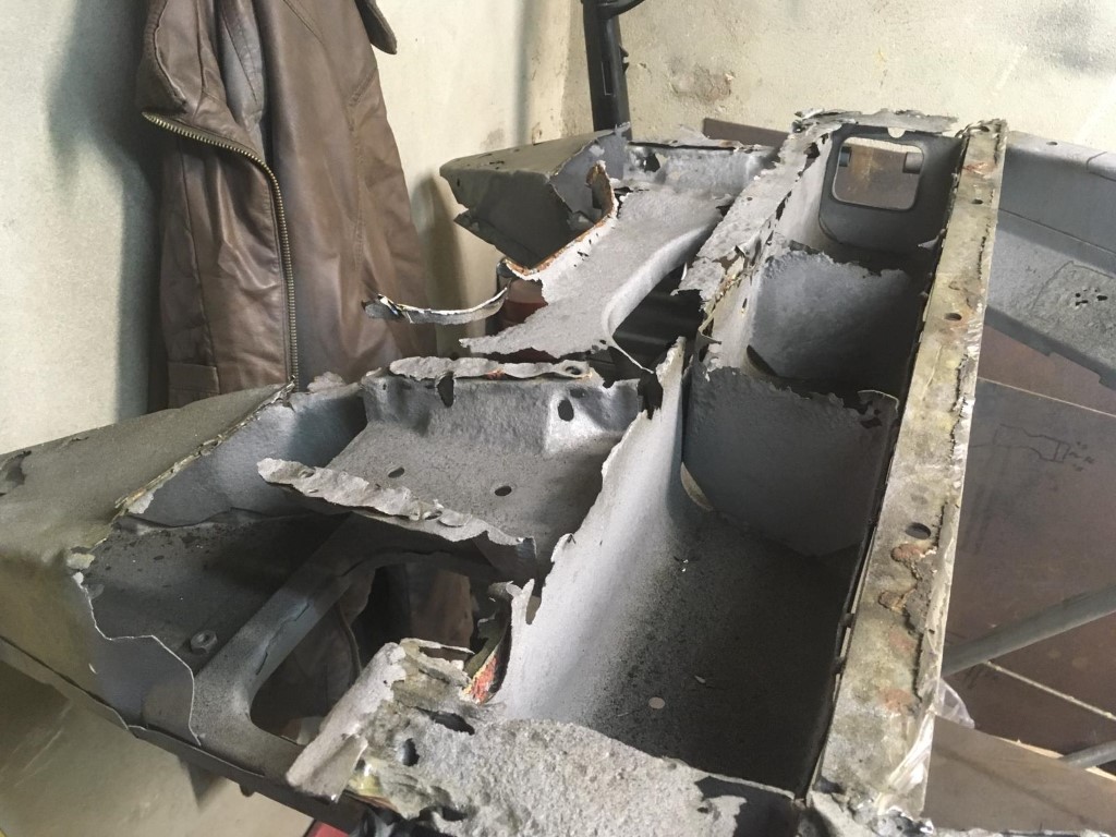

Then the final image below is what happened to the front end after Alex literally lent on it, it was an accident waiting to happen...
IMG-20181106-WA0007 (Medium).jpg (132.25 KiB) Viewed 3507 times
So it turns out all that was holding the front end in the right place was that plate :shock:
I can say that i am Sooooo glad I decided to do a frame off now as i think if it were to be used any more as Julian said on a previous post something very bad would have happened
