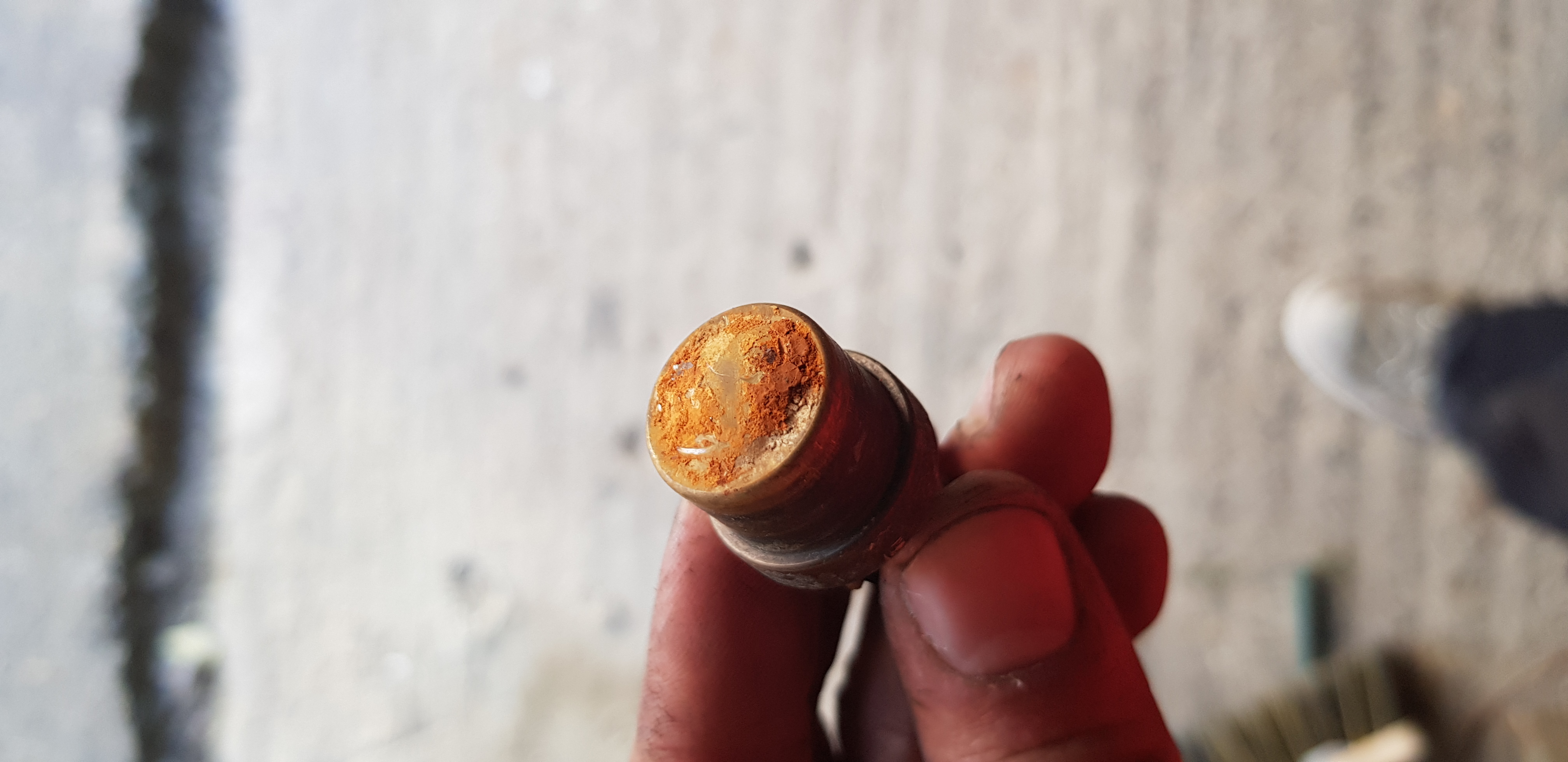

I now have the car running nicely and no heating issues now. I changed the otterstat and bled the system properly (i clearly didnt do it correctly the first time). Now the fans kick in at the 220 line and shut off at the white line between 100 and 220. Happy days. I will be installing a fan switch soon.

Oh here is the old otterstat. Can see why it doesnt work.
