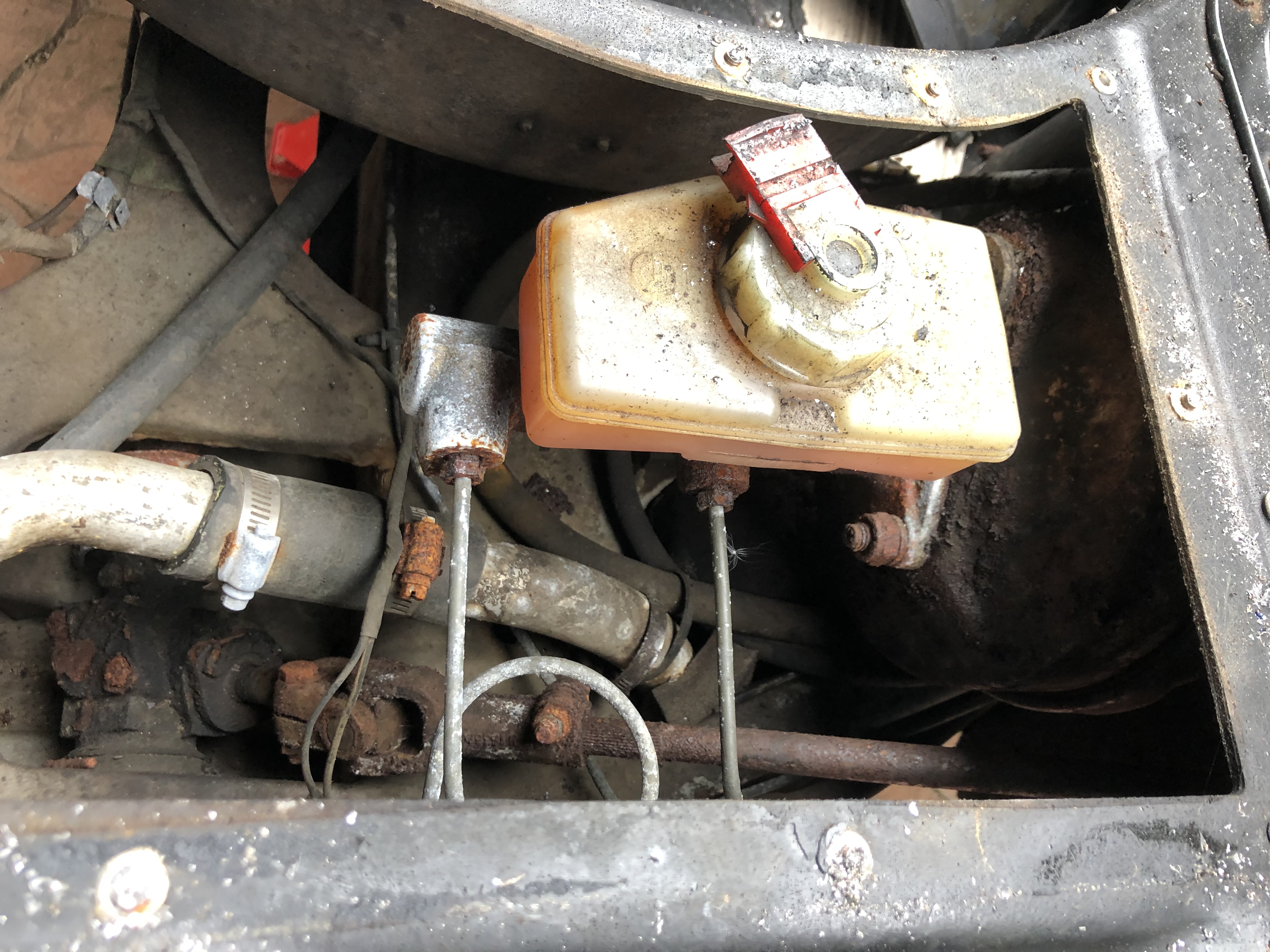

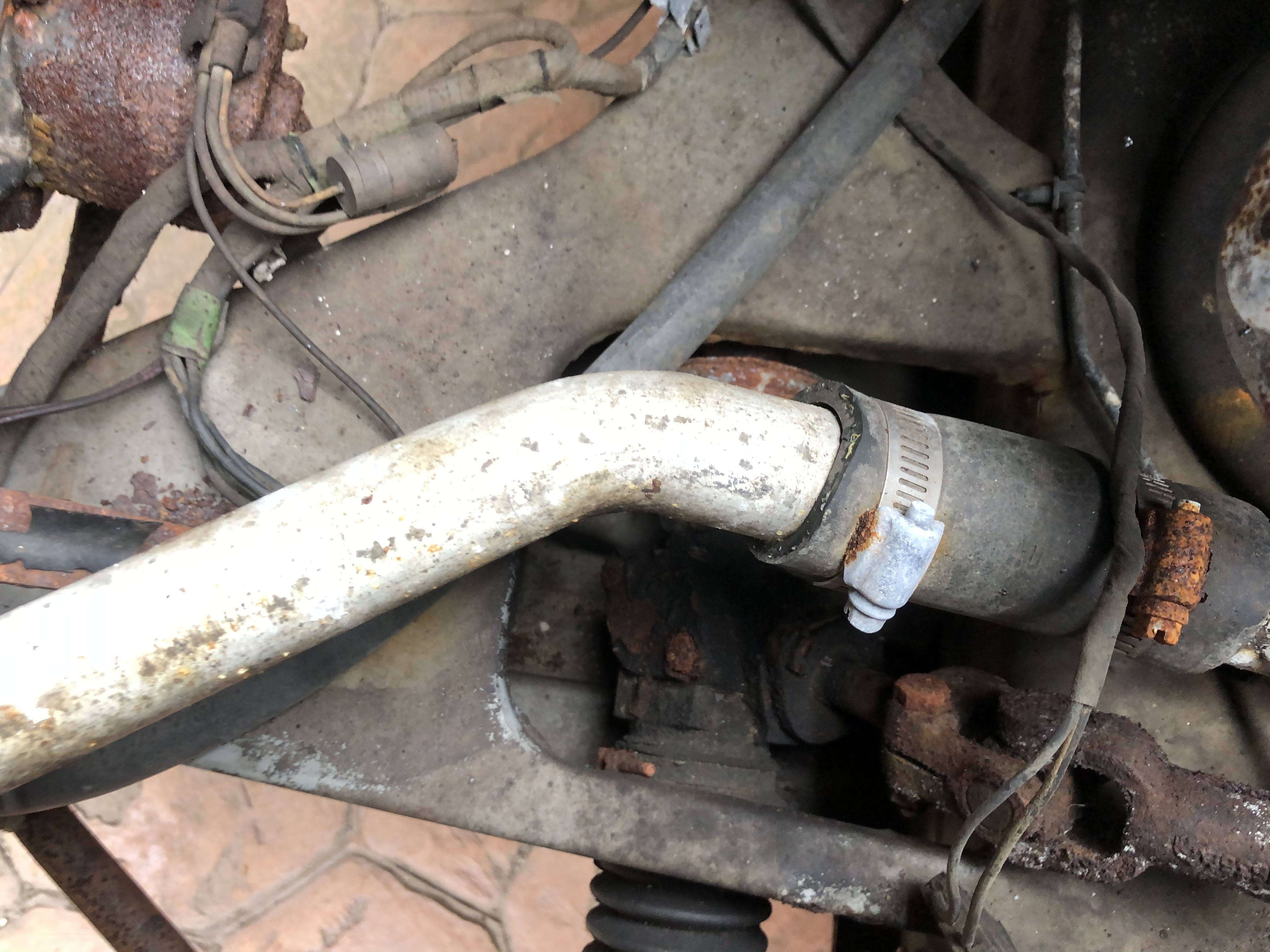

Must admit it is all over the place in terms of what has gone rusty. Took the brake cover off (drilled out) and you can see everything has rust except the chassis which appears ok.

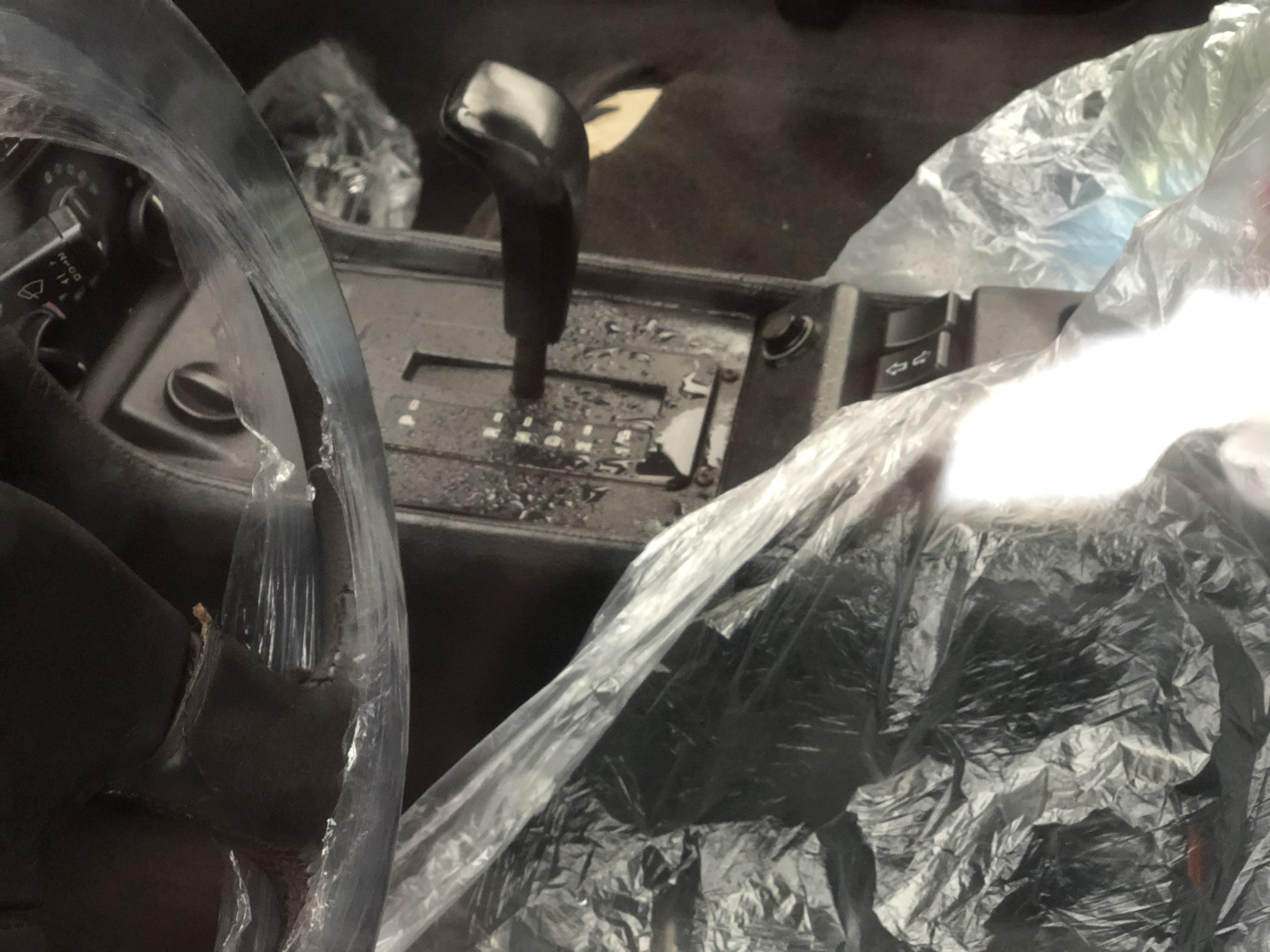

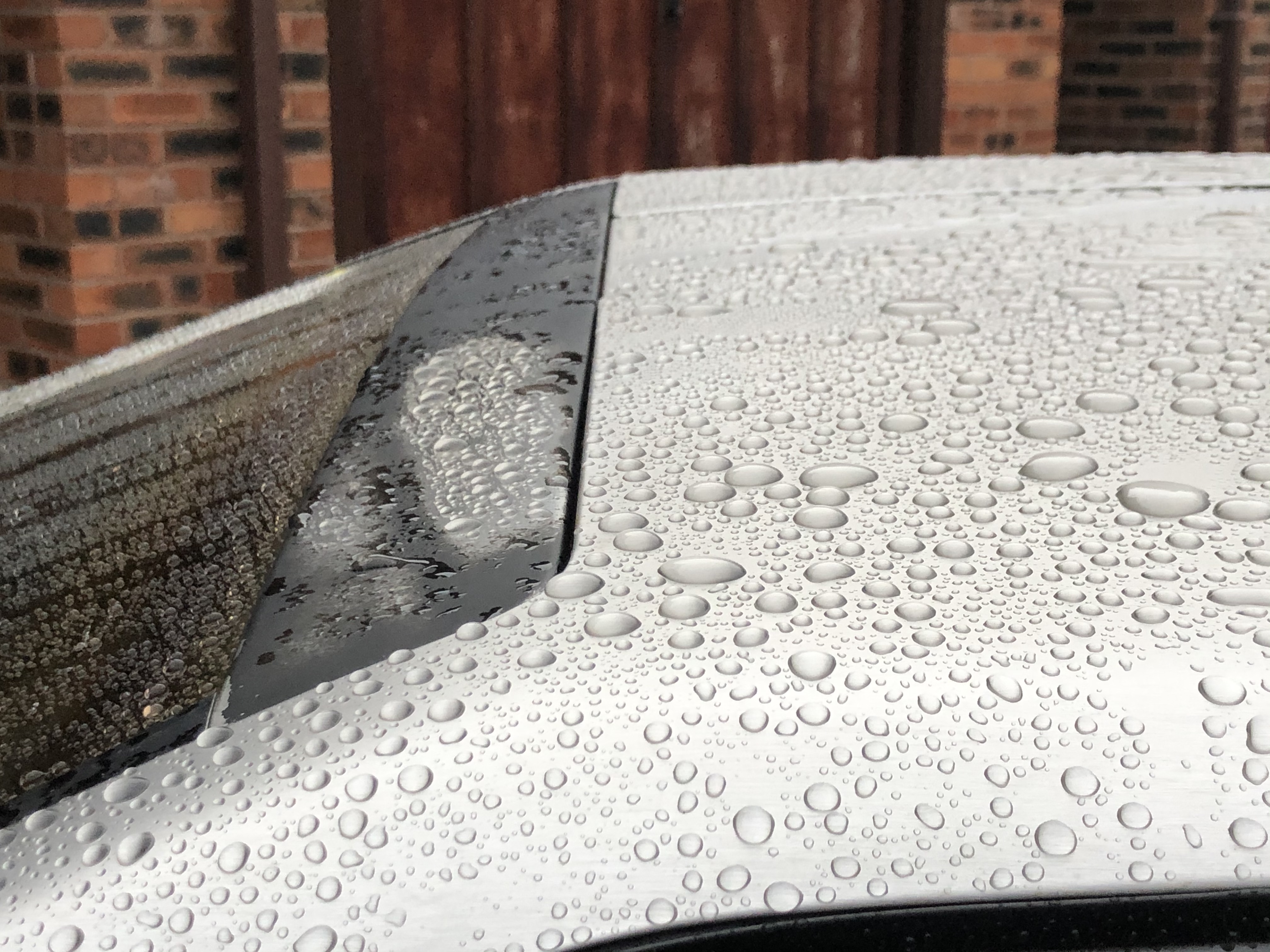

Pictures from a few minutes ago after the rain stopped..
Water dropping onto the shift panel. Been trying the drivers door by key and internally. No joy yet.
All closed
Water

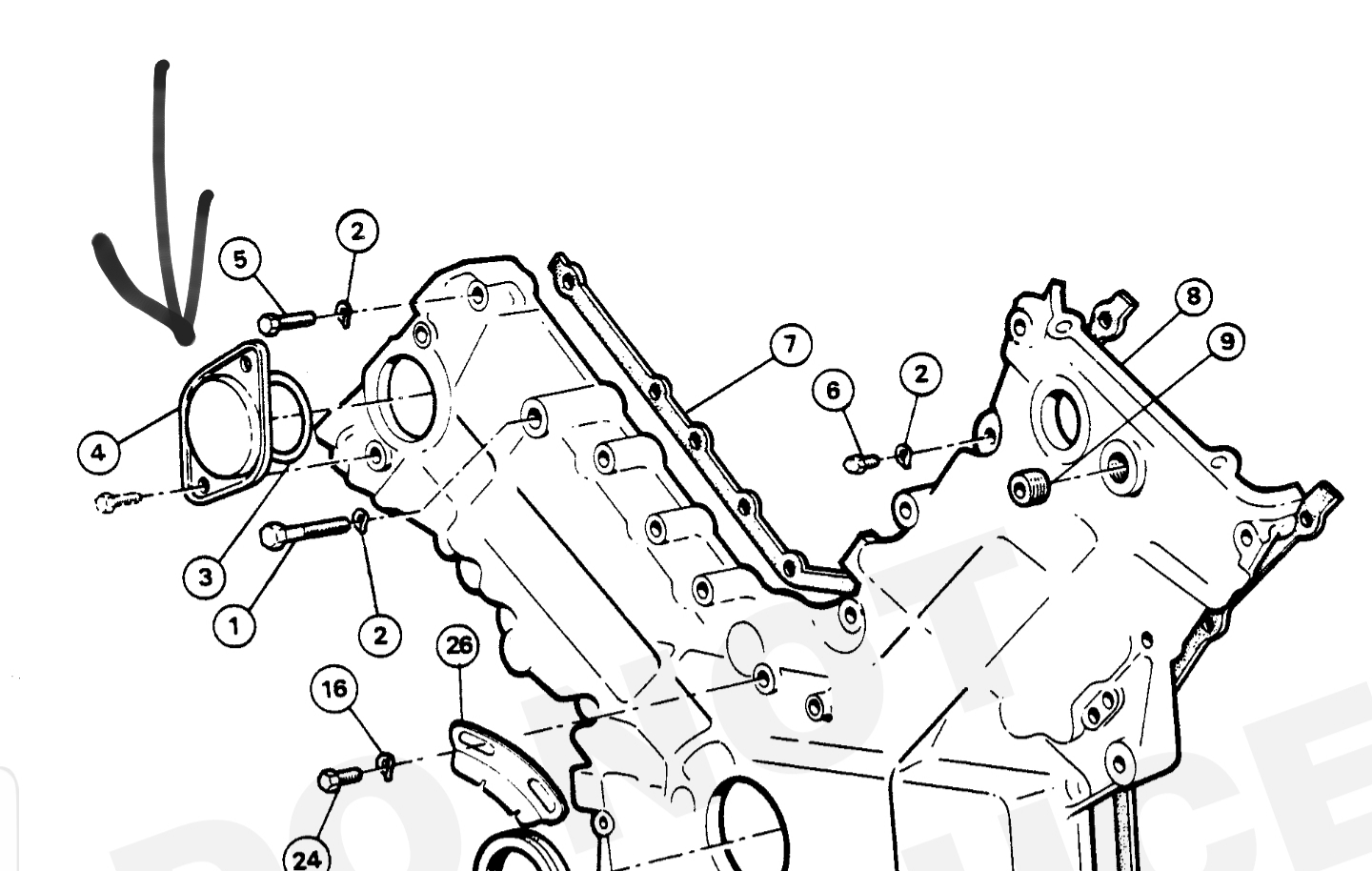

Did you have a look at the chains via the blanking plate yet?
