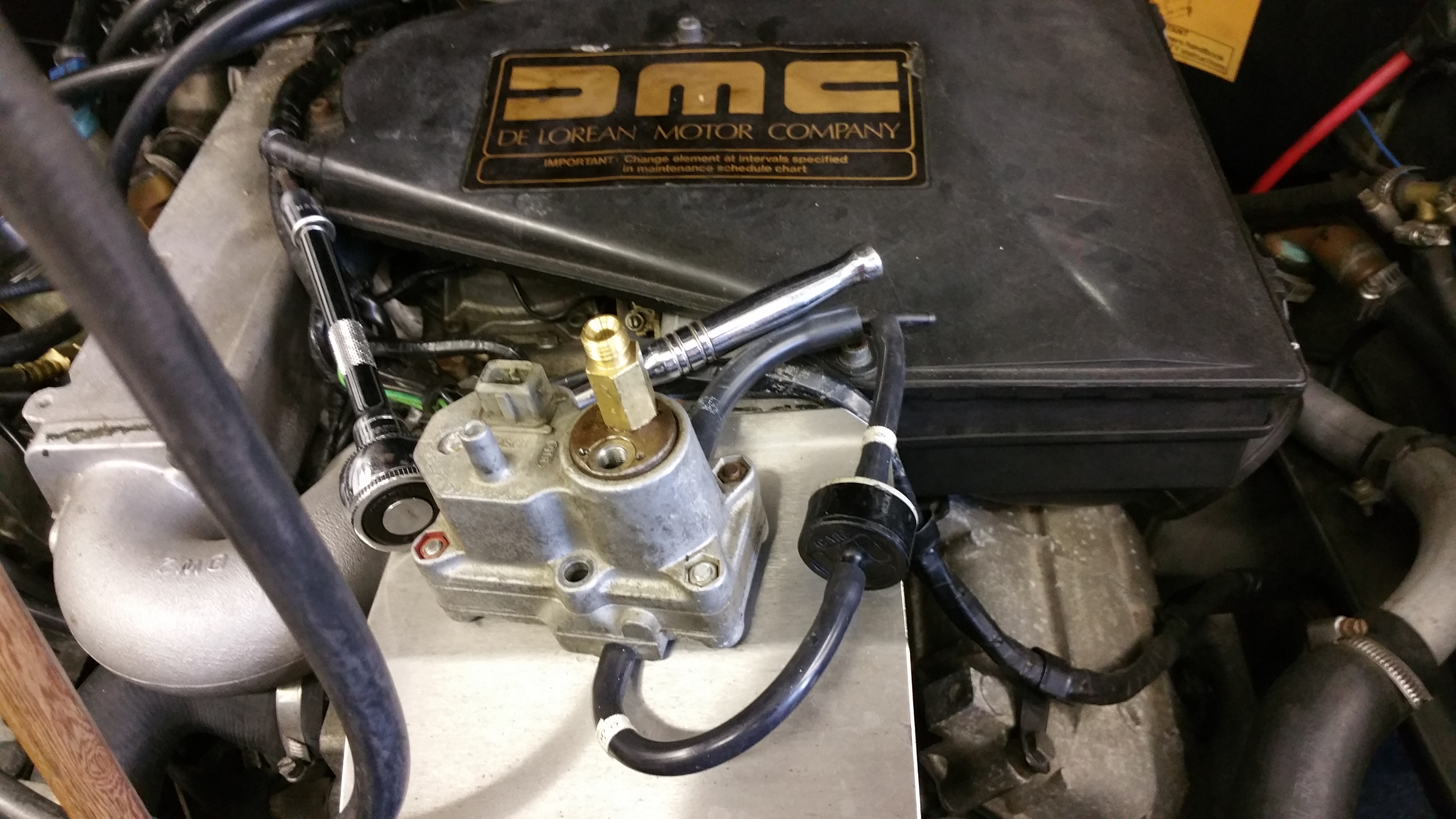

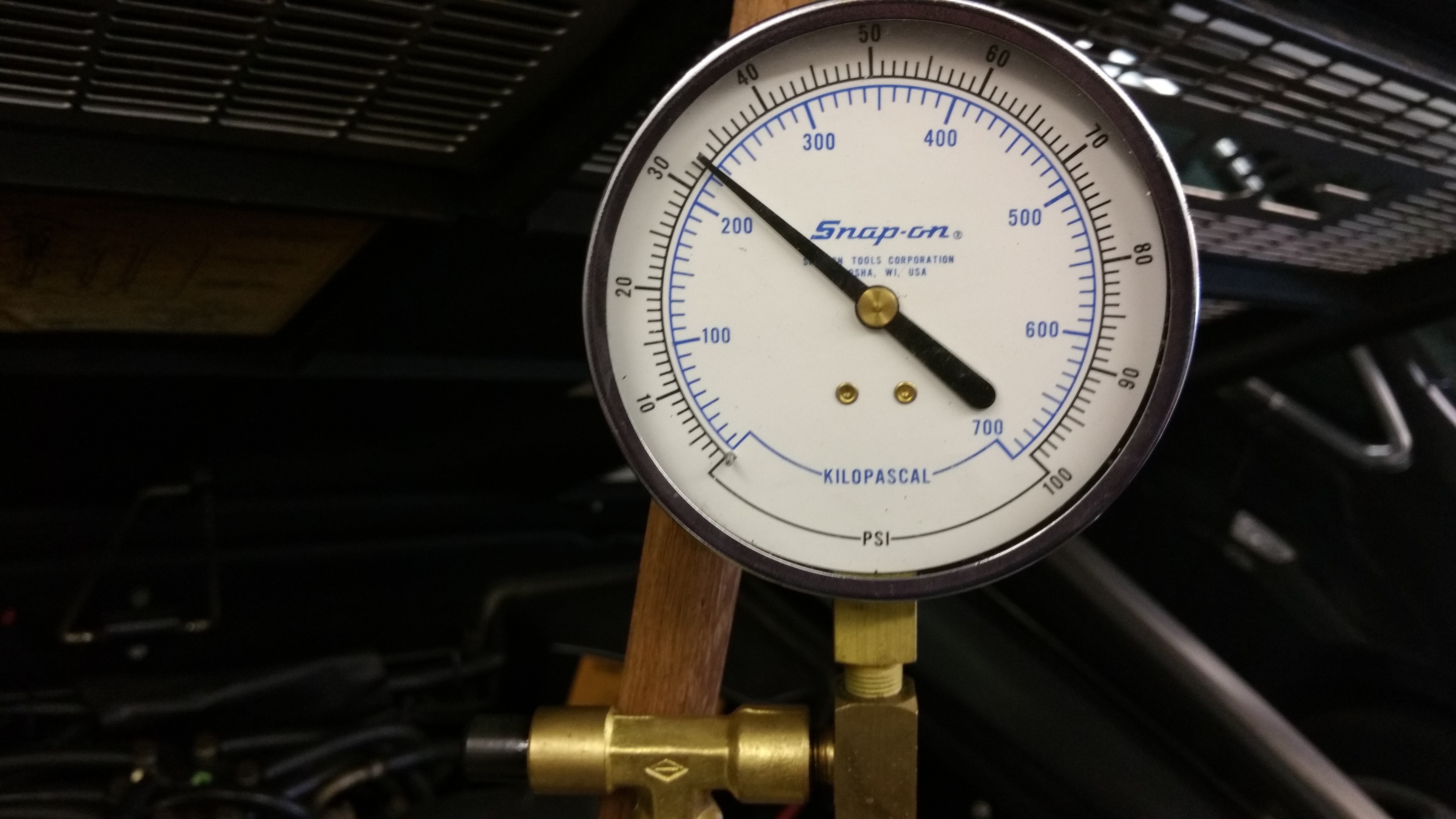

It wasn't plain sailing though, as when I first started the car after its layup, the clouds of fuelly smoke showed a very rich mixture. After diagnostics with a fuel pressure gauge, it was all down to my own control pressure regulator (, which is ironic considering how many I've fixed for others this last year). Fortunately I have a spare (that I usually bring to club tech events) so after swapping it, fuel pressures went back to normal and the engine is now back to normal again. It shows that they can seize after a long time of non use.

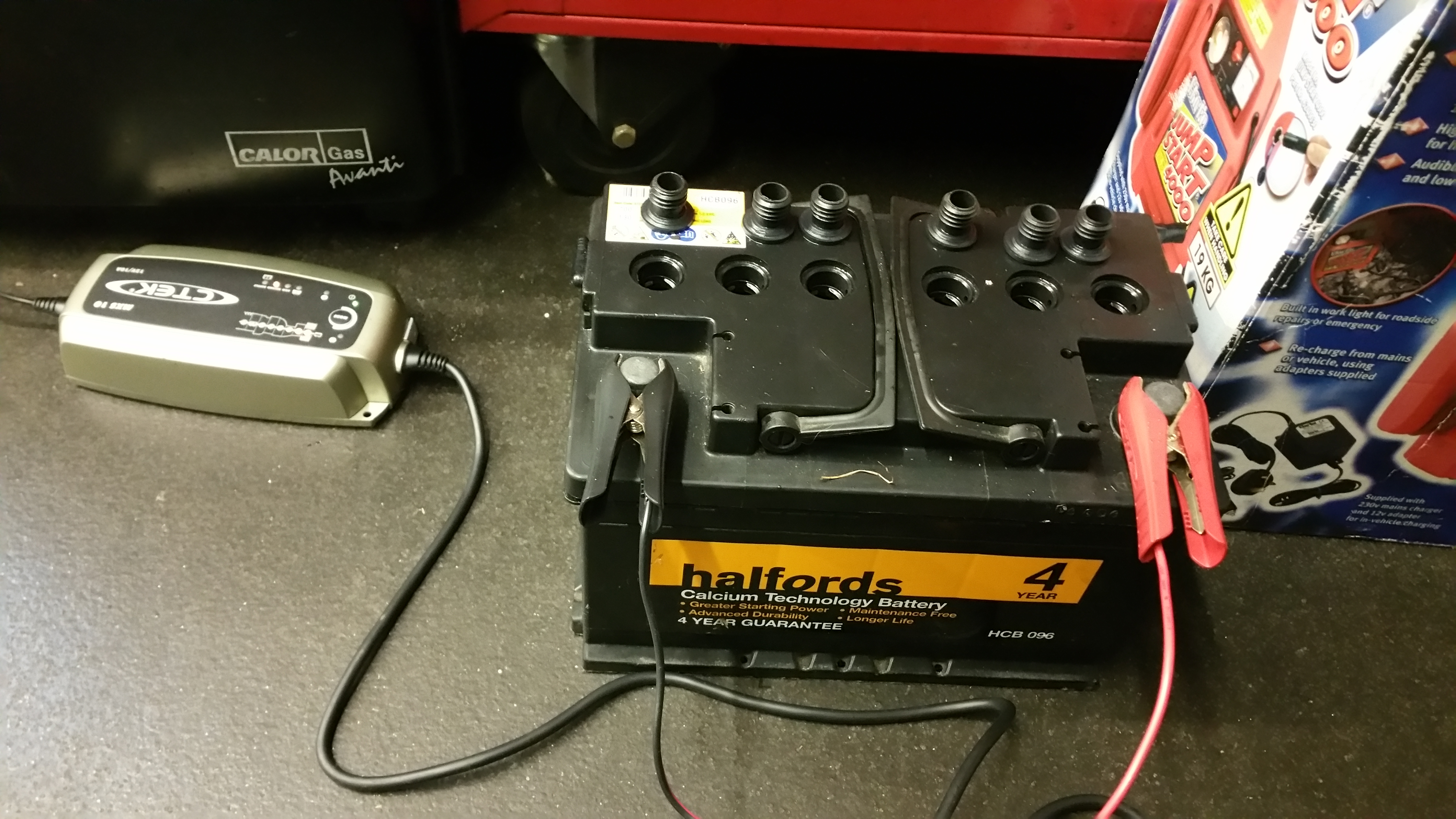

Well, nearly 7 and a half years (Sat May 07, 2011) my (infamous?) Halford's 096 battery has finally given up. I didn't disconnect it from the car from my last drive in it since Eurotec in June. It just managed to start the car so I could park it nearer the wall to winterise it, but it's now at 8.4v! All my fault but work has been stupidly busy this year.
I'm trying and recover it with a ctek desulphation recondition setting and try some "batt aid" but it might be a replacement battery time.
Wish me luck!
I hate spending money. ... :(

Postby TristanC » Sun Dec 02, 2018 8:12 pm
7.5 years isn’t too bad :)
I’ve got a battery maintainer here which recovers batteries..... never used it to recover one, so would be interested in your outcome here.
Out of interest, what will you be doing to winterise it Nick?
I’ll try to use mine when I can - but with roads wet and salty..... it may be a month or two before a dry day comes!
