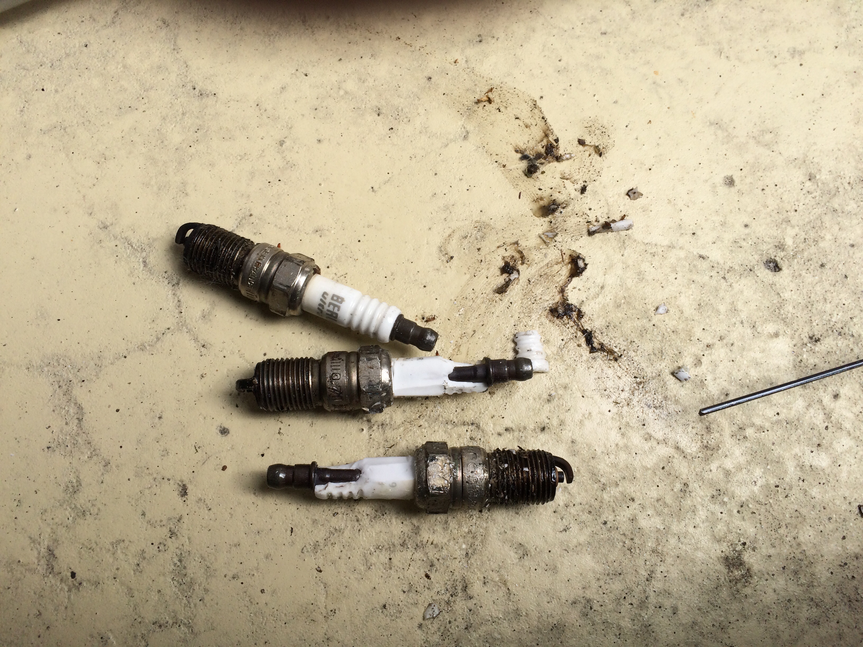

While removing the right hand side spark plugs the ceramic broke, thanks to my EL-Cheapo spark plug socket extension. Fucktards. I had to pick out the pieces on at a time with a greased screwdriver before I even dared getting out the rest of the plug (still screwed in for heavens sake). I could have easily missed that, ending up with a cylinder filled with spark plug fragments. Crisis avoided.

left hand side (right hand exhaust, because I have unconnected headers crossing over) still sounds like a tractor and there's a unhealthy amount of exhaust coming out but at least she runs a lot better than before! And this is just with the new spark plugs...

The broken plugs scared the bejeesus out of me though :shock:
