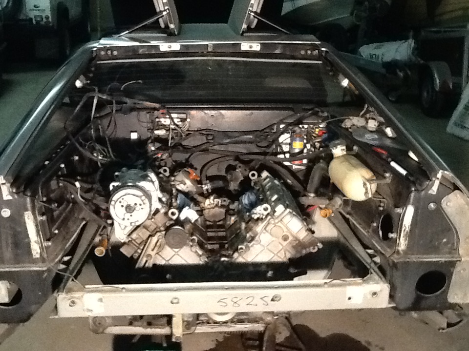

I was thinking to leave the idle valve not installed only hooked on the electric and plug the big hole in the fuel distributeur. And the see what it does. But your sugestion is much better. Can not do it at this moment, all cables are removed from the engine and the alternator and starter have been taken of. So no electric power on the wires.
For now I just move on working on other things that need atention and try to order all parts in one order.
Have started on the roof box repair, but somebody glued the t pannel to the car.
Have taken the steering rack out today, that also needs some work, it just turns to heavy, making the car hard to drive at high speed.

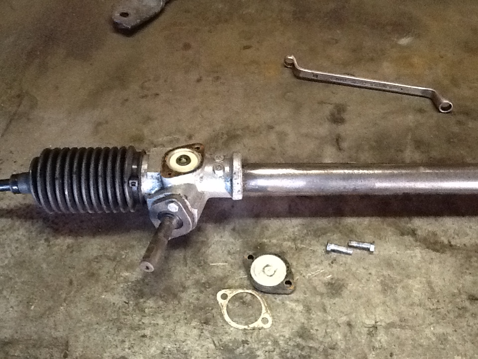

After looking at a video on you tube from Martin i noticed that he can turn the shaft of the steering rack with his hand. This is not possible on mine. Need a pair of pliers to do this. This results in the crapy steering at high speed. I gues the po never drove it very fast in the usa. The bearings and shaft look to be in very good condition. Just need to make some of these shims so everything is not so tight and i can turn the shaft easy. Don't think the club sells these shims?
I will try to make them from gasket paper.

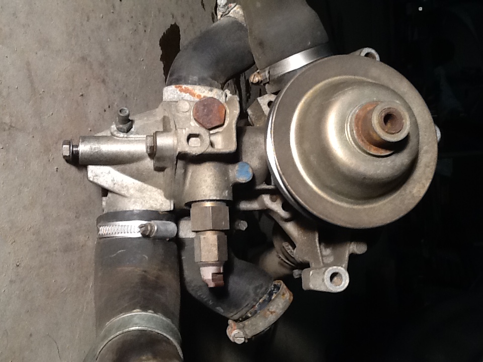

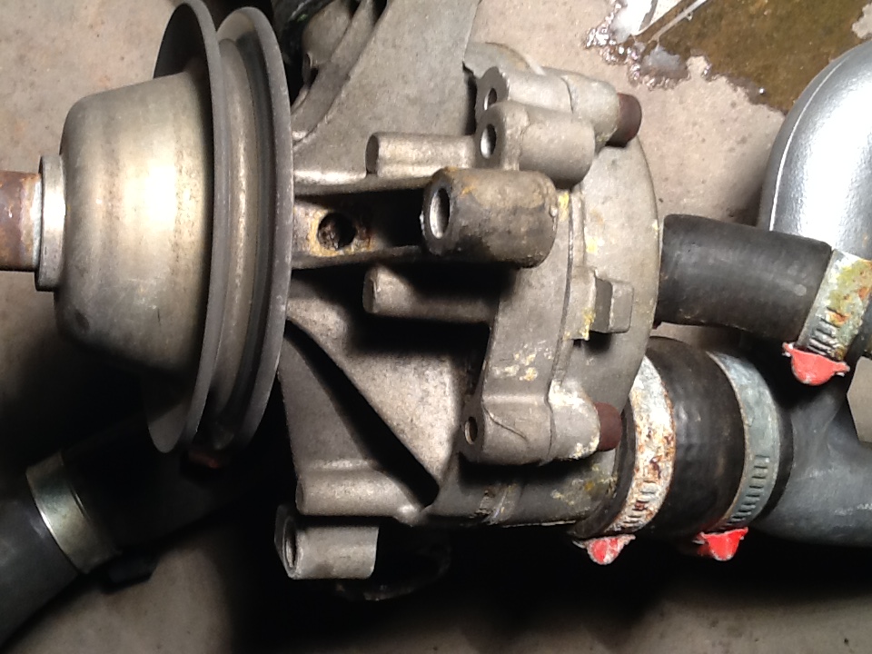

Took the waterpump of today. I was hoping to use it agian but now i can see it is a bit wet around the hole. I have never seen it leak and the bearings feel fine. But having the car this far appart it would not be smart to leave it like this.
I don't like to spend 150€ on a new one. Car has to stay of the road until the first of March. Where can I have the pump rebuild?
Would this be the original pump? Noticed it has some blue spots of paint on them like on other parts of my engine. The back of the pump has the date 1981 on it. The hose clamps are not stainless and have some red paint on the midle bit.
The short hoses are from Kleber.
