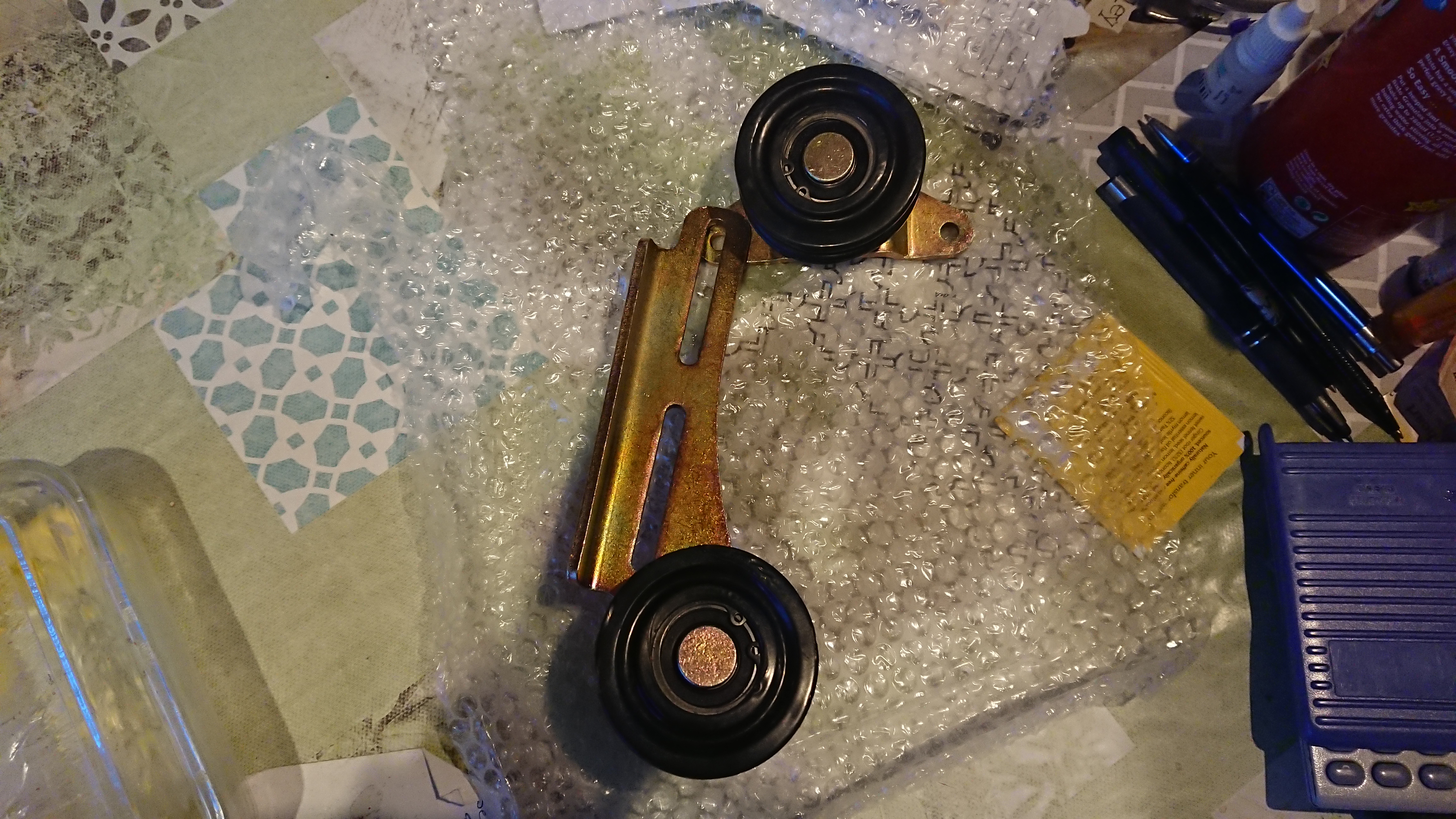

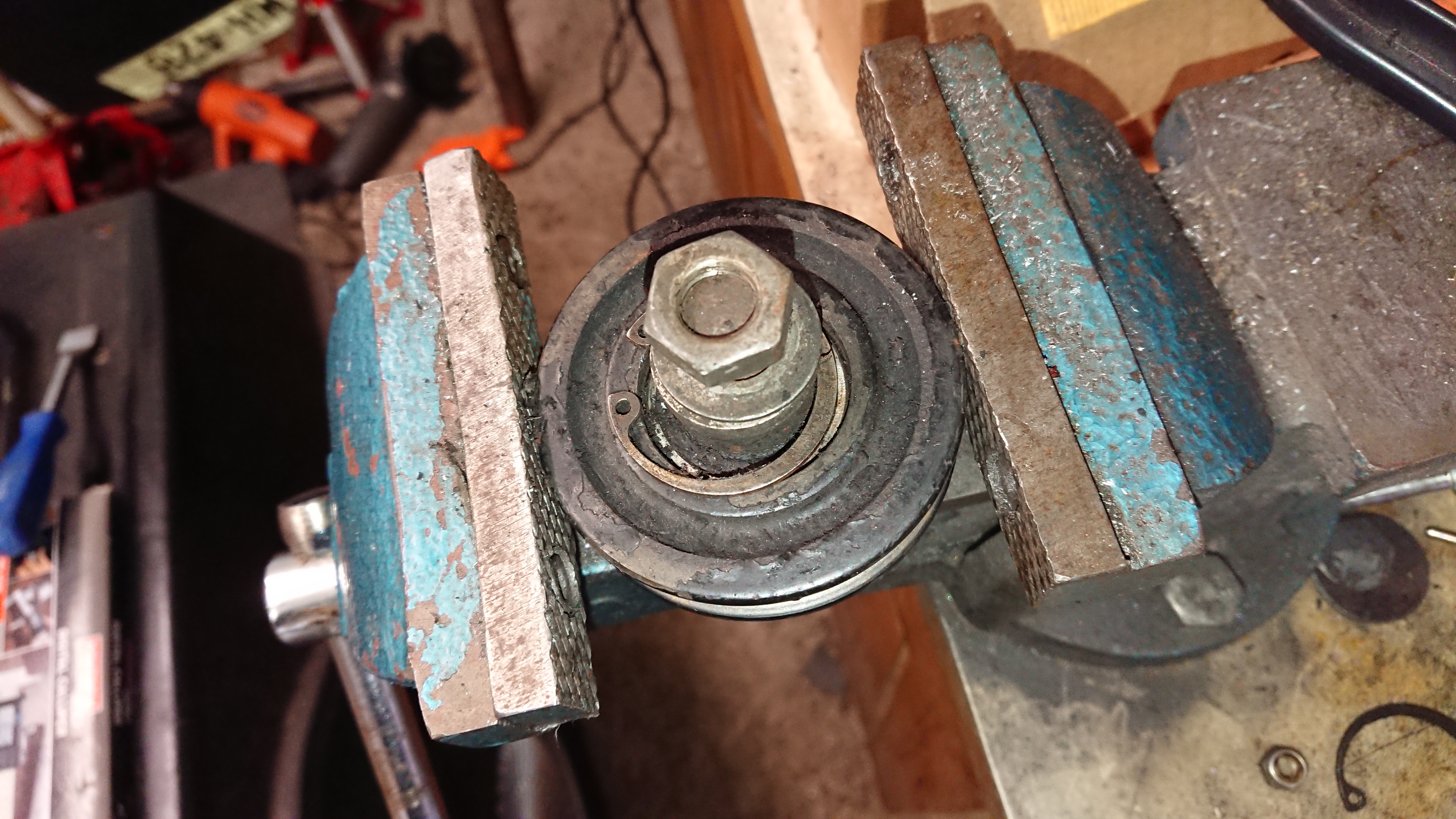

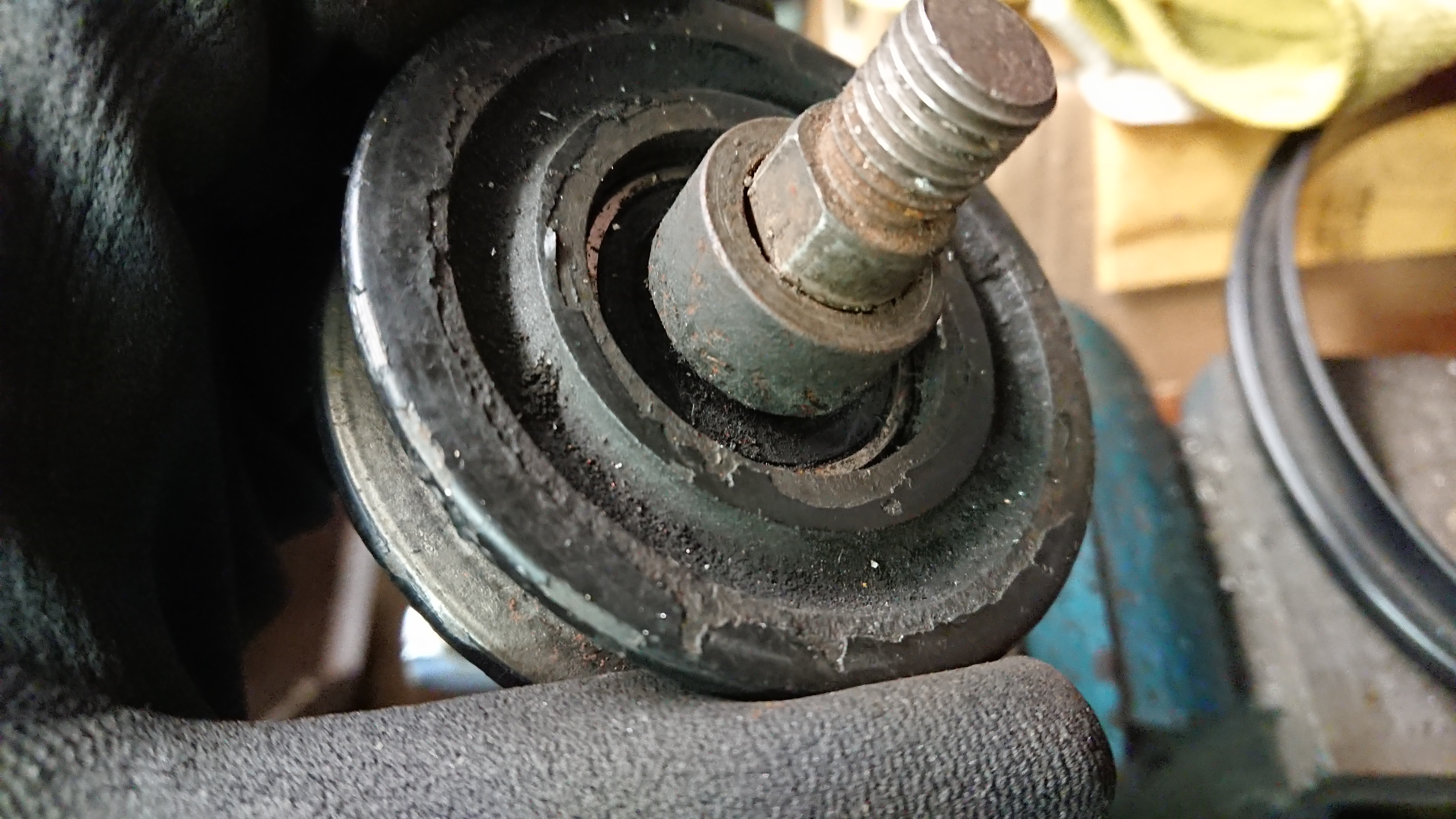

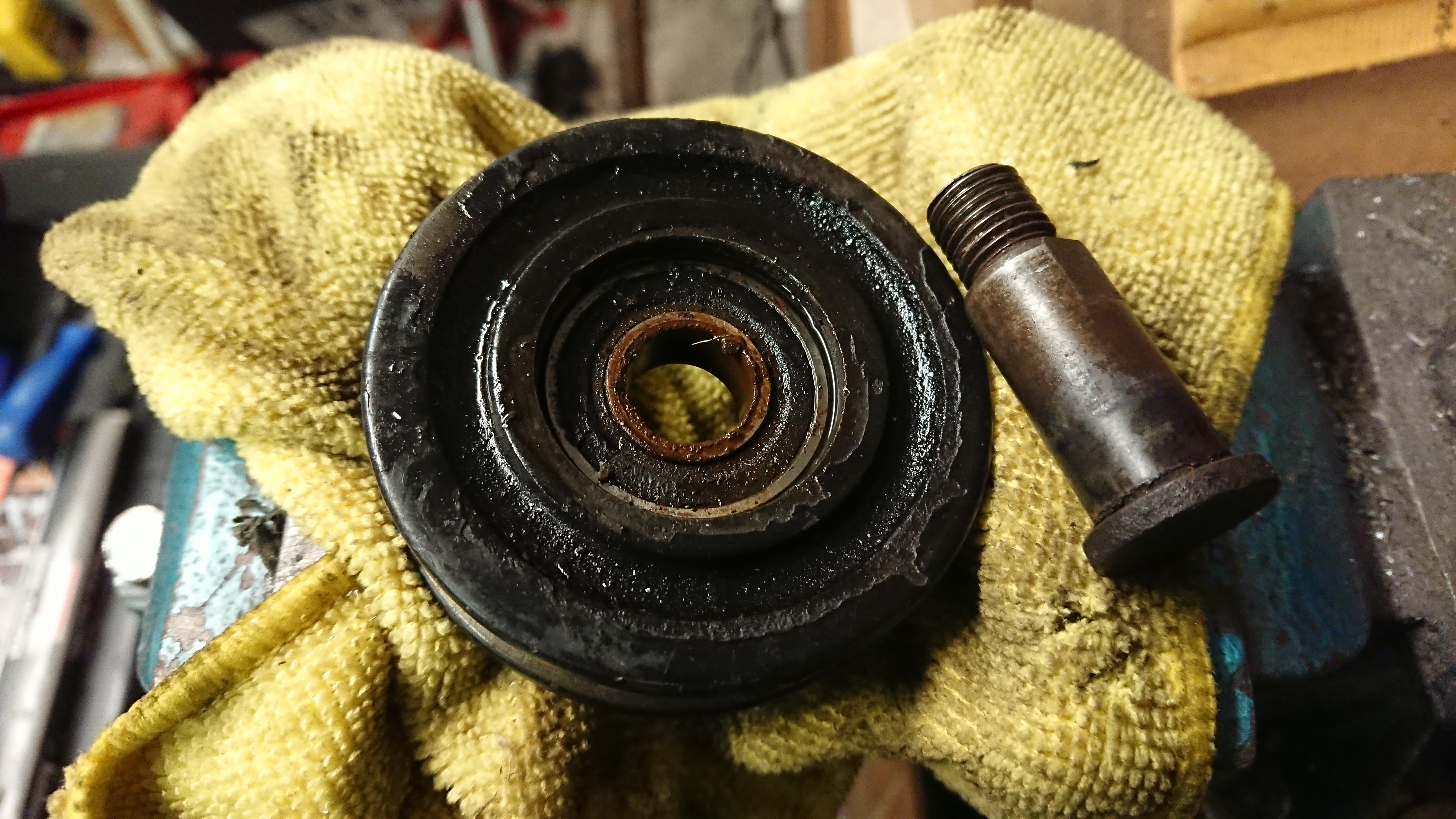

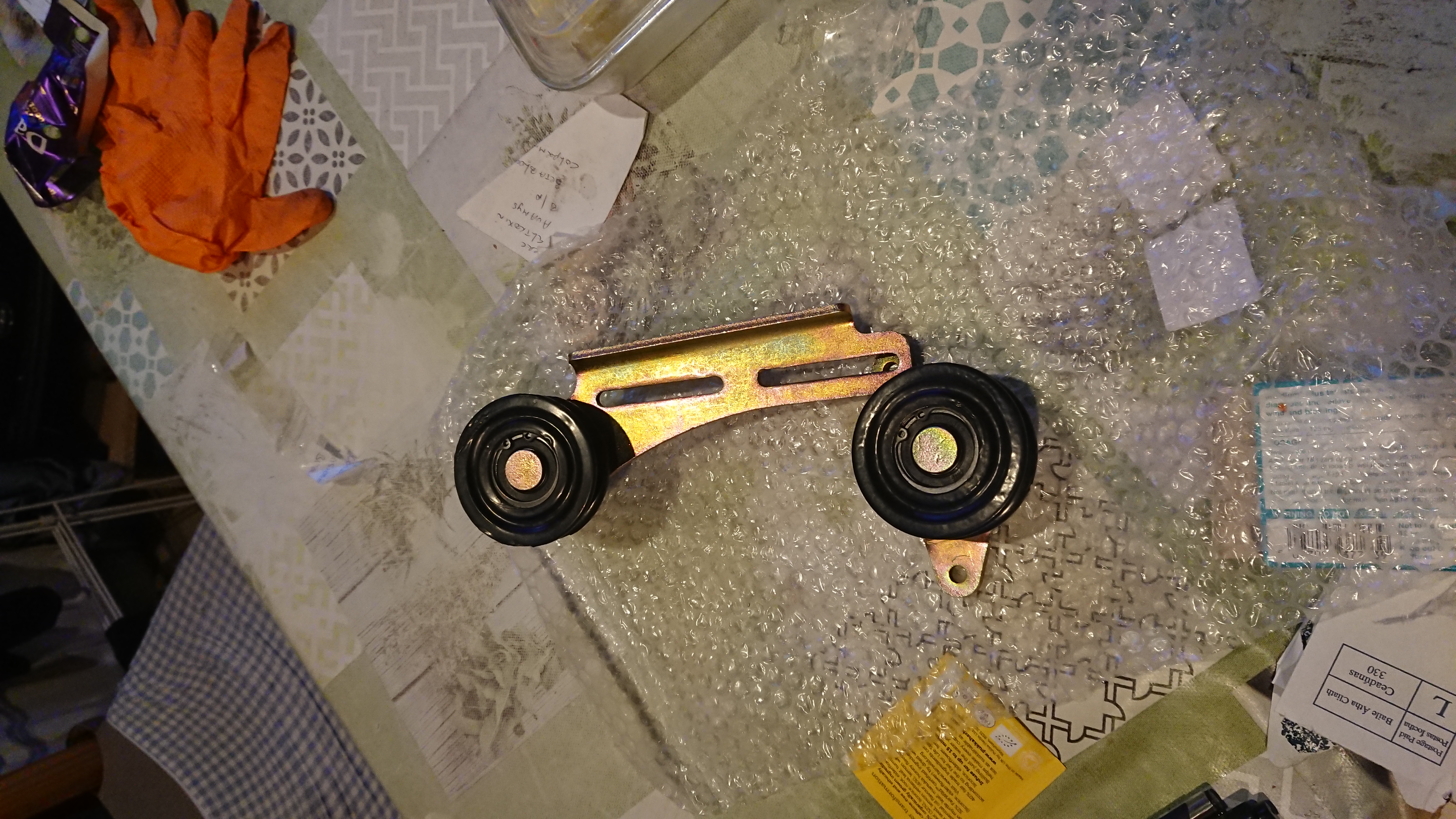

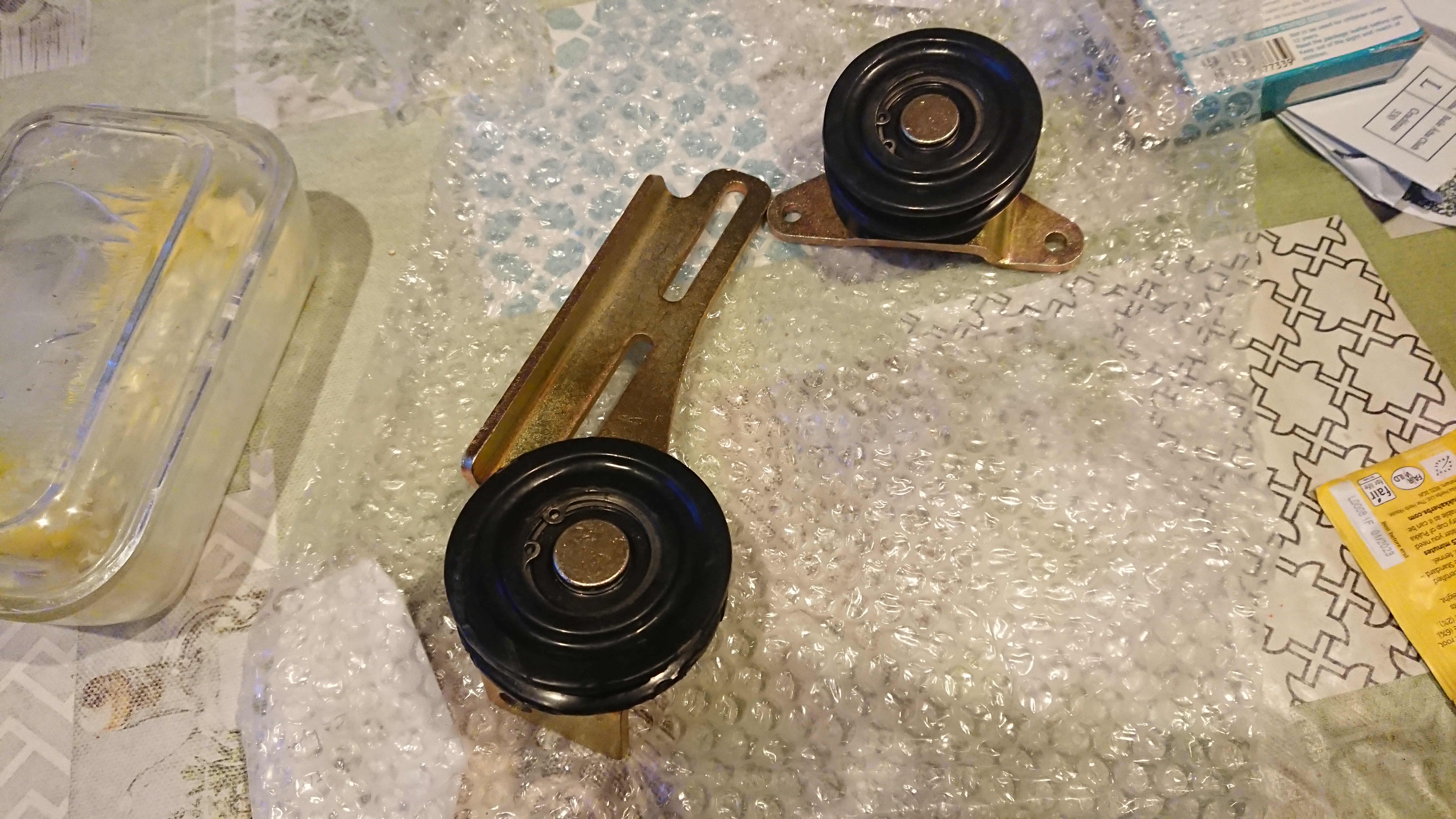

Postby cis6409 » Sat Mar 14, 2020 10:36 pm

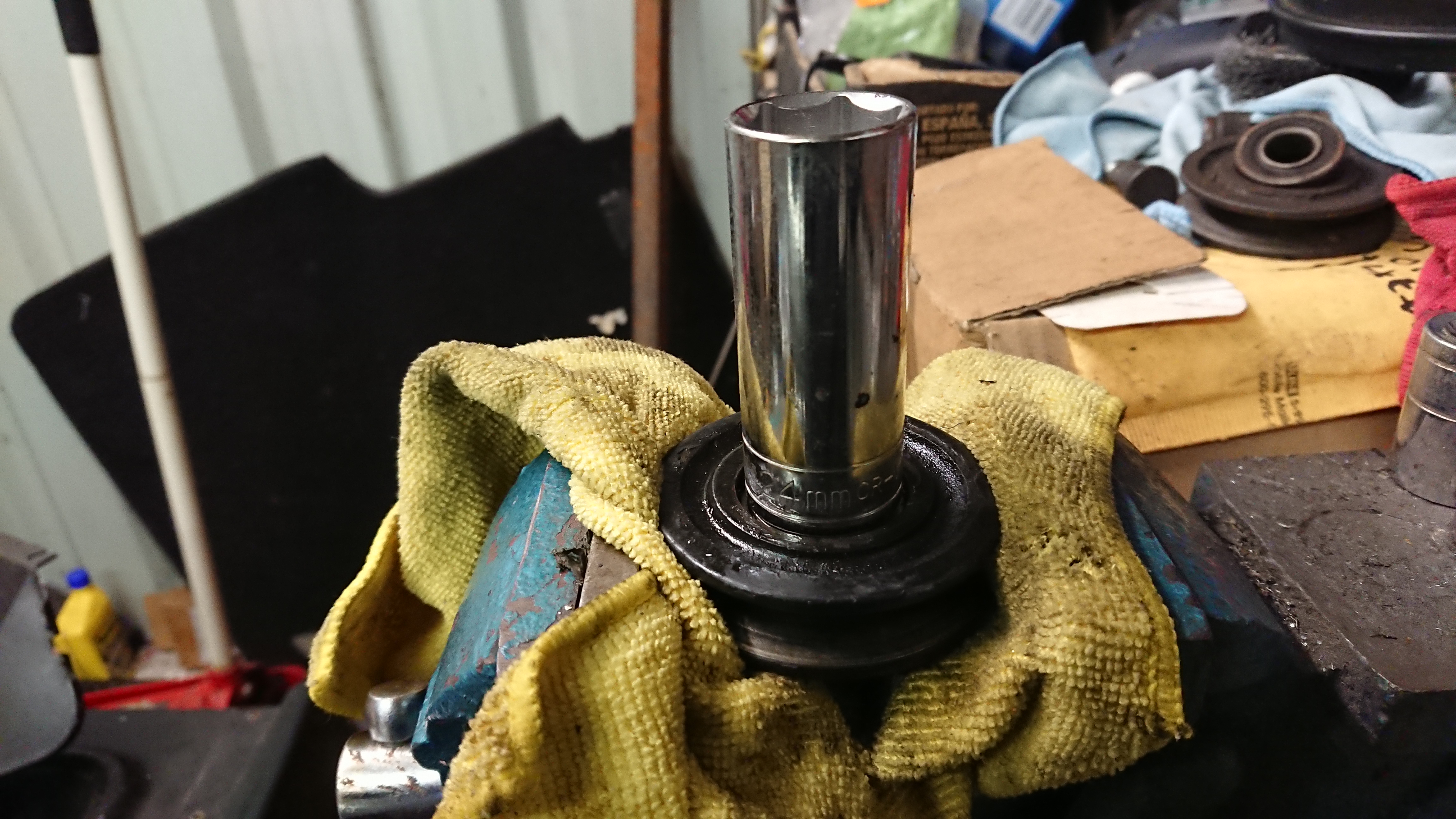

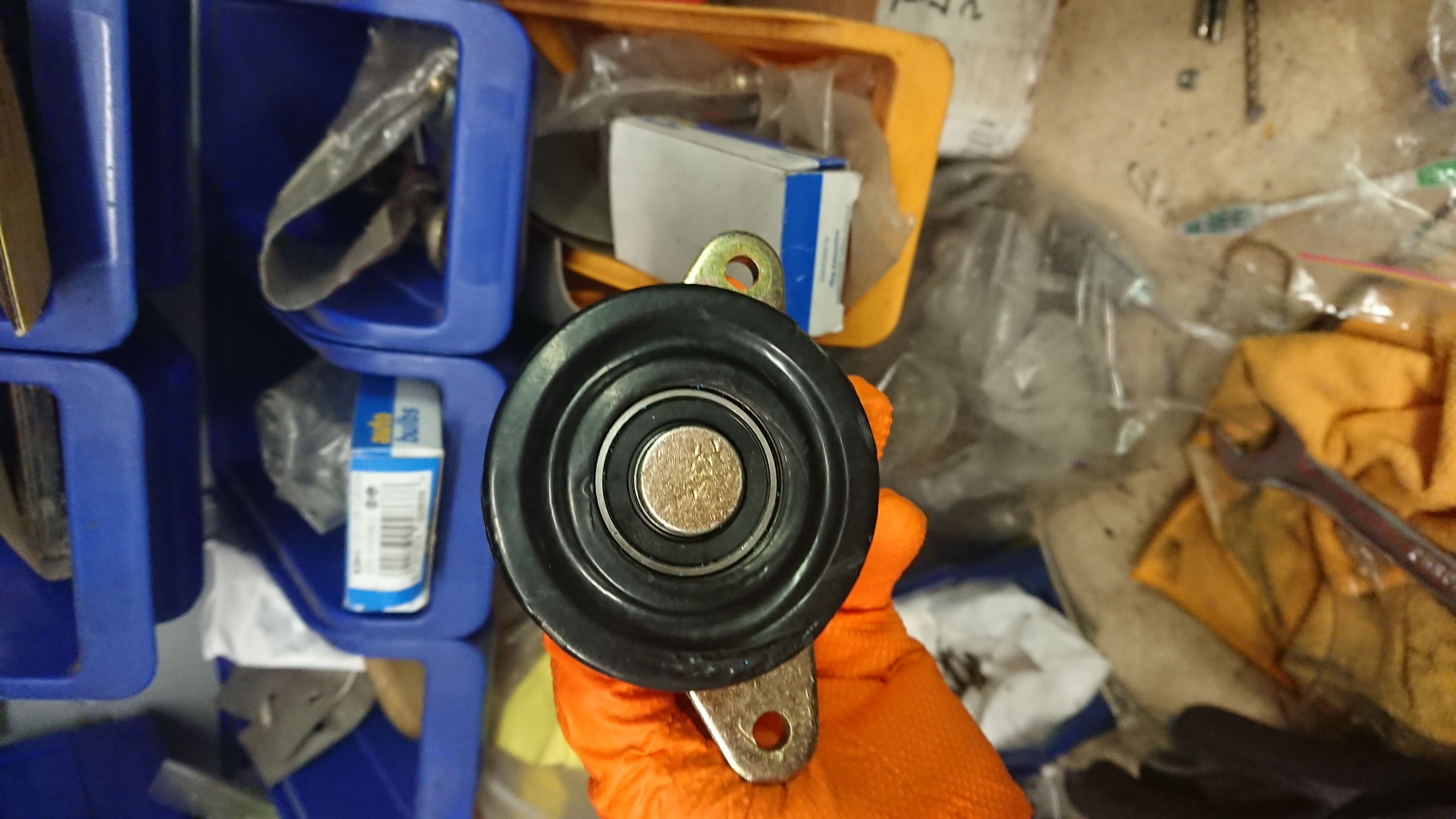

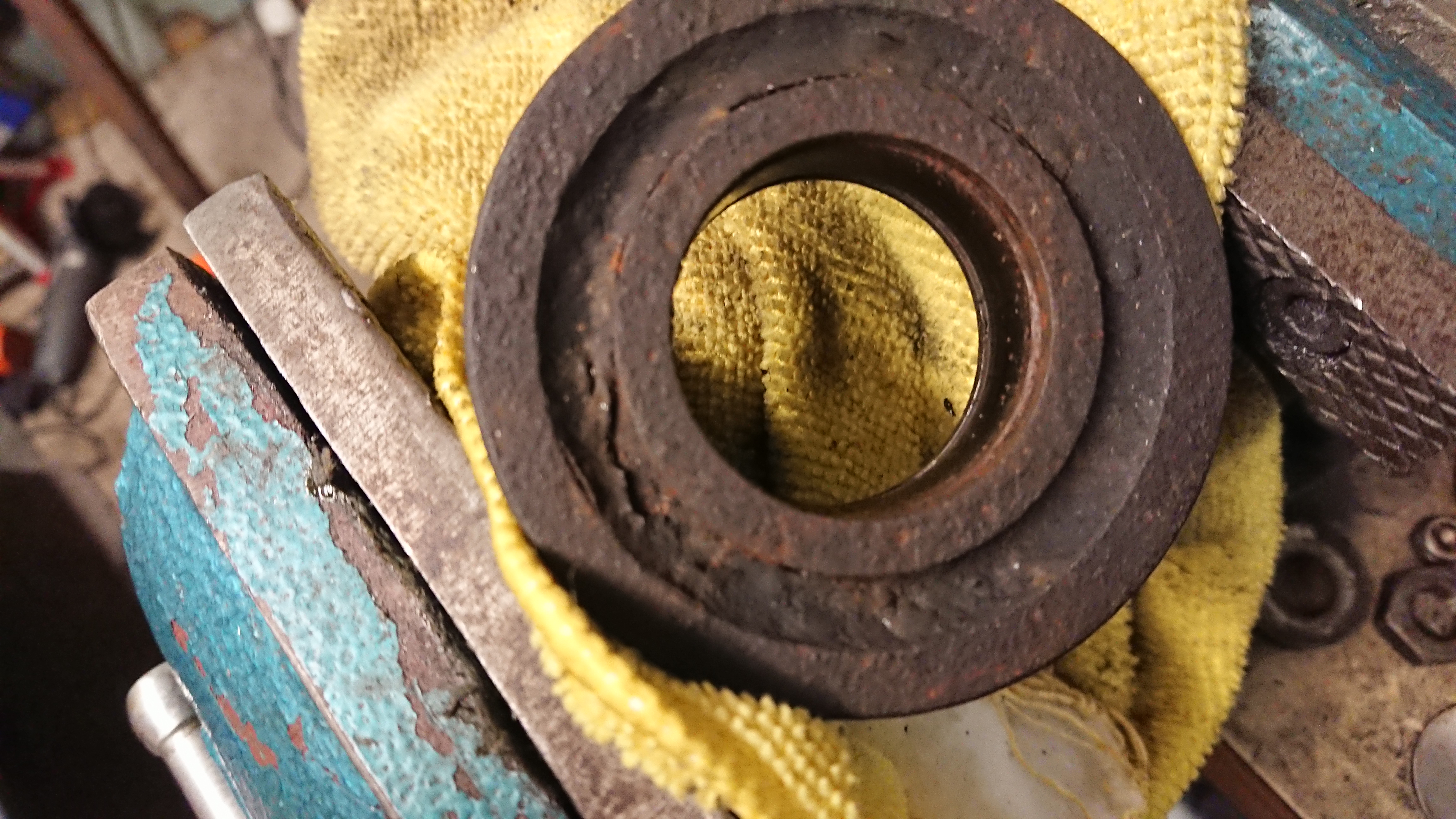

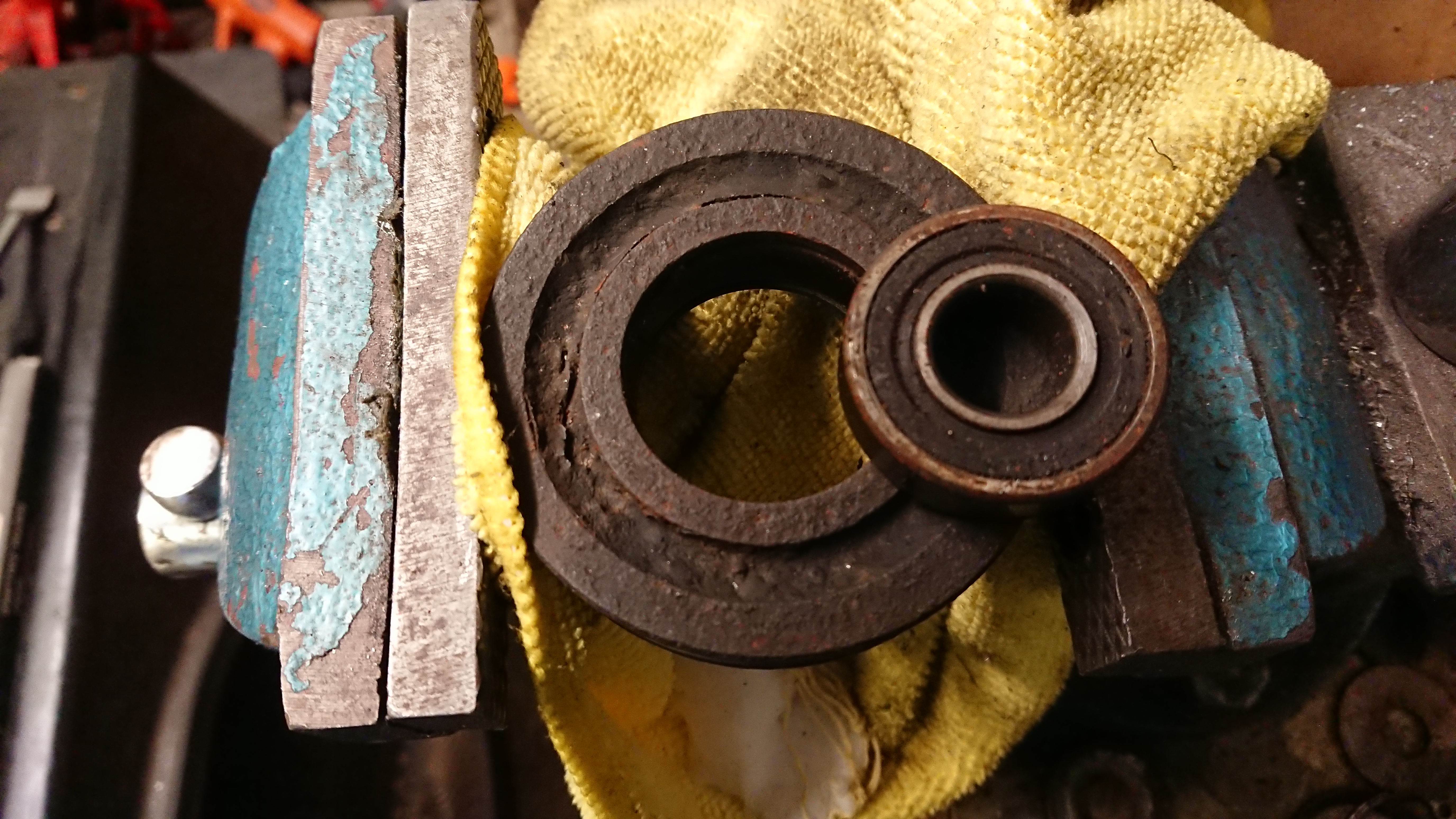

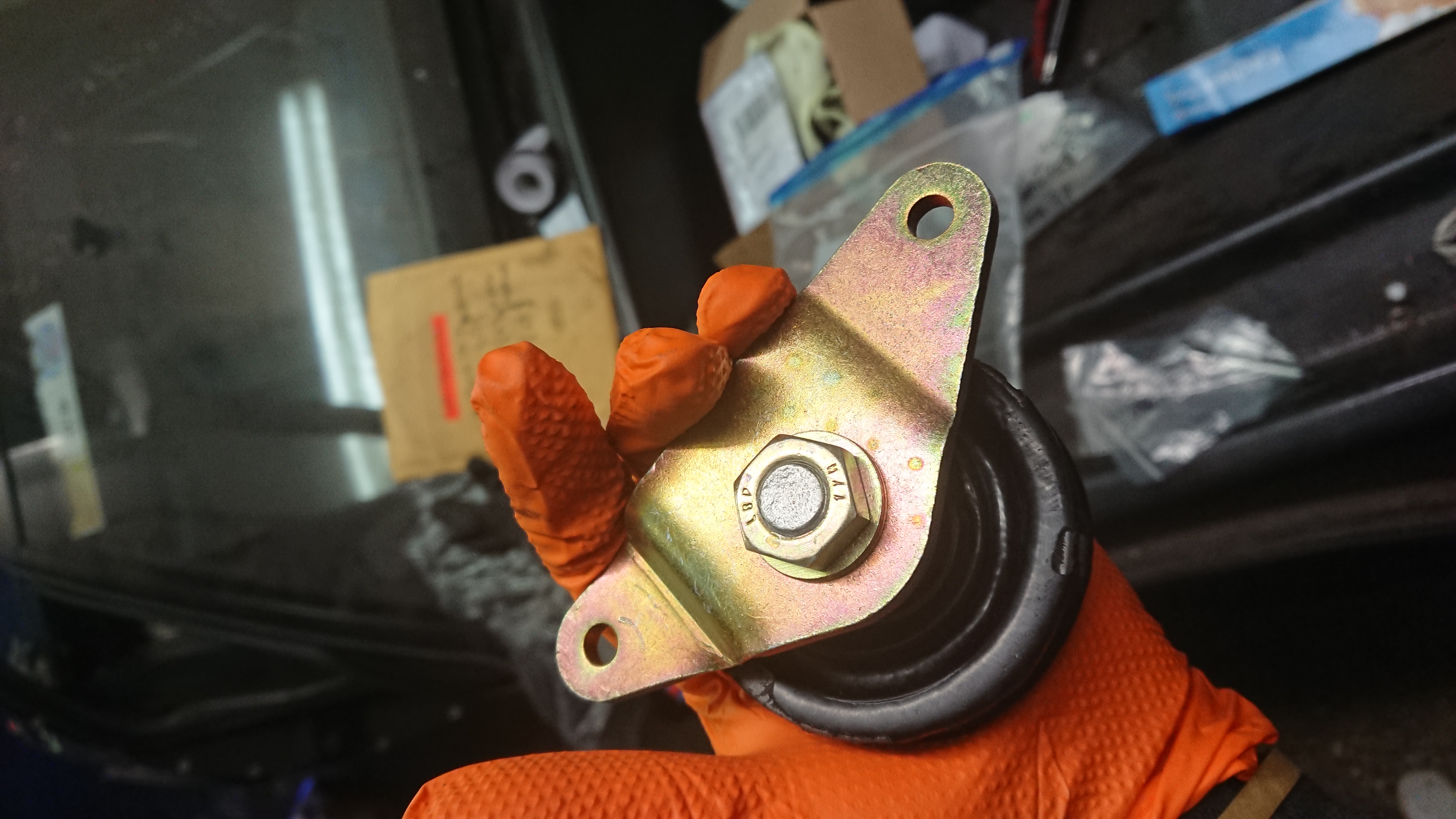

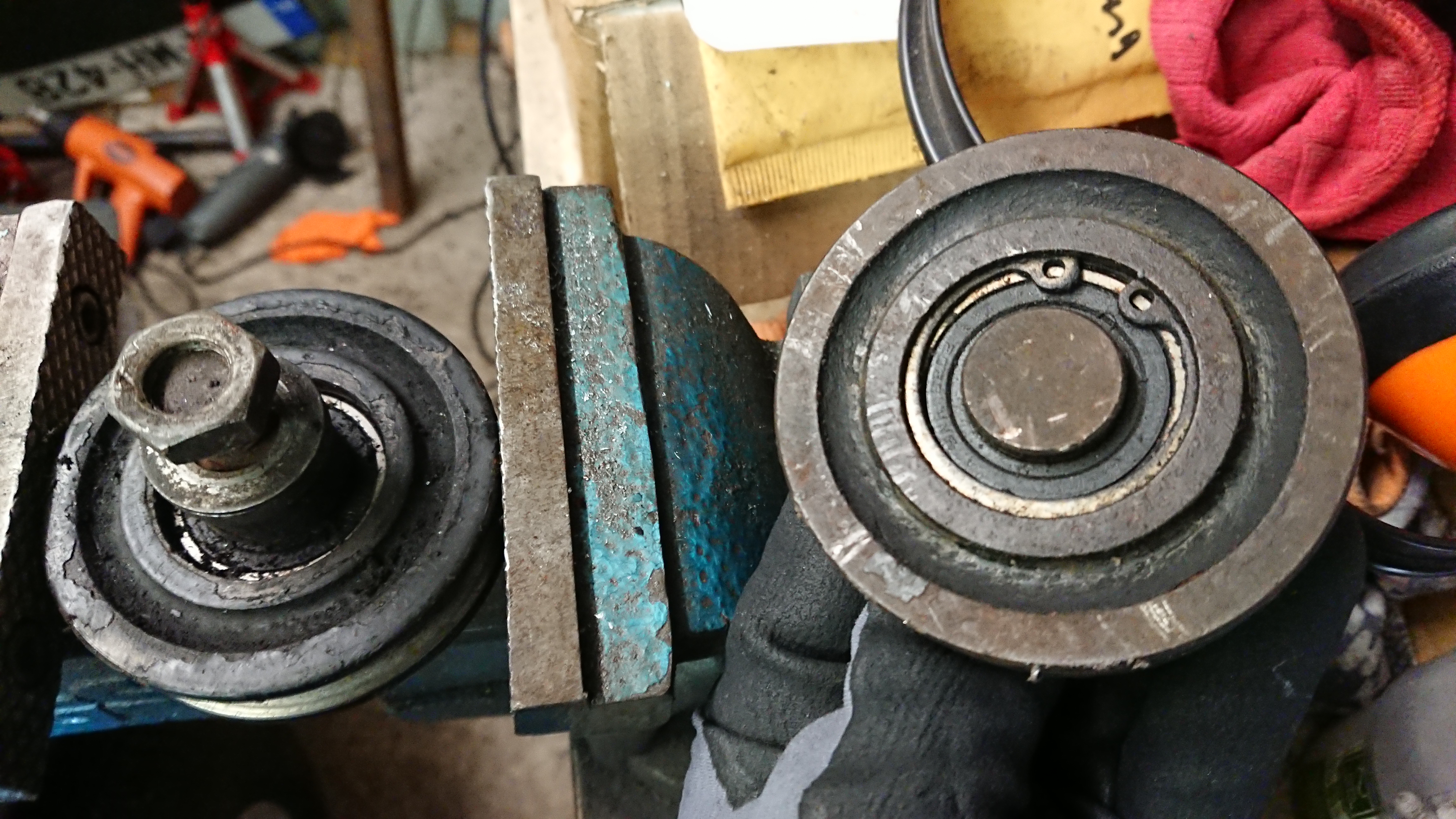

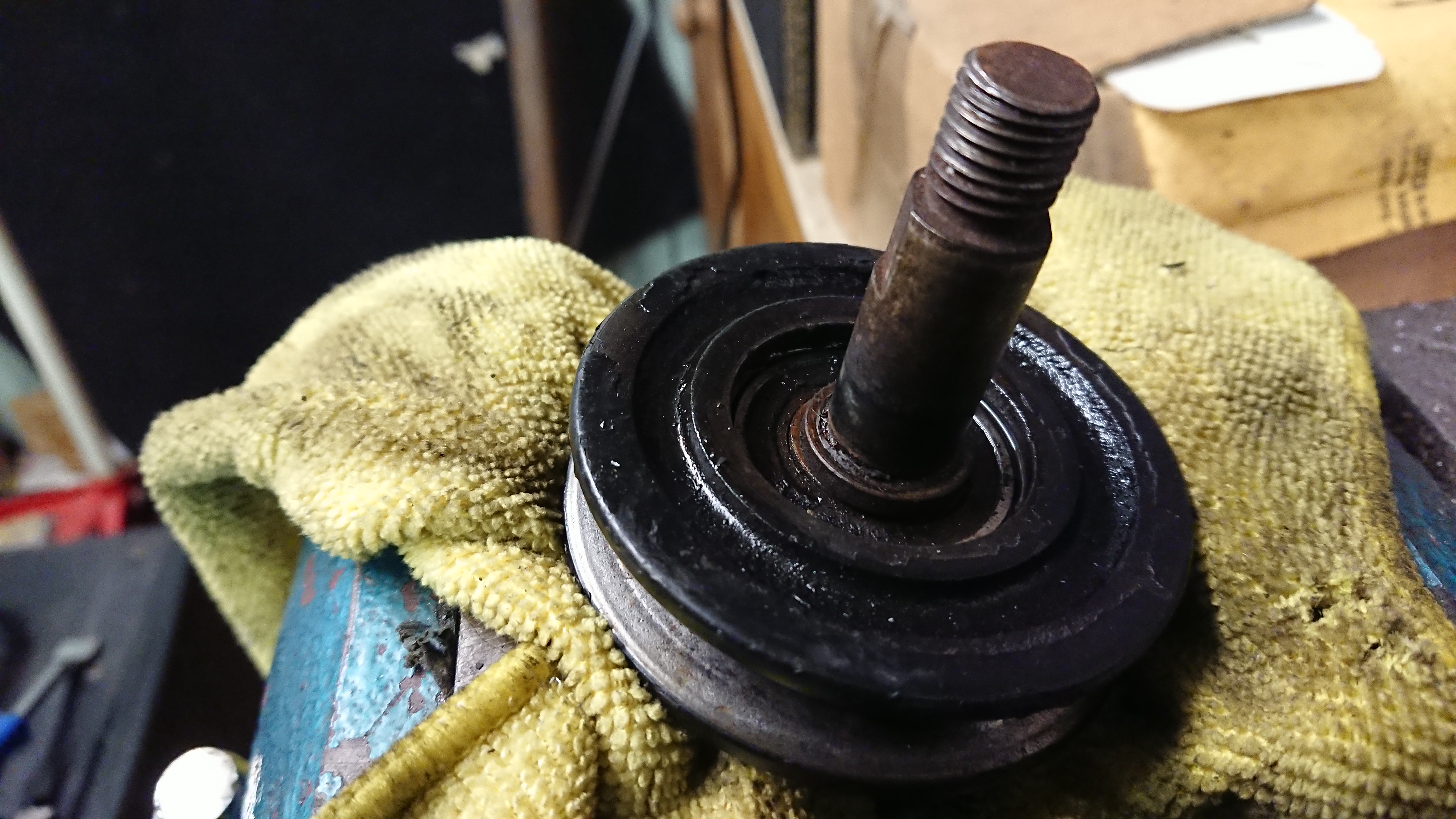

Got the air conditioning idler pulley and bracket refurbed which is small, but still progress. The old bearings were grumbly and rough well past it and in definite need of changing.
Got the bracket blasted and zinc plated and the pulleys blasted and powder coated. Now they re smooth and quiet as they should be..

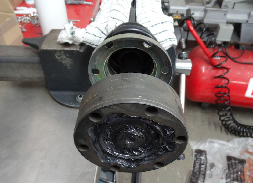

Was wondering do you need to use rtv or similar on the end caps when putting them back on to the joint itself to help seal it or do without?

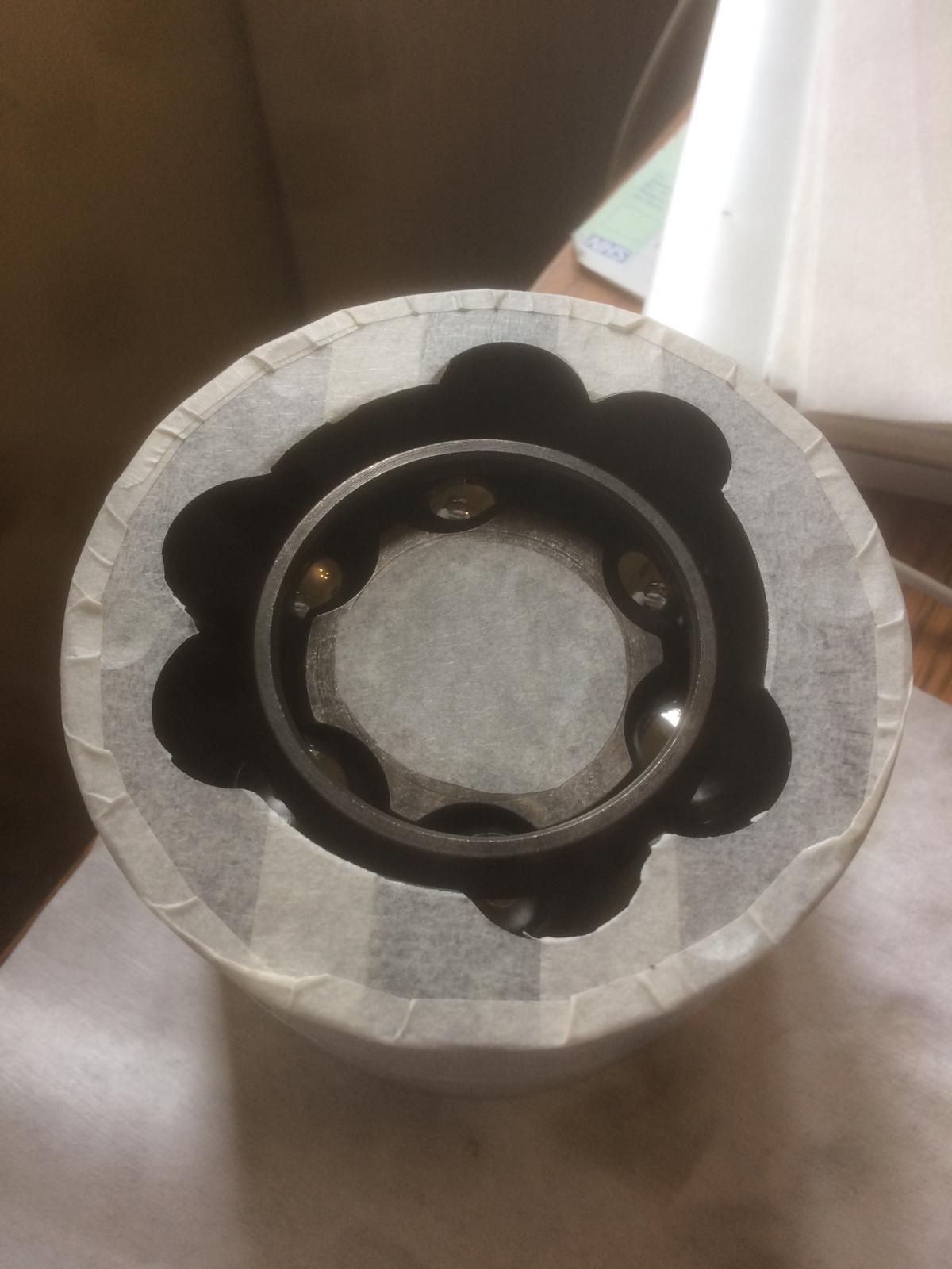

cis6409 wrote:Was wondering do you need to use rtv or similar on the end caps when putting them back on to the joint itself to help seal it or do without?
I didn't on my original D and they leaked grease and had to be re-done, so I did on this one and they have been spot on, but you will need to make sure the surfaces are very clean.
They had blue sealant on them from the factory, you'll probably find some residue of this left behind?
This was mine. I masked off the surface when putting the grease in so they were nice and clean to put on a thin smear of sealant:

Ah yes your right dan, I did see a smidgen of some kind of blue sealant on the end cap but only on the rear caps interestingly..
I'll go with some sealant on both caps just to be sure.
That's a great tip with the masking tape, that will make it alot easier to keep clean while packing it with grease. Nice one!

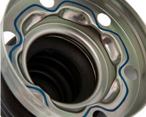

Postby Dan 6511 » Sat Mar 21, 2020 10:21 pm
BABIS wrote:the blue sealant is hylomar ;)
Thats it, and on their website it even shows a CV boot with it on:
