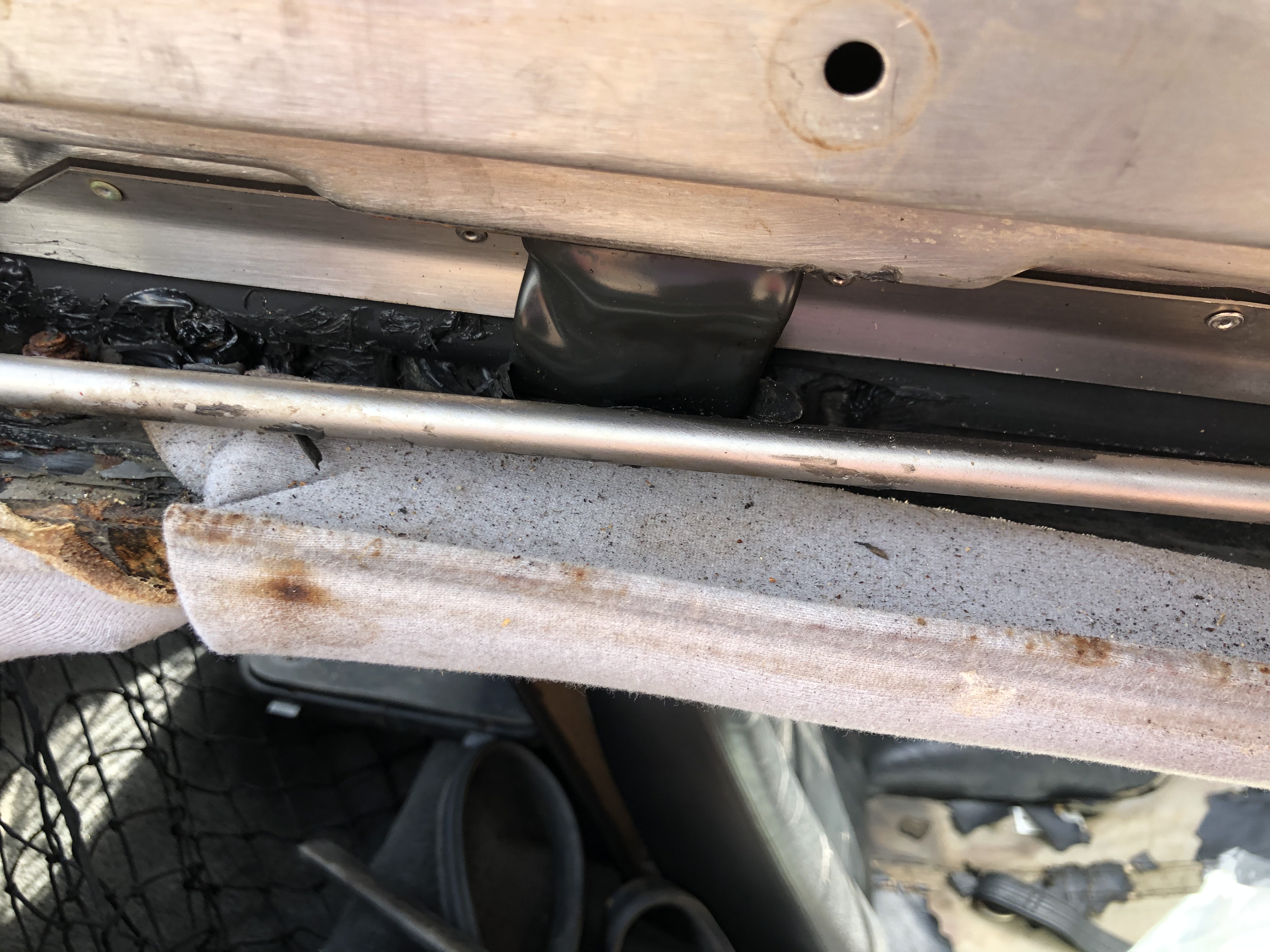

Wings now back "Aloft" Trim came off pretty easy, only broke two Fir tree's. (Plastic trim tool now a fixture within the car!)

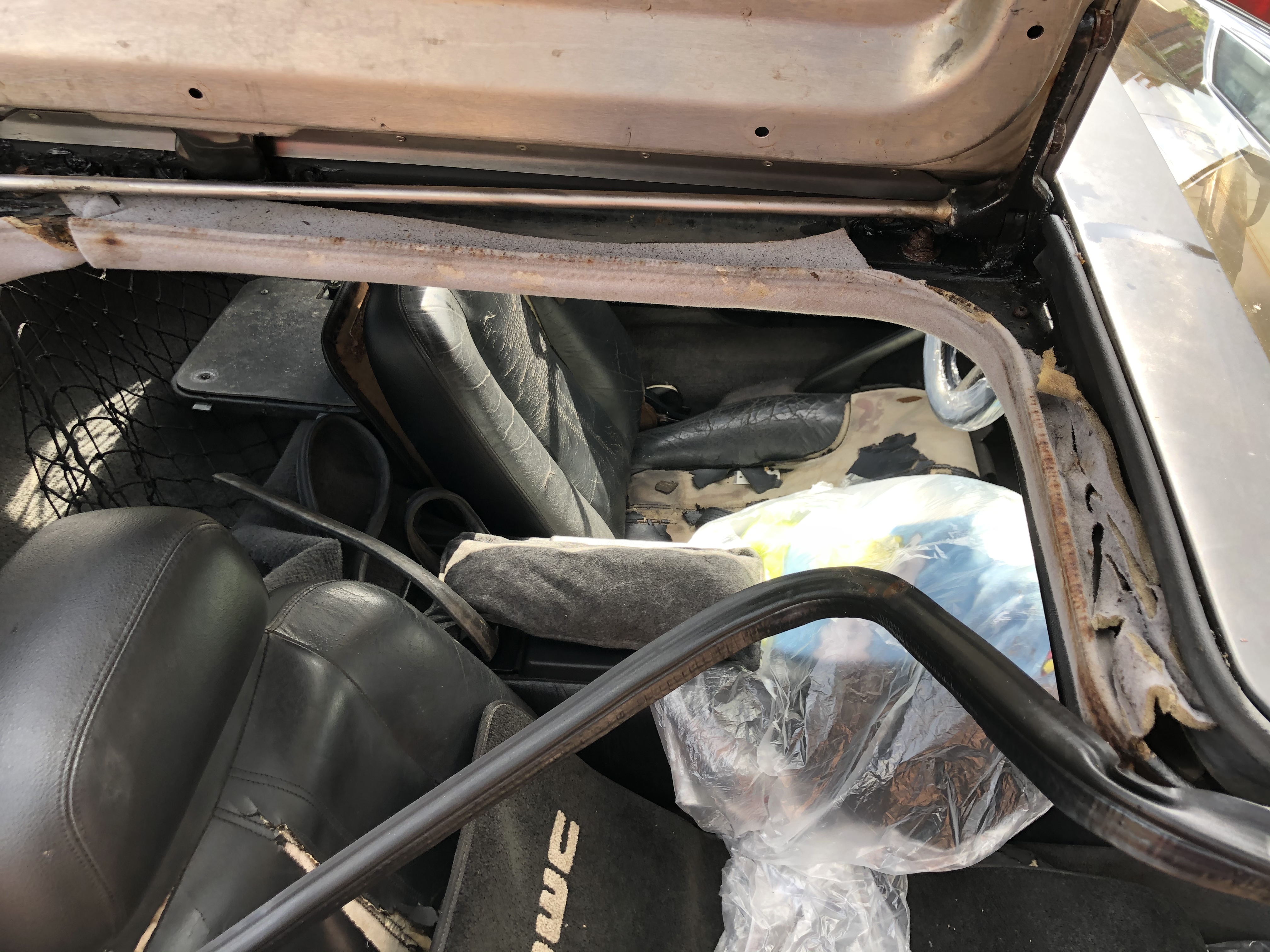

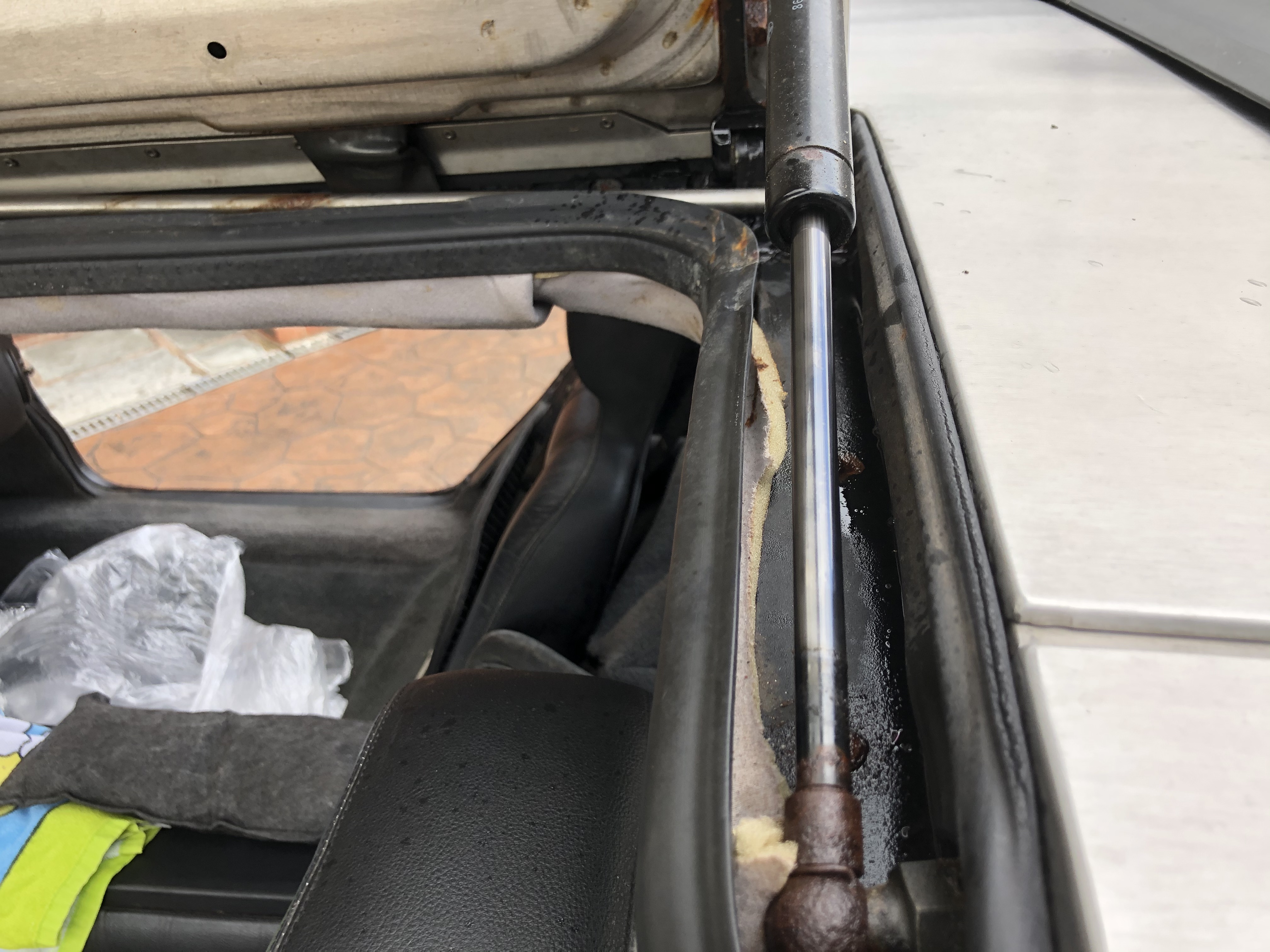

Whilst in their i noted the entire roof lining is soaking wet. looking in the roof area i noted loads of headliner is laying in the channels through the door seal on both sides. Pics below. Not sure if anyone else has experienced a possible syphon effect. Just found this on the other Forum
http://dmctalk.org/archive/index.php/t-8447.html
Other side
One side
Darrenre

Postby MikeWard » Thu Sep 03, 2020 3:56 pm
Would suggest pulling the door seal off, and trimming the headlining back. If it's sitting in that channel anytime it rains and water goes into those channels, the excess headlining material will wick it into the car. It wants trimming just as it hooks over the fibreglass tub.

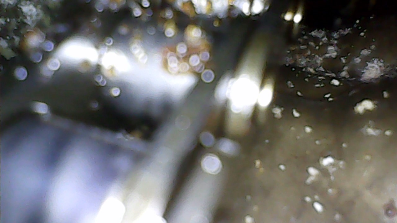

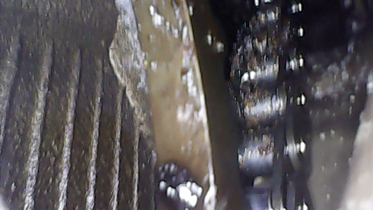

DMC1983 wrote:Did you have a look at the chains via the blanking plate yet?
The attachment 20200903_075815.jpg is no longer available
Managed to get a couple of shots Through the cover
Chain 2
Chain 1

Postby Darrenre » Thu Sep 03, 2020 5:46 pm

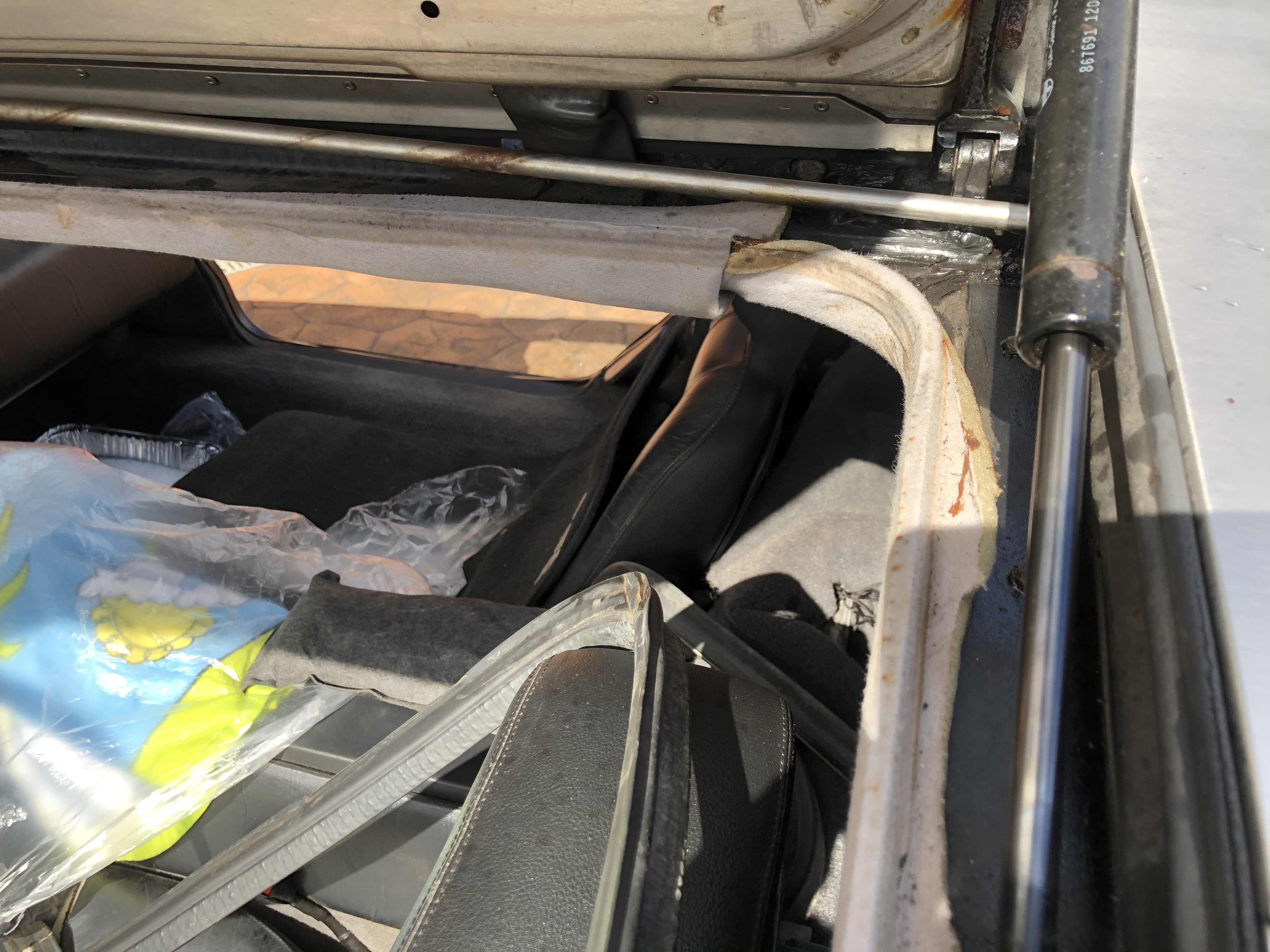

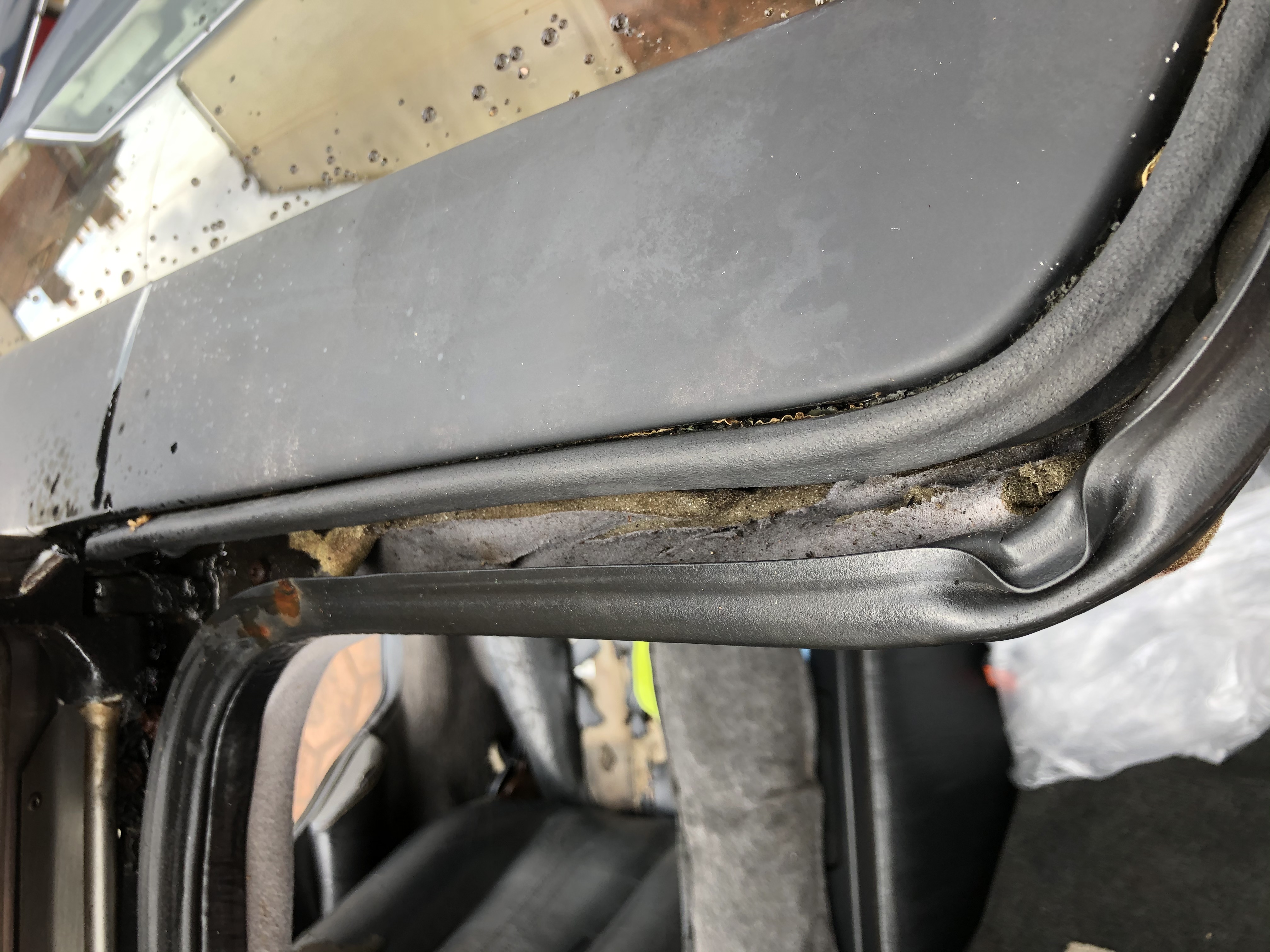

MikeWard wrote:Would suggest pulling the door seal off, and trimming the headlining back. If it's sitting in that channel anytime it rains and water goes into those channels, the excess headlining material will wick it into the car. It wants trimming just as it hooks over the fibreglass tub.
Mike
Excess was an understatement! The channel was full in a couple of places on both sides! All trimmed now.
Under torsion bar
Opposite side
Headlining in channel

Postby MikeWard » Thu Sep 03, 2020 6:12 pm
:lol: oh dear, no wonder you were getting water in the car.

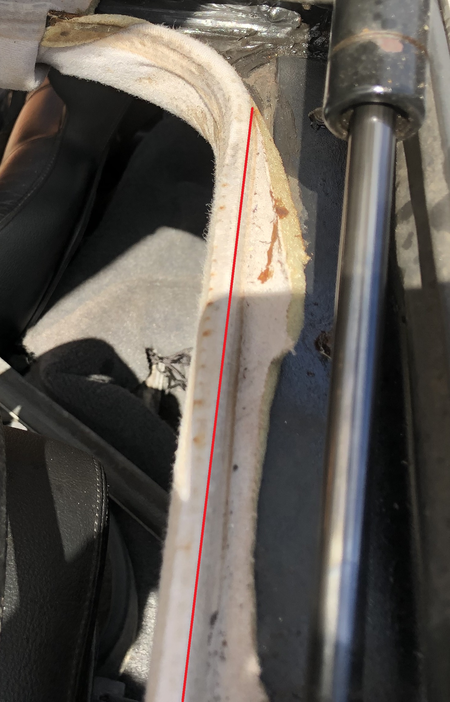

For clarification, I've marked here where I was suggesting to trim, just after it hooks over the top of the tub. That will stop it wicking water into the car.

Postby eric » Thu Sep 03, 2020 7:35 pm
Tricky to see and I have never looked through that hole but it looks a little rusty, Lets see what folk think. I am guessing there should be no rust in there at all..
Re: VIN #2307 Arriving soon from BHCC
Postby A Van » Thu Sep 03, 2020 9:28 pm
Difficult to say on the chains, personally if the car is staying outside and the headliners are very wet I would take them out now as they will retain moisture inside the car which you don’t want
Thanks Mike, that’s what I have done.
