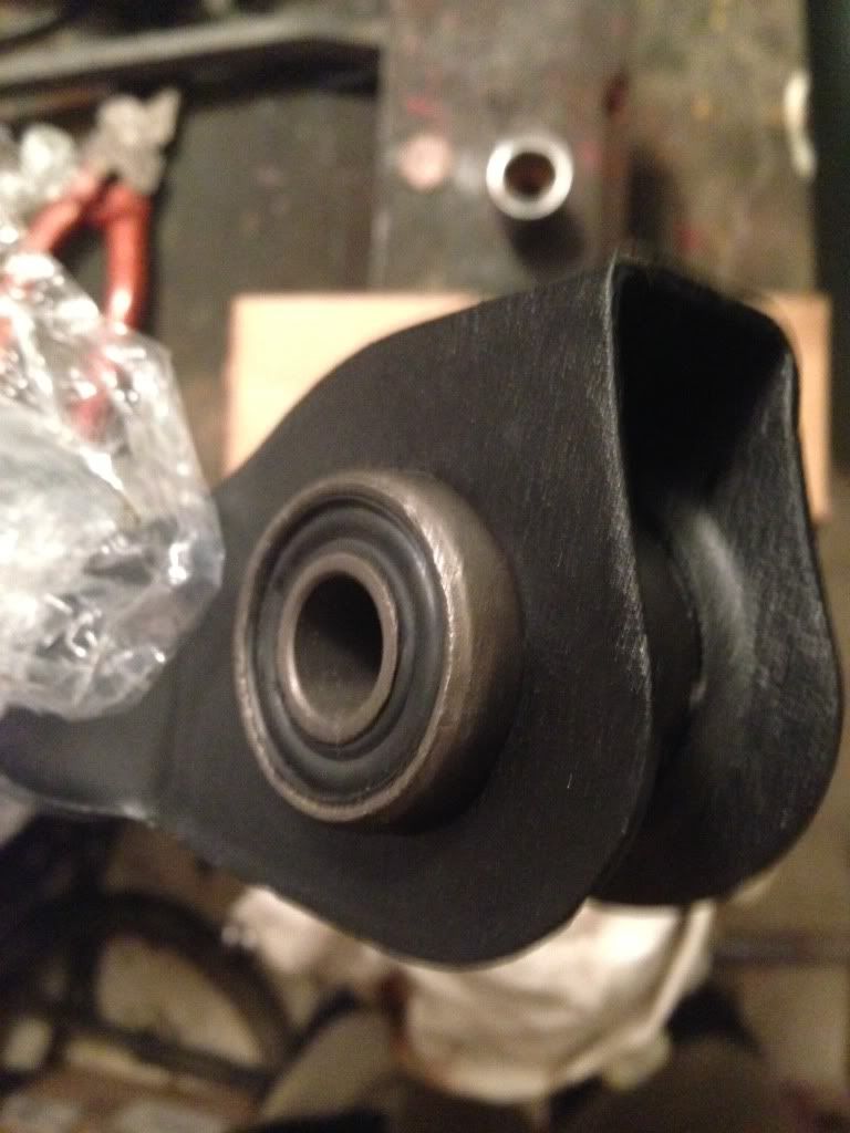

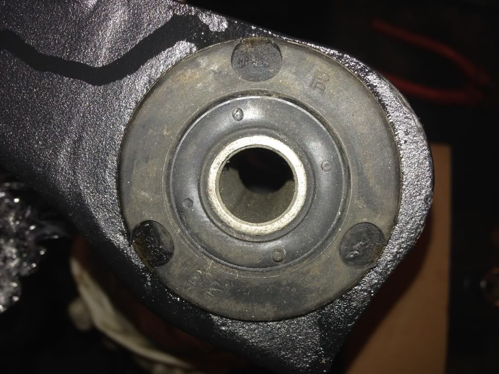

Then placed the front upper arm bushings I got from Josh @ DPI..
Everybody was curious how I would go about this job?
Well... I supposed this is a first for everybody in here eh?
Looking good?

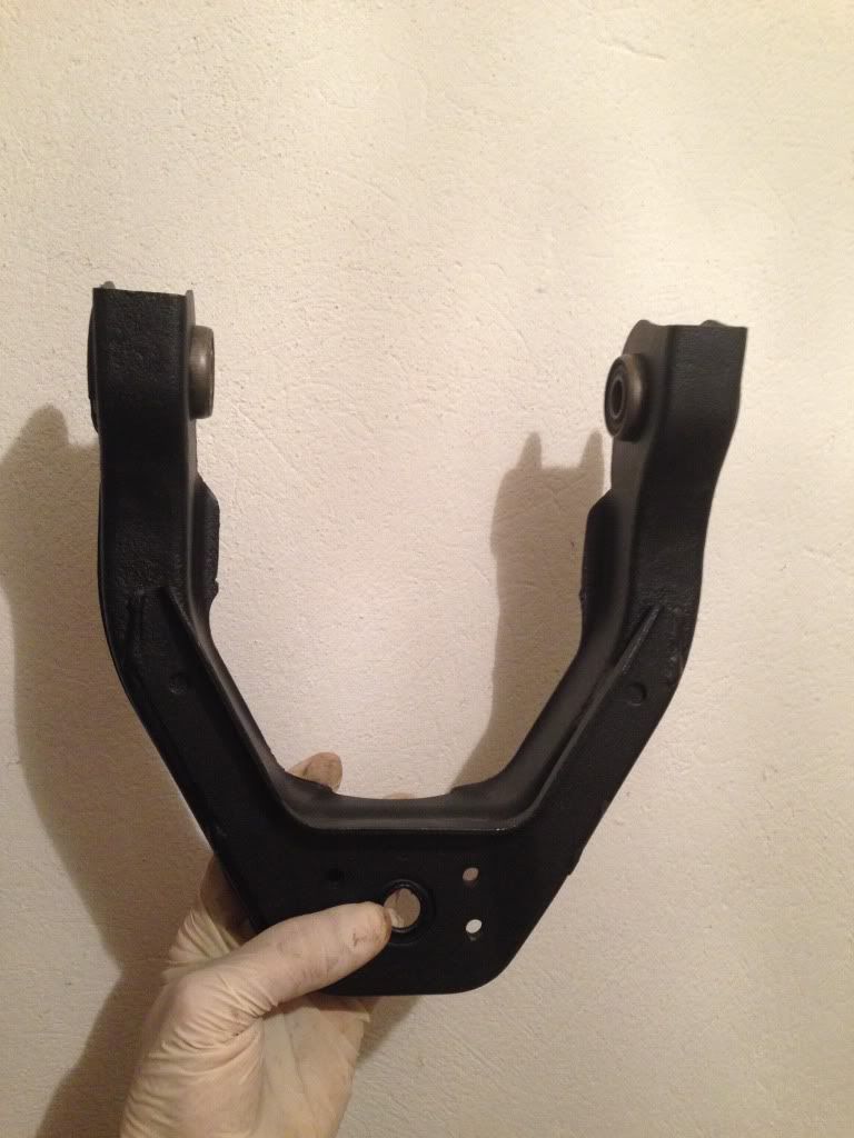

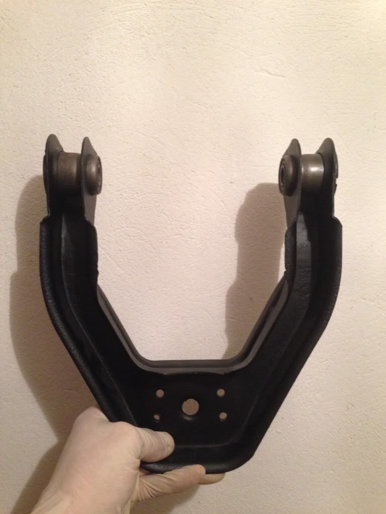

Now you'll get to see the arms after the sand blasting and power coating job. Not Stock colors but I love it.
How?

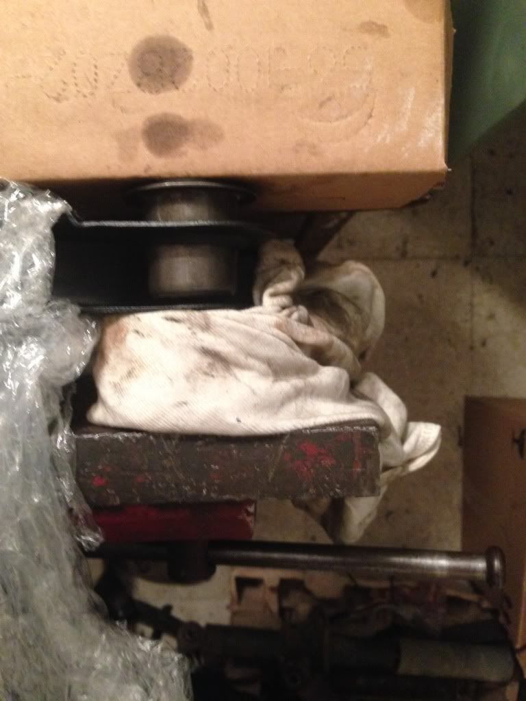

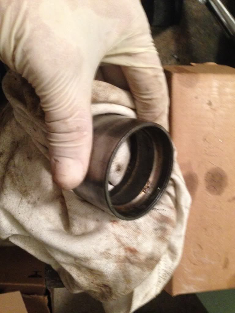

Ok. I just used my bench's clamp.
With a bit of lube and slowly working it into position. In the one side I covered the clamp's surface with a cardboard to avoid the "injury" of the bushing and on the other side I used a cylinder with a cloth to allow the metal side of the bushing to protrude.
But... WHERE IS THAT CYLINDER FROM?
It is none other than the front wheel's bearing Shel.

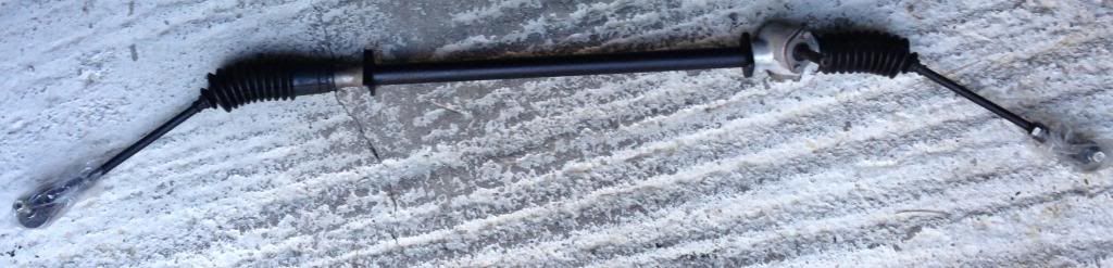

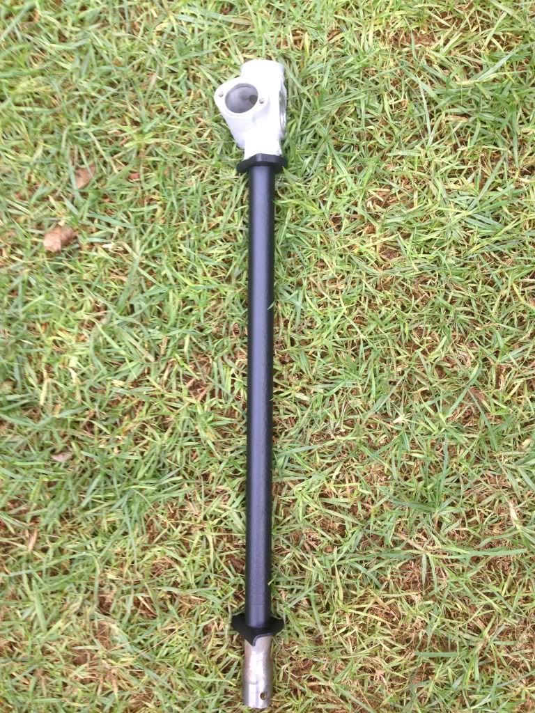

On to cleaning out the steering rack.
That too has been powder painted
Again a quick reminder of the past situation:
Upper arm
Upper arm
Steering rack
Postby Dan 6511 » Mon Oct 14, 2013 6:20 pm
Looking good. I remember doing those upper bushes when I did my car. How have you fixed them into the arms? I seem to remember the originals having a small weld tack to stop them rotating in the arm.

Postby ALEXAKOS » Mon Oct 14, 2013 6:59 pm
Dan 6457 wrote:Looking good. I remember doing those upper bushes when I did my car. How have you fixed them into the arms? I seem to remember the originals having a small weld tack to stop them rotating in the arm.
Very good point Dan! I was wondering if those would rotate after a while.
I will TIG spot weld those in 3 spots each just for Making sure!
Dan you are right! THIS IS GOOD FUN!

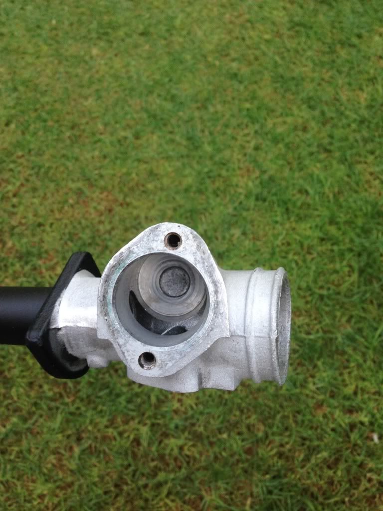

Can't really call it a full day's job cause I only worked for a couple of hours on my steering rack replacing the two friction parts
Right, here are the originals next to the copies I made with poly.
Right the melted filler cap knob left my replacement
Goes like this:
Then the centering cylinder that was ripped.
Left the original, right my poly repro
notice how large the gaps are on the original. I believe the main reason is minimal friction cause it was made of hard rubber
fitting
I rounded up the sharp corners
Postby ALEXAKOS » Fri Oct 18, 2013 4:11 pm
the time has come where the word "disassembly" moved on to repair and is now replaced by "reassembly"..
I present you the 2nd and 3 complete part of 5992
The steering rack
Refurbished inside out as you saw before. Sitting with brand new rod tie ends from our favorite eurotech store (thanx for a great service lads)

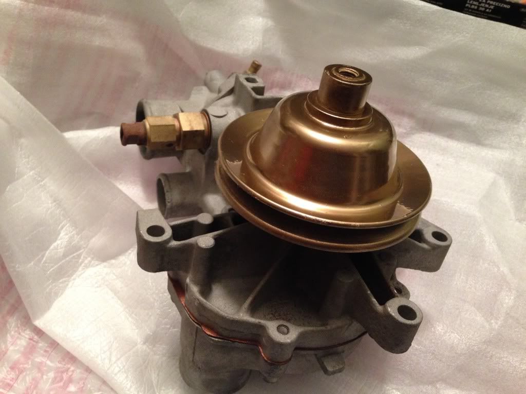

and the water pump
Cleaned from the hellish goo that sat in there. Then replaced all gaskets and seals.
