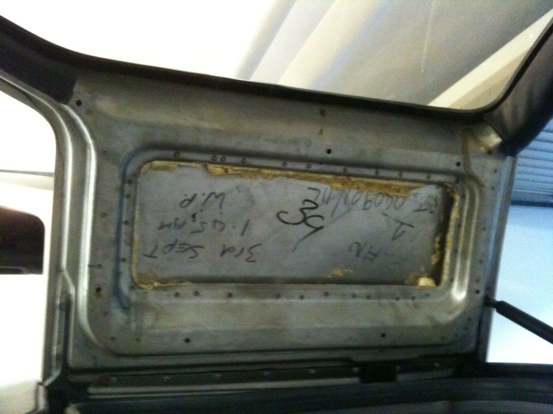

I refitted the headliner trim just now and found some cave drawings on the LH side door (drivers' side).
"3rd sept"
"1.45PM"
"W.P."
and a big "39"
and some more scribbling:
"Alan"
"1"
"R.T. 040901/11 L"

Postby arranj » Thu Apr 08, 2010 7:34 pm
Looks more like 1:45 AM - did they work that late?!

Postby RobvdVeer » Thu Apr 08, 2010 7:38 pm
arranj wrote:Looks more like 1:45 AM - did they work that late?!
Oh yes AM indeed. Looks like they had to pull an all-nighter to get mine together. Explains a lot. Or did they started to work in shifts by september '81 ?
