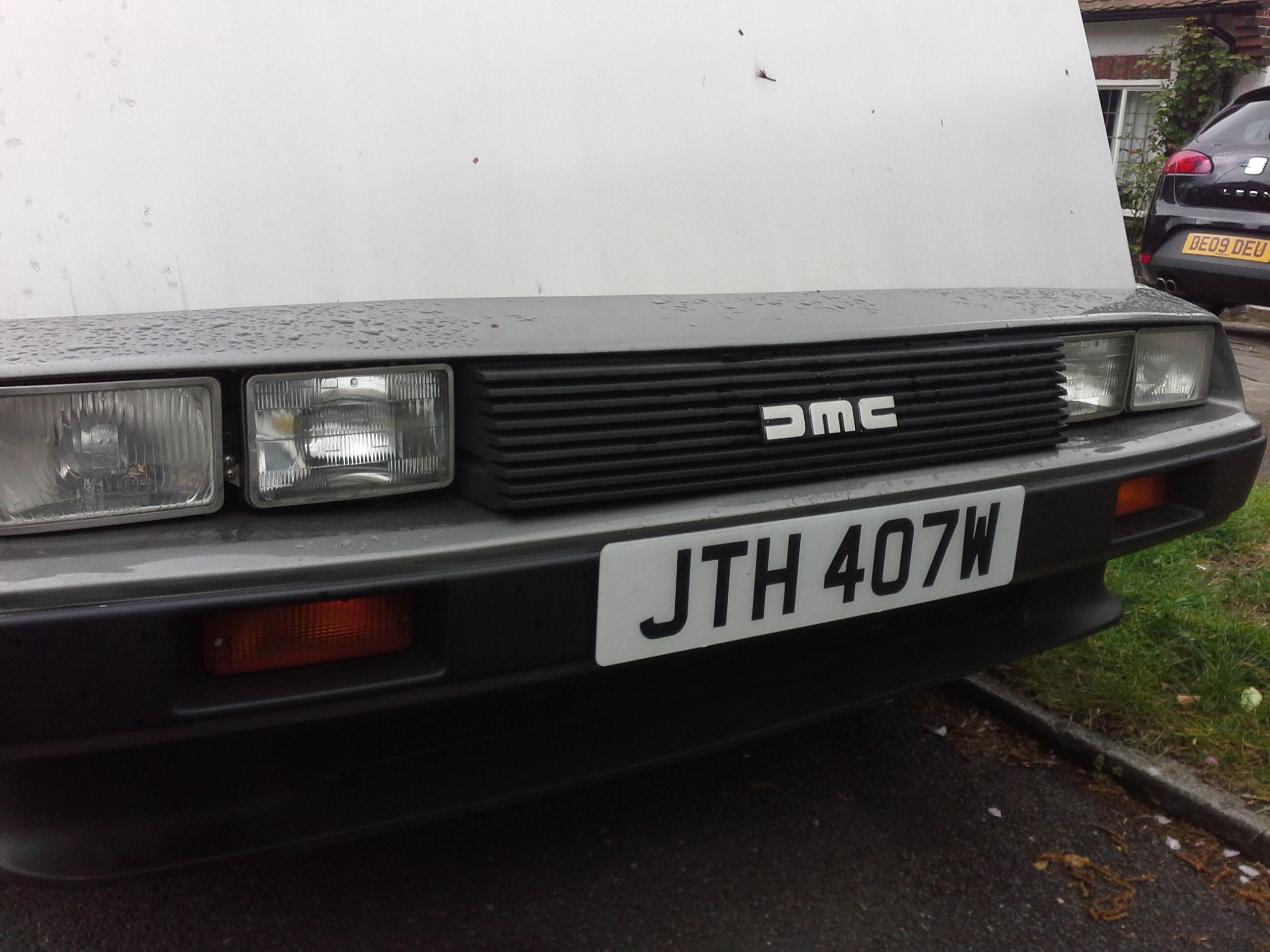

Headlights as fitted:
Non identical, don't give a fuck! Its only us anoraks who notice these things!!

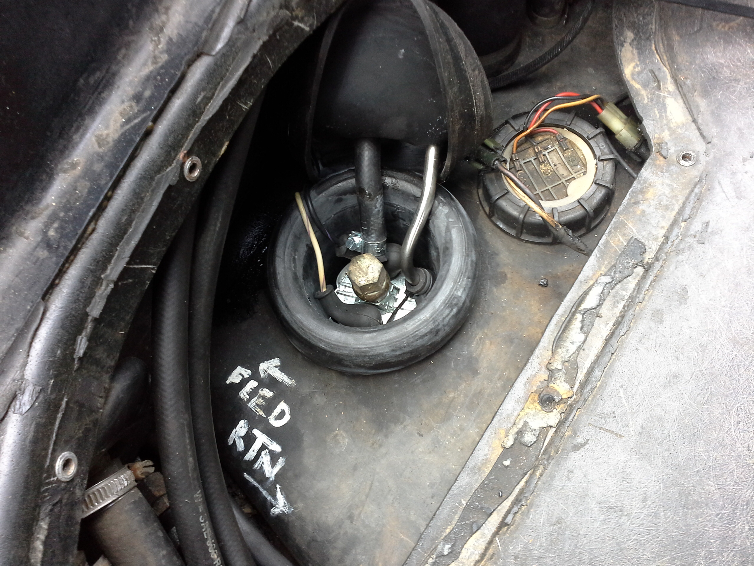

I was also pleasantly surprised to see the oil still golden after the run to Ed's and back. A good sign, but fuck all good without a fuel pump.

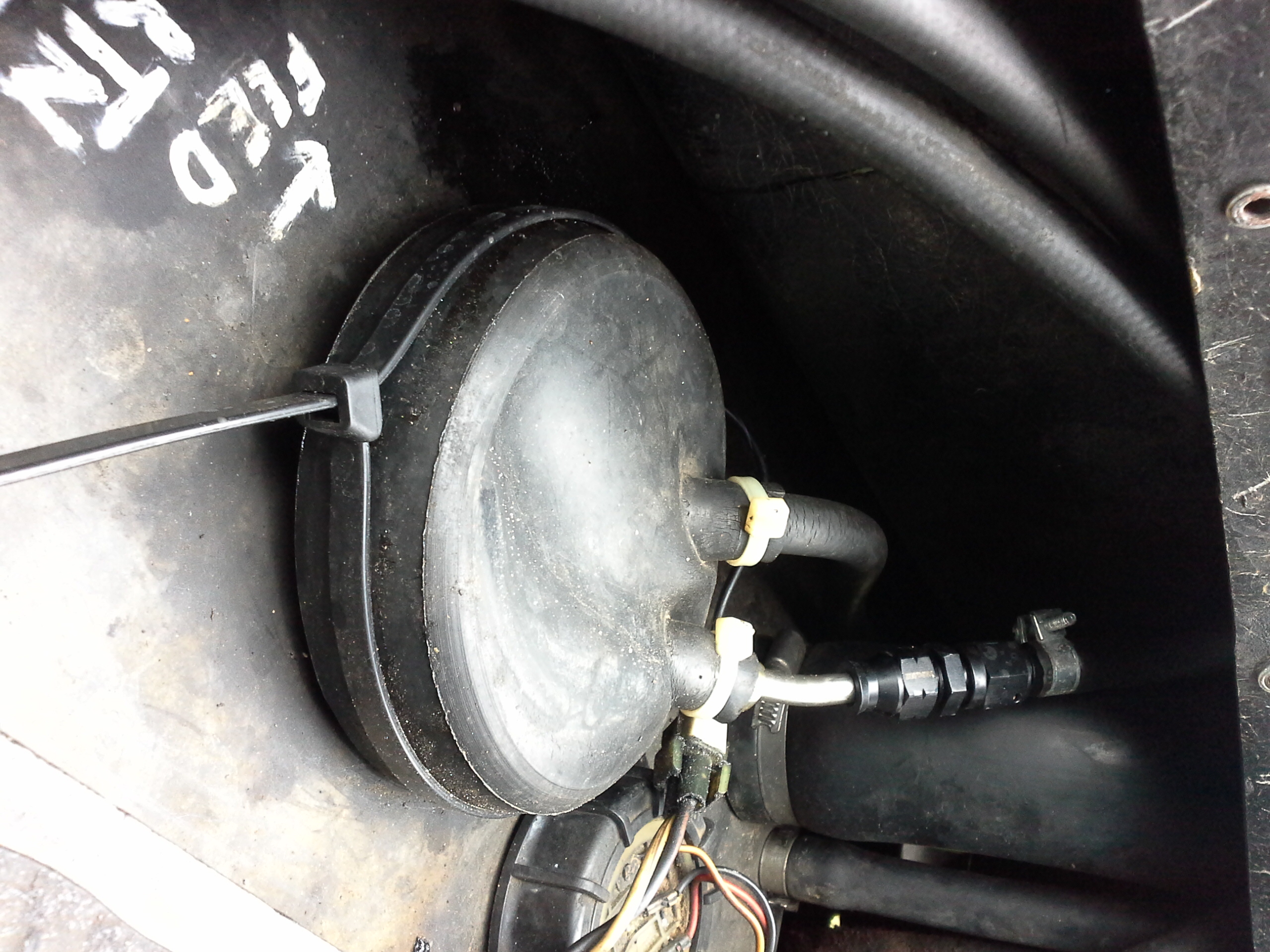

Into the pump, all looked ok

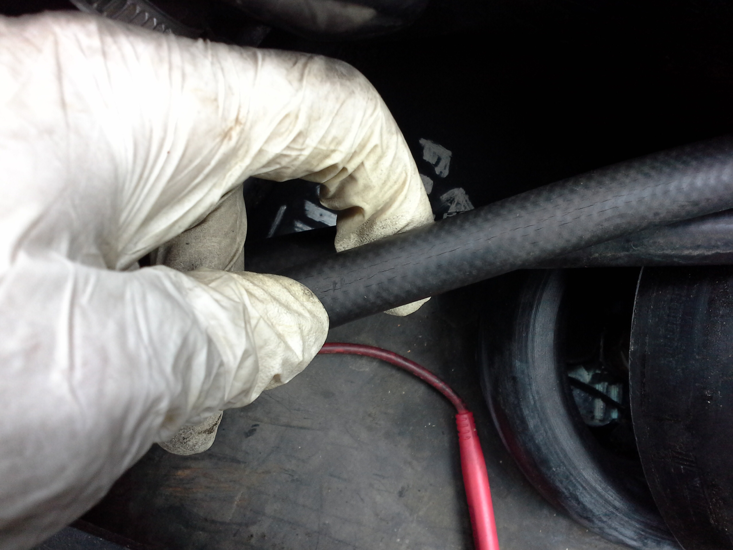

But I didn't like the look of the R9 hose from AFS. I think substandard hose is a real problem... any else noticed so called ethanol resistant hose looking a bit ropey after a few years?
So, parts ordered, I'll do the pump and in-tank filter next weekend. I think I will replace the soft lines too... suppliers? May use this guy from the Scimitar club, who has a real bee in his bonnet about fuel hose, and reckons this genuine Cohline is best. Will have to check pressure specs...
