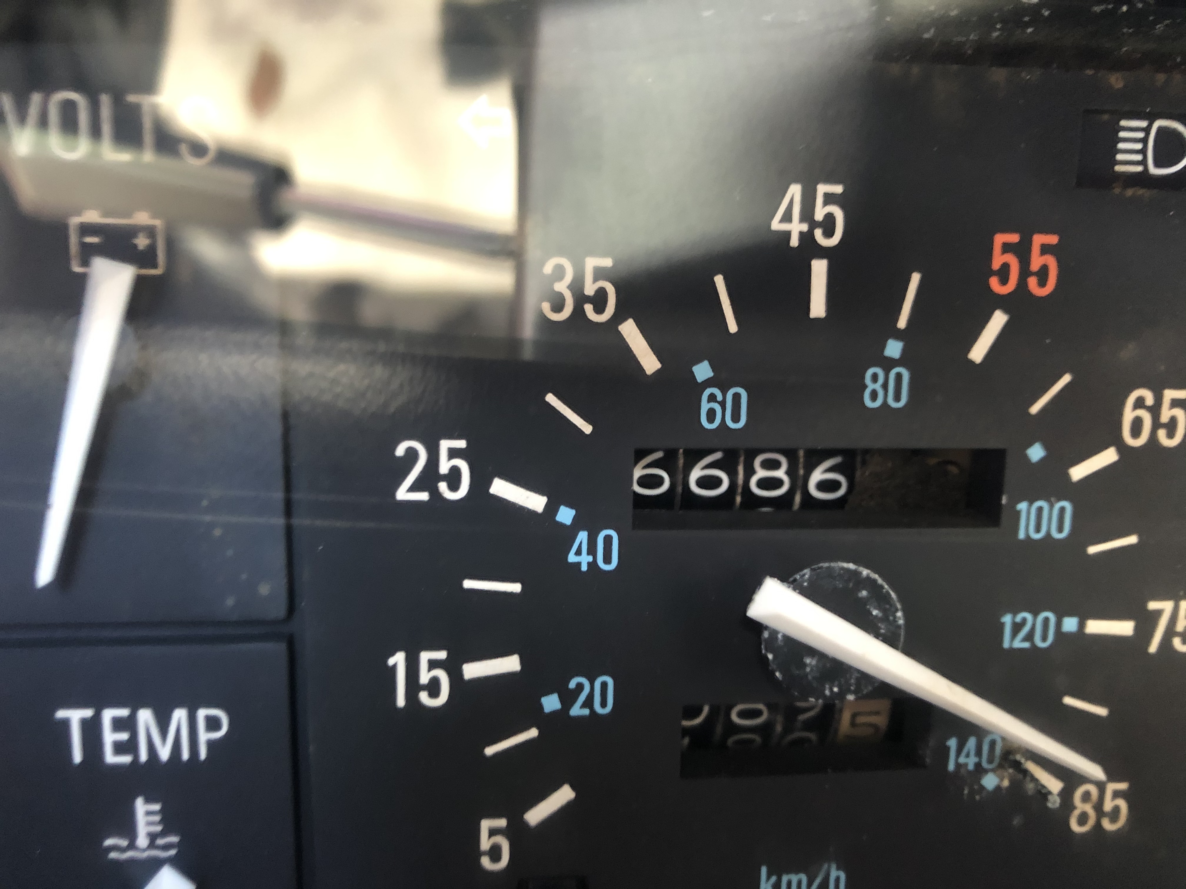

Wasn't there something odd with the speedo ? last few digits unreadable, I initially thought there may be water damage in there ?
You mean my very low mileage! Not sure where the digits went!
Speedo

Darrenre wrote:You mean my very low mileage! Not sure where the digits went!
Looks like a bit of foam has got back there blocking the last two digits, you'll need to take the binnacle apart to fish it out. It's sat at a little under 67k miles.

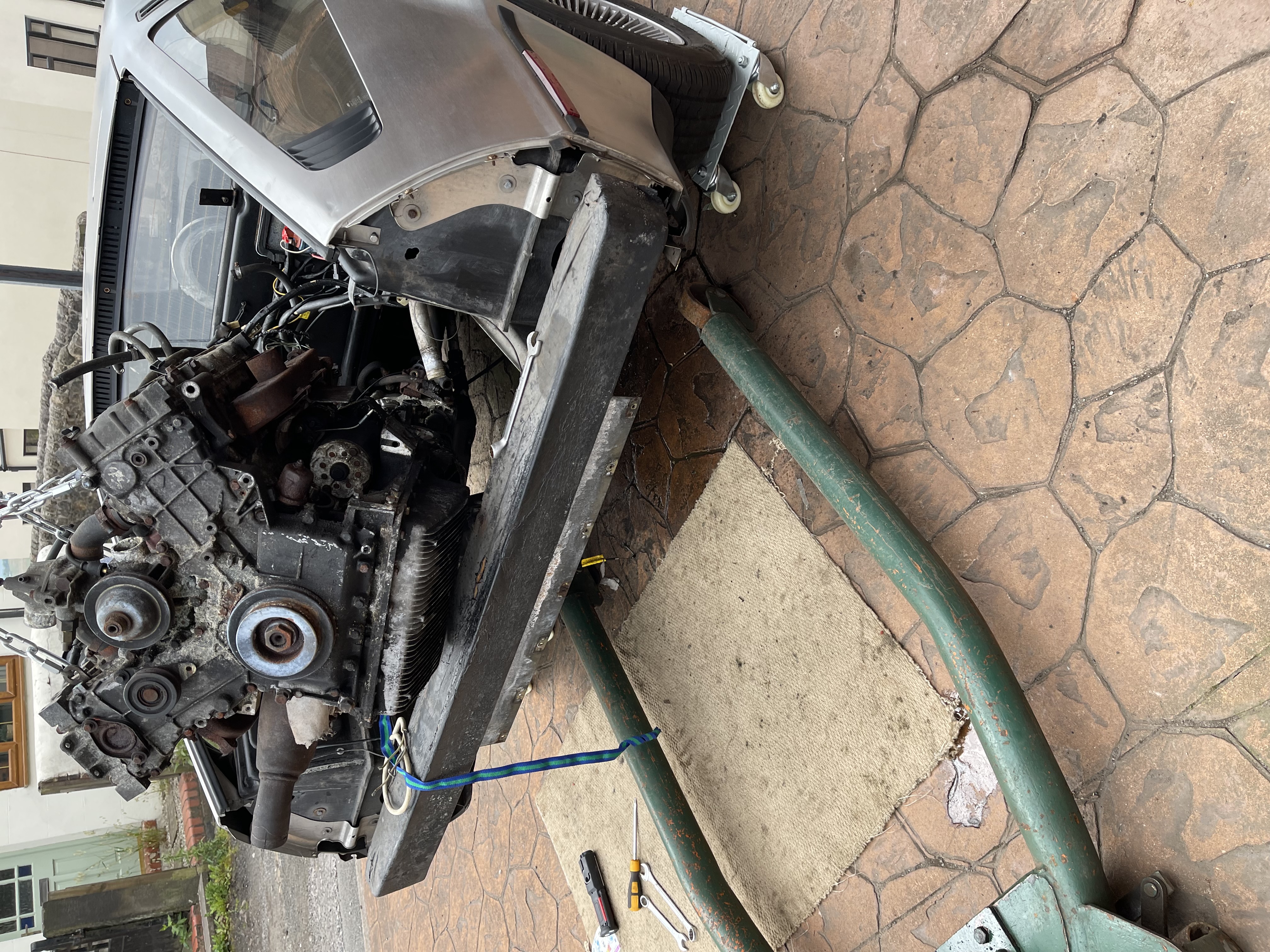

Volvo Engine Finally removed
Volvo Engine Out

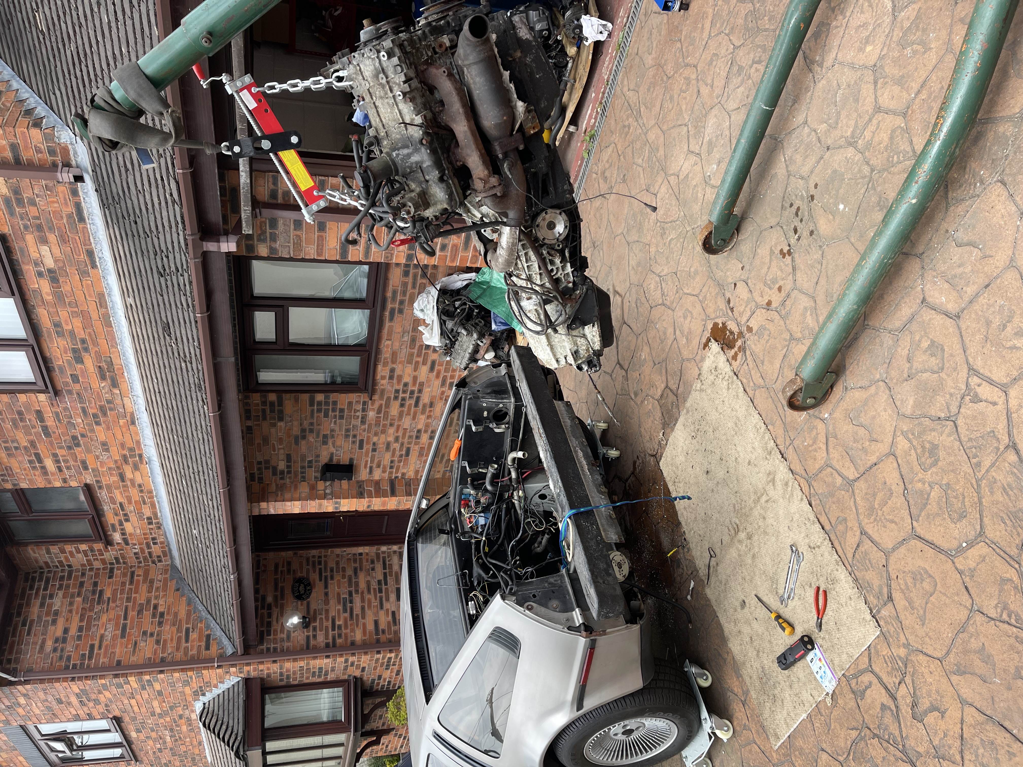

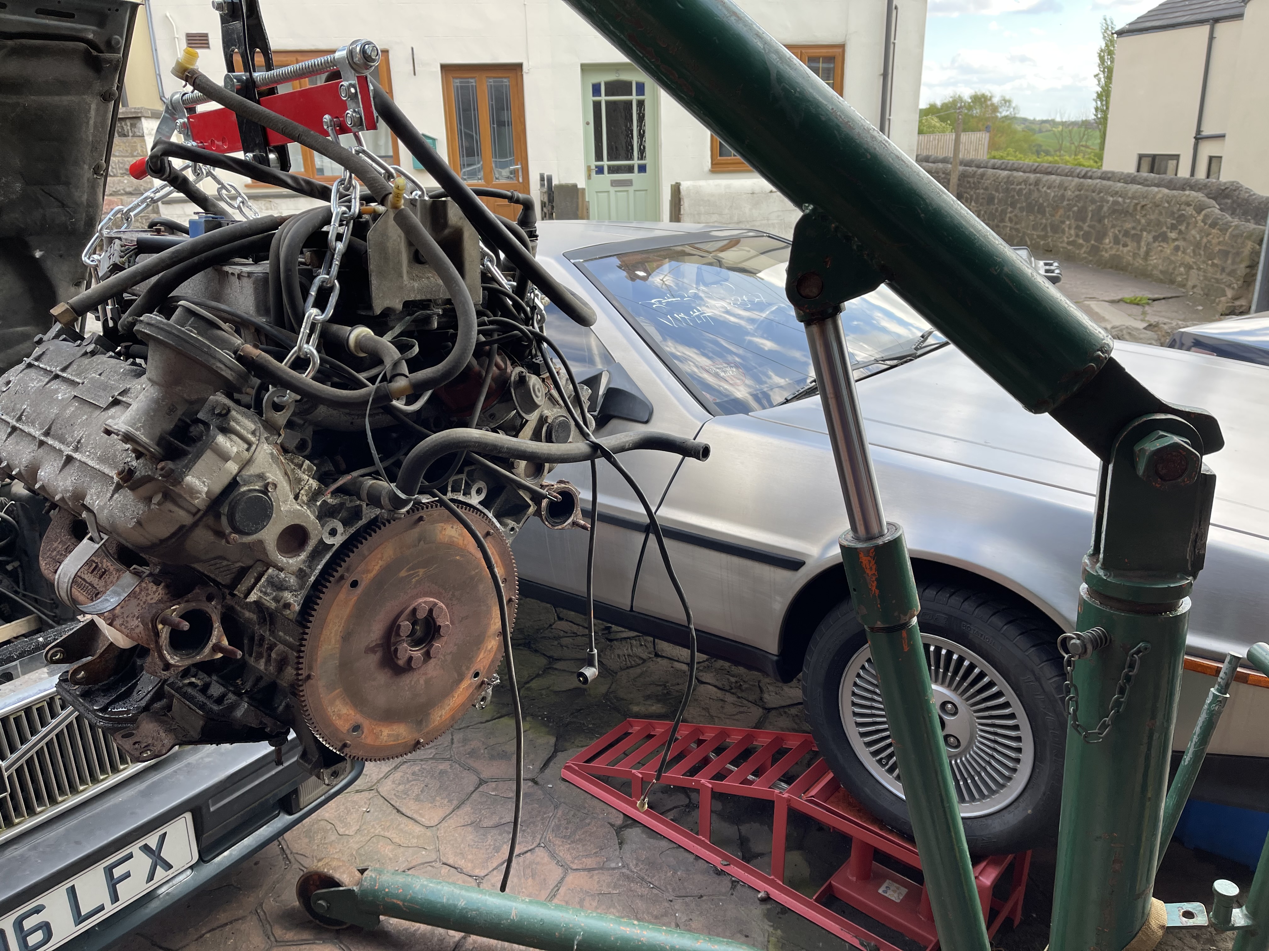

Delorean Engine and Auto Trans Removal
On its way out
Its out!
Driveline out

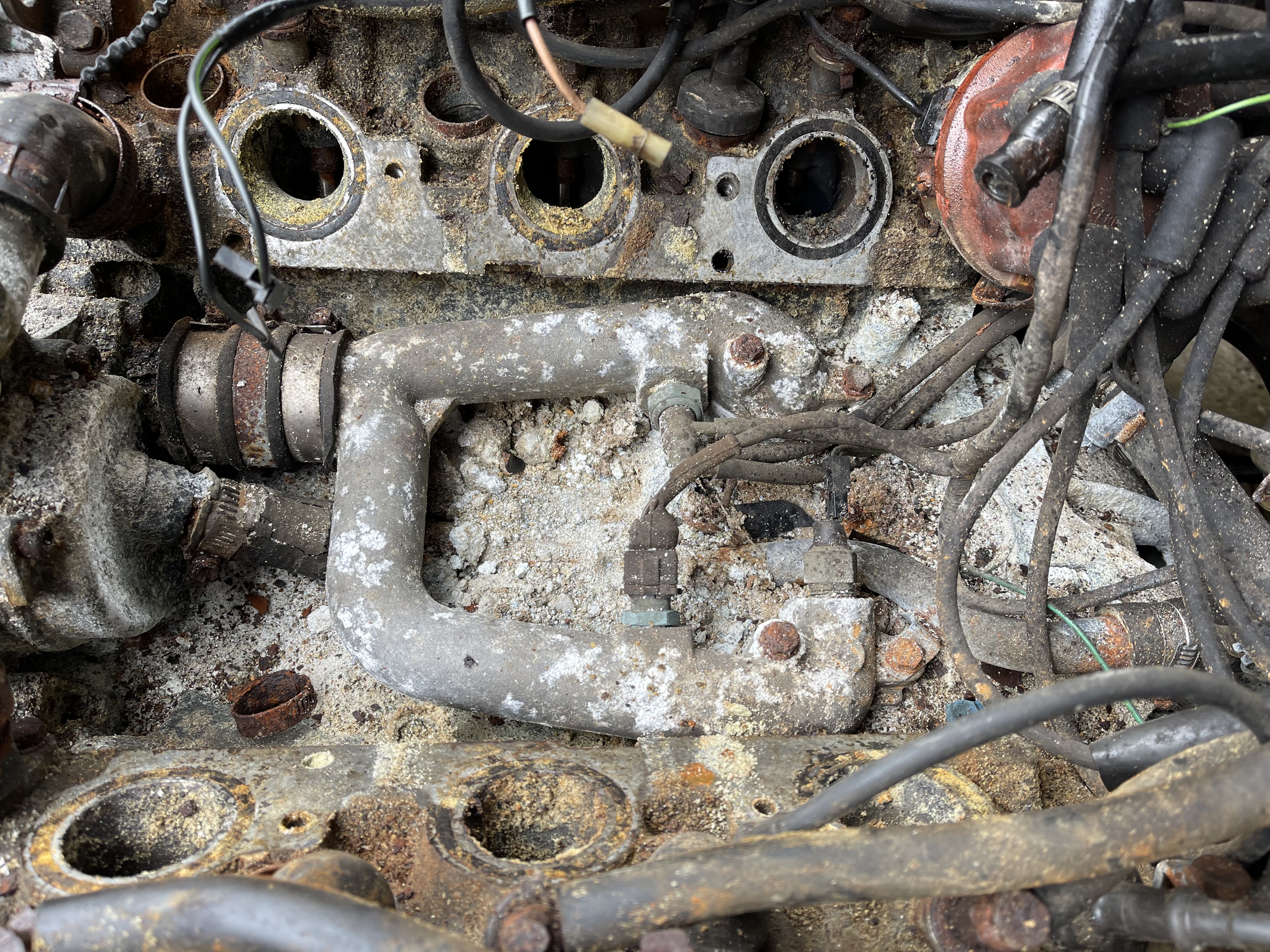

Lovely Valley!
Valley Full of Crud

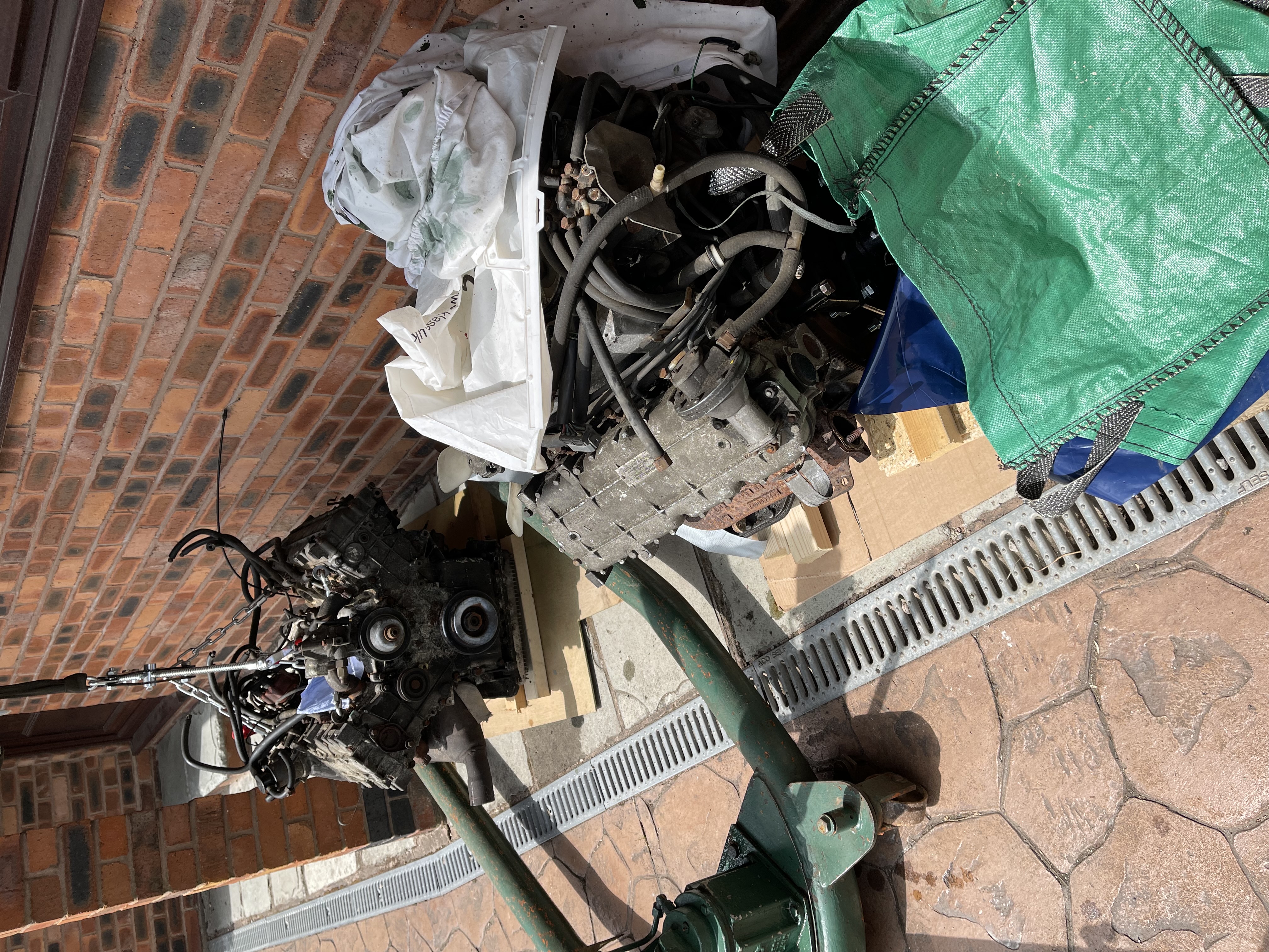

Now the fun part!
Swapping over
Swapping over
