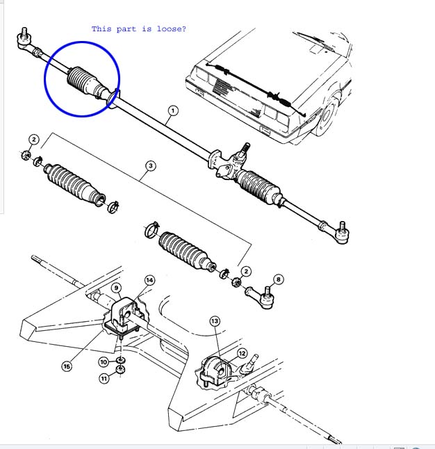

My car went for its MOT today and had a couple of problems. According to the tester the "passenger-side steering inner knuckle joint" is loose/allowing play in the steering. (I will double check exact working on MOT doc when I get home) The part he indicated to me was within the concertinered rubber boot which is at the end of the rack.
Does this sound like I just need to order a replacement part? Martin replaced the steering rack in my car with a low-milage one when I bought it, and there is no play on the driver side, so the issue is just at the passenger end.
Pic below shows the indicated part...
Sorry I'm not very technical with car part terminolgy yet... :(

If that part is loose then you need to have the rack looked at ASAP :shock:
But you need to pull back the bellow and tighten the nut that attaches the tie rod to the ram. I assume he is talking about this part
The picture shows what is inside the bellow, the ram is the toothed bar.If I was you I would have the rack re built for piece of mind. Sure we could arrange to get the rack off :)
If you ram / pinion are in good condition, which they should be, I can have your racked re furbished for £35 + delivery & VAT.

Chriss -That sounds like it could be the problem. That picture is very helpful and I can understand what the problem could be! Otherwise refurbishing the rack is the next option and a no-brainer at £35+vat, again, if anyone would be kind enough to help out..?

In theory yes, but without seeing the car hard to be sure, it could easily be a track rod end too. Also 14k on a rack does not mean its OK, still coming on for 30 years and depends on how it was stored etc
You would not even need to crack the tie rod, just cut the clips holding on the bellow and slide it off along the tie rod, the nut is round but has cut outs for a spanner. Tighten the right amount,not too tight! then re grease and put the bellow back with cable ties
