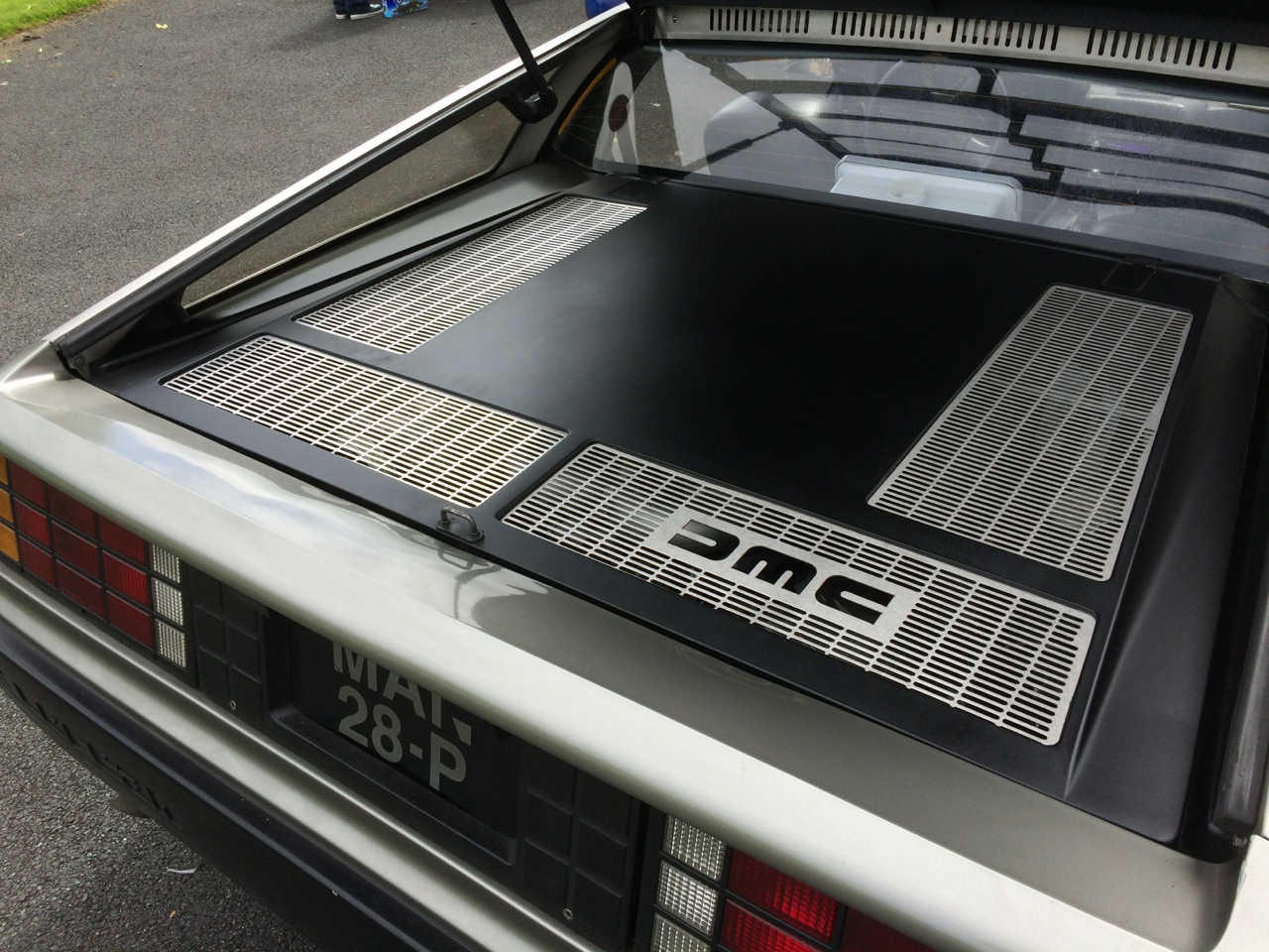

So today, being fathers day, I decide I'm allowed a bit of time to work on my cars and today its the turn of the D to get some love.
Digging through my pile of 'bits I need to put on the car' I find Ed/Julians rear stainless engine cover inserts, digging deeper i find the pack of new metal clips and the new engine cover hinges, sorted I know what I'm doing!
So everything goes to plan and she's looking luuvly :)

Anyway at least the rear engine cover looks good.

Doh, bugger. Nice grills though Simon :D
