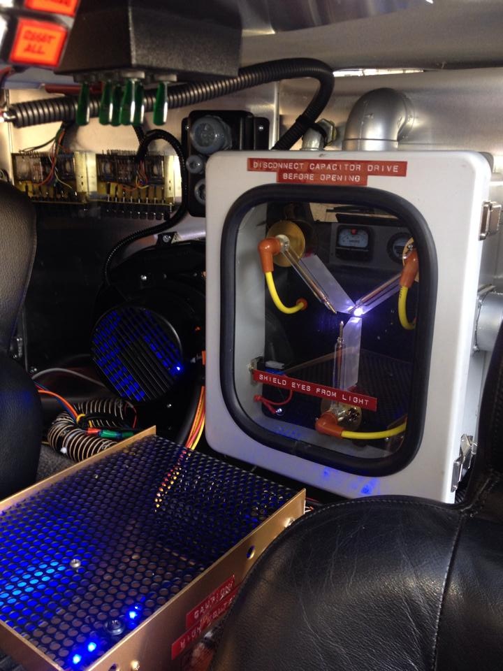

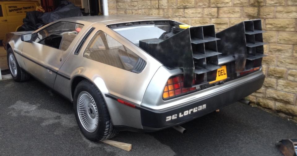

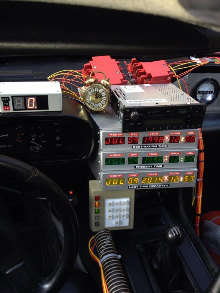

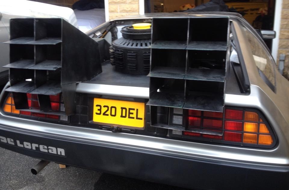

In case any one is interested I thought I would post up a couple of pics of my conversion so far. The conversion is a no holes drilled project and so far has taken me 18 months to source the parts from all across the world. I have tried to keep it as accurate as I possibly can. Yes I do know I have black interior, and yes I know I dont have the correct bonnet but the general public won't mind I'm sure :D
Ready for the hoses and other bits and bats to be added

How the hell do I get the windows out without smashing :D ?

First insert a thin, long and sturdy metal like a screwdriver through the rubber seal to create a hole. Then push trough a thin wire. With that wire pull it around thr glass to cut the black silicone. Do not force push the glass at any time.
Awesome looking time machine mike:)))
Re: My BTTF conversion
Postby A Van » Tue Jan 13, 2015 10:00 am
You have done really well mate nice work, cheesewire worked around the screen will chop through the sealant

Thanks Guys, I will give it a go :-) unless of course a Wakefield Delorean owner wants a trip to Bingley to do it for me :-)

Postby Deloreanyorkshire » Wed Jan 14, 2015 10:59 pm
It's not the windscreen admin it's just the rear pontoons. The windscreen front and rear are definitely staying in:-)
