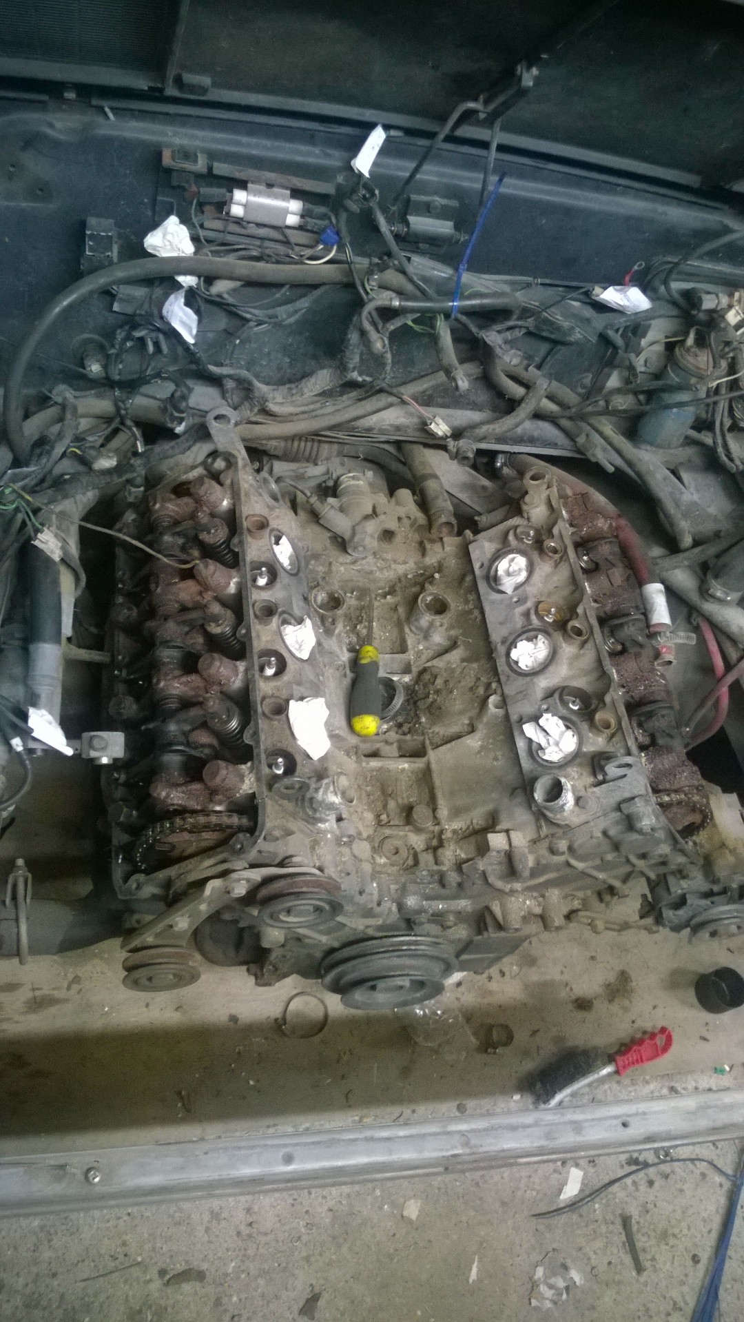

Removed the top bits and labelled up

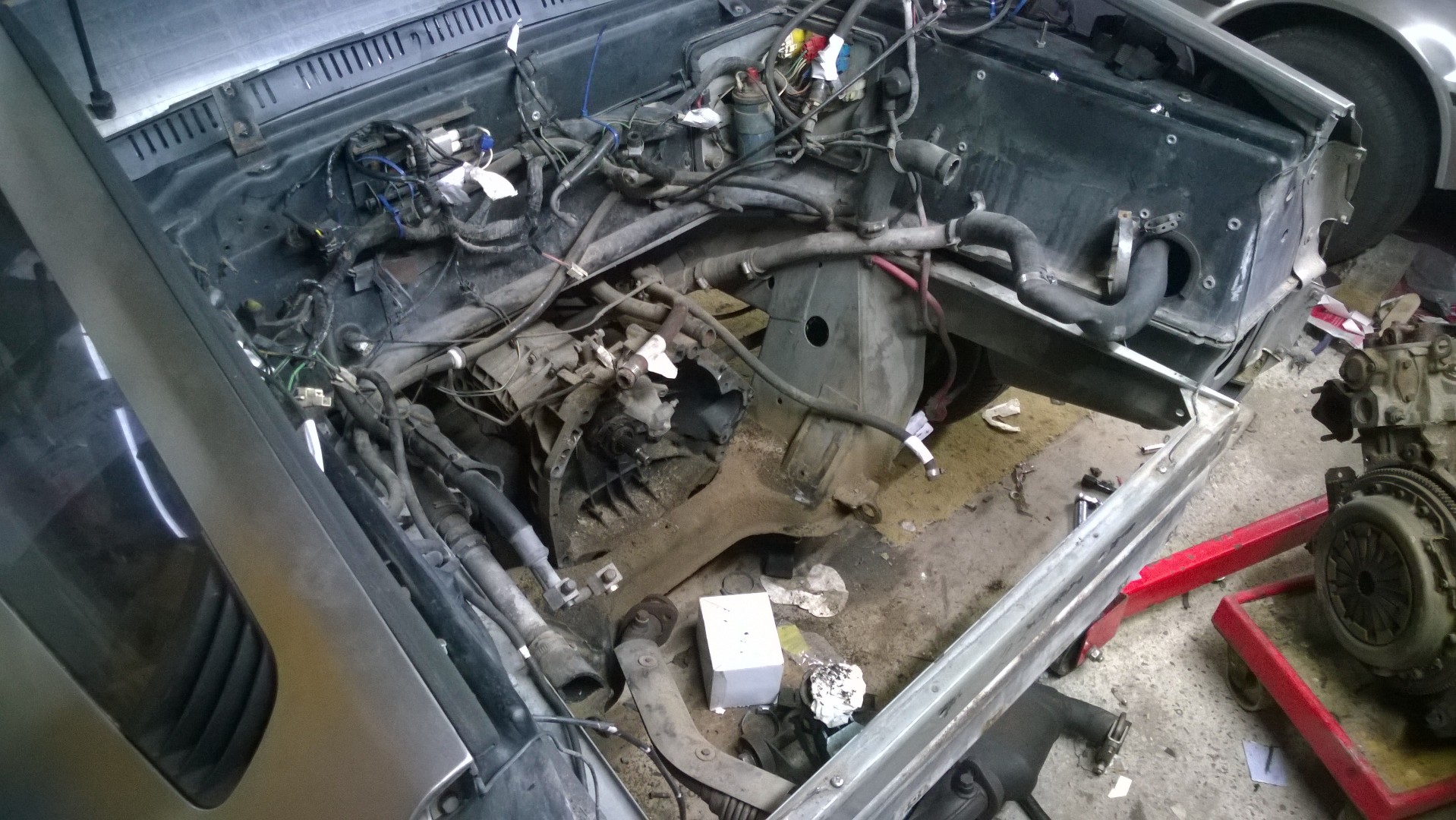

Removed the rear bumper and the rocker covers D:
WP_20160111_005 1.jpg (578.54 KiB) Viewed 6555 times

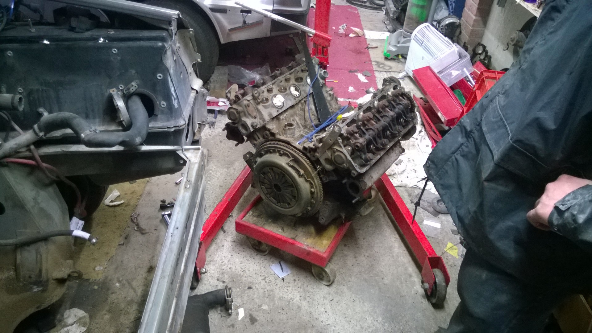

BOOM!
There she is!

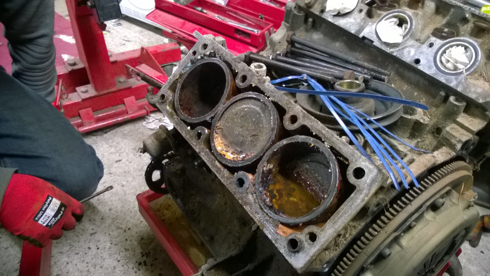

Uh ohhh!
This is why the engine wouldn't move! After, the very hard task, removing the internals of the engine we found out that pistons were completely rusted to the liners! So that was the end of those pistons But!

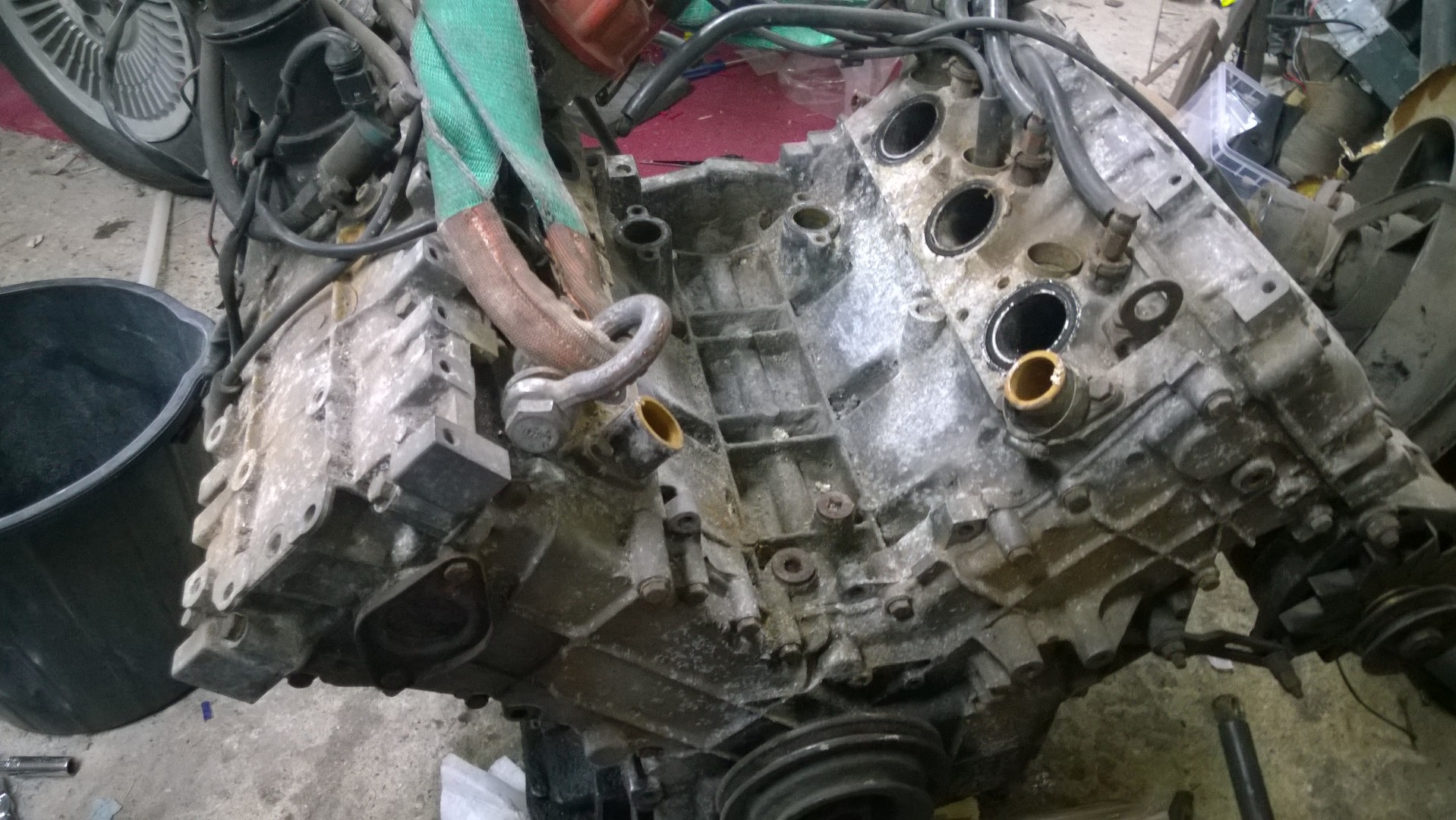

My new engine, top bits already removed
The engine block was absolutely fine, on my original engine, which went to my brother who needed a new block after his welding of the valley went the way of the Bible. But the crank and heads were good, so spare parts! :thumbsup:

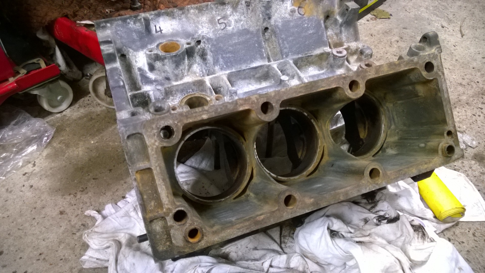

But because my brother dismantled it ready to make it his, it looked like this
And THEN! He found out it was a 2.7.....thus having no need to disassemble it hahaaa.
So I'm now assembling all the gaskets for it then rebuilding time!
