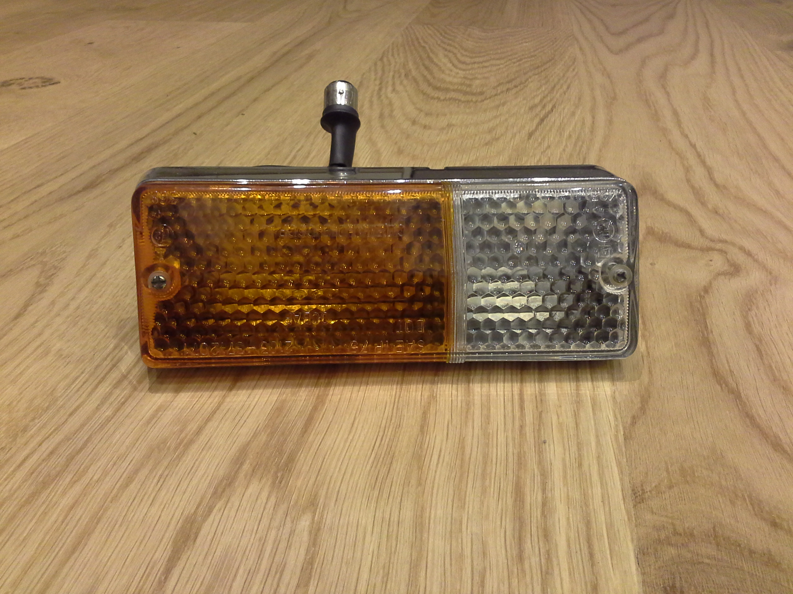

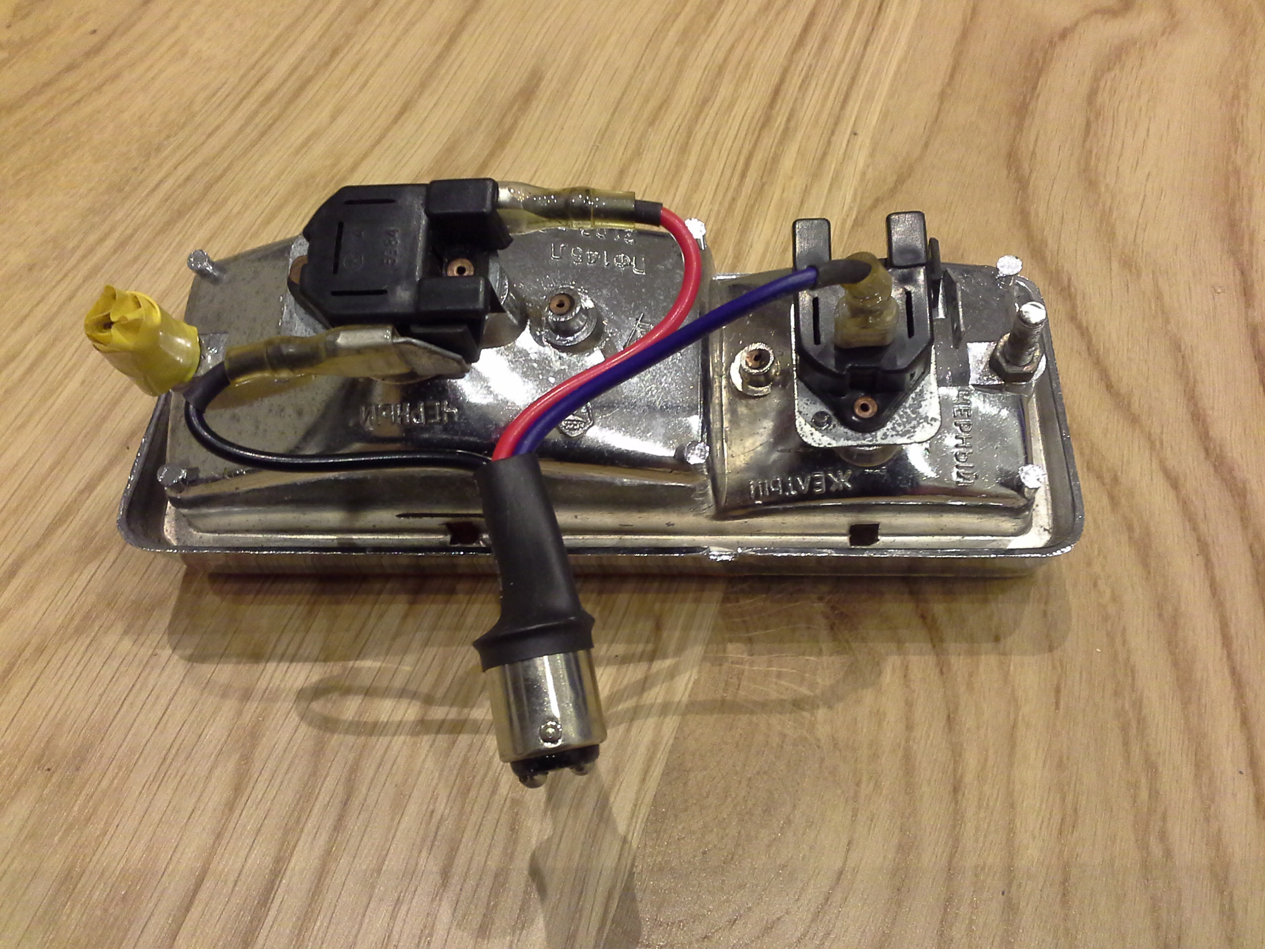

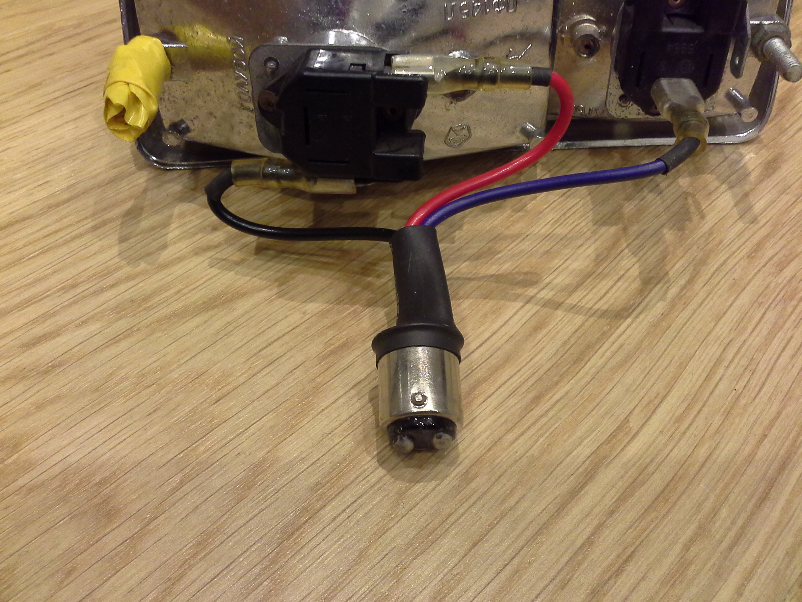

I also sourced the lada indicators but never fitted them. I made up tails to fit into the exiting bulbholders, which then split off the side light and indicator functions, so if I wanted to fit them I wouldnt have to butcher any witing- simply plug in to the existing bulb holder, which then splits off the function to two separate bulbs in the Lada unit..

Postby andyd » Tue Mar 27, 2018 8:01 pm
You can buy the tails on ebay, but I think I had to get them from the US (staggered pins on the male "bulb" fitment)
I have them "just in case" but they would only be on for a morning till I got the ticket! !

Postby Rissy » Wed Mar 28, 2018 9:12 am
Here we go. All the way from Germany. (Personally, I think i'll make my own using a couple of broken bulbs)
https://www.ebay.co.uk/itm/Rucklicht-Ad ... %7Ciid%3A1
