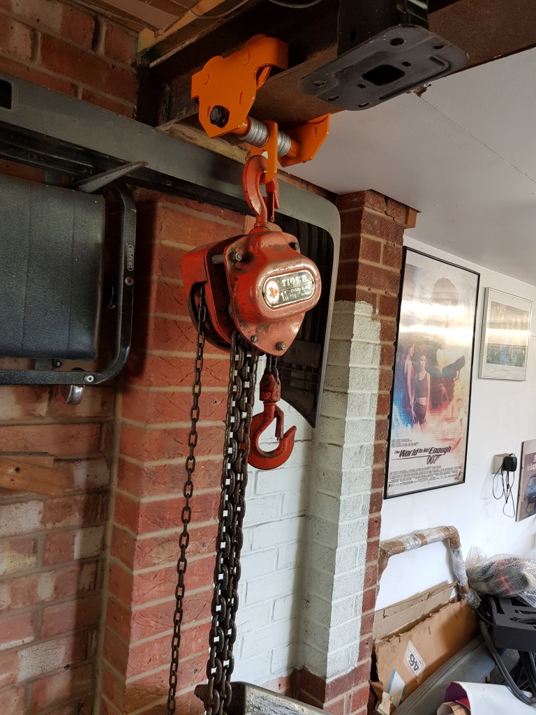

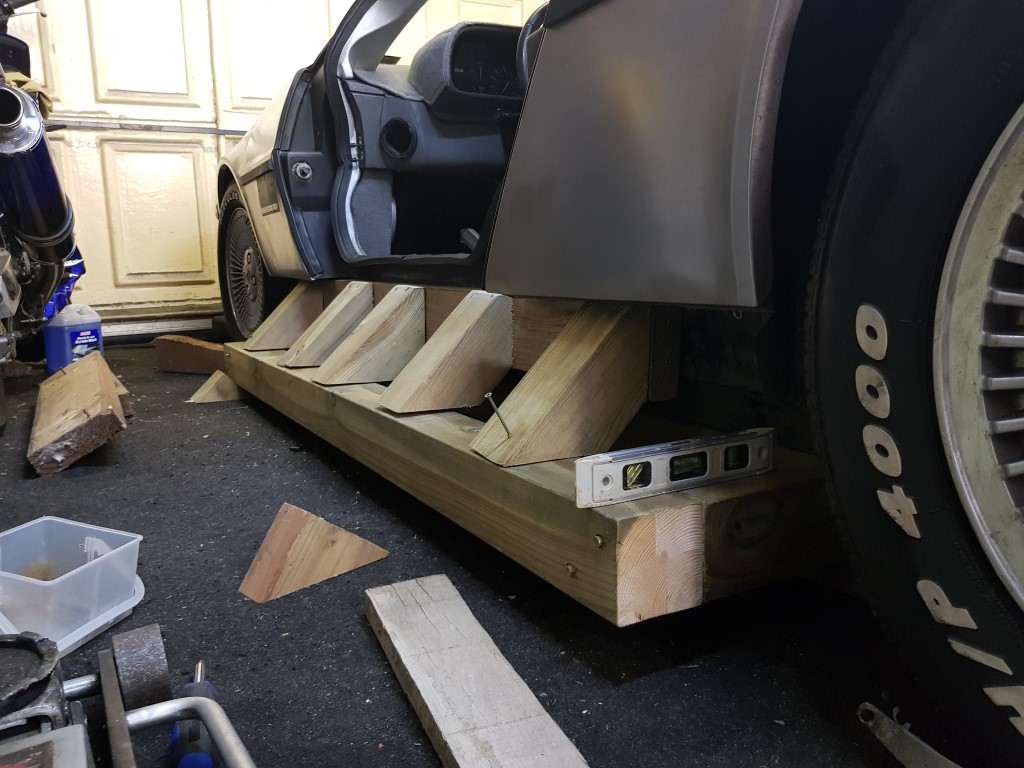

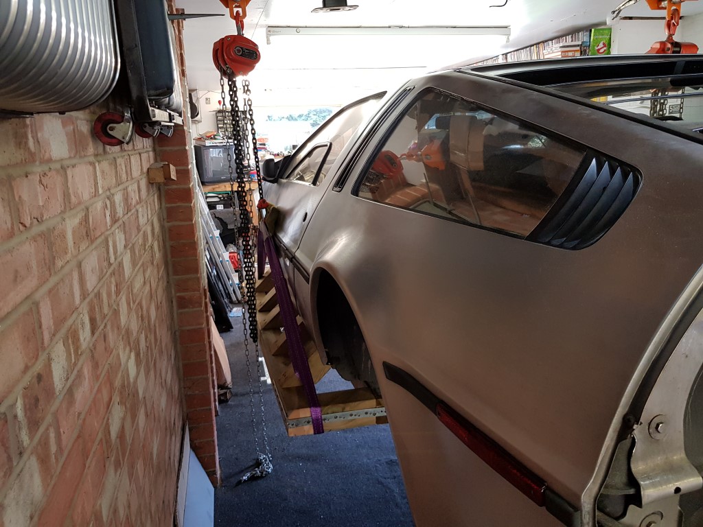

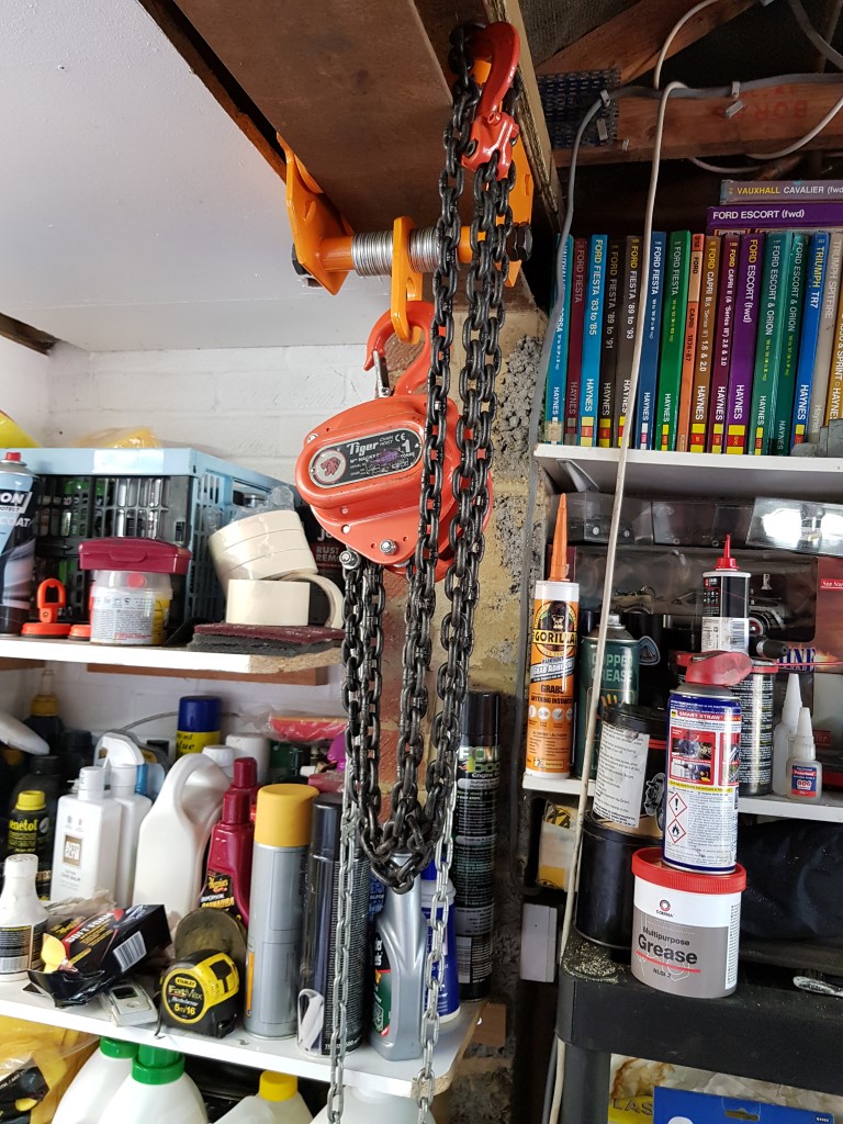

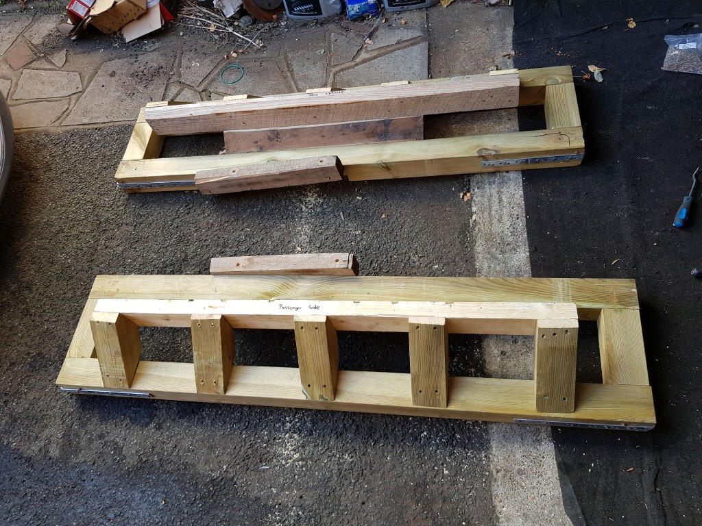

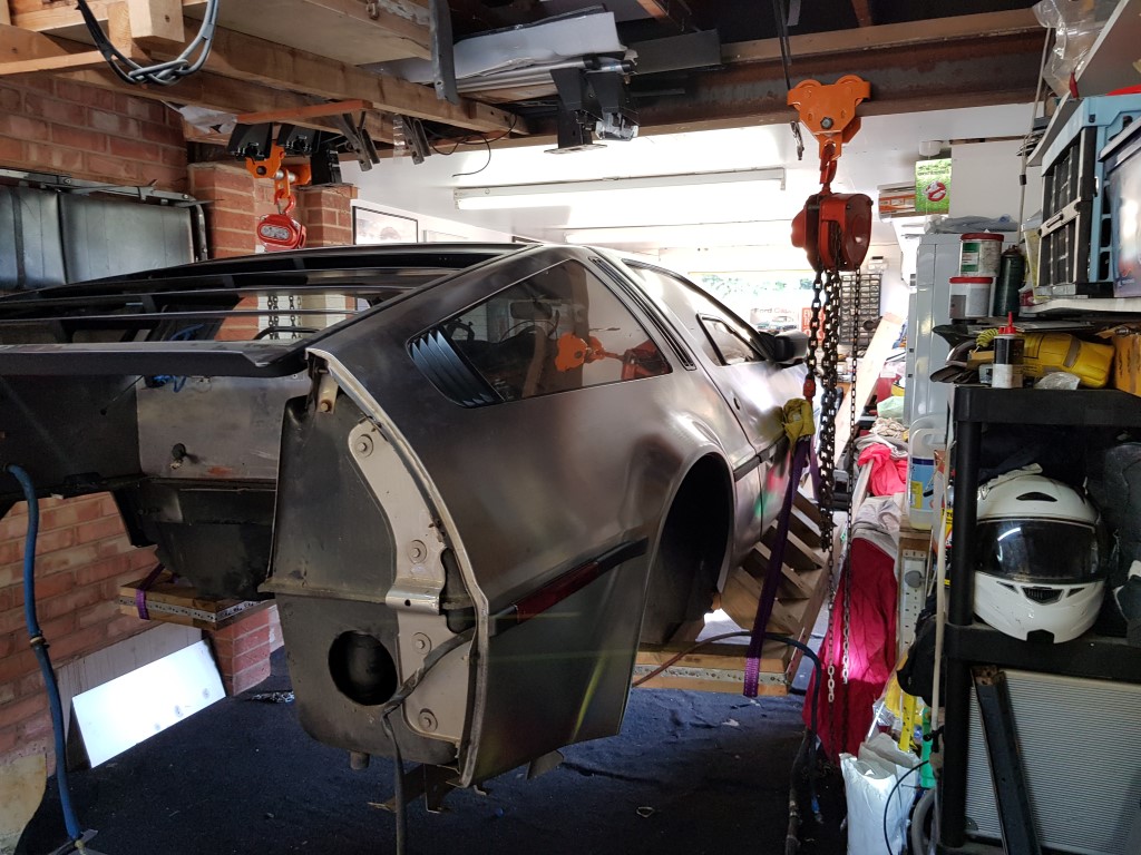

Well I've finally put into action the epic plan to sort everything out, so it started off with an idea of making use of the RSJ that runs across the middle of my garage and use to RSJ trolleys and 2 chain winches to lift some sort of brackets to lift the body off, this would act the same way as a 2 post ramp and leave the middle of the car free to lift the body off the chassis.
I started off getting these ...

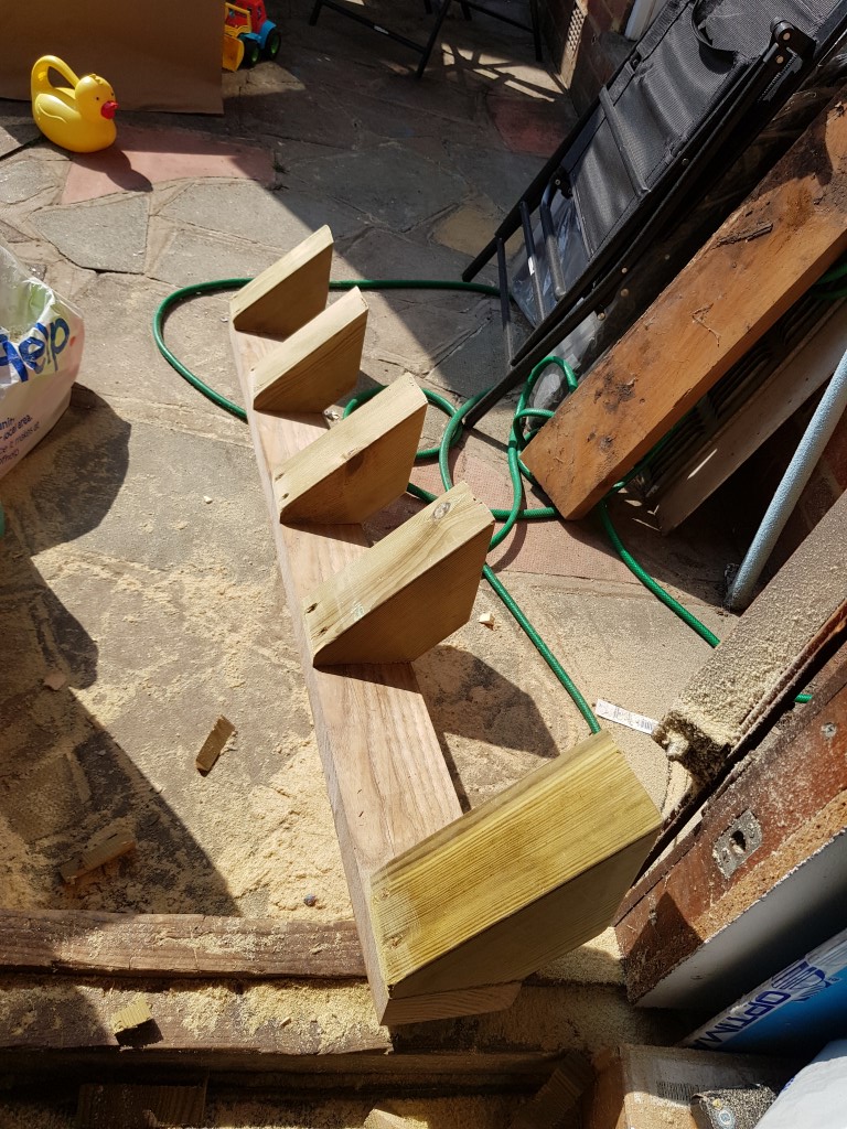

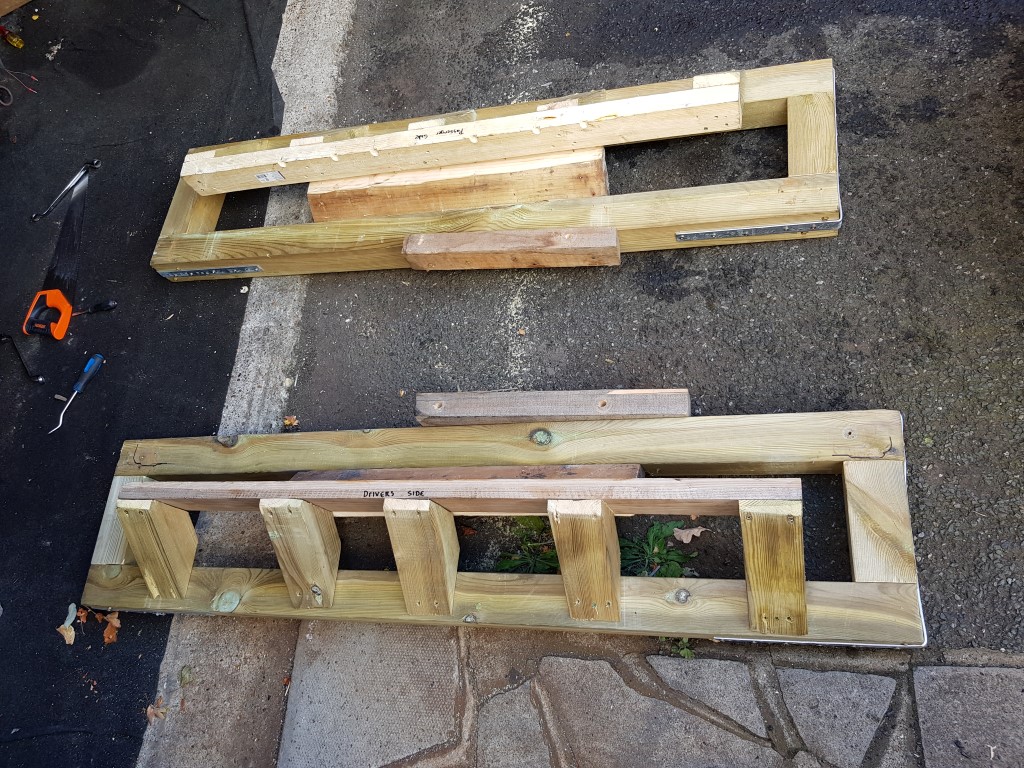

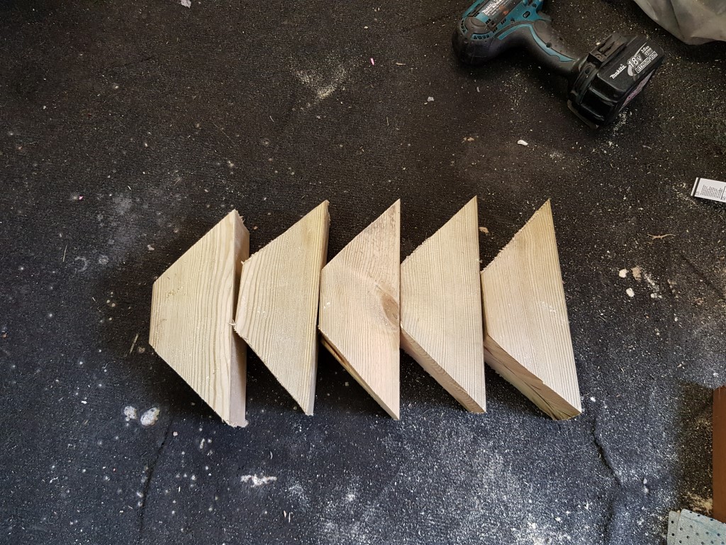

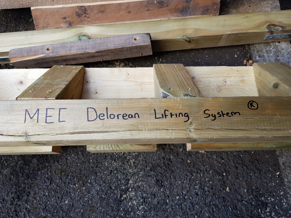

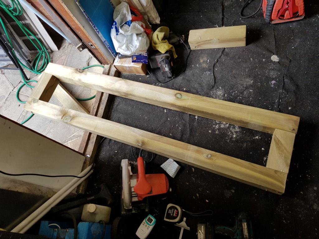

After this i then started thinking about what i could make to lift the body up and came up with this ...
20180829_143237 (Medium).jpg (285.33 KiB) Viewed 9528 times
20180829_162628 (Medium).jpg (386.6 KiB) Viewed 9528 times
20180830_111603 (Medium).jpg (354.39 KiB) Viewed 9528 times
Then for a test fit ...
20180830_113745 (Medium).jpg (206.66 KiB) Viewed 9528 times

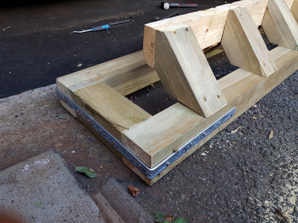

I then added another piece of wood on the back of the main square from which fits into the recess under the car and bolt through the seat mounting holes, this prevents the brackets from slipping out from under the car...
20180904_221035 (Medium).jpg (283.53 KiB) Viewed 9528 times
After a few more tweaks and modification i ended up with these ...
20180928_135205 (Medium).jpg (381.4 KiB) Viewed 9528 times
20180928_135218 (Medium).jpg (376.12 KiB) Viewed 9528 times
20180928_140952 (Medium).jpg (319.1 KiB) Viewed 9528 times
20180928_122104 (Medium).jpg (373.77 KiB) Viewed 9528 times

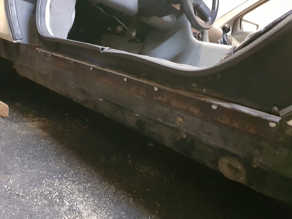

I also added a strong piece of angle Iron which bolted in the sill, this bolted in place of the original tin piece so no extra holes were needed...

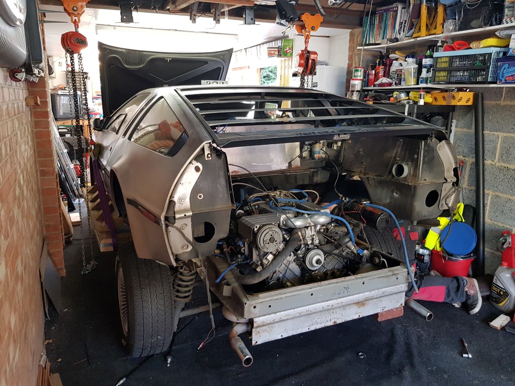

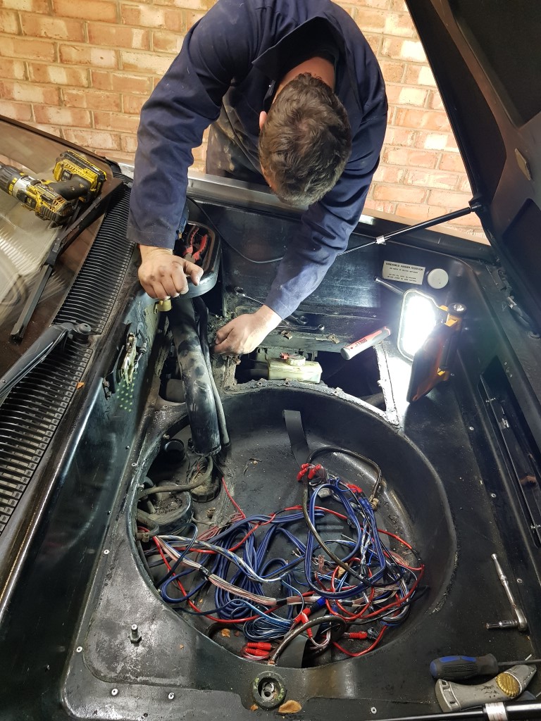

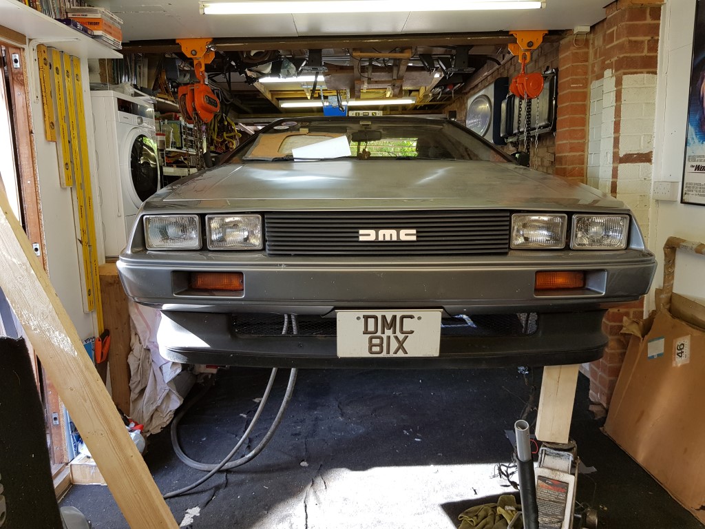

I then preceded to remove the rear facia and a few other bits and then at 7.50am this morning (Saturday) i had a visitor ...
20180929_081950 (Medium).jpg (266.23 KiB) Viewed 9528 times
I'l continue how we got in, in the next post ... ;)
Re: MEC'S EPIC RESTORATION
Postby mec » Sat Sep 29, 2018 9:18 pm

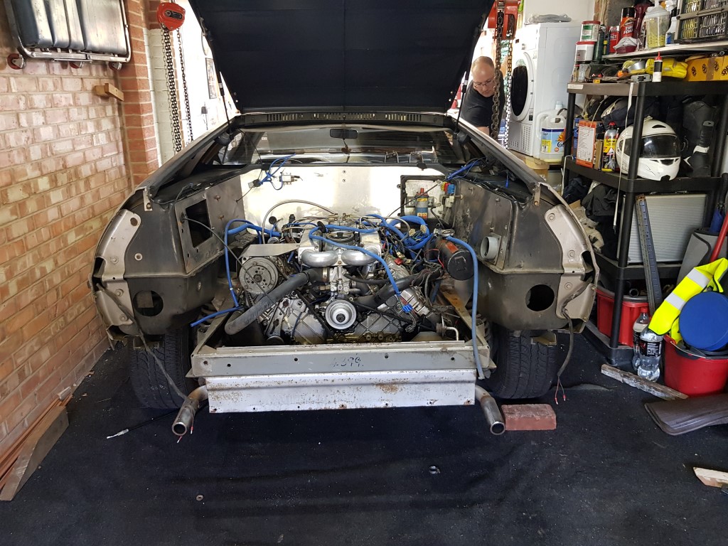

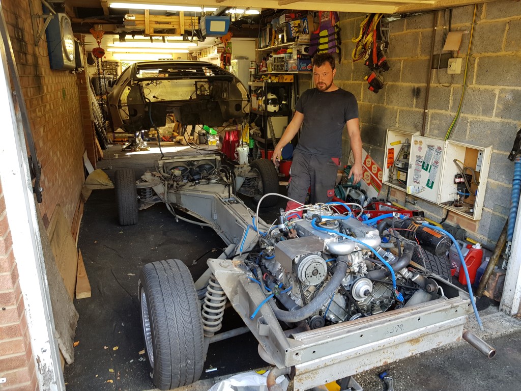

So Mr Alex Denny arrived and we got to work ...
20180929_101826 (Medium).jpg (328.77 KiB) Viewed 9520 times
20180929_120555 (Medium).jpg (300.7 KiB) Viewed 9520 times
20180929_122810 (Medium).jpg (236.58 KiB) Viewed 9520 times
20180929_124241 (Medium).jpg (325.79 KiB) Viewed 9520 times

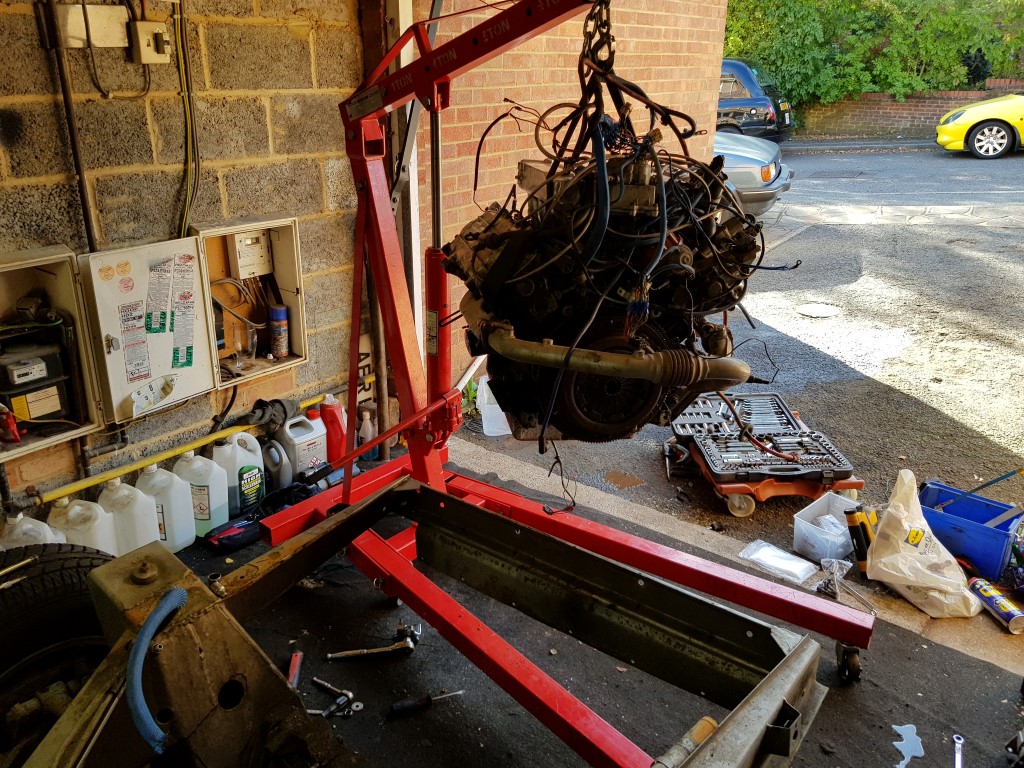

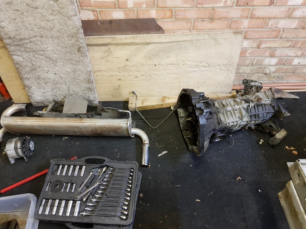

Engine out ...
20180929_152312 (Medium).jpg (370.18 KiB) Viewed 9520 times
Gearbox out ..
20180929_180249 (Medium).jpg (287.27 KiB) Viewed 9520 times

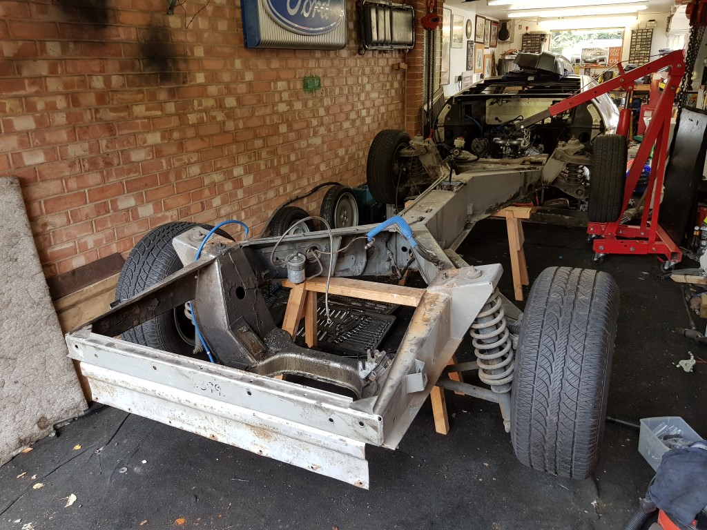

As its sits tonight...
20180929_190532 (Medium).jpg (303.7 KiB) Viewed 9520 times
Not Bad for 8 Odd Hours work ... more updates to come soon ! watch this space :dmcdoors:

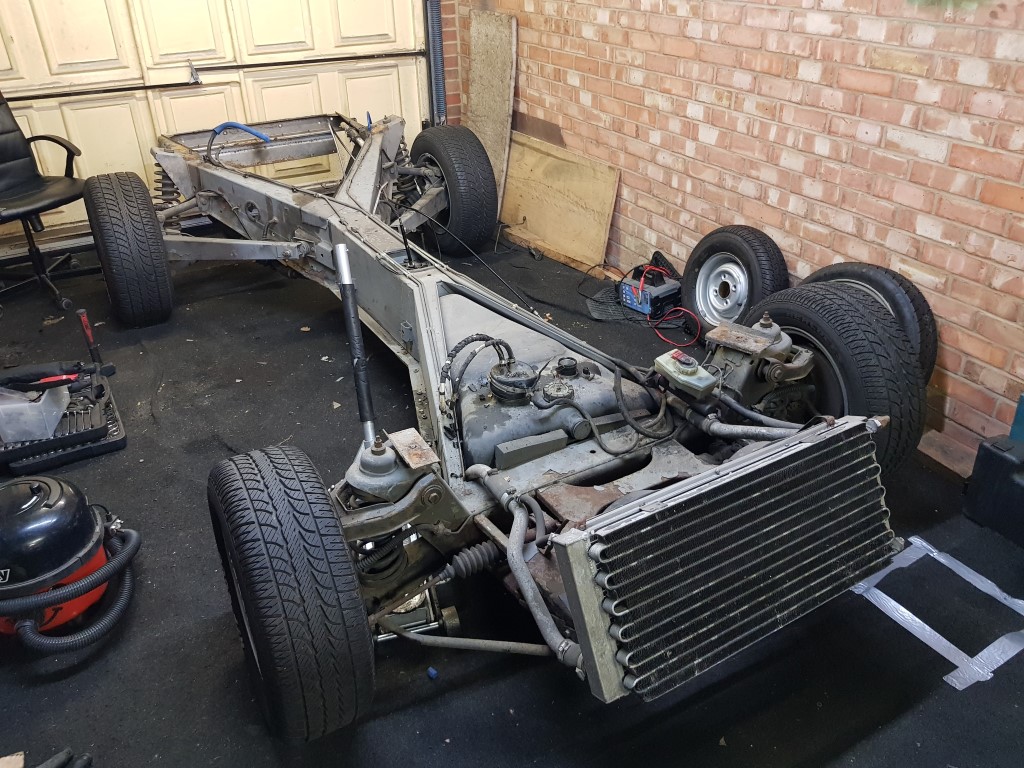

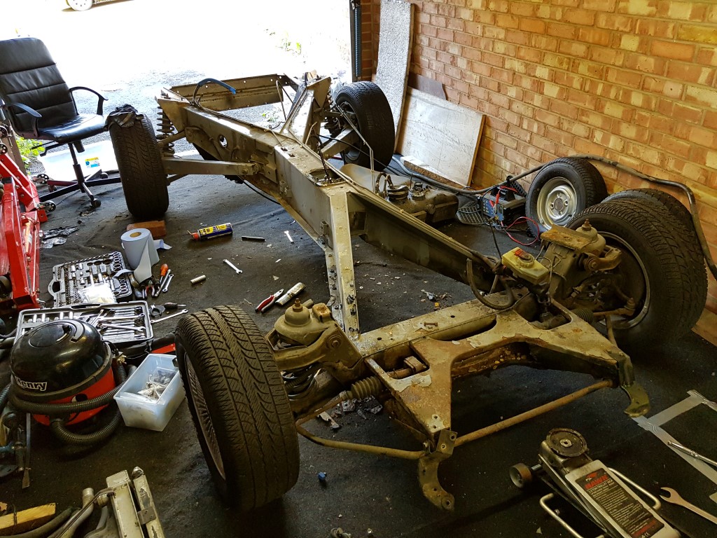

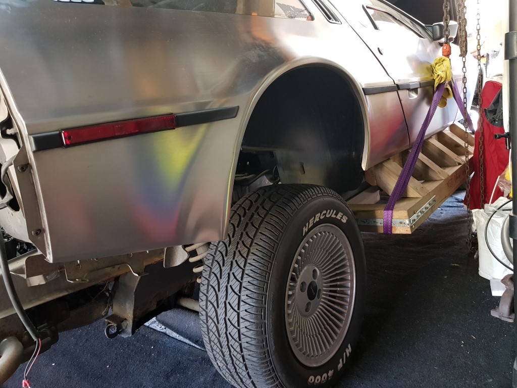

So then onto today (Sunday), another full day in the garage (on my own this time) and progress carried on at a fair pace...
20180930_101042 (Medium).jpg (303.2 KiB) Viewed 9448 times
20180930_111420 (Medium).jpg (311.9 KiB) Viewed 9448 times
Tank and Rads off
20180930_112701 (Medium).jpg (335.69 KiB) Viewed 9448 times

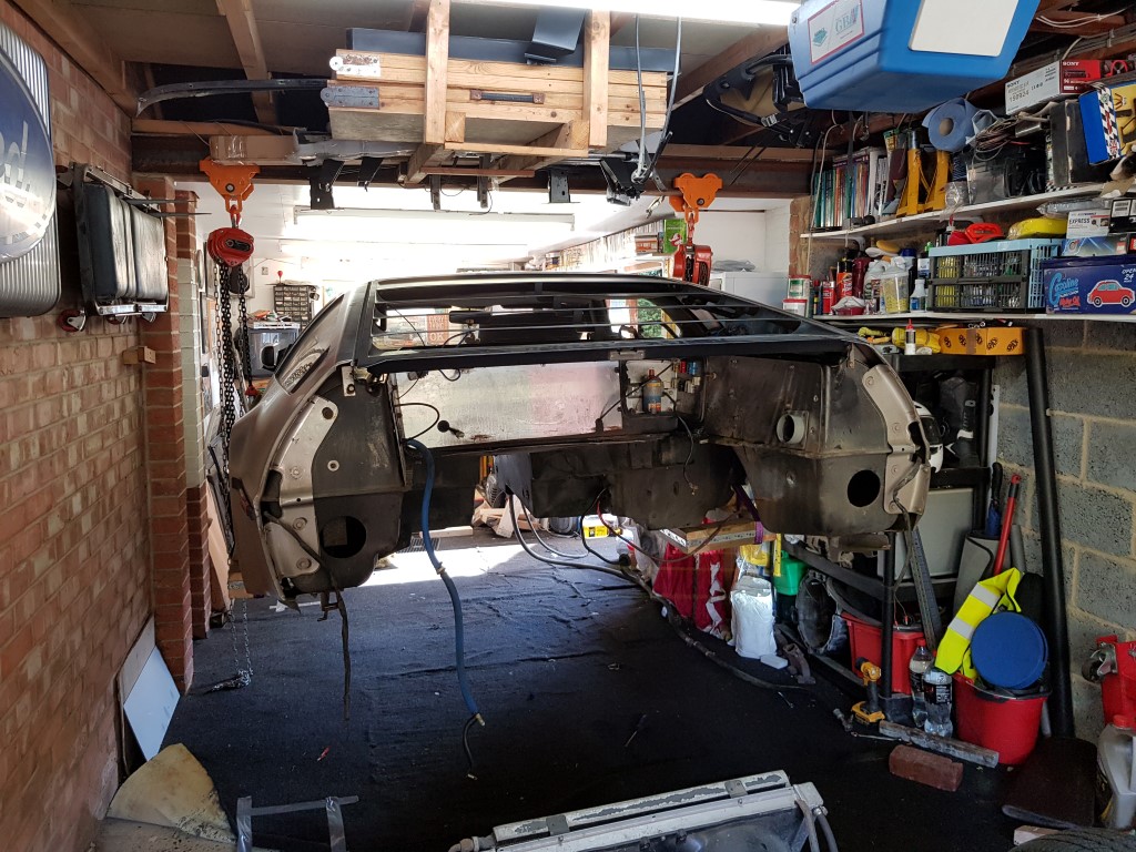

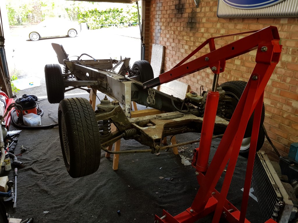

Going up !
20180930_122358 (Medium).jpg (292.61 KiB) Viewed 9448 times
20180930_122337 (Medium).jpg (326.79 KiB) Viewed 9448 times
20180930_123829 (Medium).jpg (310.79 KiB) Viewed 9448 times

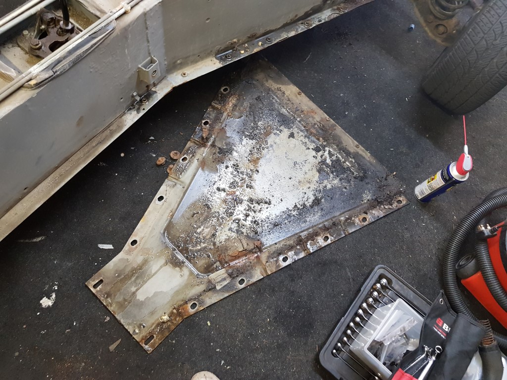

Rear suspension out
20180930_143450 (Medium).jpg (351.58 KiB) Viewed 9448 times

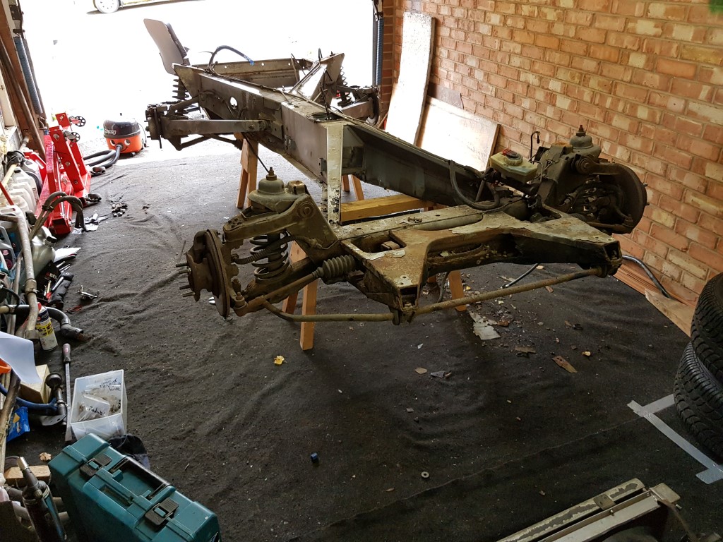

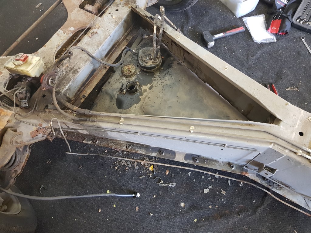

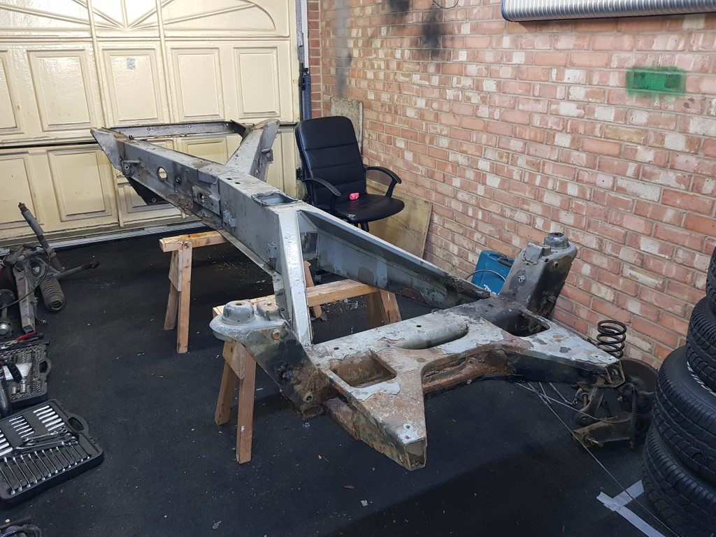

and then to the end of the day... chassis completely striped...
20180930_225714 (Medium).jpg (288.25 KiB) Viewed 9448 times

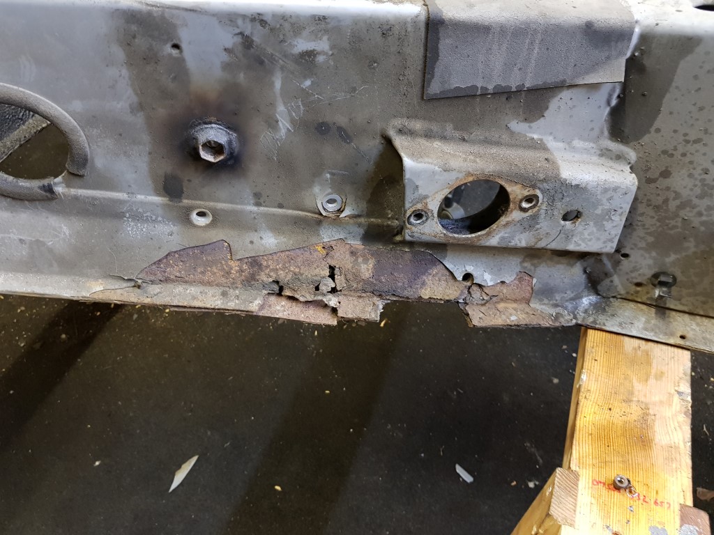

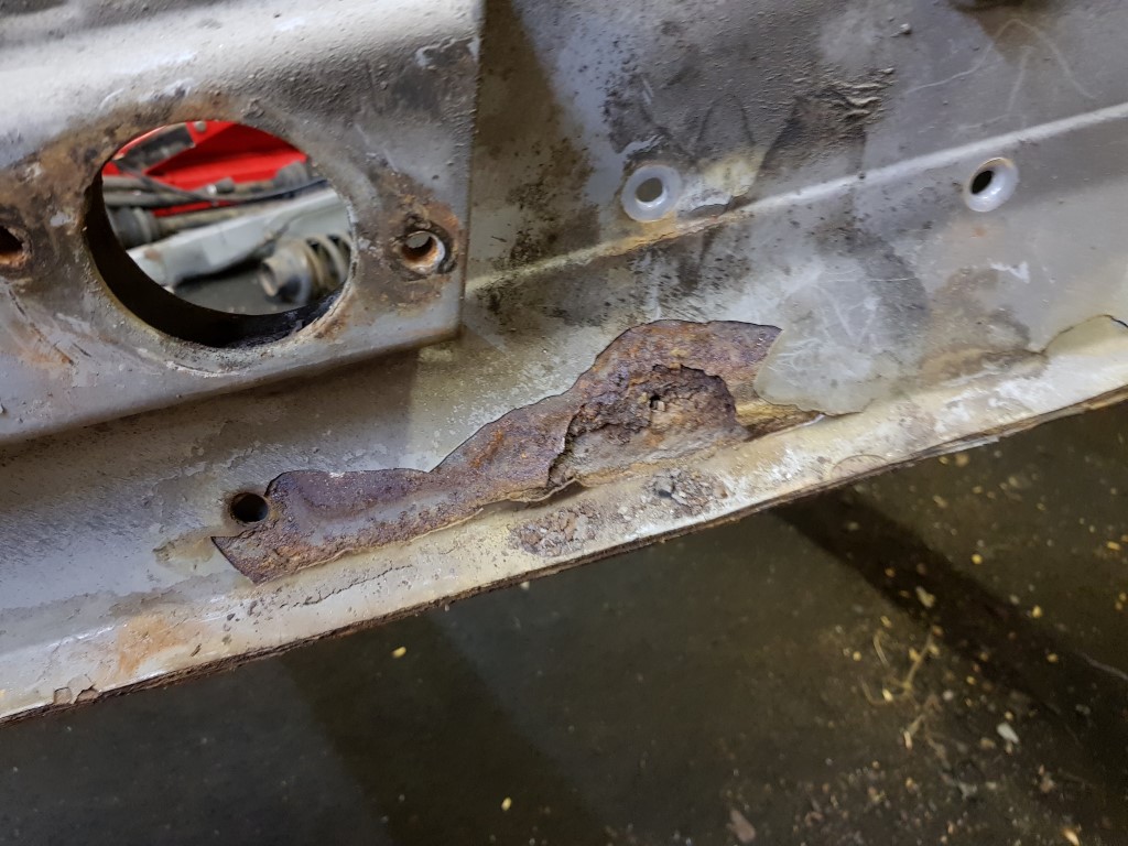

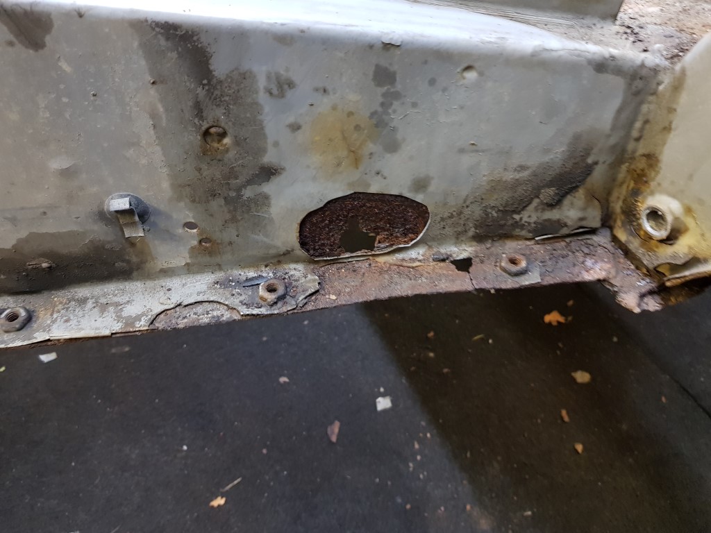

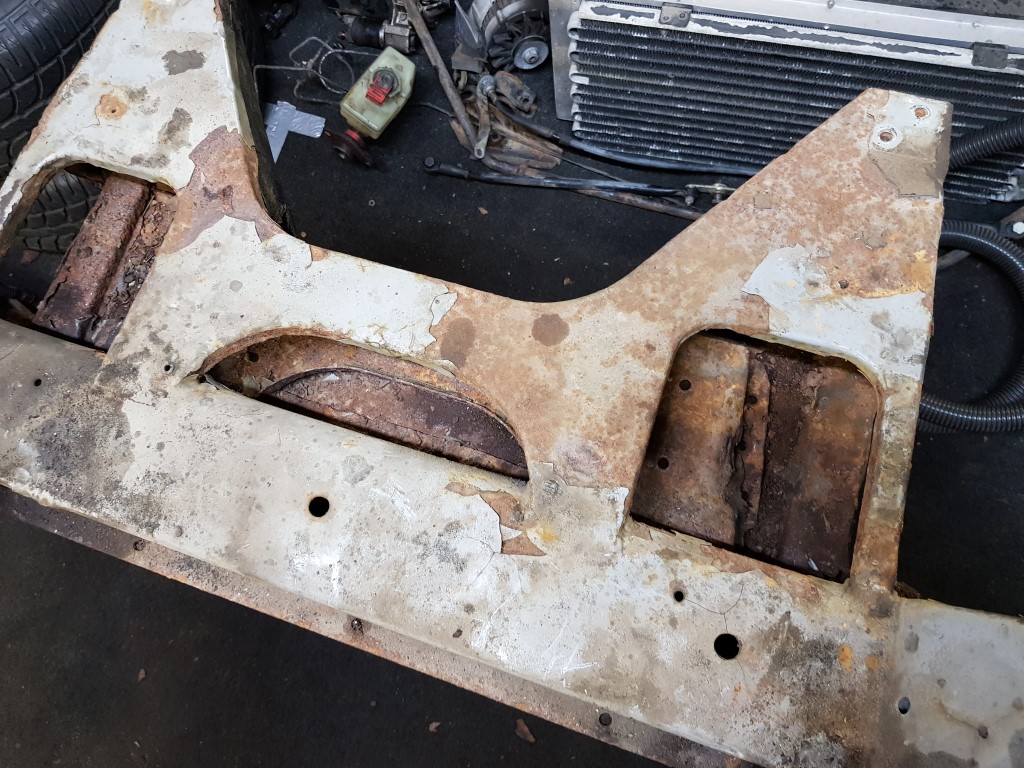

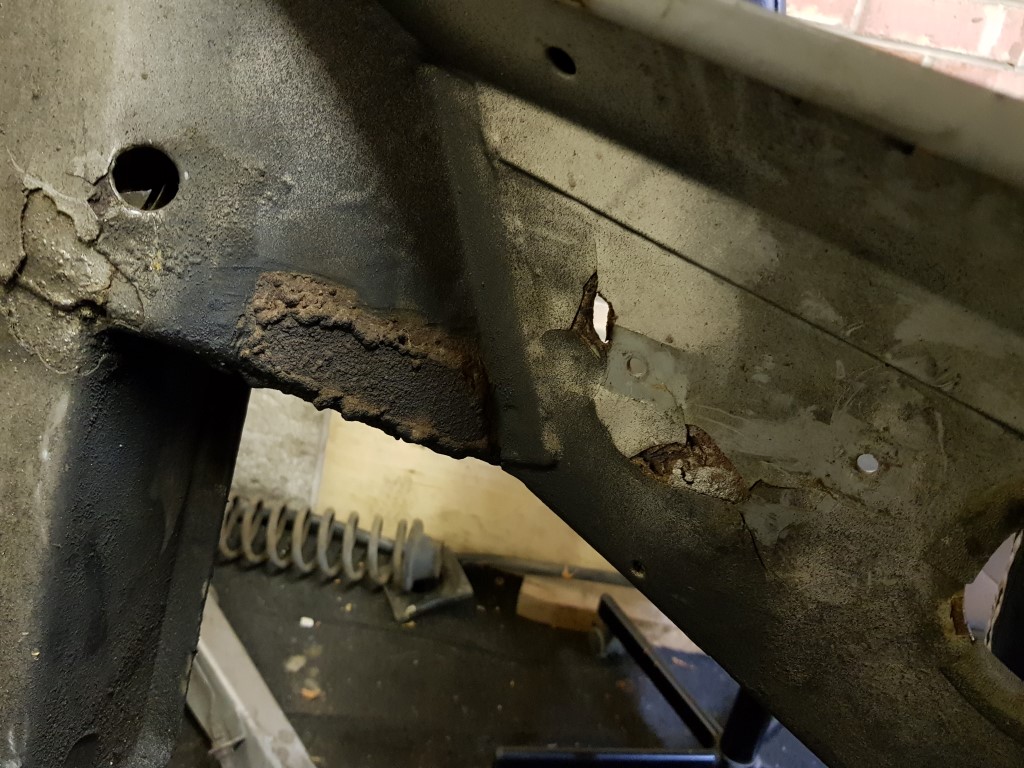

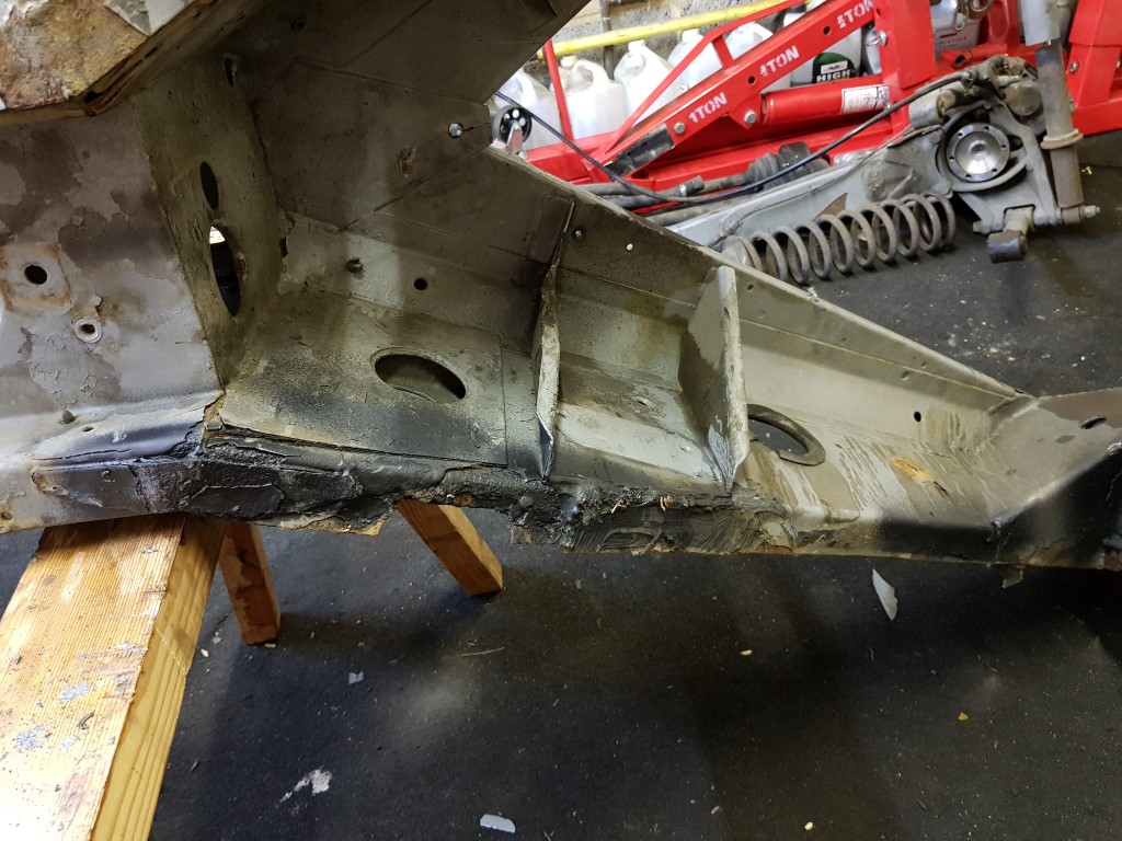

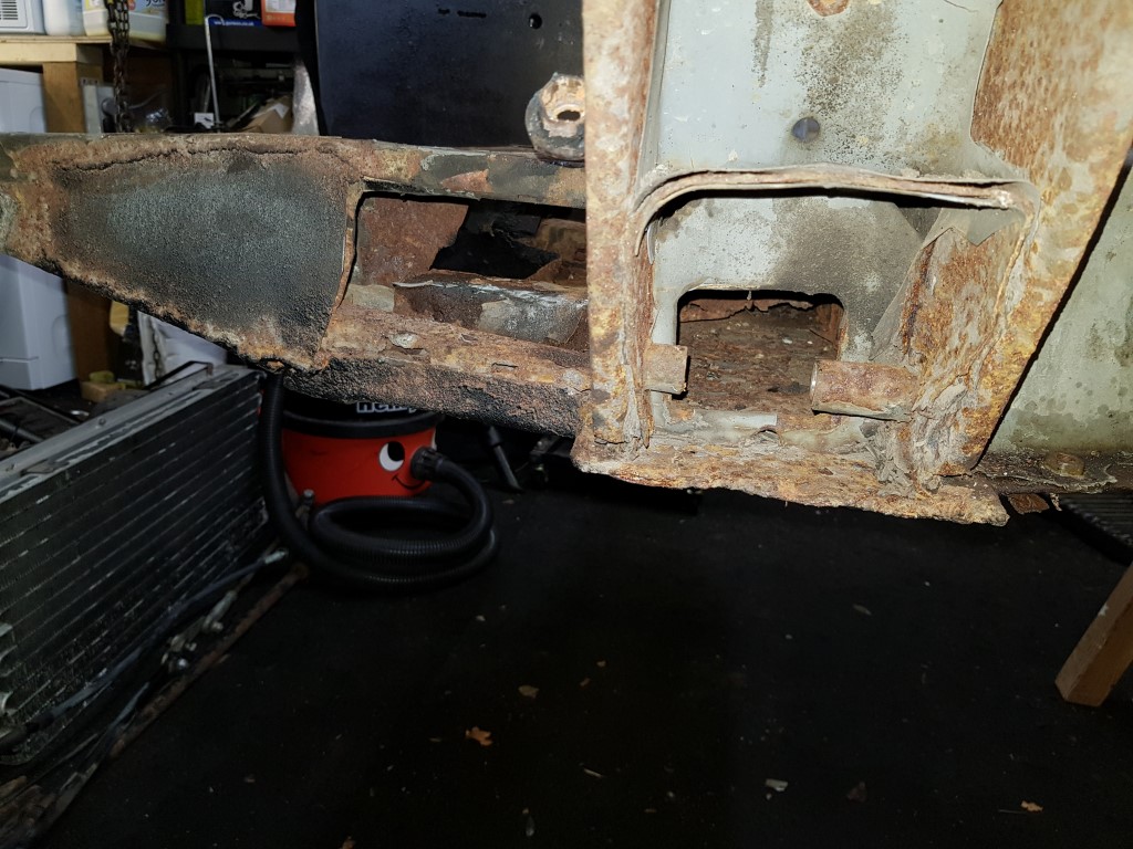

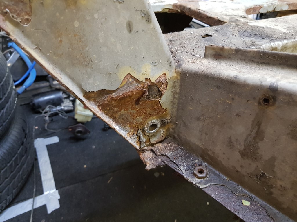

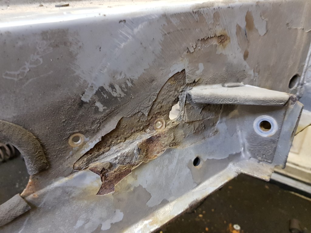

So how bad is the rust i hear you asking, well il let the pictures do the talking :shock:
20180930_225755 (Medium).jpg (234.16 KiB) Viewed 9448 times
20180930_225801 (Medium).jpg (184.45 KiB) Viewed 9448 times
20180930_225807 (Medium).jpg (304.66 KiB) Viewed 9448 times
20180930_225814 (Medium).jpg (255.68 KiB) Viewed 9448 times
20180930_225822 (Medium).jpg (207.31 KiB) Viewed 9448 times
20180930_225915 (Medium).jpg (220.54 KiB) Viewed 9448 times
20180930_225927 (Medium).jpg (244.12 KiB) Viewed 9448 times
20180930_225943 (Medium).jpg (216.98 KiB) Viewed 9448 times
20180930_225948 (Medium).jpg (212.19 KiB) Viewed 9448 times
20180930_225958 (Medium).jpg (242.65 KiB) Viewed 9448 times

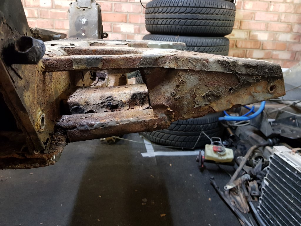

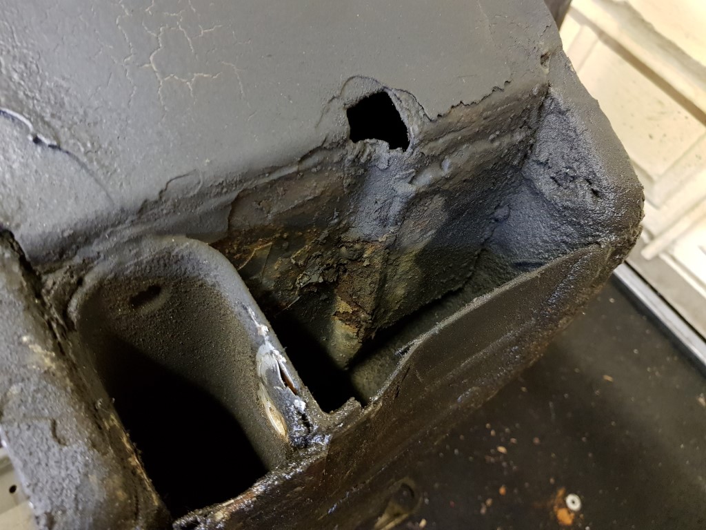

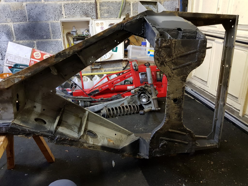

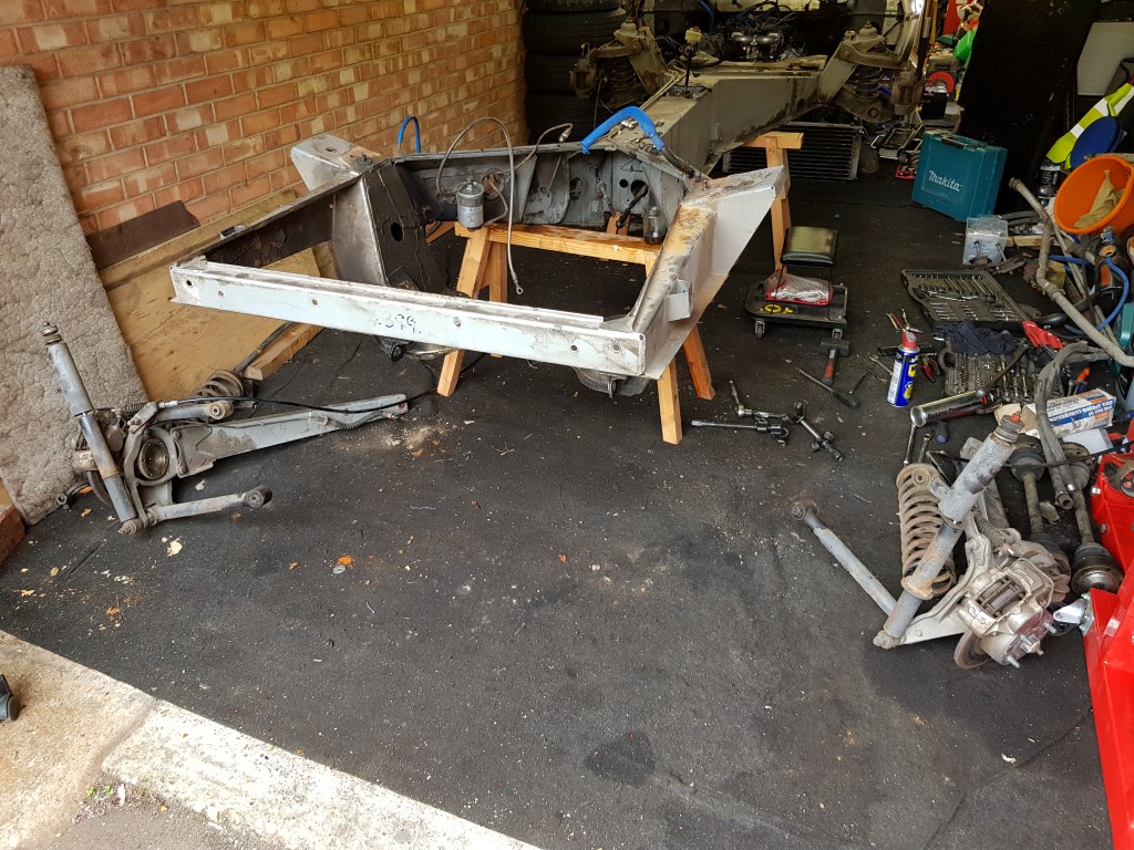

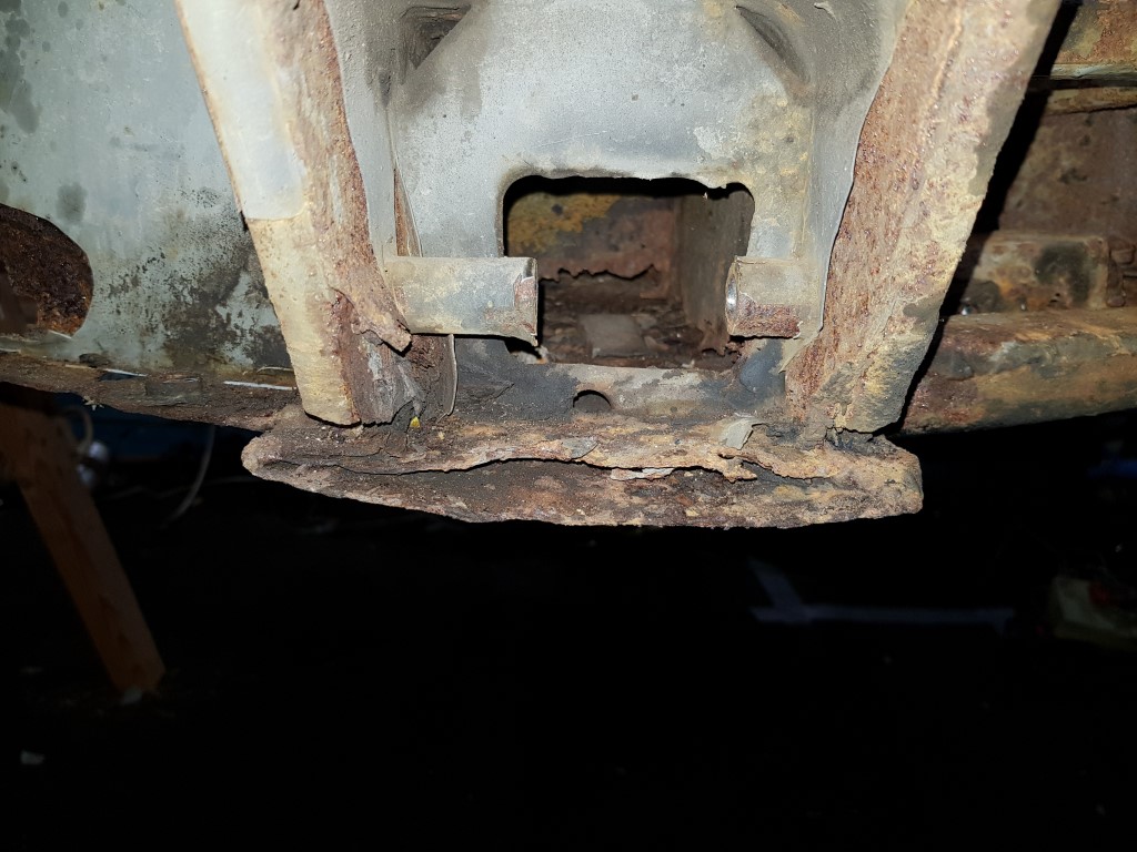

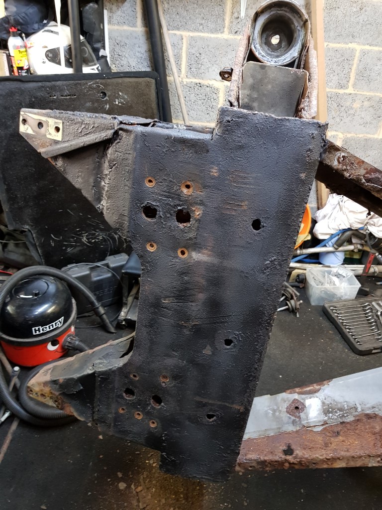

All of the pictures above were with the chassis up the right way, then i turned it over :o
20180930_230142 (Medium).jpg (314.26 KiB) Viewed 9448 times

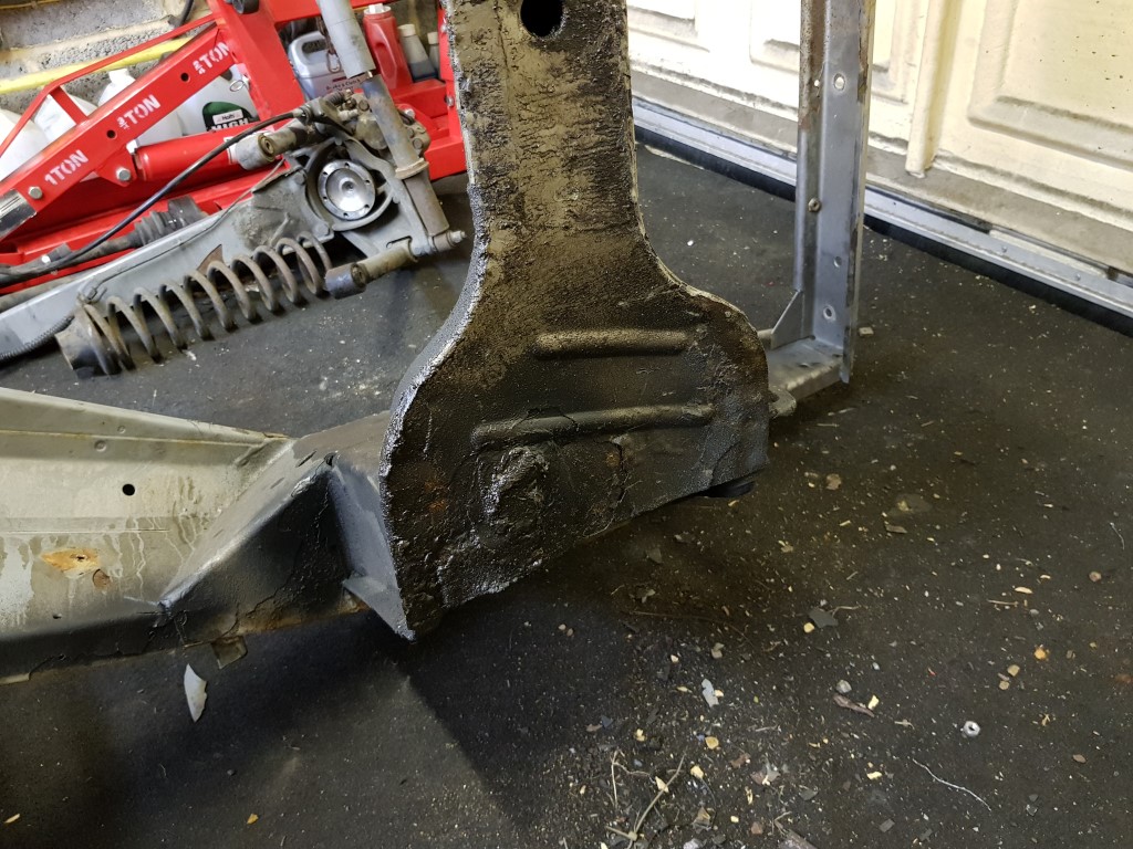

This black area at the front i think is infact one massive plate that been welded on ...
20180930_230120 (Medium).jpg (330.27 KiB) Viewed 9448 times
20180930_230204 (Medium).jpg (240.1 KiB) Viewed 9448 times
20180930_230213 (Medium).jpg (259.07 KiB) Viewed 9448 times
20180930_230216 (Medium).jpg (294.13 KiB) Viewed 9448 times
20180930_230301 (Medium).jpg (229.95 KiB) Viewed 9448 times
20180930_230522 (Medium).jpg (298.9 KiB) Viewed 9448 times
So there you have it, my delorean stripped to a bare chassis in 2 days... looks like that was the easy bit !
Lets hope the genius welding of Mr Alex Denny can save my car, 1st though is a phone call in the morning to get the chassis booked in for dipping to strip all the rubbish off and see whats left !!
