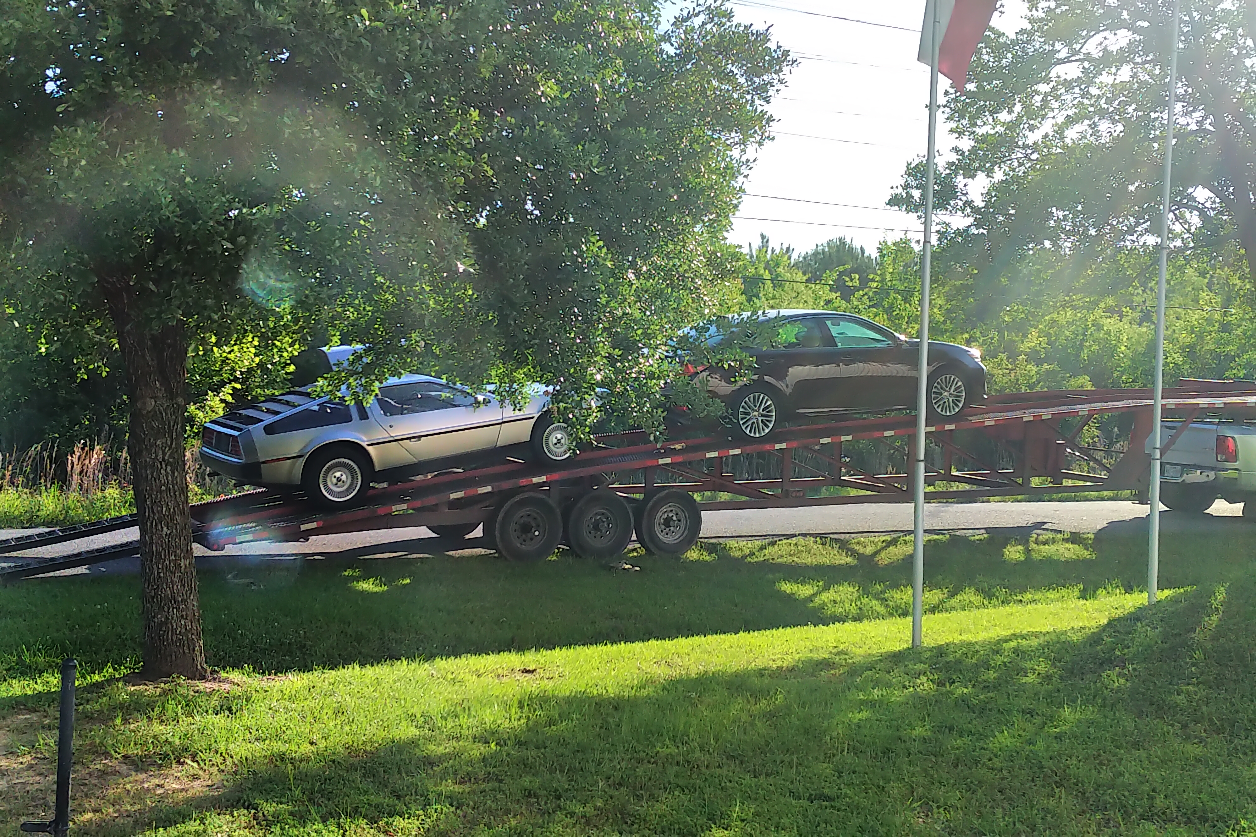

Postby Azar » Mon Apr 13, 2020 6:31 pm
Good news! The car is ready and will be shipped soon.

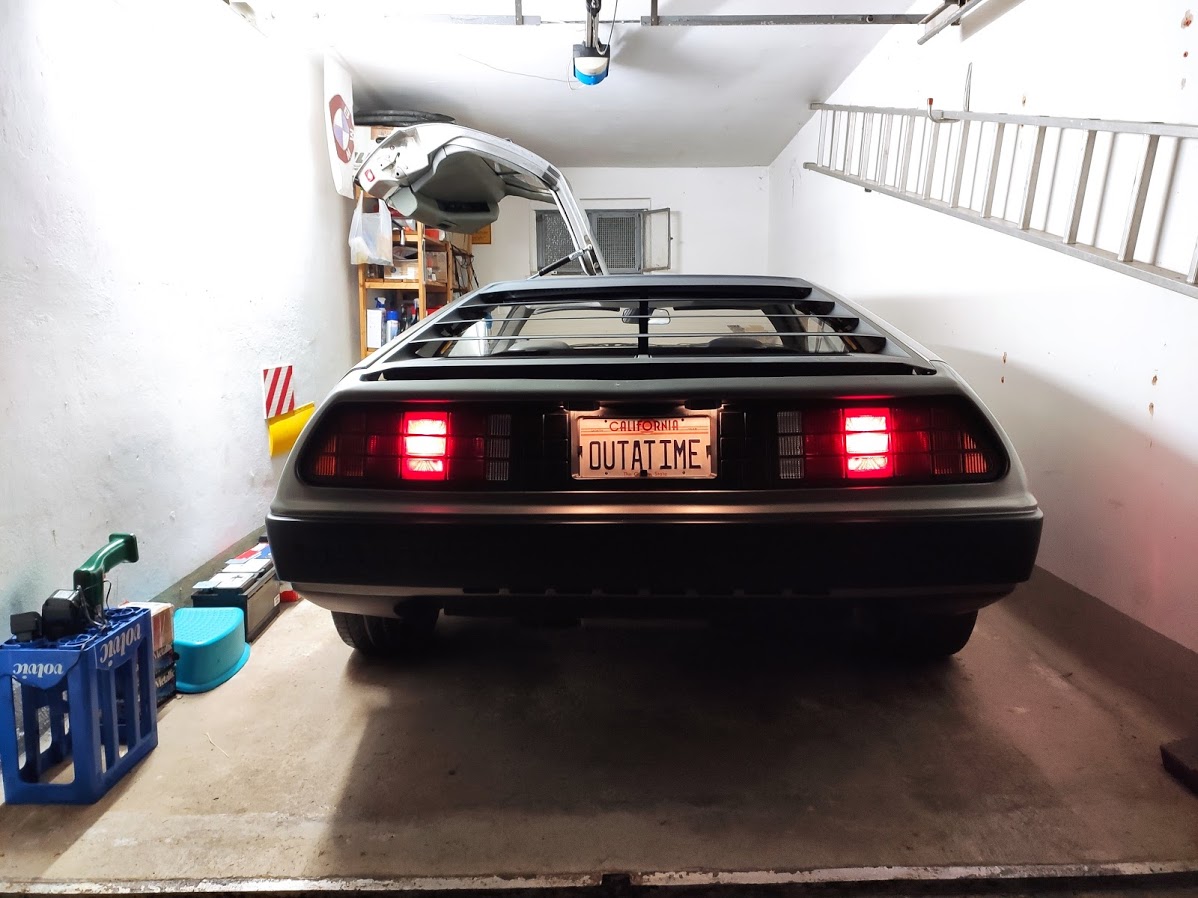

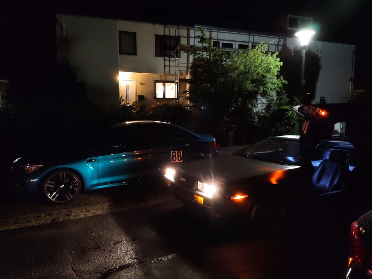

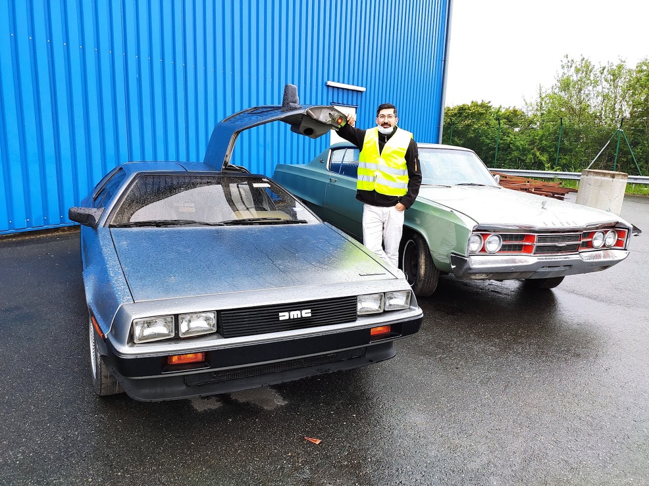

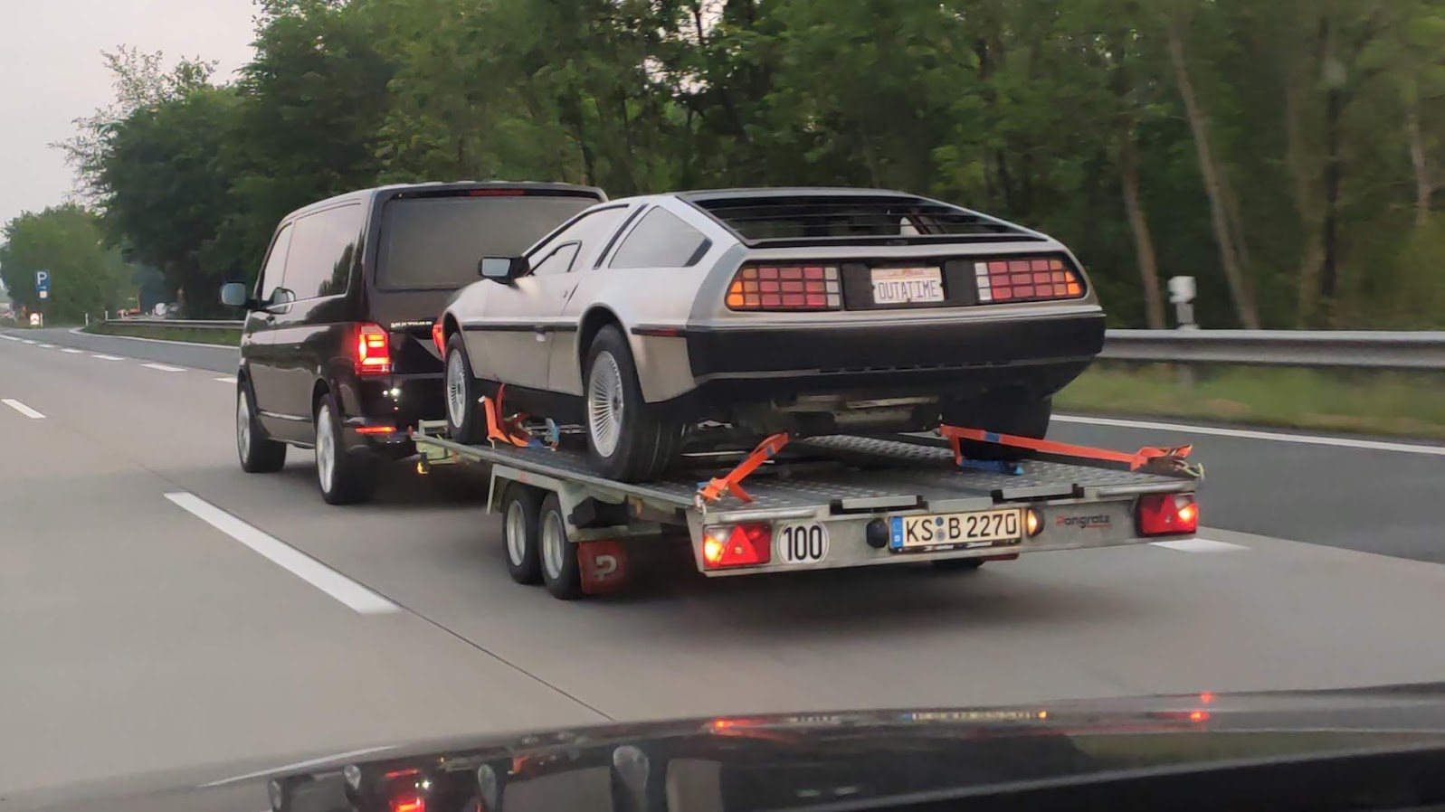

Postby Azar » Mon May 25, 2020 7:56 pm
The DeLorean is with me in Kassel, Germany!
