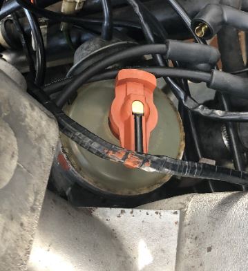

However on testing all the individual spark plugs only the plug on cylinder 2 was getting a spark. So took a deep breath and disconnected some of the fuel lines to move the fuel distributor out the way. Stripped down the distributor and the rotor arm was in this position.

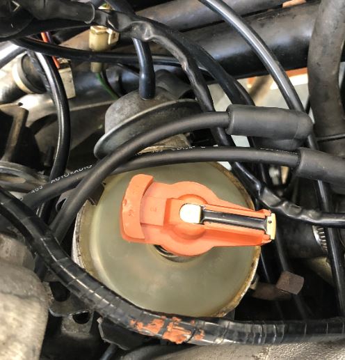

Took off the rotor arm and found that I had managed to fit it 90 degrees out. The notch wasn't lined up. What an absolute idiot I am. Correctly fitted it should have been like this
Re-assembled everything and the engine started with the first turn of the key. So even though the rotor arm is keyed so it should not be possible to fit it incorrectly it can be done. As an Engineer I made a foolish error, but at least the other moral of the story is if it doesn't start after you have worked on it logically check through as it's probably something you have done.
