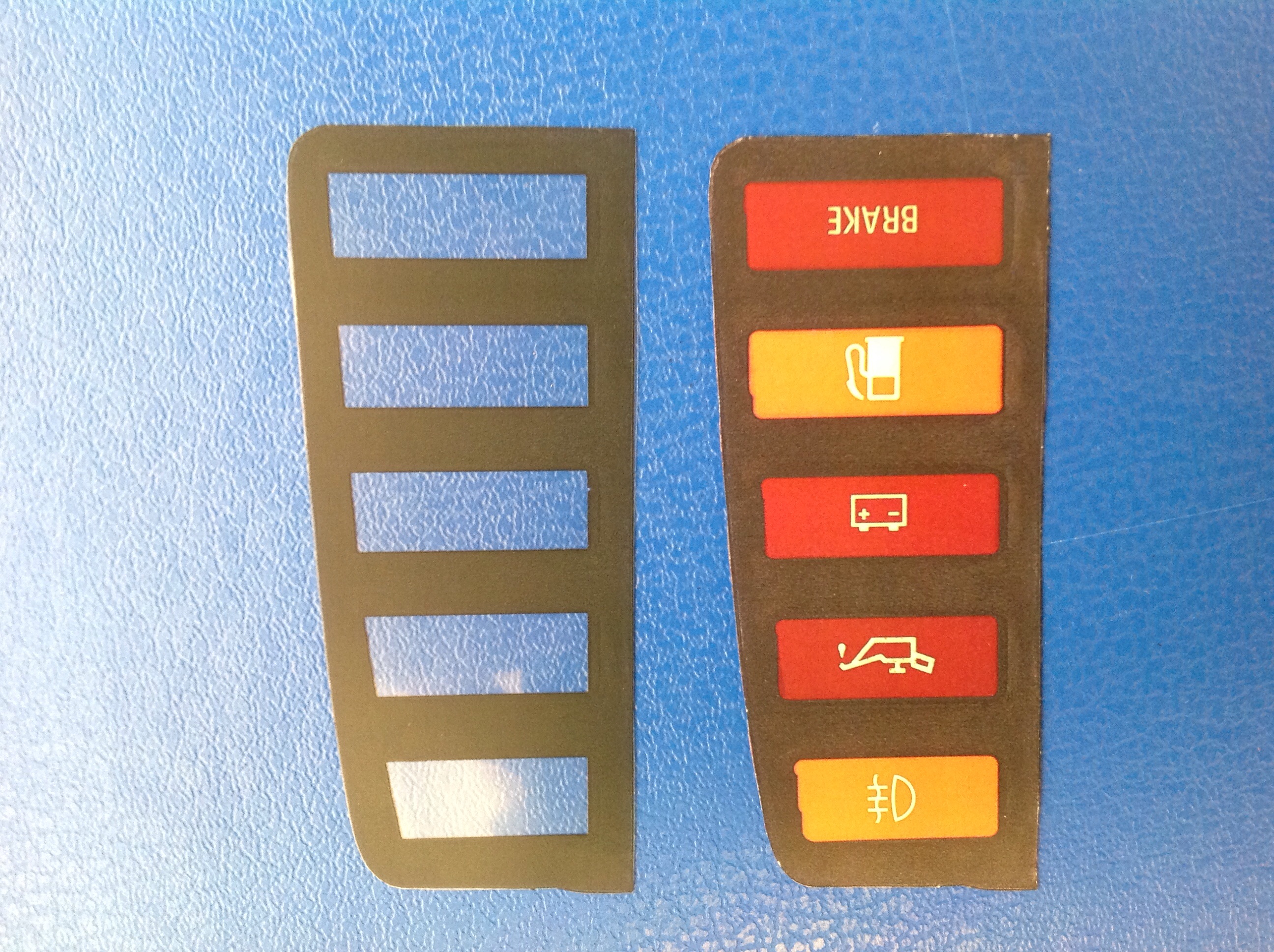

1st attempt... Need a way of printing white symbols instead of transparent.

Needs refining and the colours need to be darker to match to door symbol on the opposite side. I have already changed the red Lambda to the ISO fog symbol against an orange background trying to match the fuel warning background (you can just about see it in my poorly taken photo). I am going to try a white textured coating on acetate and see if that works better. This first attempt is actually two layers of acetate, the back sheet has the gel colours and symbols while the front sheet has the black/ grey framing. I might try layering it in Photo Shop instead of physically and use a higher grams per square metre acetate to make up the difference.

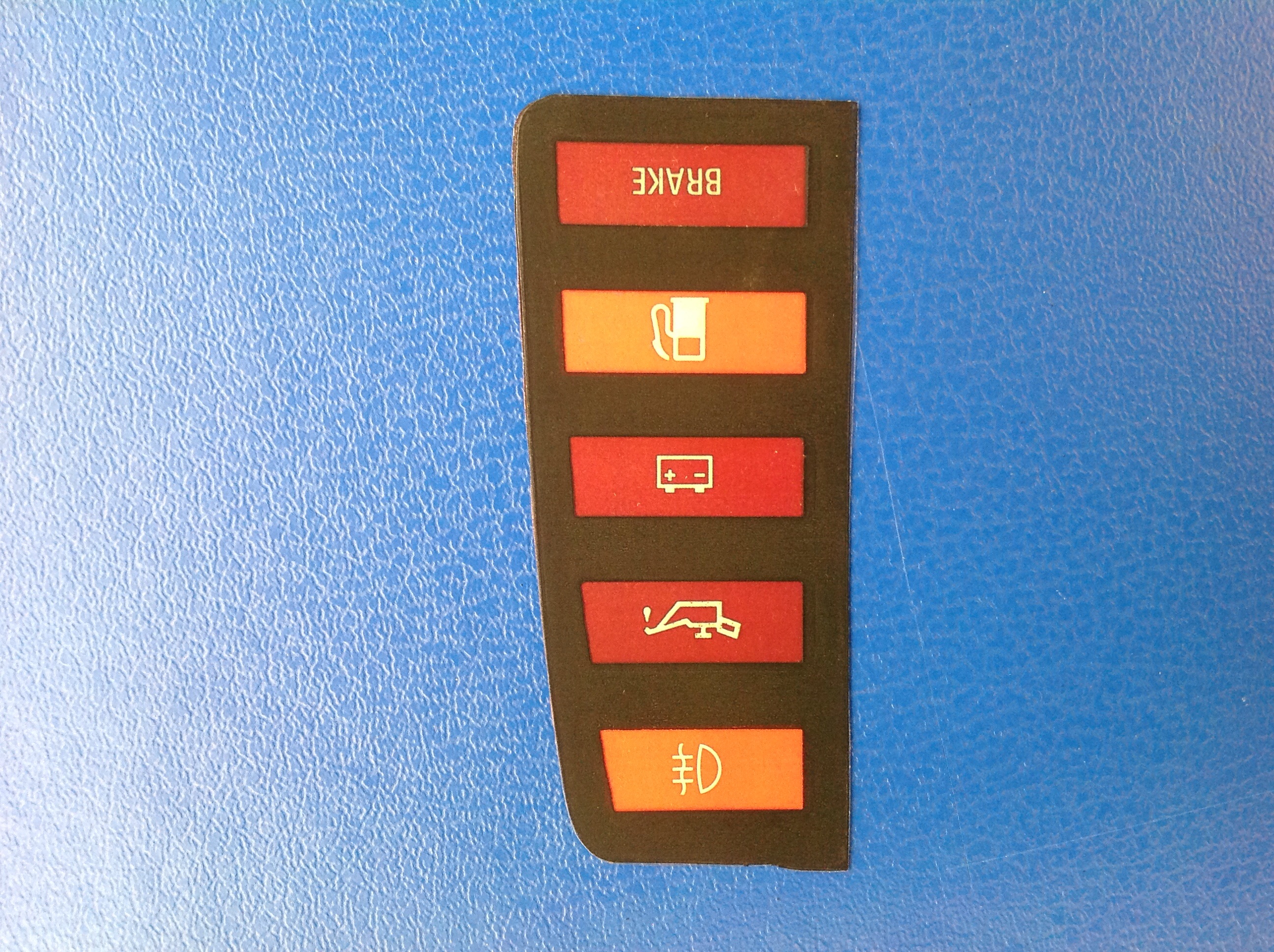

Postby Mark » Fri Apr 10, 2015 2:40 pm
Refined frame and colour change to bring it close to the original.

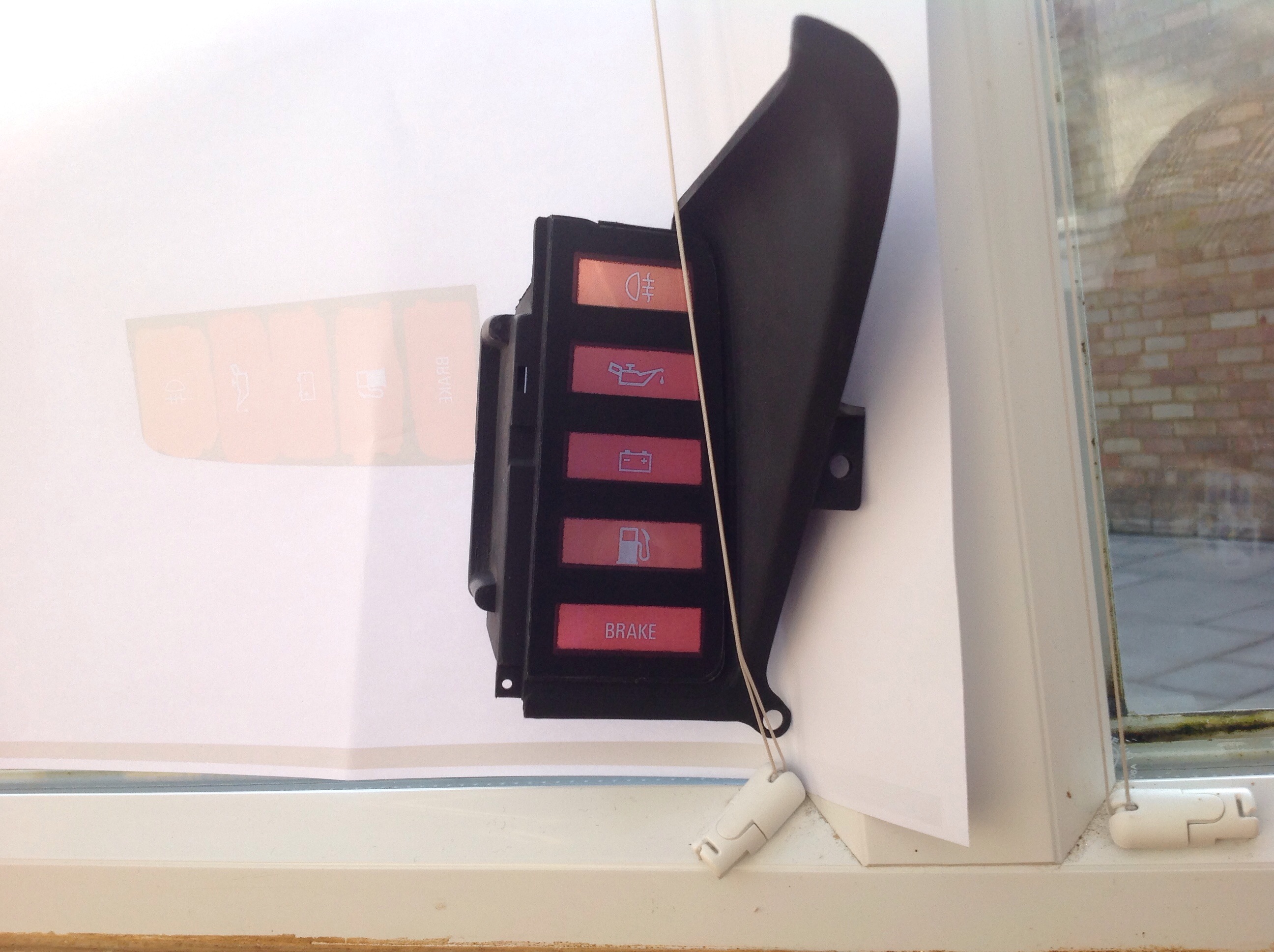

Postby Mark » Fri Apr 10, 2015 2:42 pm
Frame and gels layered together.
