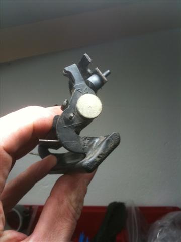

Here's a shot on the repair. This is before glueing, so the handle cover is still missing. I drilled through the parts and inserted 2 halves of a broken 1.5mm drill on either side. The metal part goes into the handle little over 1 full cm. With some super-strong glue it should be good enough for a while.

Just to let you know: the repair attempt was entirely futile. The stresses on the handle are way beyond the power of the superglue that I used.

I've made a decision and i'll order a single metal one with Ed U. I seriously don't want to risk getting locked out because the other breaks on me as well.
The handle on the passenger side broke off because of too much stress. I realigned the latches on that door, but I didn't tighten one of the latch clips. That one came loose and when I tried to open the door I pulled too hard on the handle. Strangely, it didn't break at that moment. Only after I reattached the latch and opened the door at a later moment it came off. I suppose it was already seriously weakened by then.
I'll fix the new one on the driver's side and move the old plastic one to the passenger side.

Today I drove up to Ed U to get 2 new door handles and other stuff. One is already in!
I'm keeping the other one for when I remove the trim on that door.
