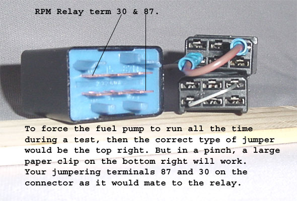

Postby Admin-bloke » Wed May 22, 2013 6:42 pm
You could always do the link as a temporary measure:
http://www.specialtauto.com/delorean-pa ... jumper.jpg
You can replace the 555 timer chip on your original one or get the one from euro car parts or buy one direct from Ed/ Houston.
This as assuming that it is the fuel pump relay that is at fault.
The earth side of the pump goes via the inertia switch so make sure this is in place and the plunger is in the down position.
