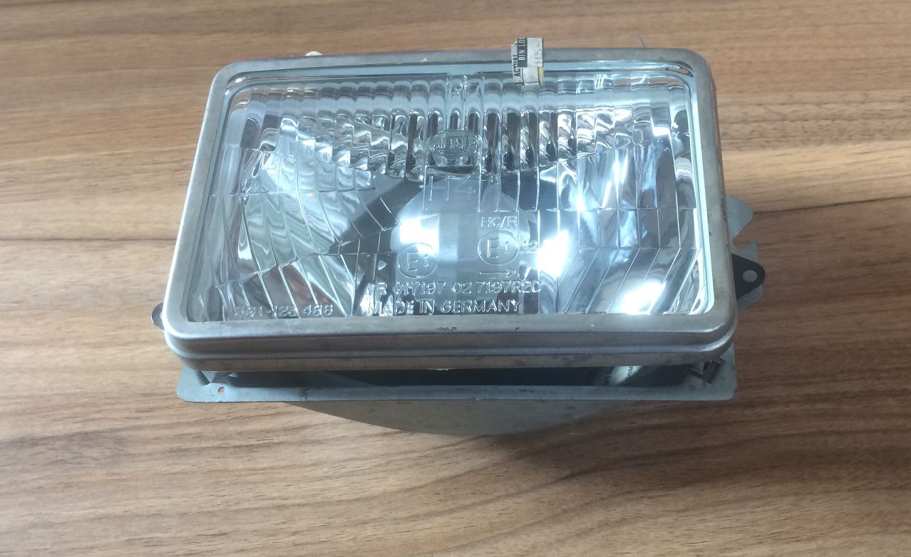

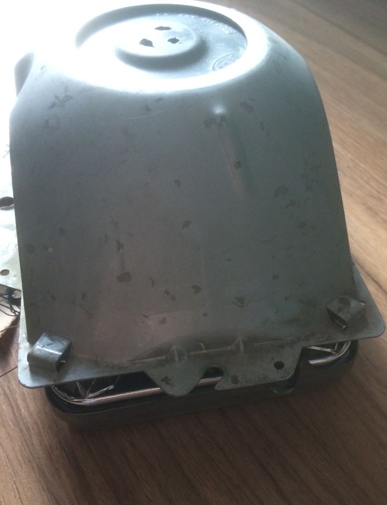

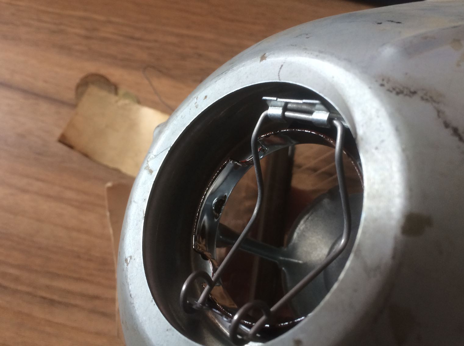

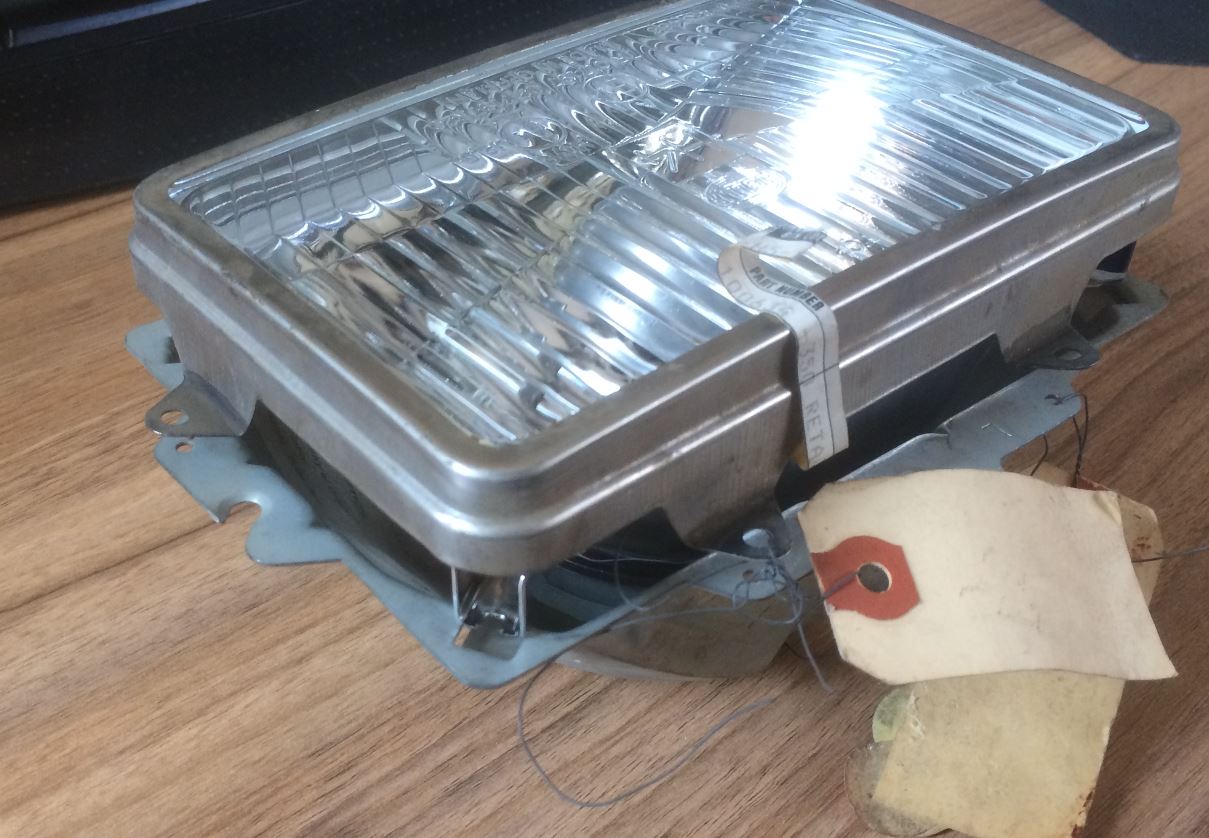

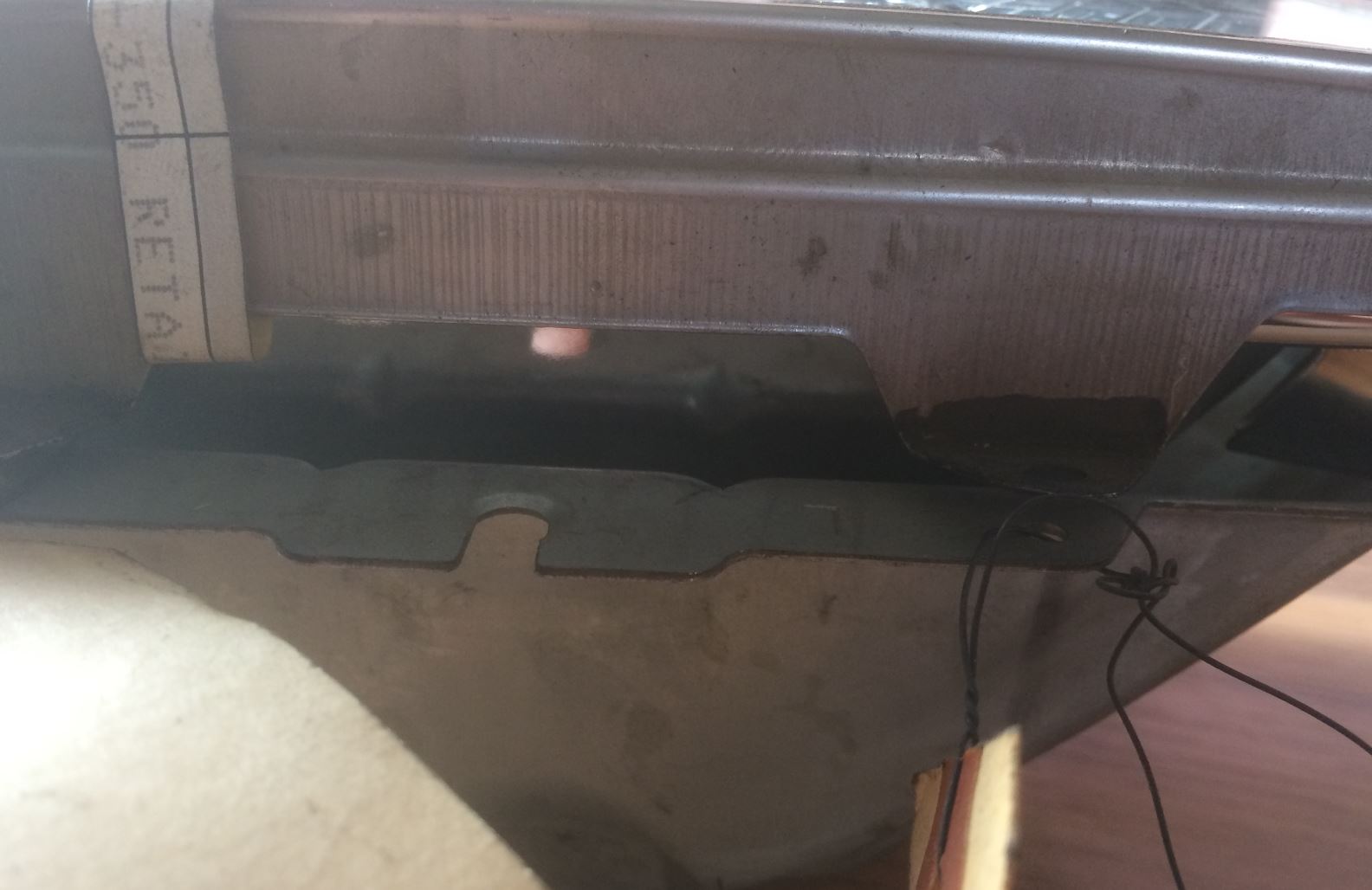

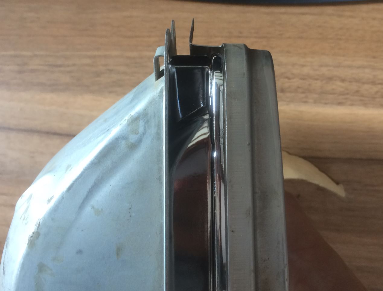

Pictures for reference. This is taken with the rubber seal that goes over the back of the light removed. Also in this case I have removed the side light holder. You'd obviously need to drill a hole for that anyway.

Postby arranj » Wed Sep 23, 2015 4:50 pm
This is with the seal on - hardly any difference that I can see. Yes the 4 bezel screws are what would be holding it in place, but I can't make it "swim" very easily - mainly because the rubber seal has decent friction all round with the back of the bucket. Agreed though it isn't perfect - it's protruding by about 6mm more than it should I think.
Not only would you cut the back of the bucket off to get it in, you'd also need to chop off a lug from the headlight or modify the bucket there too because it doesn't quite go in on one of them.
I have Hellas though, and no bucket modification - you can't tell it's sticking out.
The old Valeos had a much shallower profile, so didn't have this problem. Only problem is now they don't make them any more.
By the way - these Hellas have spoons covering the middle, yes.
