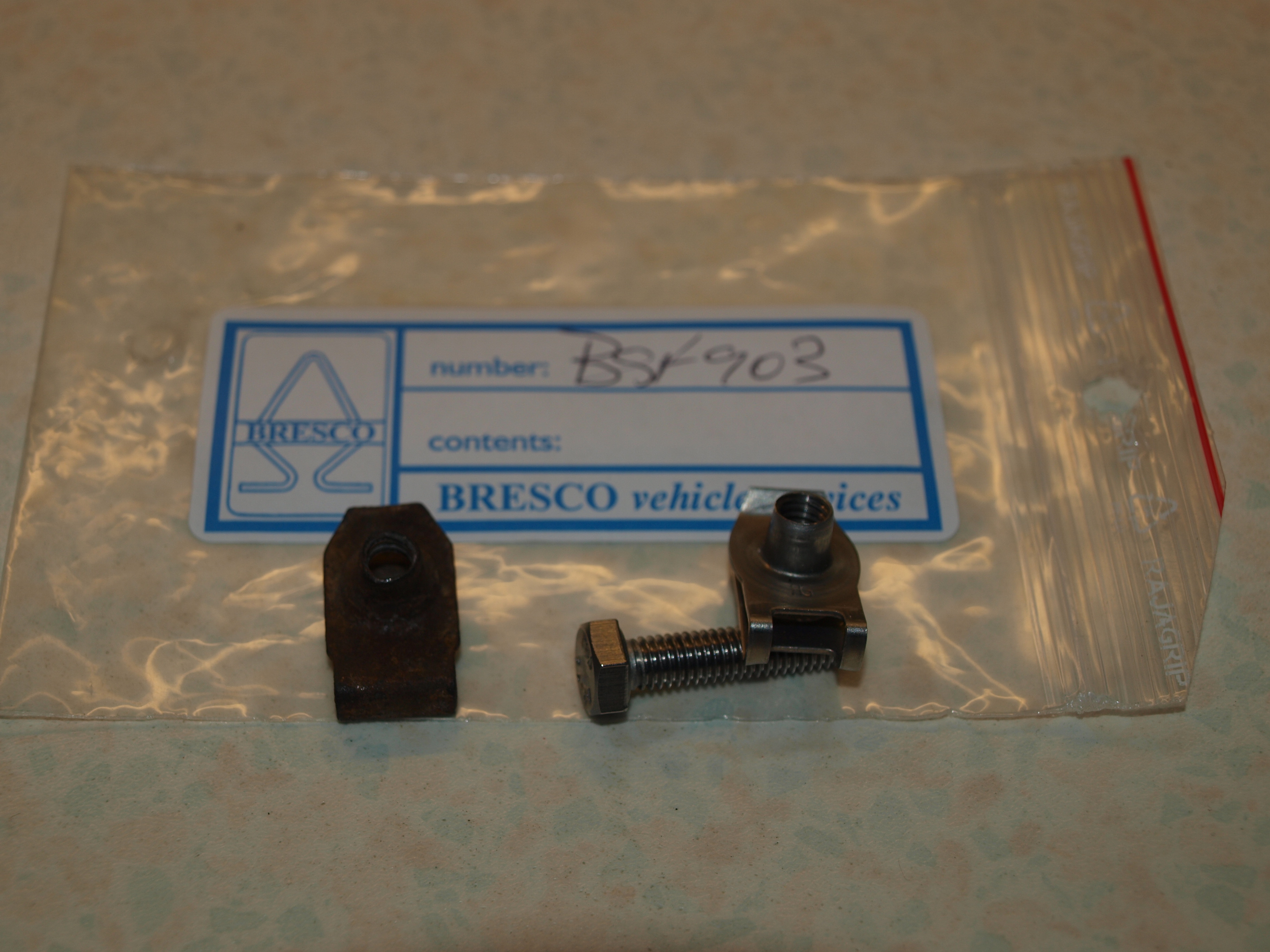

Postby Spudmurphy » Tue Apr 25, 2017 8:43 pm
..... the "clip" I intend using to re attach the front and dispense with the rusty old zinc plated ones.

Postby arranj » Tue Apr 25, 2017 10:03 pm
Yep they have made it as far as "goods inwards" here! Now have them in both "all stainless" and galvanised steel.
As for the front stainless spire nuts/clips - aren't they interchangeable with these? (all stainless) http://www.deloreanclub.uk/spire-retain ... nless.html

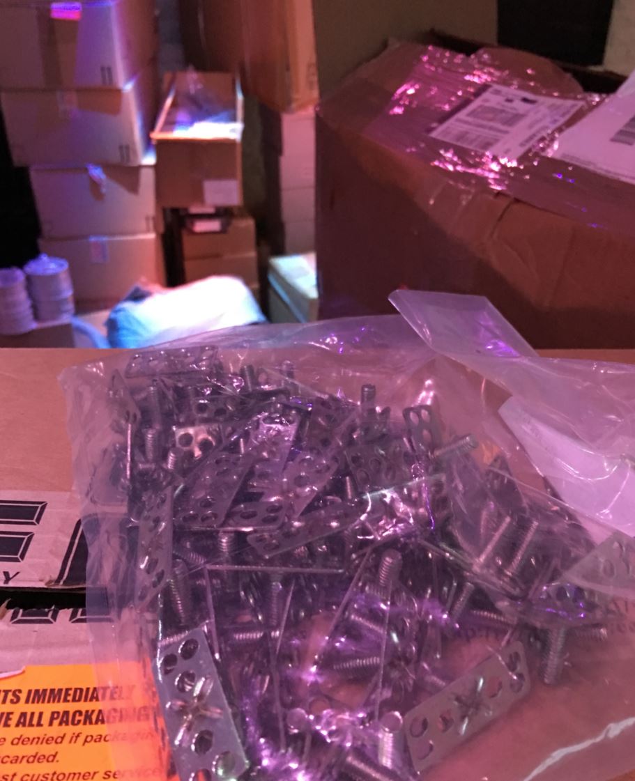

Postby jamesrguk » Sat Apr 29, 2017 2:01 pm
I'll be adding these to my purchase list soon, but any suggestions on the best adhesive to hold them on?
James
Re: Bonding Fasteners
Postby InoX » Sat Apr 29, 2017 4:39 pm
I intend to use tiger seal on the front lower bumper. Making sure I've dug out all the rust and dirt and crud. Shouldn't move anywhere once they're on.

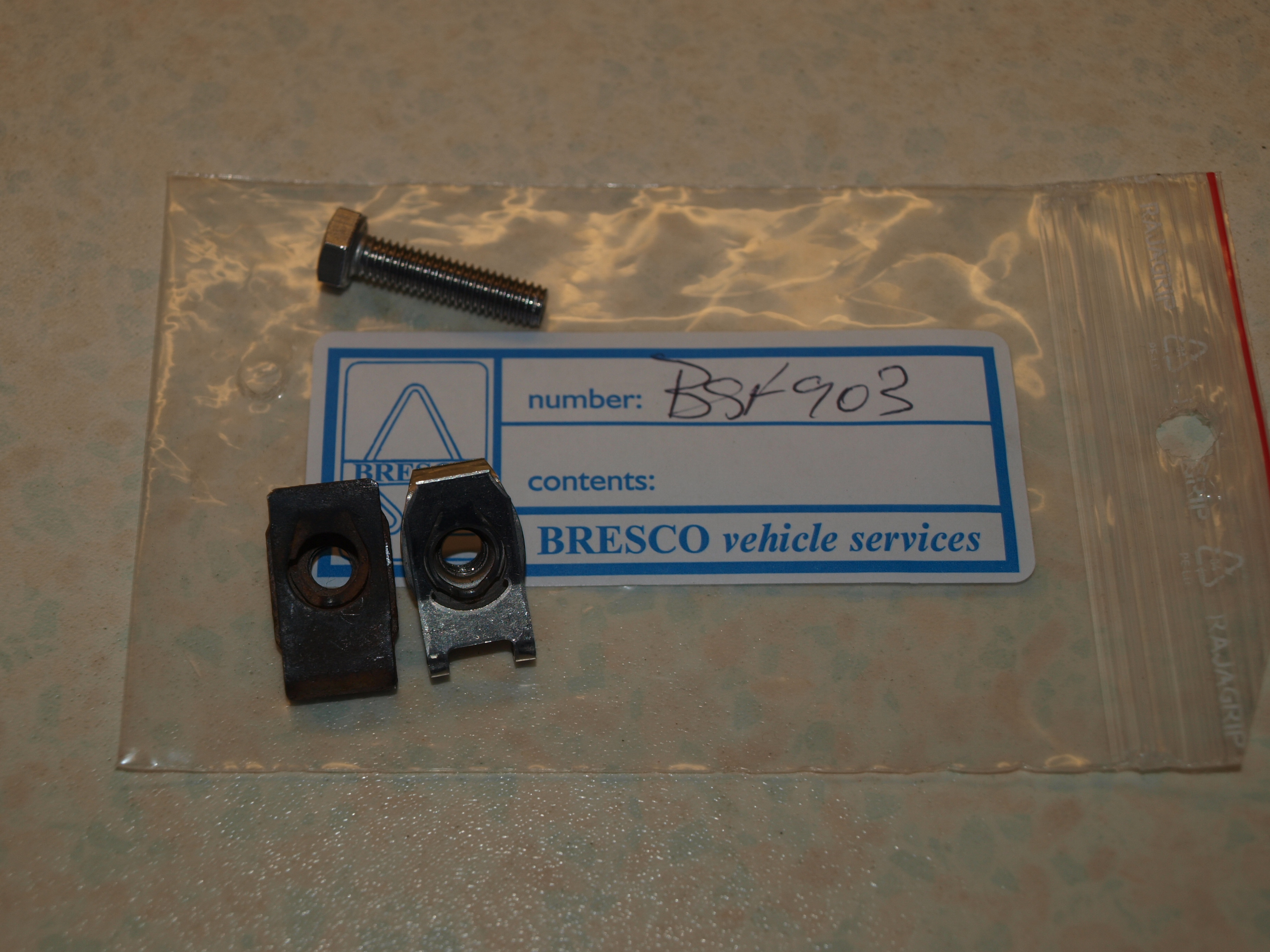

Postby Spudmurphy » Sun Apr 30, 2017 10:00 am
.... and further to my earlier comment, here are the ss fastenings for the front of the car, that I managed to track down - it wasn't easy tracking these down ...

Postby InoX » Mon May 01, 2017 5:22 pm
just noticed are those stainless bolts and stainless fasteners? take it you're going to use copper grease?

Postby Spudmurphy » Mon May 08, 2017 11:44 am
InoX wrote:cheers spud. saw that post on another thread :lol: ;)
Also if anyone is interested in taking their front end apart, when you remove the grill, the caged nuts along the top are these:
http://www.ebay.co.uk/itm/Cage-Nuts-Cage-Rack-Nut-201-304-Stainless-Carbon-Steel-M4-M5-M6-M8-/322378621227?var=511332226971&hash=item4b0f43612b:m:mRvOXdE_sB_buAugOCuPFSA
albeit, from Chinesia. £1.53, if you're willing to wait a month.
Having been under the car recently, I can now see where you're coming from with these fittings, Arran just threw me when he mentioned caged nuts .
However the stainless clips do the job just fine on the (very) top mountings which are unsuitable for caged nuts.
Out of interest, what will you use to bond those fasteners?
(hope it's as good as the stuff used by a previous owner on my front "bumper" - quite clearly it had suffered from a small split and been repaired - hasn't budged).
Anyways, wot with being in the process of stripping down and refurbing my D, I'm always on the lookout for good quality fasteners and "best practices".
