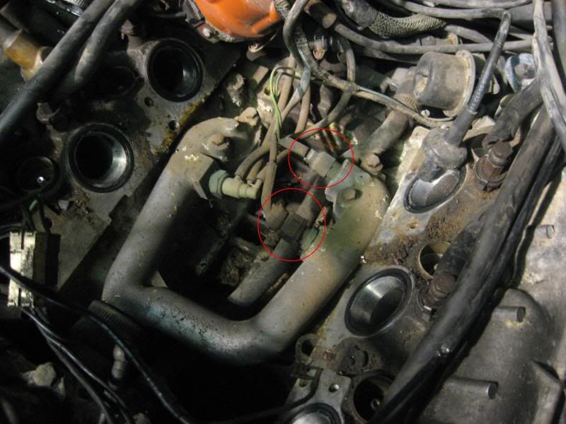

I need the two switches that are circled below
I probably need a y-pipe too if anybody has a spare?

Lambda switch - 102478
Bottom
(Cant find this one on DMCH, know what it is?)

The bottom one is the idle ecu thermistor.
There are 2 volvo types. Get the one which is 12k ohms at 20 degrees !
I can't remember the Bosch part number....

Problem with that one is that it doesnt actually do what it is supposed to do :)

bozzzydmc wrote:Problem with that one is that it doesnt actually do what it is supposed to do :)
Is it needed then?
Is it needed then?
Yes it is.
What Bozzzy is trying to say is that for the ecu to work correctly it needs another 10k ohm resistor wired in series with it.

.. And I still have a few little jumper wires that we made up that don't involve cutting the existing wiring if anyone would like one x

bozzzydmc wrote:.. And I still have a few little jumper wires that we made up that don't involve cutting the existing wiring if anyone would like one x
Bozzzys top plug and play inline resistor :thumbsup:
