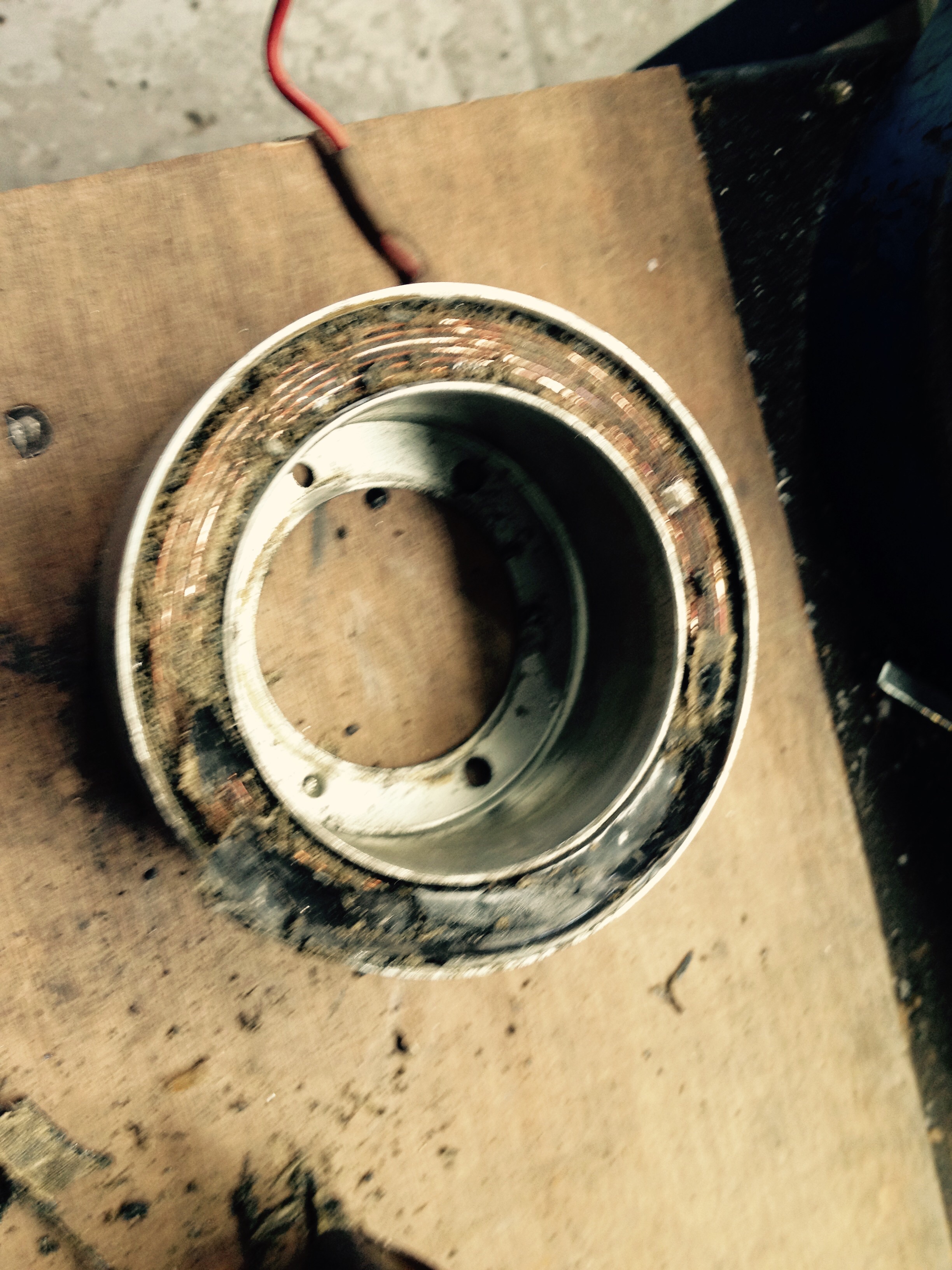

Postby DJK73 » Tue Jul 07, 2015 6:52 am
Hi
It's defo the coil, it's burnt out I checked the resistance
I currently have the coil off Barry and mikes project car on mine and it works fine
I just need to replace there's

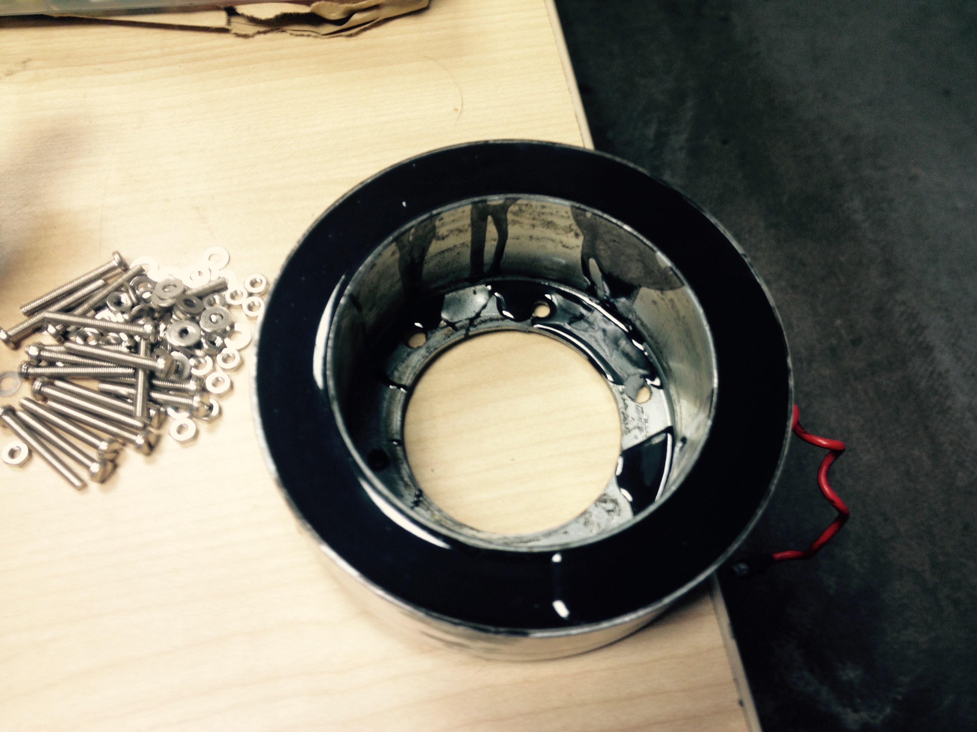

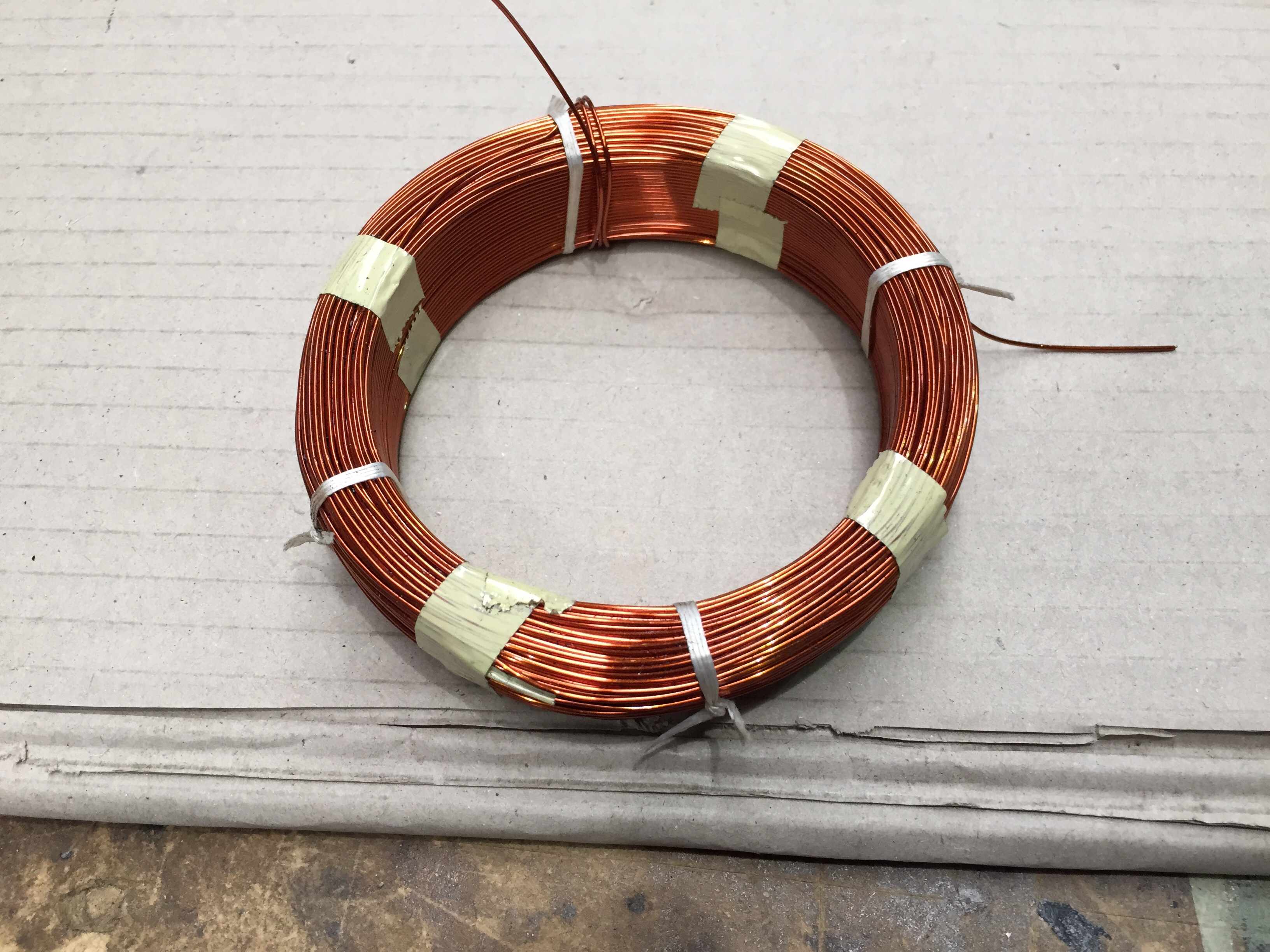

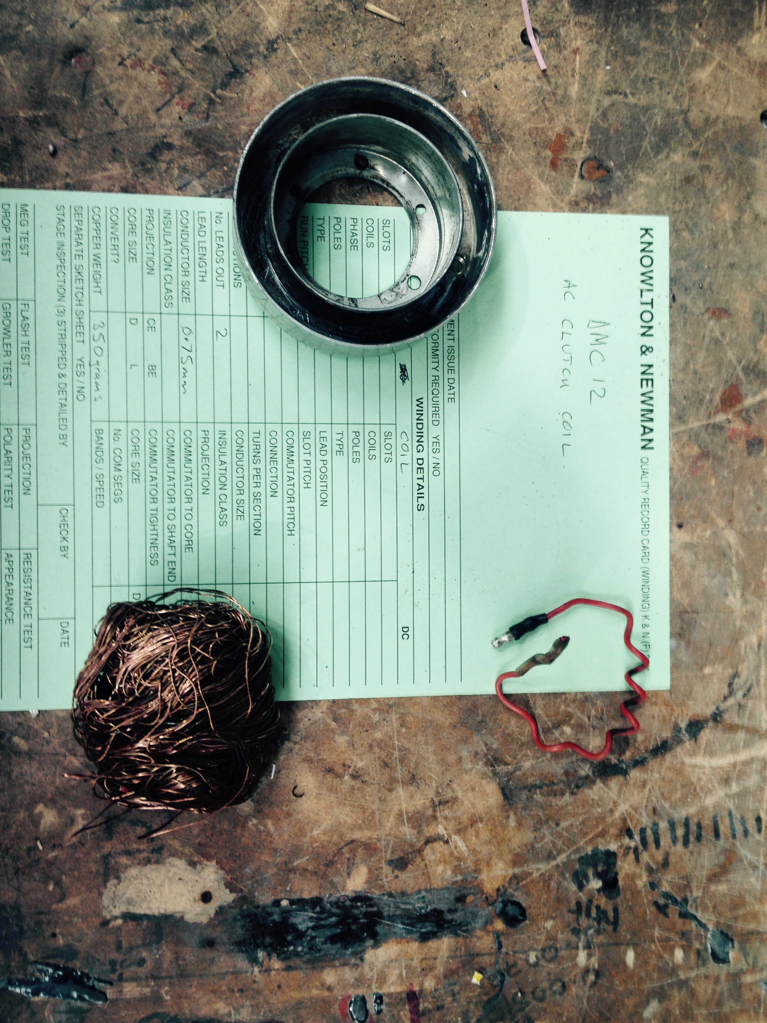

Postby DJK73 » Wed Sep 09, 2015 2:21 pm
Hi
Thought I'd share this
I ended up stripping and rewinding my old clutch coil to replace the one I "borrowed " from dbros1+2
Finished apart from cleaning off epoxy encapsulant
New coil
Old coil removed from casing
Burnt out coil before removal

Postby Admin-bloke » Wed Sep 09, 2015 5:58 pm
I like it. Have you got a coil winder or did you do it by hand?

Re: AC compressor
Postby Admin-bloke » Wed Sep 09, 2015 8:08 pm
btk65 wrote:Dan, I think the big guy is taking the micky .......its bit like asking him if he's got a test meter :lol:
D'oh. I completely forgot! I thought you had coil winders for the big big motors..
I'm thinking of a production run of central locking solenoids ;)
