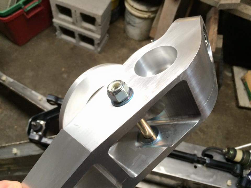

Are they aluminium? If so use a corrosion protecting compound like duralac or acf 50 between any dissimilar metals like the steel washers and the Ali arm otherwise the ali we be eaten away in a year

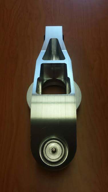

Postby andyd » Thu Dec 31, 2015 5:14 pm
Hi James,
A pair is $1250 + shipping + tax, with the bush and dcuk ball joints pressed in.
Bare arms are $489 each.
