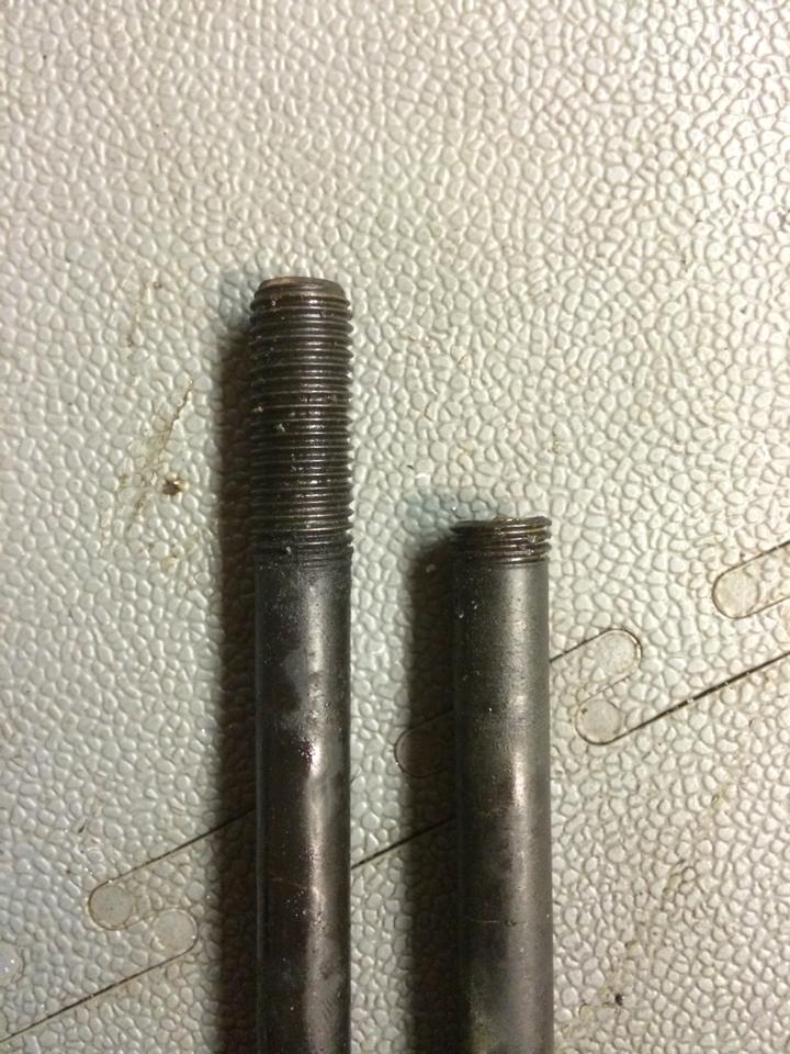

I have just snapped off a head bolt on mine, gutted. :(

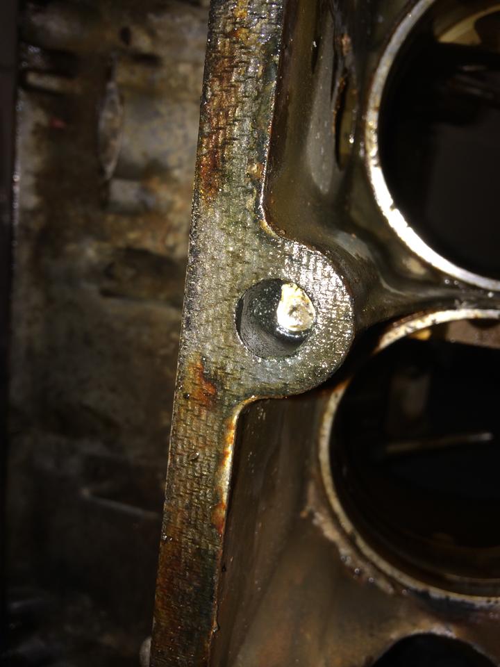

Head bolt snapped and left end in the block. On my original delorean block. My volvo block is rotten but all the bolts came out fine, typical!
Alistair recons he knows a place that can extract it, and i've found another machine shop up north that can spark erode it so all is not lost just yet.

Yeah I'd have fancied your chances of getting that out. What happens with the thread after though? Do you need a special new bolt and tap out a special new thread in the block?

Cheers for the link Nick. Do you know how spark erosion works? What stops it eating the aluminium as well as the steel bolt?

I looked at spark eroding for a completely unrelated project a few years back.
Effectively spark erosion is just a very high temperature electrical pulse which is very acurately shot into the material you want to remove, at the same time coolant is added. the rapid heating (several thousand degrees c) and cooling effect causes the offending article to shatter and turn to dust, but it is very precise so the huge heat does not effect surrounding material.
That said you would still need to retap the hole and unless I'm mistaken spark eroding / electrode milling, is pretty expensive.

I would get it soaking in plus gas straight away as this will help who ever extracts it
Then I would go down the route of extraction rather than spark eroding as that is normally a last resort or for removing broken taps or drill bits etc and it's expensive
A decent machine shop should be able to set that up in a milling machine and drill out the centre of the bolt, this will relieve the pressure on the thread. Then remove it with an "easy out" and some gentle heat. Should save the thread.
Hope that helps
