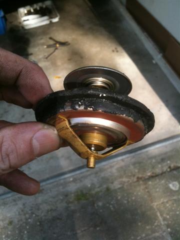

I've removed the thermostat housing and thermostat. I noticed that there must have been a lot of air inside because the top inside of the housing felt dry, and my garage floor wasn't soaked in coolant.
I'm not sure anymore, but i have the feeling is was installed upside down (??) Now if it were upside down, that would certainly explain a lot.

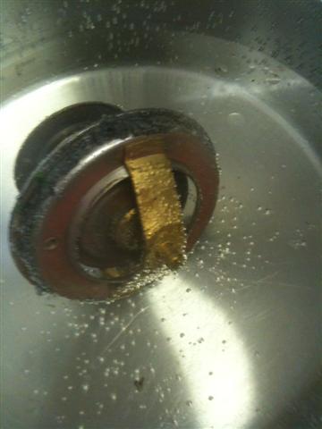

I checked the thermostats working by boiling it. It starts opening around 79C as by specification on the hardware, so that is working fine.
