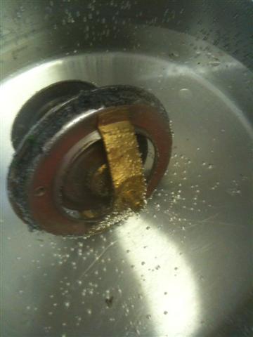

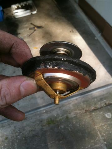

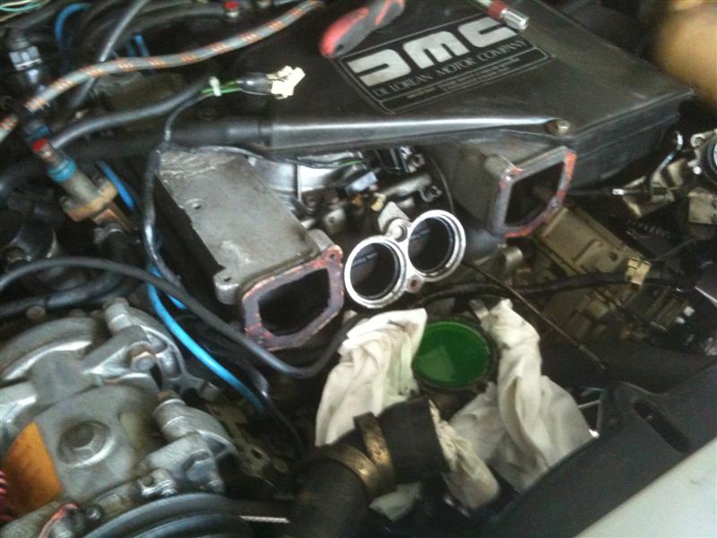

I've removed the thermostat housing and thermostat. I noticed that there must have been a lot of air inside because the top inside of the housing felt dry, and my garage floor wasn't soaked in coolant.
I'm not sure anymore, but i have the feeling is was installed upside down (??) Now if it were upside down, that would certainly explain a lot.
I checked the thermostats working by boiling it. It starts opening around 79C as by specification on the hardware, so that is working fine.
Anyways I had to remove the ram horns as well, but there a separate thread for that.

That black stuff on the thermostat looks like silicone sealant to me and not a 'proper' circular seal so telling me that thermostat has been out before ...
Which way in was the thermostat? ...should have been the circular plate on the end of the spring at the bottom ...
If its saying a different opening temperature to the stock 87 degrees C then that not an origional thermostat in my book ... that aside i dont think the differnce in temperatures will make a great deal of difference ... personally i would change it though ...

bozzzydmc wrote:Part 4 buddy
But then im sure you know that already
As in the diagram Rob, the triangular nipply part goes to the top !
Was it this way around when you removed it?
It should also have a black sealing ring going around the outer lip of the thermostat.

Yes it had the ring on it which still is ok fortunately, but PO added some additional sealant so it was def taken apart.
Bad thing is- it doesn't fit upside down, i checked.
Even worse: I tried to drill out the stuck bleeding plug but theres no way i'm getting the remaining copper out without damaging the thread any further. The stuff is welded together. I am so sick of this and now I have to order a new #3 AND a #19.
