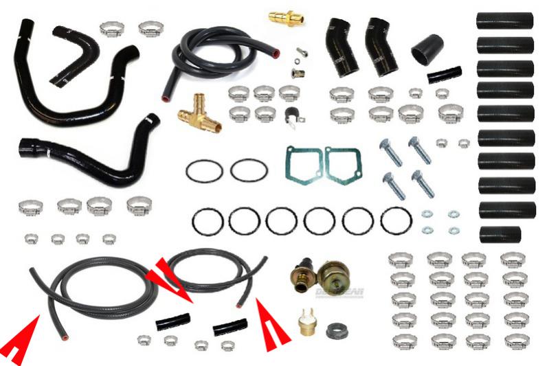

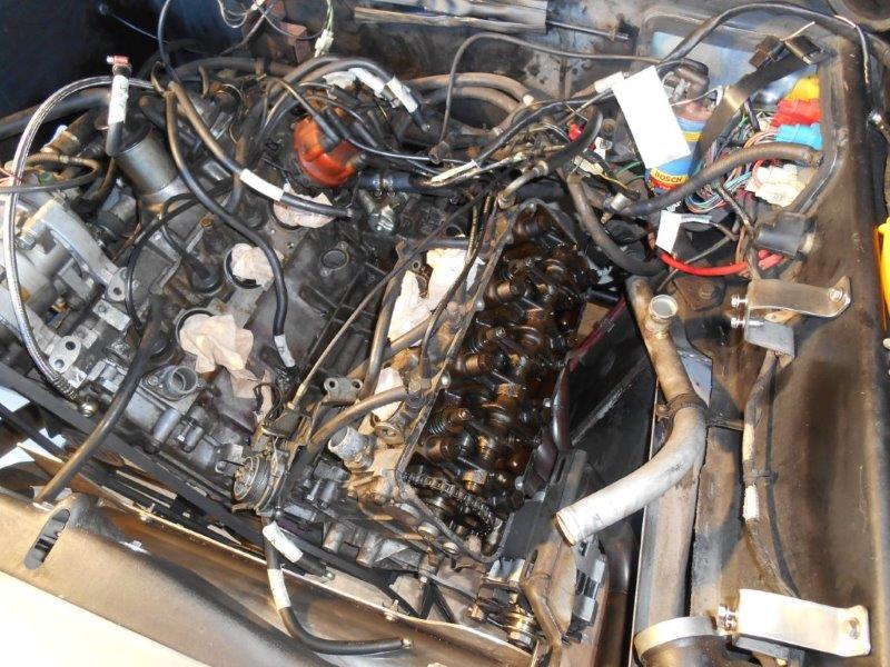

I don't know if all members here are going to dmctalk very often, but I'm working on the car right now and was wondering about a few thing on Josh kit from delorean performance.
Here is the picture of the kit I am talking about.
What about the pipes with the red arrow? Where are they going and are they already cut to the right length?
If anyone has an idea or even better a picture to show me the way, it would be great!
So far, here is where I am with my engine:
Many thanks for any answers :pray:
Postby Slammer » Sat Nov 07, 2015 10:36 pm
Try to compare with this http://store.delorean.com/p-10207-complete-hose-kit-wo-radiator.aspx
You can do a search on the parts number to see where each hose goes.
