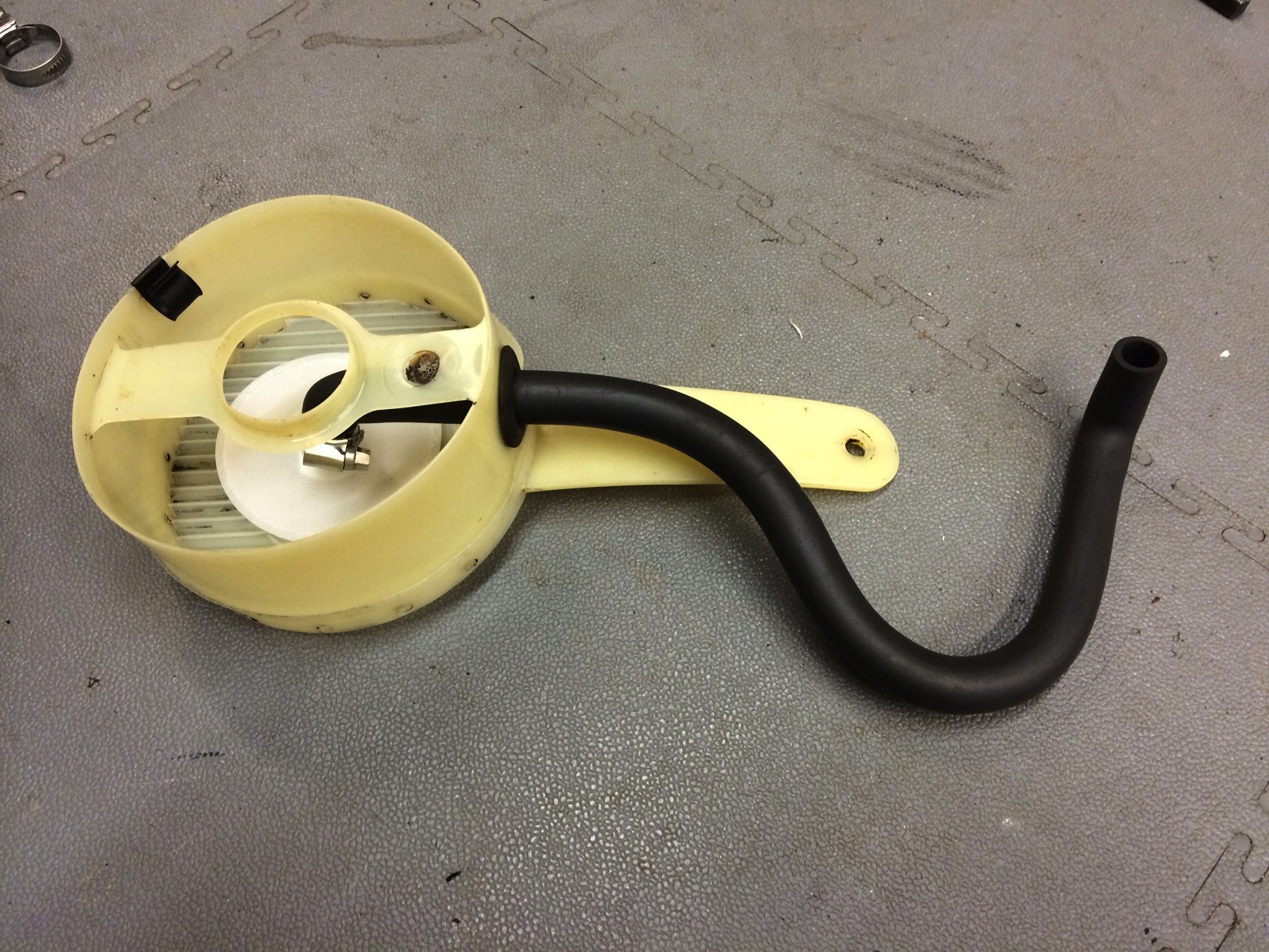

New fuel tank installed but fed the return line into a container to flush the fuel system through. Ran the pump and nothing came out of the return line.... Then I heard a trickling sound, looked underneath to find fuel pouring out of the accumulator area!

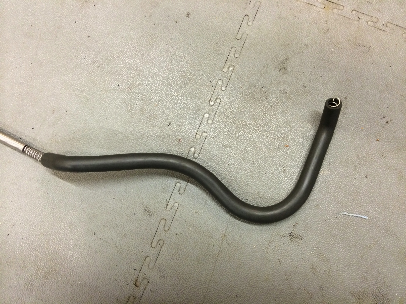

Turned out the flexi hose had rotted out and just fell apart in my hand. Renewed the hose with some new injection pipe.

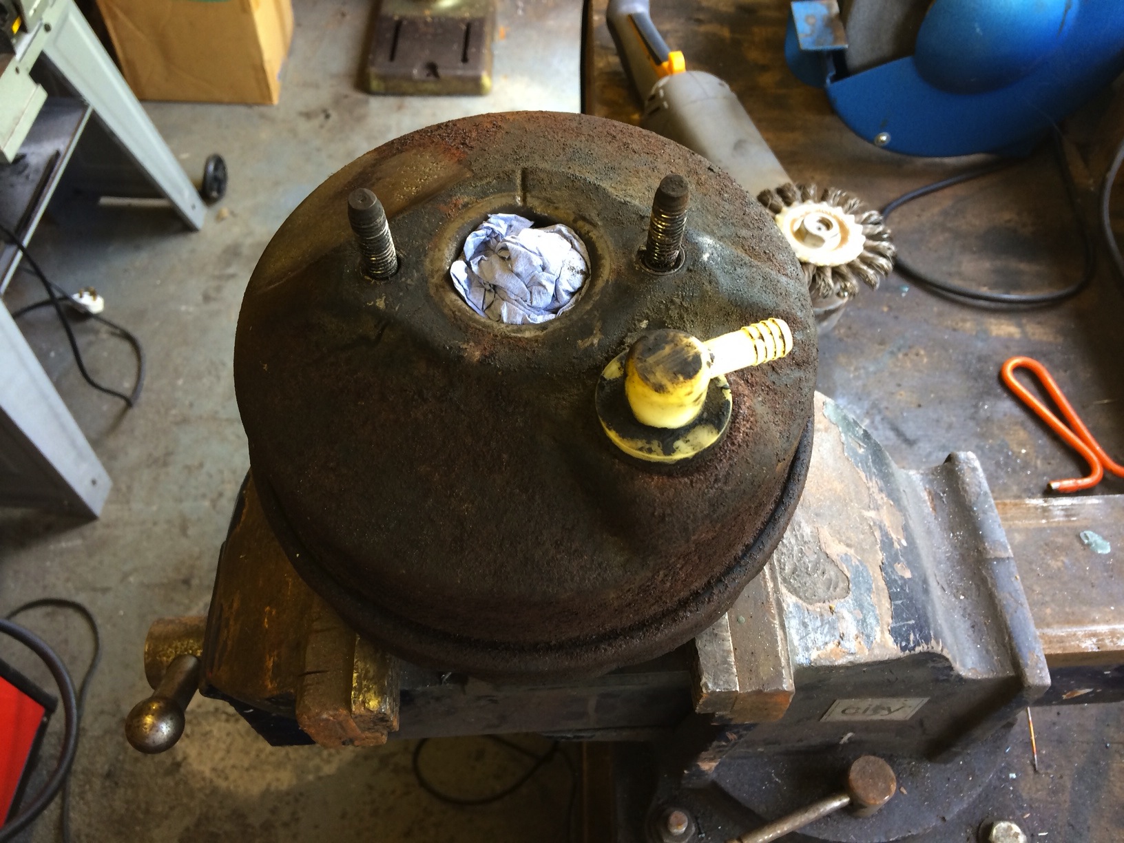

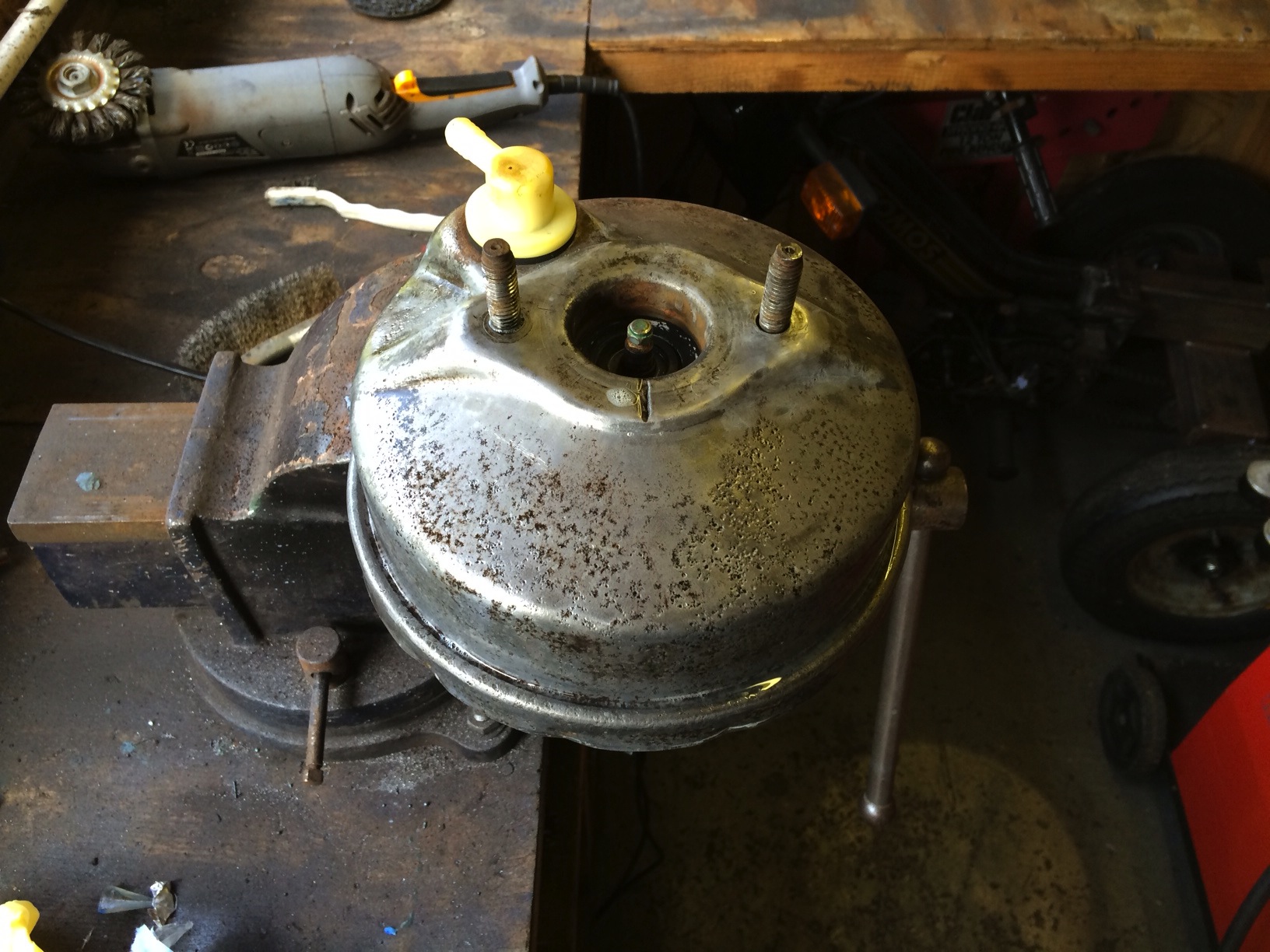

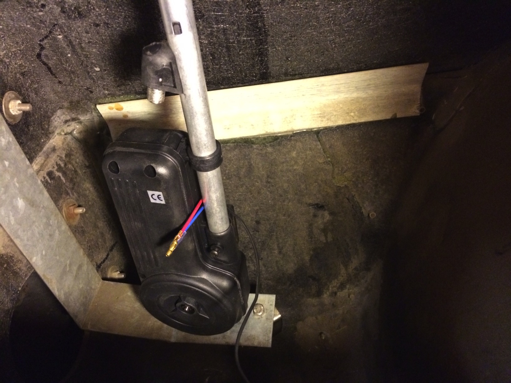

Also changed the brake master cylinder and stripped and painted the brake servo, and fitted a new electric antenna.
