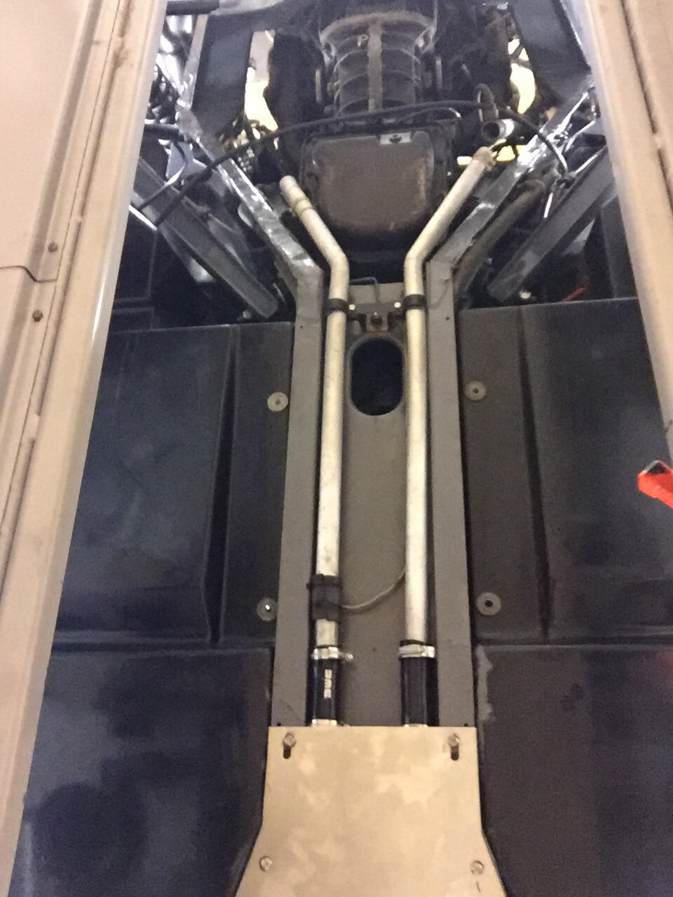

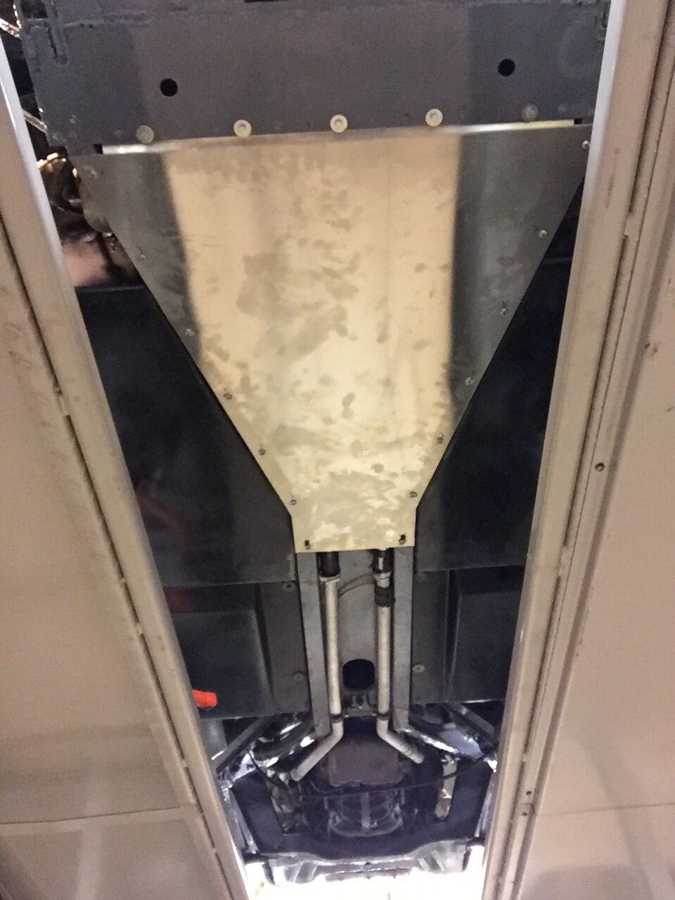

We will soon have it back on its wheels. We finished assembling the brakes (apart for the hand brake) and bled them today. So underneath we have still to fit the fuel tank, radiator, coolant pipes and drive shafts

The fuel tank has been refitted to the car along with a new stainless steel closing plate
Fuel tank closing plate

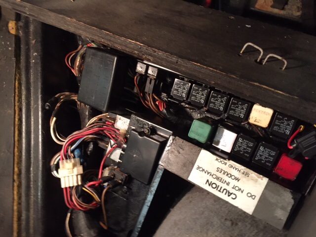

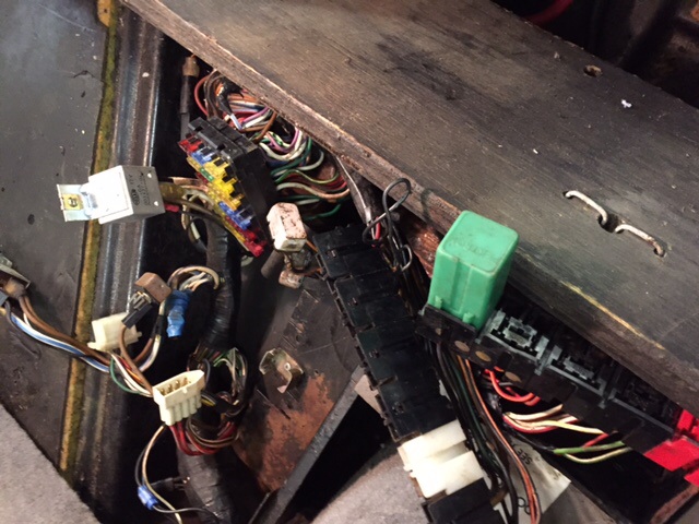

The relay and fuse compartment was a real mess so we have stripped it out and cleaned it, replaced the faulty relays, repaired the wiring, removed the scotchlocks and refitted it all back together
Rats nest
Relays etc

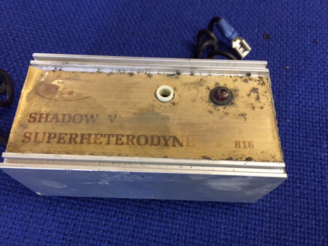

In sorting out the electrics we found that the PO had fitted this device discreetly under the ashtray
Radar detector
We googled it and found that it is an early speed radar detection device!

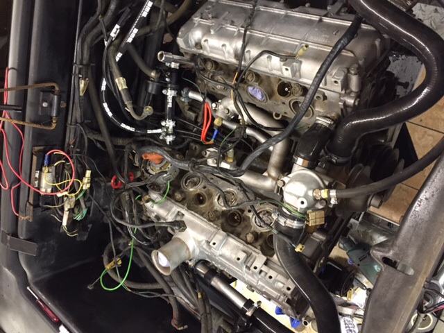

We have started to rebuild the VOD with overhauled/new components as required including the water pump which we have overhauled.
VOD

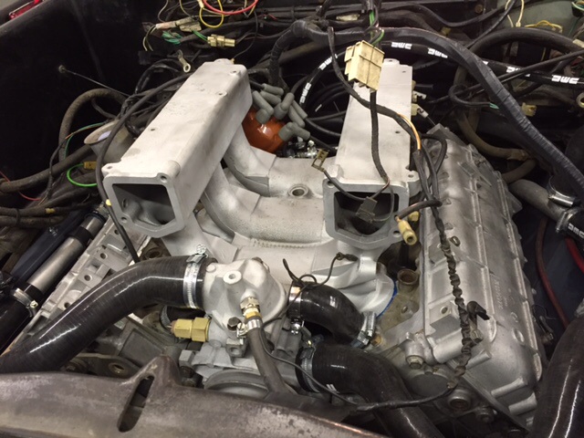

The air intake manifold is now fitted, we are starting to feel like we are getting somewhere!
Intake manifold on
