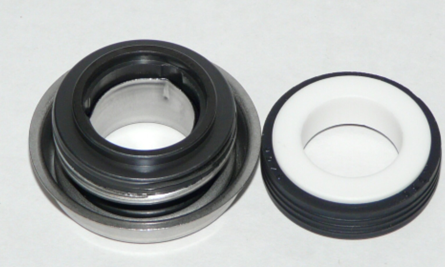

Postby mknowlton » Wed Sep 16, 2015 1:45 pm
No, that type of seal is not the one you want.
The problem here is that different manufacturers have different references for the different seal types, unfortunately I am not at work this week but when I am back in the office I will ask my store man for some cross references.
In the meantime, here is a photo of what it looks like, as I say, you will not need the ceramic seating (the part on the right)
Did you speak to a local bearing supplier as I suggested?
With all of this information I am sure that they will be able to help
Oh, one other thing, if you are going to attempt this repair, pay a little extra for reputable brand bearings ie FAG, SKF etc and don't be tempted by the cheap Chinese products on the market.

http://vulcanstock.co.uk/vsis/specifica ... =Type%2075

Re: Water Pump Reseal kit
Postby mknowlton » Thu Sep 17, 2015 7:33 am
Hi Chris
Yes, that looks like the seal but I will check the dimensions when I am back in the office just to be sure
With regards the pulley, no don't freeze the pump to remove or fit but you will probably need some heat.
To be honest I can't recall the exact method of dismantling and rebuilding without the pump in front of me, this is why we are going to do our 'how to' write up when we get the next opportunity.
